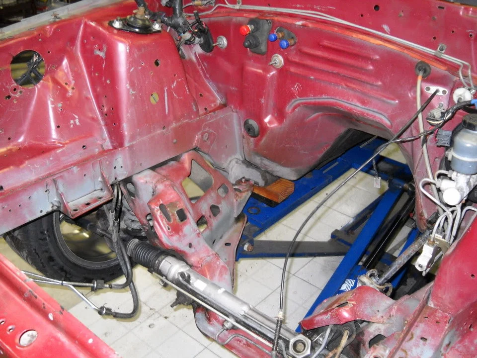

pushed the car back outside and scrubbed the crap outta the engine bay.. i went through a lot of toothbrushes!
from this
to this
the car has the factory rack still in it! thats gonna change soon! i cant wait to start sanding on the engine bay. i cant decide if i wanna try to paint the bay myself or pay a pro to do it. anybody painted their bay theirselves?
its not hard at all to paint your engine bay, just make sure u do a really good job on prepping it for paint, go on youtube an watch some videos on car painting, it will help alot, u can get a show stopping paint job from your garage , long as u fallow few simple rules,prep,prep,prep.... But for real just look around alittle watch videos, an get a nce hvlp spray gun, an spray a good high build primer down,wetsand,spray your base coat, then clear coat it, wet sand an buff it out, if u get flaws in the clear no biggy wet sand them out , an buff them,,, nce car btw, keep the good work up, you will have your own shop before you know it..

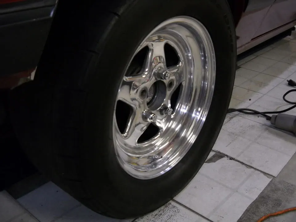

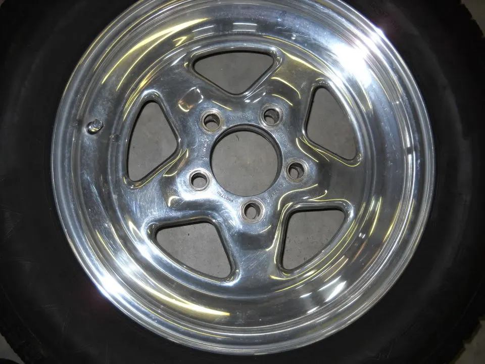

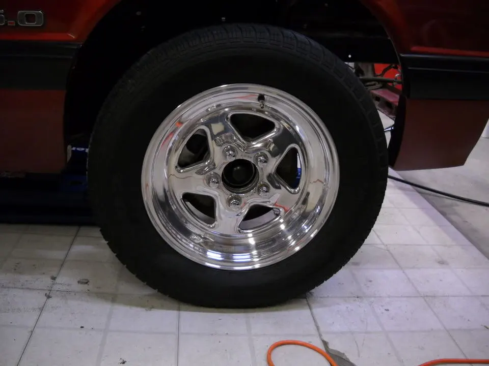

got my prostars yesterday!!! wetsanded and polished them for a few hours and they came out lookin pretty good. need some 275/60/15 nittos now.
before
after

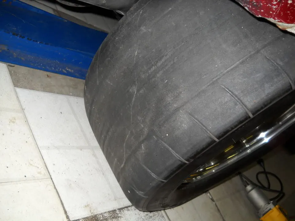

Drag Radials are a bit bald lol

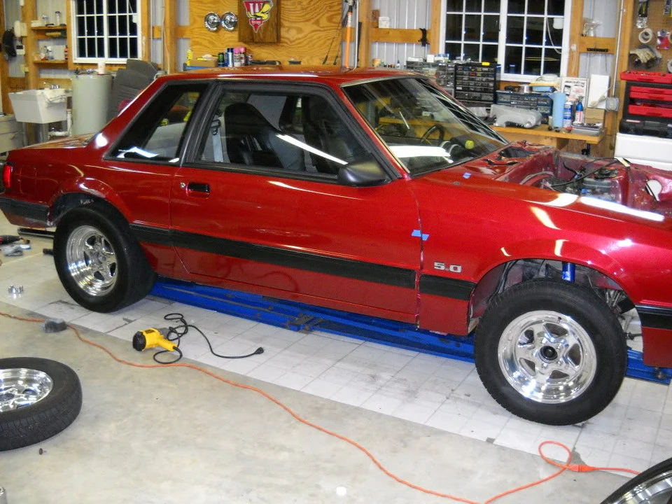

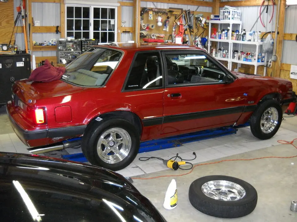

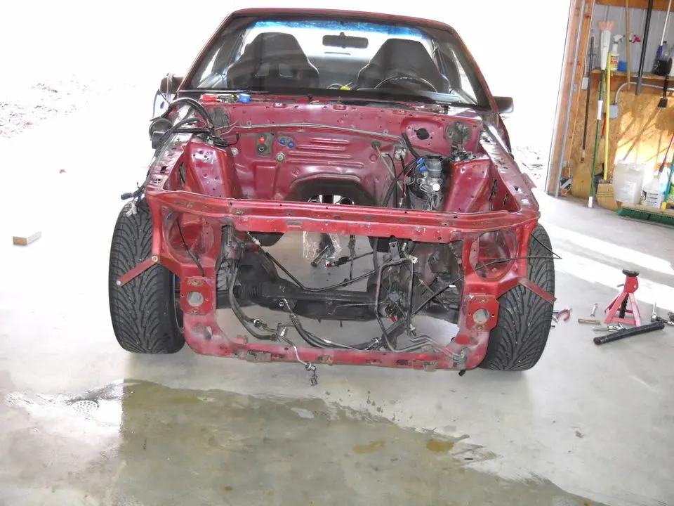

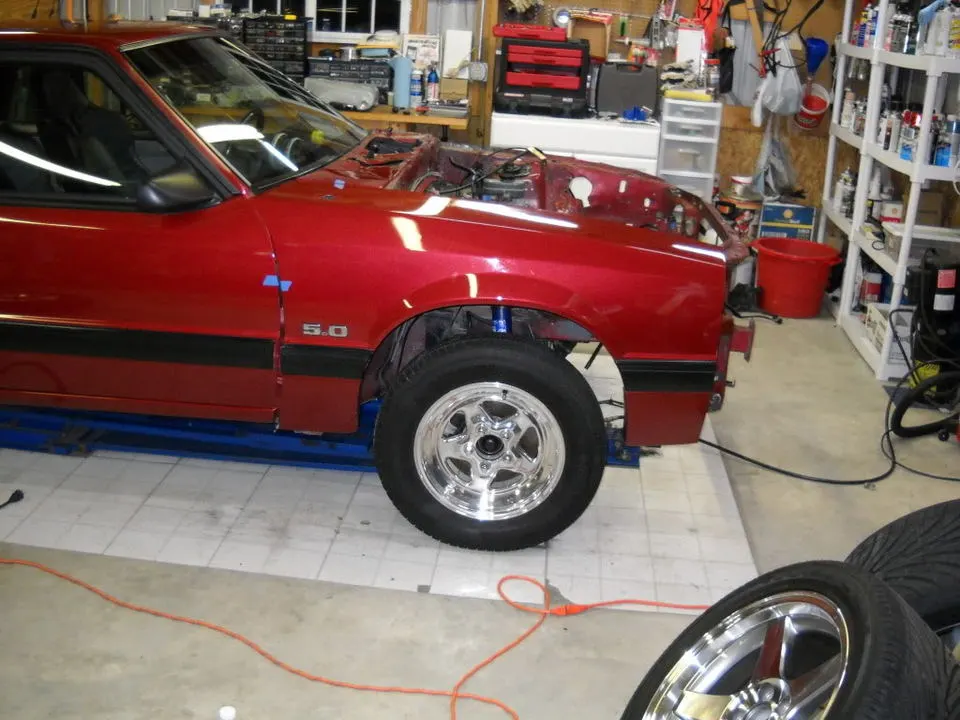

hung a fender on it real quick to see how it looked...
LMK what you think. idk if i like it or not. def need a taller rear tire though

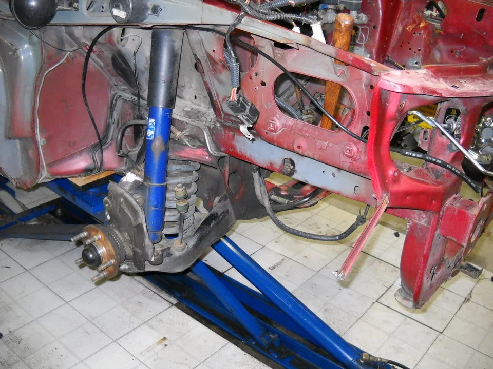

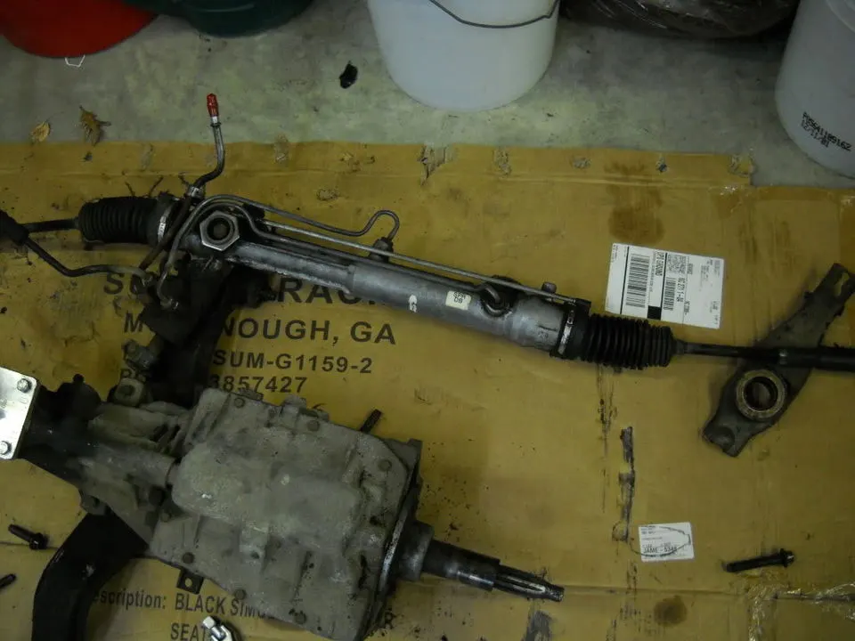

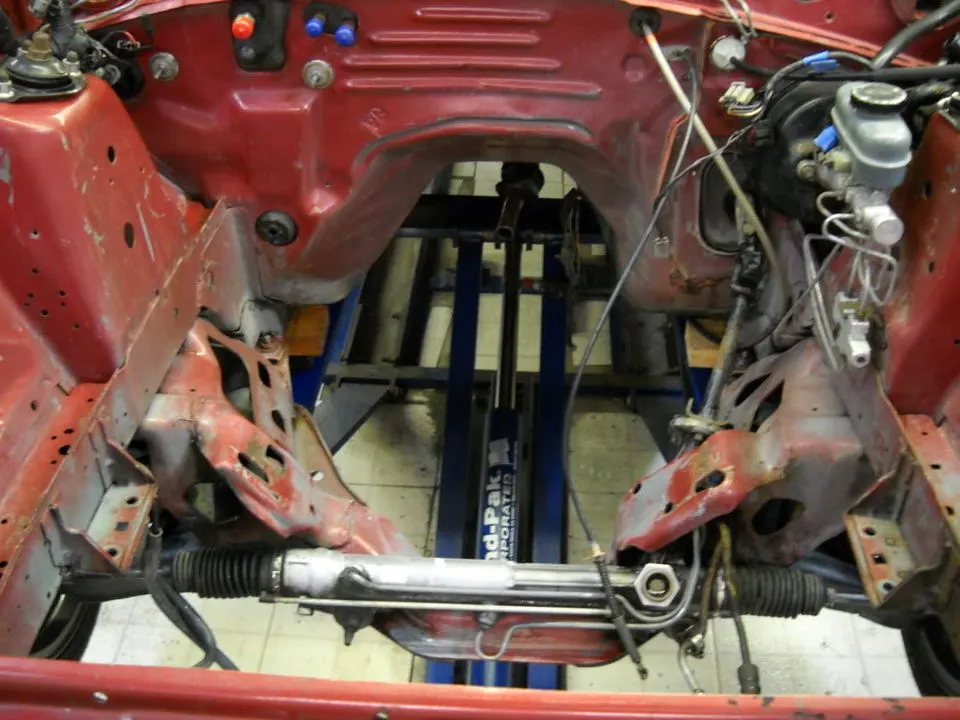

took off the steering rack
gonna take the k member out nxt weekend

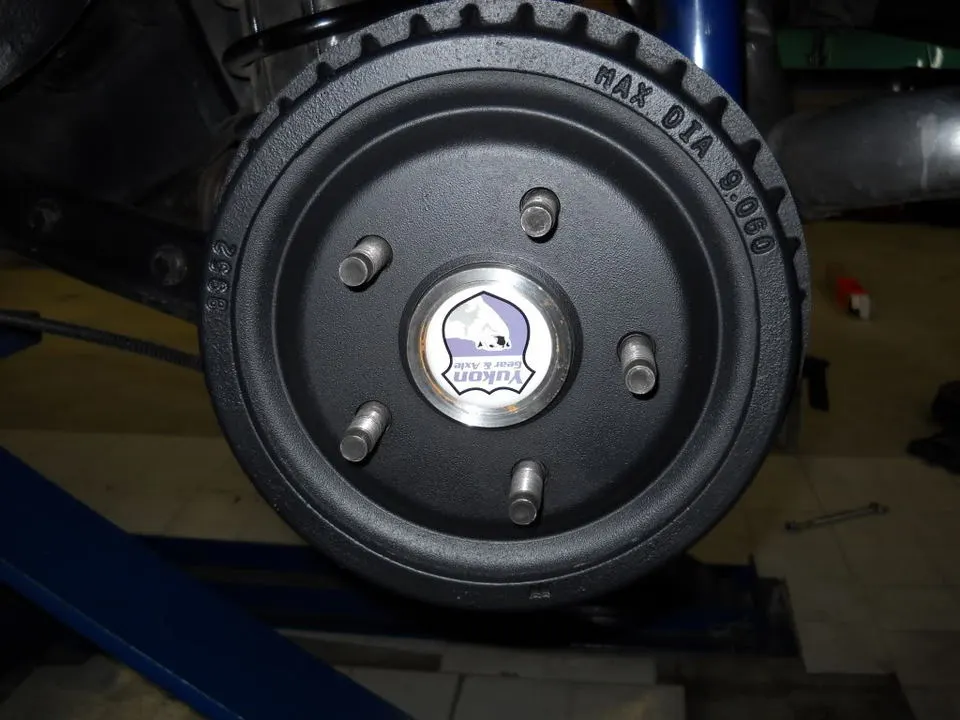

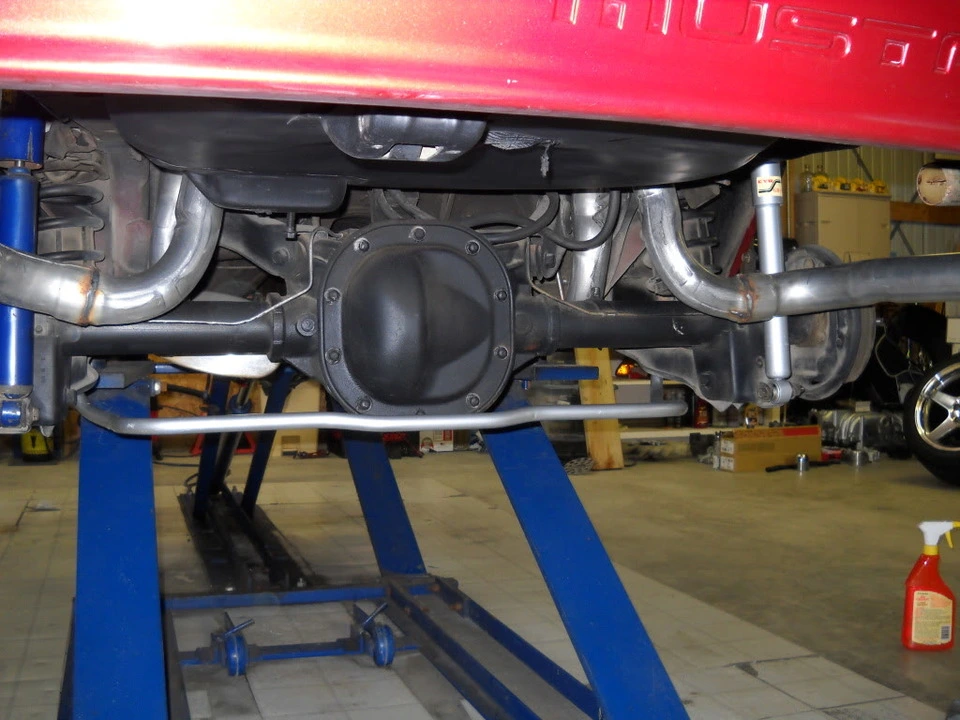

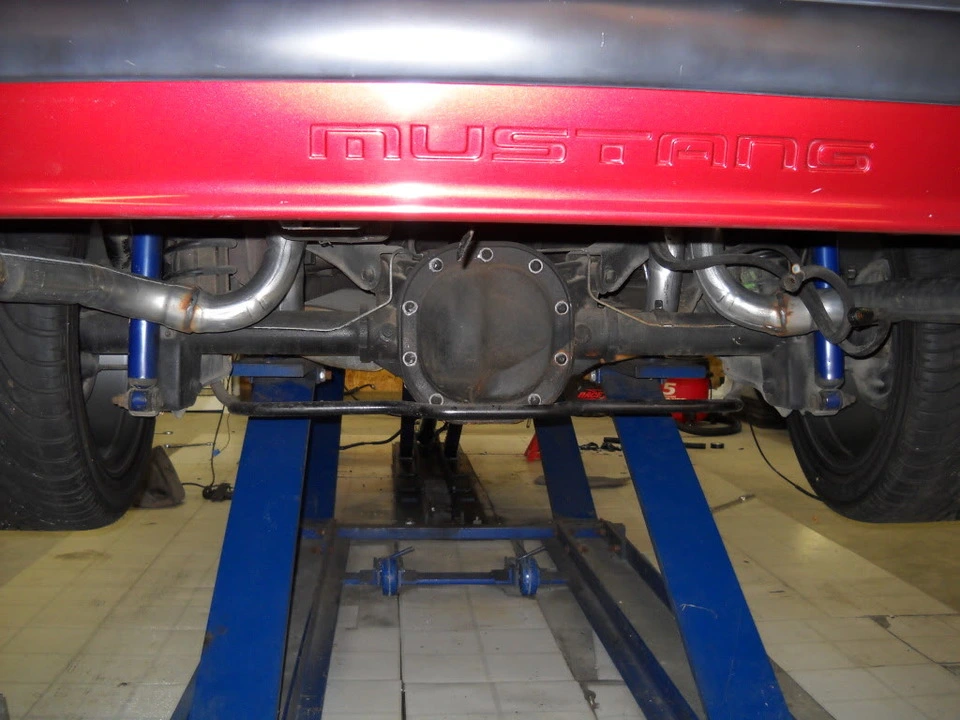

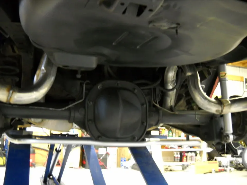

spent most of the day cleaning and painting stuff on the rear of the car...
got it done though!
before-
after-

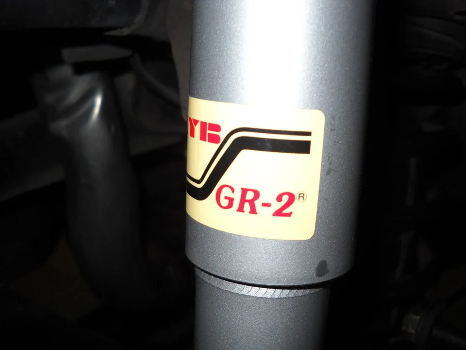

installed my kYBs
gonna start working more under the car and start workin my way up towards the front of the car. i dont want it to be perfect just pretty clean and protected.
