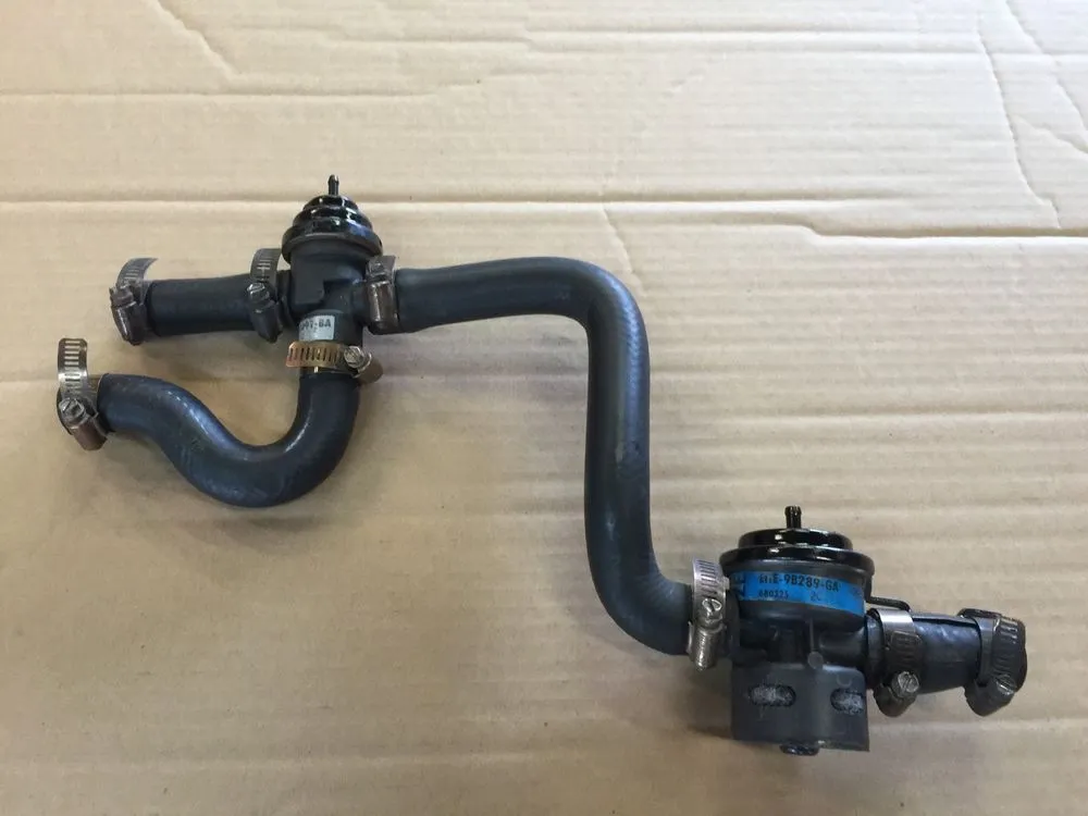

This what your talking about?
This one from a fox, the 94-5 would appear to be longer between the check valve and the bend down at the firewall, is yours gone or just ate up
Disregard my statement. The checkvalve is on the tube coming from the heads.
The pipe to the cats just routes from the diverter down to the h-pipe
Lower routing hose would connect to the h pipe. Top one goes to the ckeck valve and then to the ports on the heads

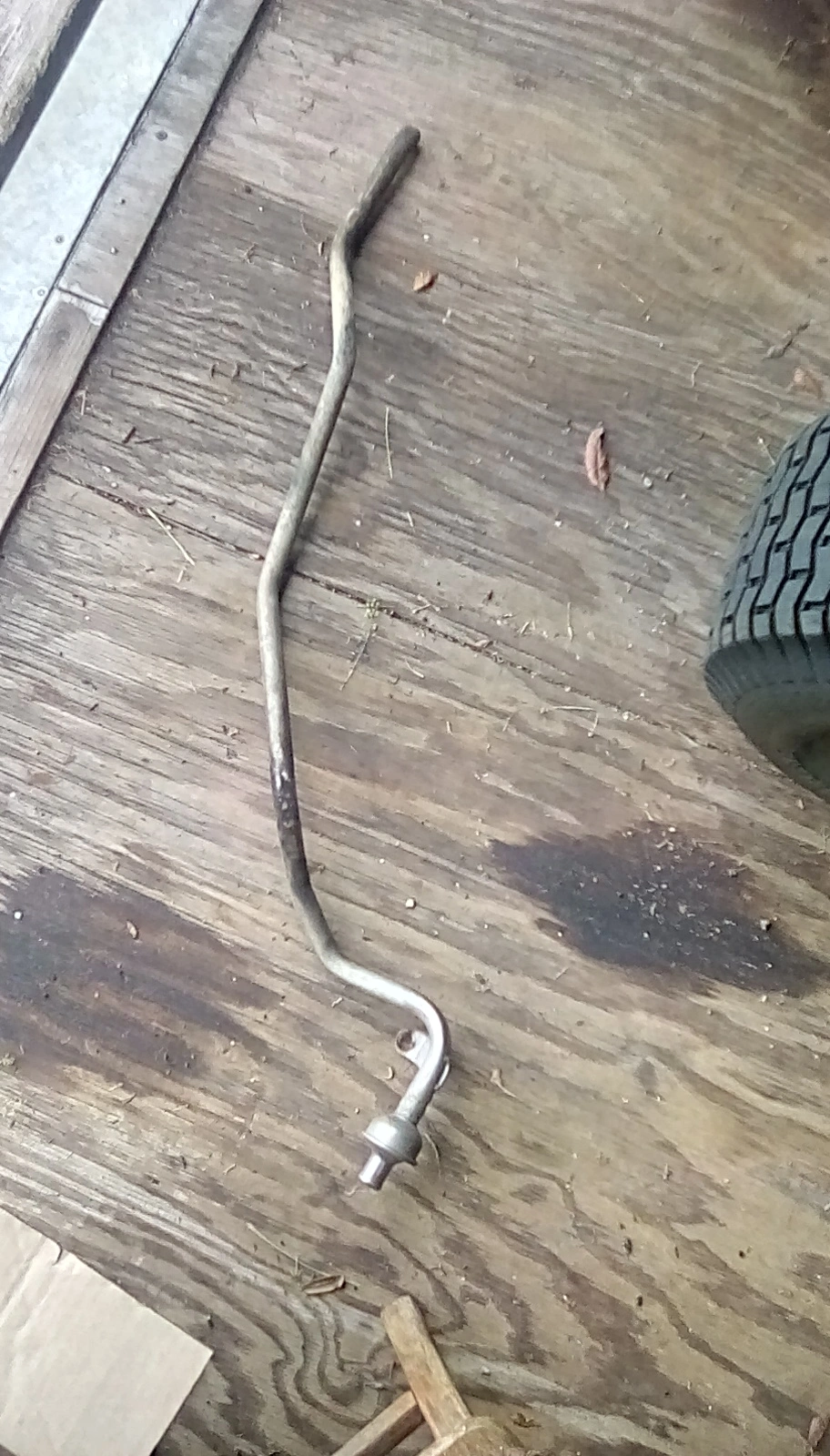

The smog pump has been disconnected from my 85 GT that i recently purchased. But all the check valves, diverter, and bypass valve stuff is all still there. From what I've been told I can remove all of that, and also remove the metal engine vacuum tube, but you have to plug the holes.
So My budy said to cut the ends off of the tube where they bolt into the motor, and install them backwards to block the holes.....is this ok or is he crazy?
