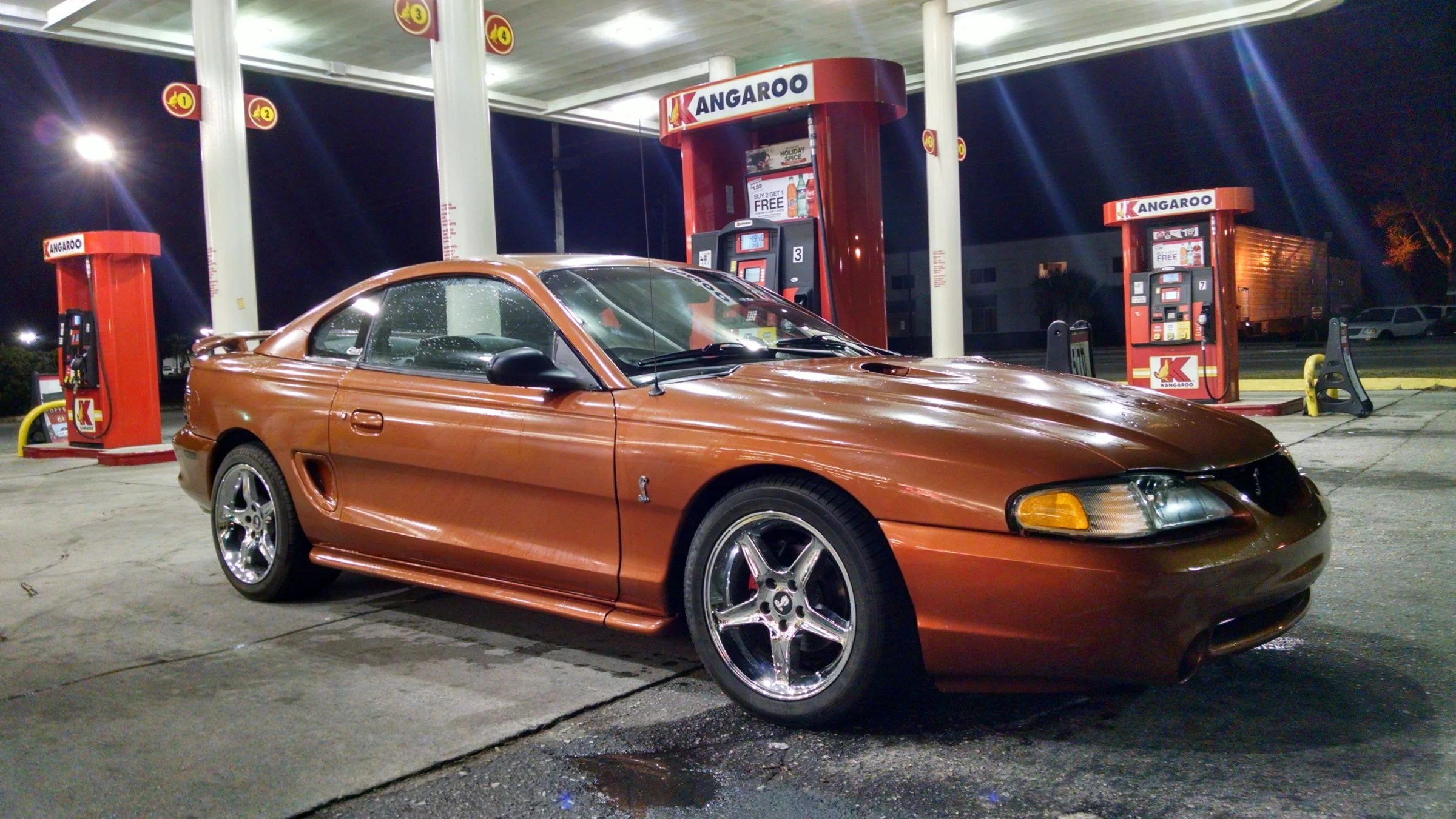

Do you have more from the cobra other than the engine and trans?

its my current daily driver i actually amoked a large deer with it bought all ford replacement pieces sent to frame machine found out itd been wrecked previously quite bad and although its straight its not the same in many ways. My plan was to buy a nice k member with control arms and coil overs i have a tko meant for foxbody and literally run every piece of the car from electrical dash gauges and should i need a different intake(i cant see why using everything sn95, id get a trick flow or system max but i truly cannot se it being an issue explain how with all myc current components. Again thanks in advance and let me. Ill have oem cobra bumpers hood lights and lol clean titled shell up for the cheap
