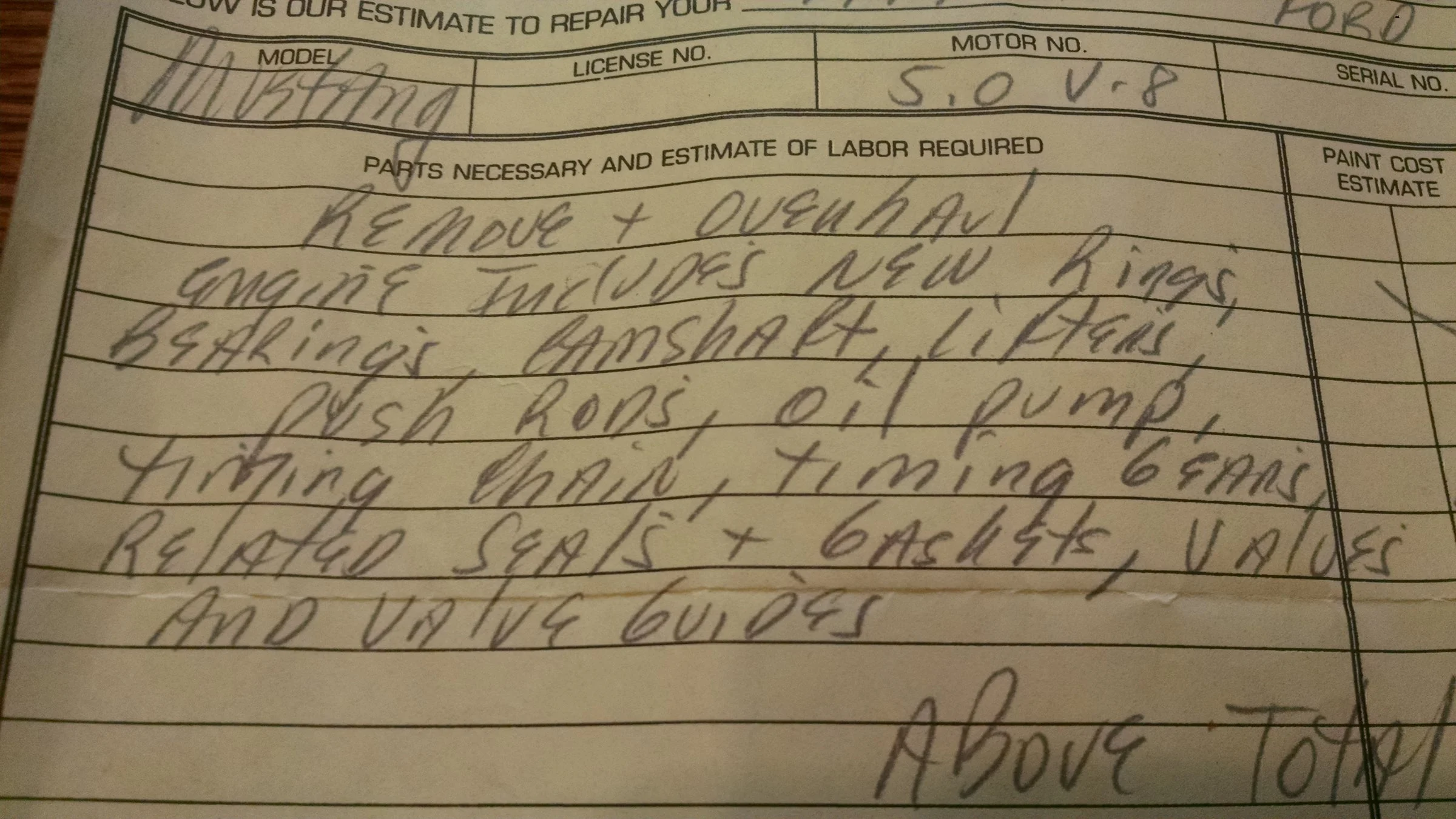

A 2013 "coyote" 5.0 swap with supporting parts etc, 15K easy.
You should drop by the shop and ask him to show and educate you, if he's been doing it this long he shouldnt mind and you could play back what you learn with folks here for validation and clarification like youve been doing,

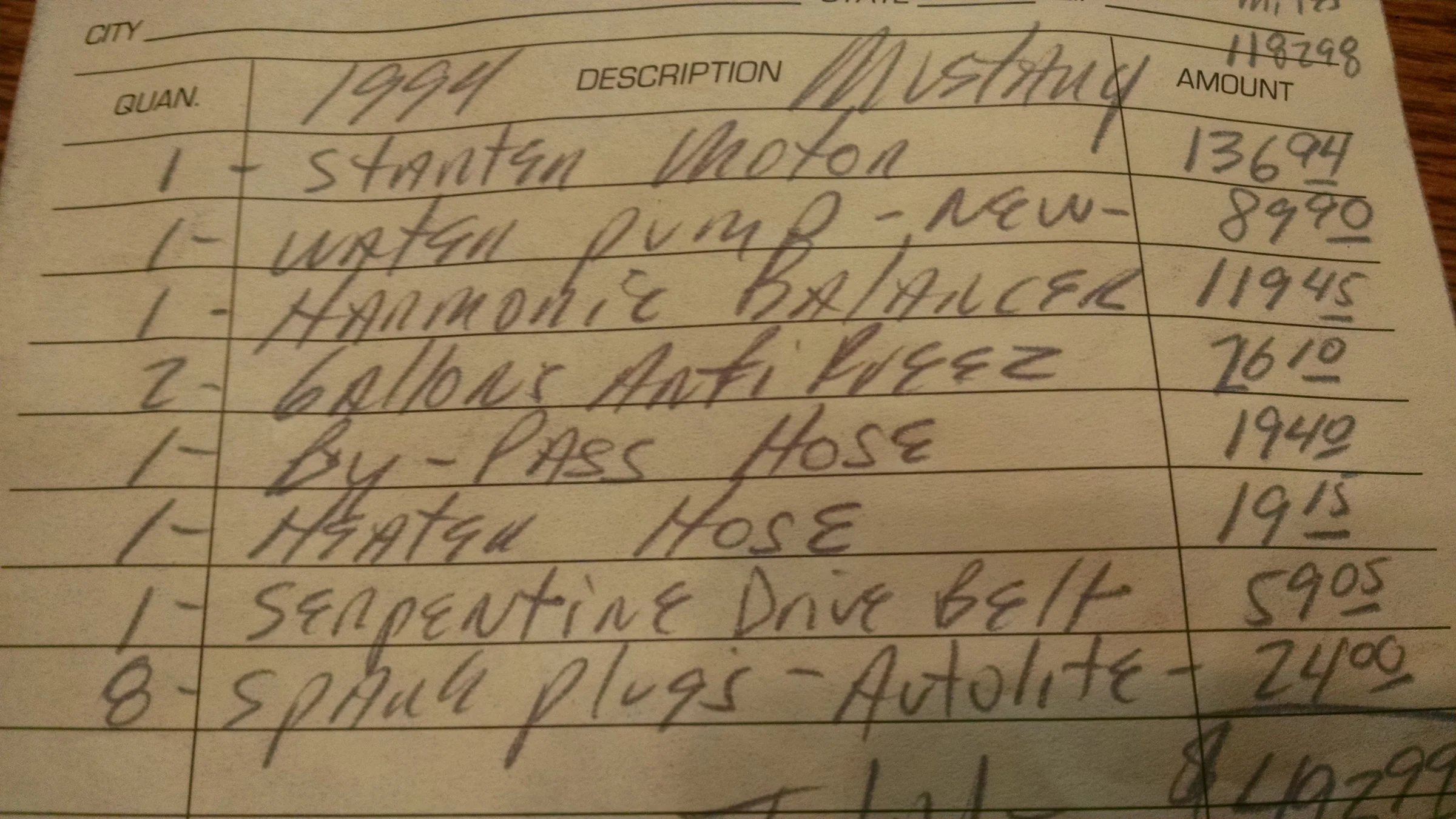

HATE IT HATE IT HATE IT im gana burn this POS to the ground ... got car today drive it the 50 miles home .. have to drive it the 50 miles back cuz something isnt right!
this is list on what he replaced ... the crank isnt on there but it was replaced

Why on earth would have had to replace the crank? All it would have needed was the journals polished.

and this was why the rebuild was so much just over 4K
what i dont get is i would call some of this stuff part of the engine rebuild ... like the harmonic and the coolant and spark plugs
it was warped or bent or whatever .. its what shot the engine to .. well it was the harmonic balancer really the damaged the crank
Those are actually pretty fair prices from a shop and none of those items are in a rebuild kit. It's an itemized break down of everything purchased and he laid hands on. Those extraneous items never make it into the Summit or LMR ads offering stroker or rebuild kits, but damn if you can't get the engine back together without them.
What's puzzling me is why you needed a new starter? Was that bad to begin with?
it was warped or bent or whatever .. its what shot the engine to **** .. well it was the harmonic balancer really the damaged the crank
Ahhh.. that will do it. What's the car doing that you need to take it back? You're coming off a fresh rebuild, keep in mind there is a period of time for things to break and settle in.
the starter was covered in oil as the rear main sall was bad
