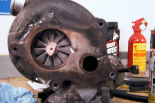

...and I swing by 140's house. I see him and his friend Todd were working on Todd's car. He has a nasty crack on his E3 and apparently 140 talked him into swapping it for a ported E6. :notnice: 30 minutes later, and 3 nuts off, we decided that the exhaust housing should come off to reach the last nut.
140 then proceeded the break all 5 bolts in half. Here is the carnage left over.

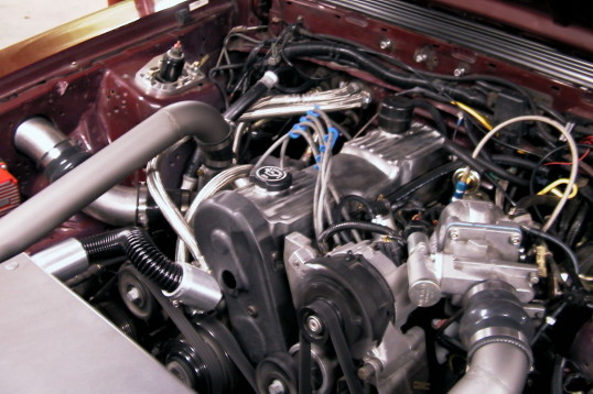

We then jump into the LX and go for a spin. I'm sceptical of the Volvo intercooler but we made a few runs thru the gears and I notice something. Either my car is messed up or his is. During shift the car does not jerk when it hits boost. Everytime I shift and let the clucth out I get a jerk back which 140 mentioned he aslo gets in the SVOld. We attribute it to the suspension.
I'm not liking the out of boost power but it feels nice going thru the gears smoothly with boost. Not a good drag car but fun for highway races and turns! I think the Volvo is choking the flow alot.

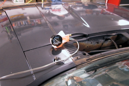

So from there 140 was trying to figure out this miss he was having. 3400 rpm and 12 psi and the thing just ran into a wall on his SVOld. Revving out of boost is fine but as soon as it hit 3400 with 12 psi or more BAM! What a piece of #$%^! So after him already having changed the plugs, wires, and computer we start to work. We swap Todd's distributor over and go for a ride. This is the most violent jerk of a miss I have ever felt. SVOhmygodwhatthehelliswrongnow? We come back and start thinking. 140 hooks up the vacuum guage and everything is fine. He then puts on the fuel guage and everything checks out. So I mentioned that maybe the afpr isn't raising properly with boost. So he then shows me the coolest 20 minute fuel guage install in the world!
Well we take off, flashlight and all, and I shine the light on the guage (gayness) and we see that the afpr is working fine. The miss still lives! After returning home dissapointed 140 begins to cry. Yes I do have a pic.
