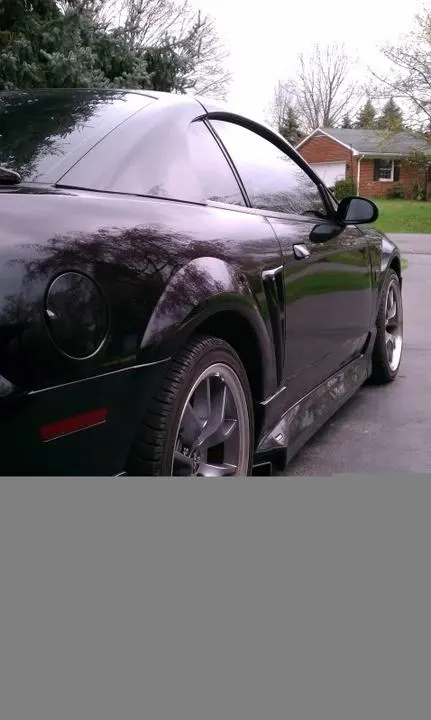

I have 255/35's on mine, I'll snap a pic before I go to my softball game tonight...

It's not the best pic but if you look at the front wheel where it meets the tire you can kinda see how it sticks out a little bit...and yes I know the car is dirty

Thanks for the pictures they really help. I think the 255 tire will be fine, it looks good in the picture. Thanks guys!
