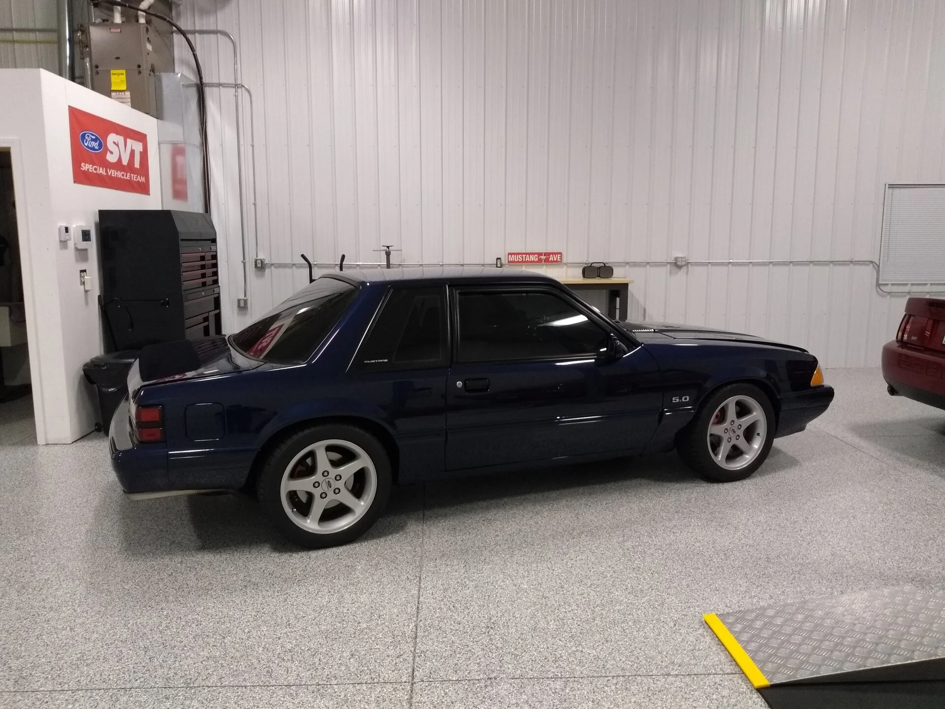

I didn’t mind the 4 lug cobra R wheels until I started looking at pics of Foxes with 5 lug cobra R wheels. Now it’s engrained in my head that 5 lugs are the only way to go if you get those wheels. Having a black/dark center cap helps make the 4 lugs look more tolerable IMO.

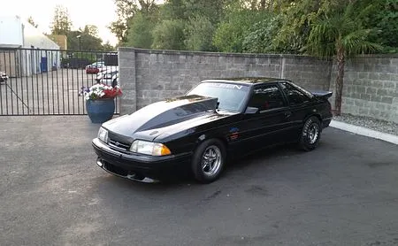

I don’t mind the Saleen spoiler as long as the rest of the car somewhat matches the theme (at least a slight cowl hood, the right set of wheels and a good stance), like this:

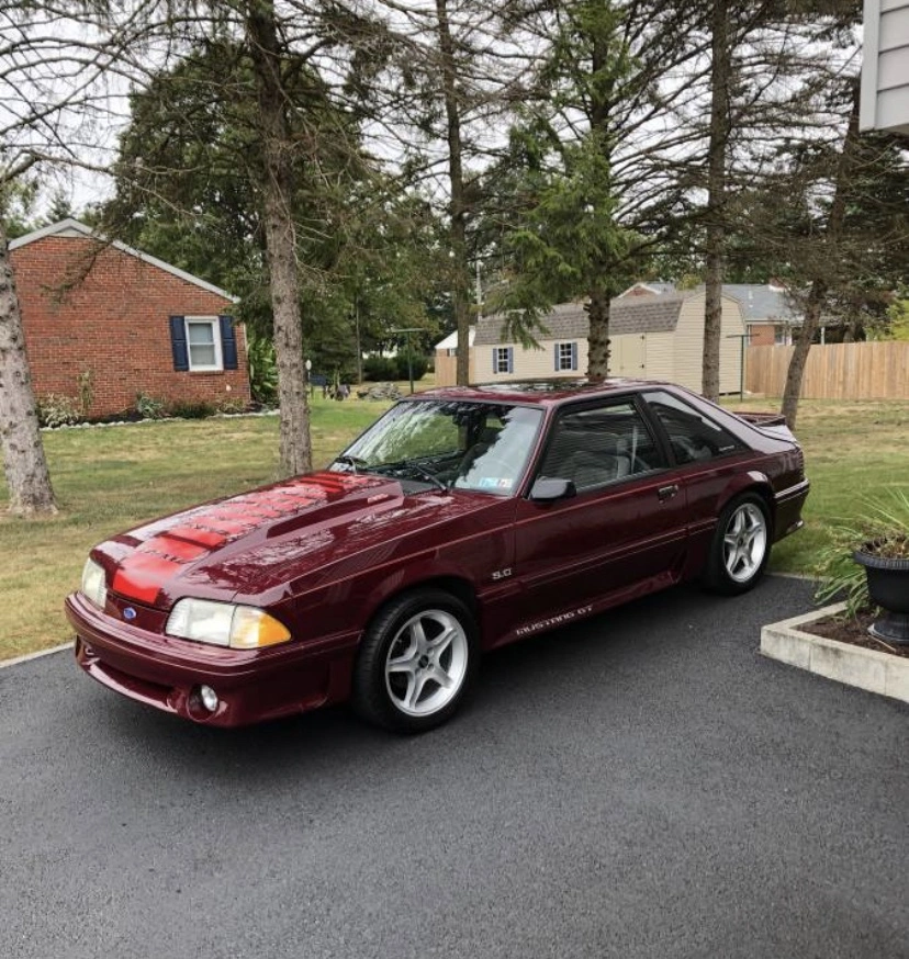

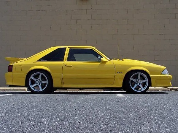

I personally never liked the saleen wing. And not a fan of those wheels either. But bullitt wheels look worse and only belong on vintage mustangs in my opinion.
The 99-01 cobra wheels look good though. I might be partially biased though.

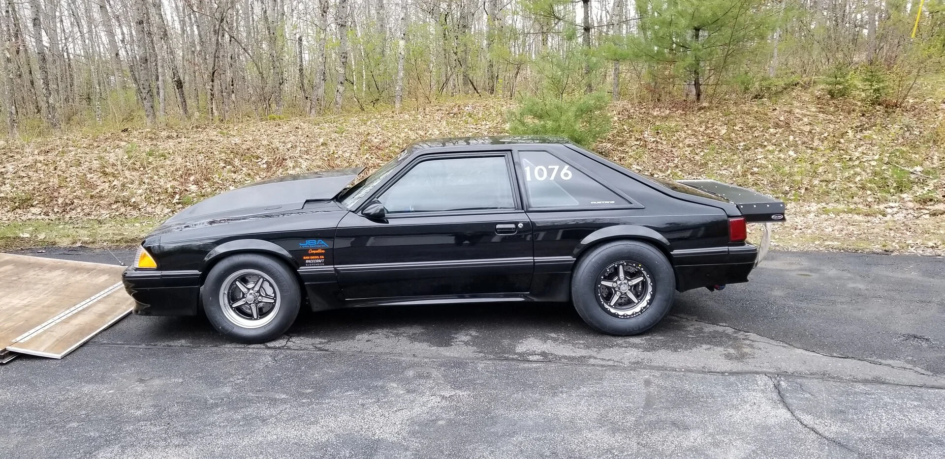

The Saleen wing worked as intended. It provided a lot of down-force on the rear of the car at speed. Since I have a Saleen, I thought the rear wing worked very nicely with the rest of the body tweaks that Saleen did.
When I took the Saleen wing off of my Racecar and put on a flat wing, the car picked up 3 mph in the 1/8. That gives you an idea on how much downforce/drag that rear wing provided. It is hard to get downforce without adding drag.
At the same time, it is easy to add drag without adding downforce.

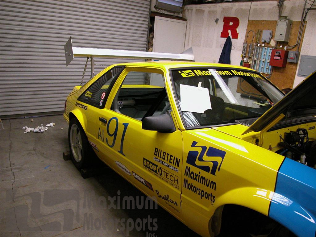

I don't want to get in a big argument about it, but I would tend to find the wings being very effective to be dubious at best.
To be blunt, our understanding of aerodynamics has increased greatly since the Saleen wing debuted in 1983. The "divisive" 2000 Cobra R wing was often blasted by people as being too high and ugly, but the reasoning from Ford was sound - if it was too low, it did nothing. This is also why all the race cars, such as the Maximum Motorsports one...
use a big ass wing that sits above the roof - because that is where they are most effective.
Still, I guess it can't be ruled out that a Saleen wing does nothing since I don't have access to a wind tunnel, but as with most pieces for street cars I would lean towards 99% aesthetics.

Agreed on the 2000 R. I remember reading that it was described as “just high enough to be functional”.

To be fair, that has to do with the shape of the new Mustang body. The newer generation Mustangs (and all newer cars, really) are so much better aerodynamically than prior years that they can do things much more cleanly and efficiently.
Despite the "aero nose" our cars are bricks compared to the new ones. A lot of people focus on the "boxy" front end, but we've learned that the rear of the car is just as important, and how the air flows off and detaches from the car has a huge impact on drag. The air flow detaches from the Fox at the roofline because it angles down too sharply, which is why spoilers and wings that are mounted on the edge of the trunk are less effective than ones above the roof line. Ideally, the air would flow down across the rear glass and detach smoothly at the end of the trunk.
The bubble hatch capri probably had better aerodynamics because of that, but they are super ugly too :)
