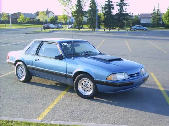

So this winter i am going to ditch the T-5 and i have a pinto C4 already to put in. I had it rebuilt with all the best upgrades, more clutches in the direct drive drum , H servo and stage 2 shift kit, i also had the converter redone to impove the stall RPM.
At the end of this year the IHI blew up, too much boost i guess so i bought a T-3 .60/.63 but the cold side has been swapped,the wheel and shell are from a GN turbo. It works great but i think the TC IC has to go maybe a nice front mount is do.
