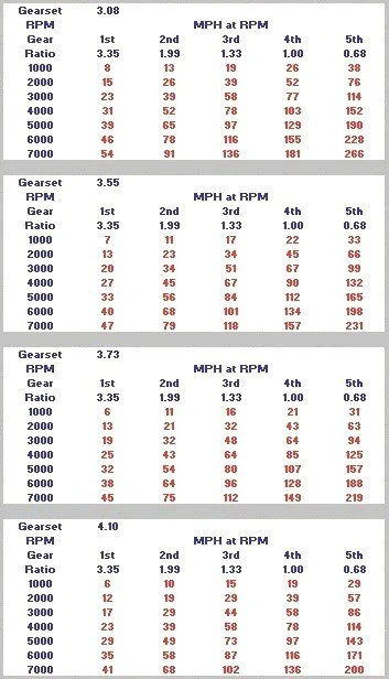

See below - this chart uses stock tire size and stock T5 gear ratios.
gear-ratio-charts-jpg.553834

Based on the excellent chart jrichker posted, along with what you guys are saying, I'll probably go with the 3.73's I originally intended to go with.
