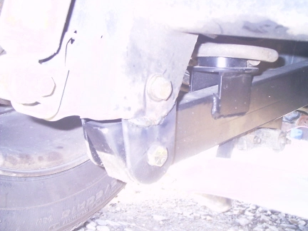

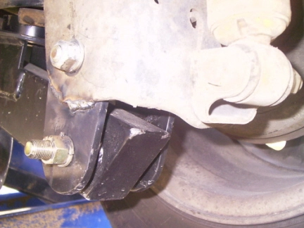

hopefully these pics will help with my question. and do any of you suggest that i reinforce the torque boxes, considering i do have the southsides on it. or should i just cut the welds and put the factory arms back on? thanks for all the advice guys, i am new to the stang world and all help is greatly appreciated.

I have southsides on my car also and they are welded like yours in your pics,they are welded i guess to prevent the brackets from shifting back and forth. Mine were also making alot of noise too found out i had no spring isolators and i put some in and the noise went away. i heard some people say they took them off and put the stock ones on and their car hooks up better.
WELD THEM IN.
I'm not even kidding...a buddy of mine was at full boogy on the strip doing about 130 and one side busted a bolt and his axle twisted sideways and he went spinning 360s down the track....was a miracle he didn't flip or hit anything. Also personally i wouldn't run them without reinforced torque boxes.
with proper precautions (welded/reinforced TBs, welded axle side etc...) I feel the southsides have some of the best hook for a stock style suspension. it grab and keep grabbing and i love them. but without proper precautions, you'll hate wat kind of damage they'll do to your car
