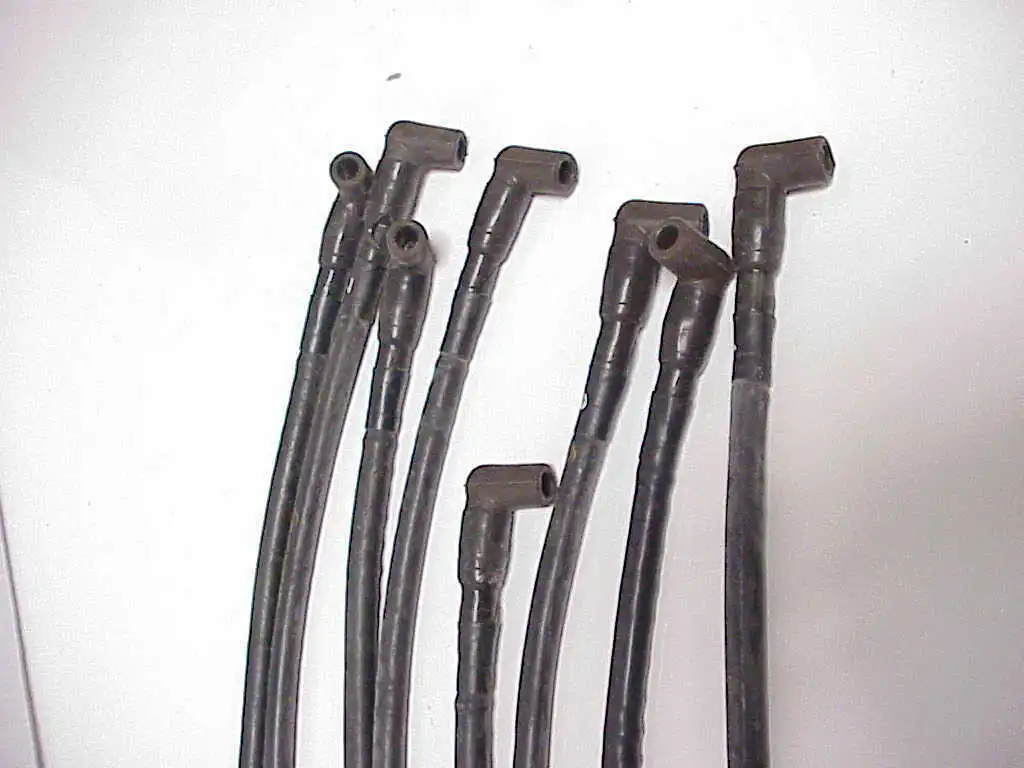

go and buy a used set of Blue Streak 8.8 nascar wires with heat shield ... these are the best you can buy .. comes from a Chevy engine and numbers on the cables dont match with Ford but they fit ... they sell the kit ..8 cables...for 30 buck on Ebei ... :coff: hendrick motorsports
You just found my next set of wires , thanks.
