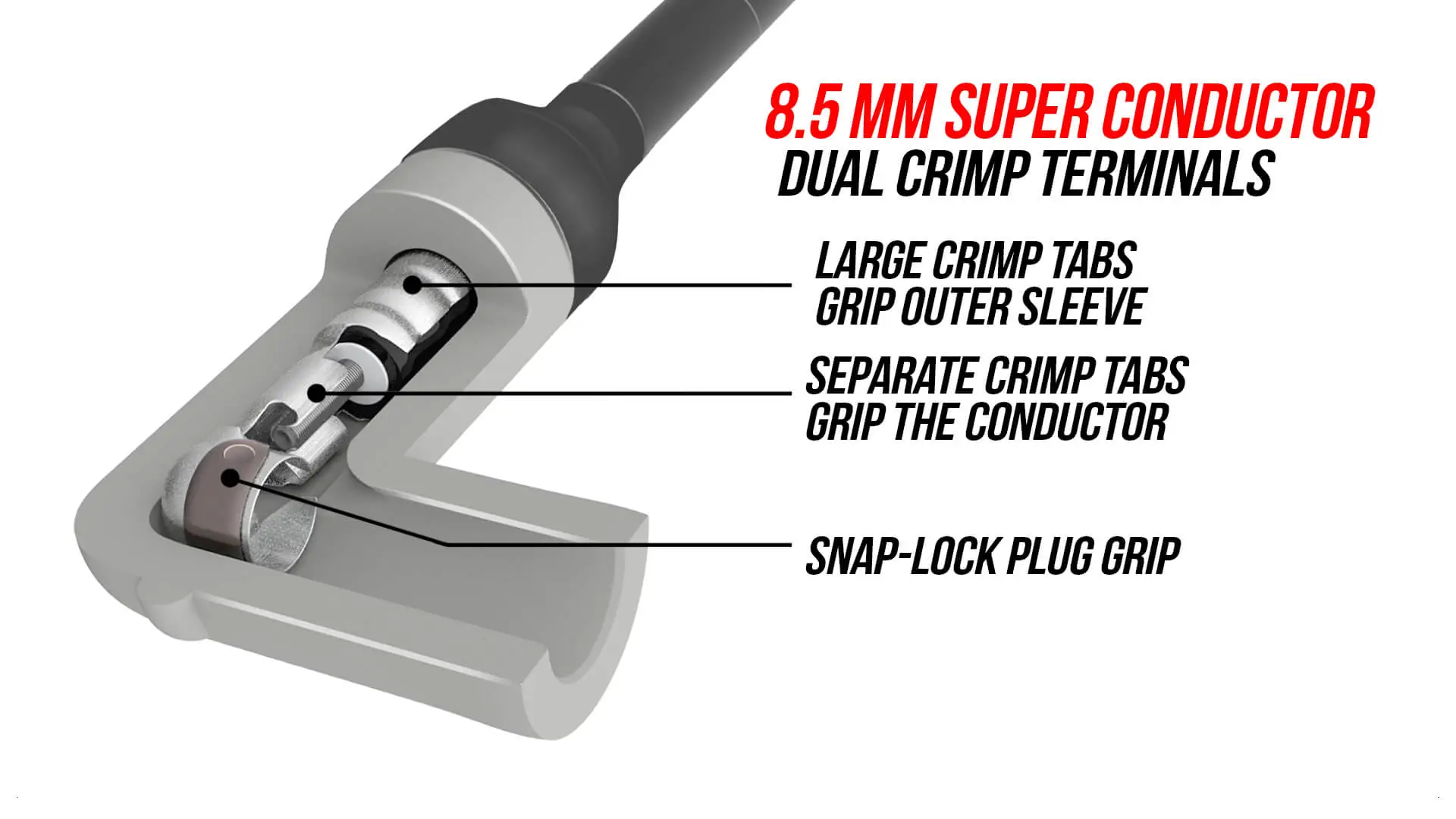

any thoughts on double or single crimp connectors?

Those items are all you need to make plug wires, plug one extra boot and terminal to make the coil wire. It’s a good idea to get an extra two terminals if it’s your first time, allow just in case you mess up.
Double crimp terminals are nice, but not required.

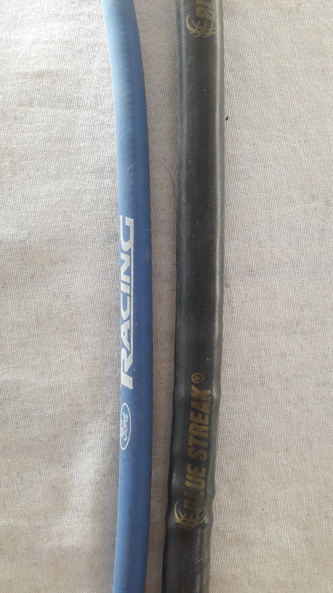

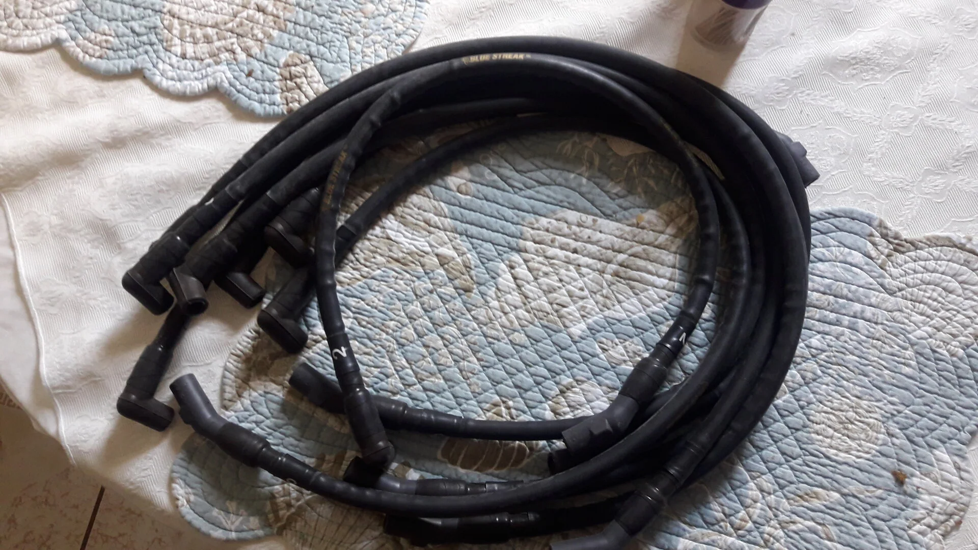

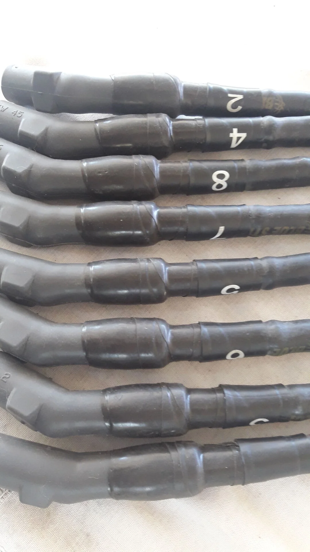

USPS 4 Days shipping to Miami... this are Chevy Wires so the numbers dont match with ford ... but they all fit and no problems ..I had these wires on my other 331 .. but sold them .. next week I gonna install them on my actual engine... they have a heat shield thas why they look so thick and are like 12mm thick..

there’s really only one way to do a double crimp
When I do a dual crimp style, I crimp the silicone sleeve, and after I gently push the core with a flat head screw driver (or anything thin a s flag) while crimping the second, just very lightly until the core will stay in the terminal itself. Then I finish the crimp. I like to crimp the silicone sleeve first, because if you do the core first, sometimes it can get strained when going back and crimping the sleeve
That’s why I usually recommend a couple extra terminals if it’s your first time. FYI, the single crimp method is easier, but I like the dual crimp if available.

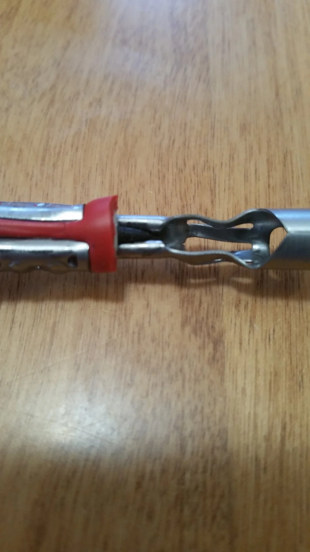

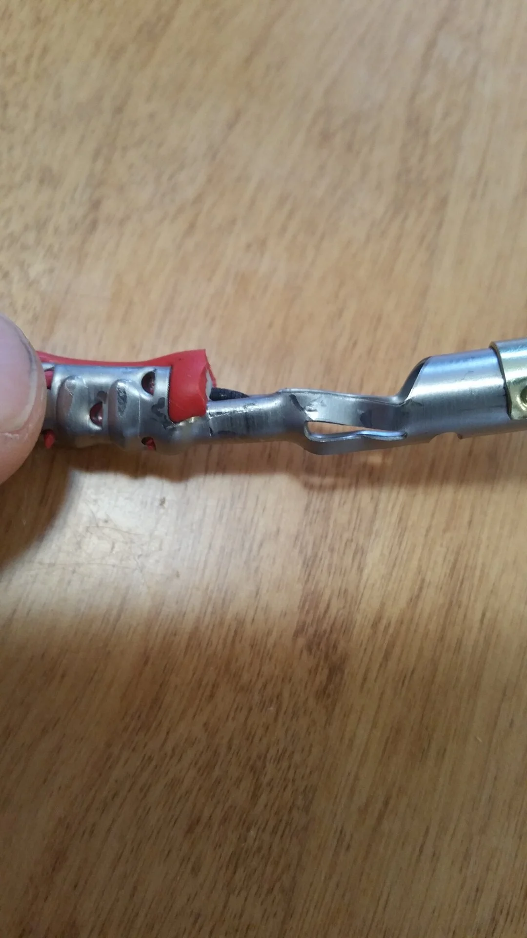

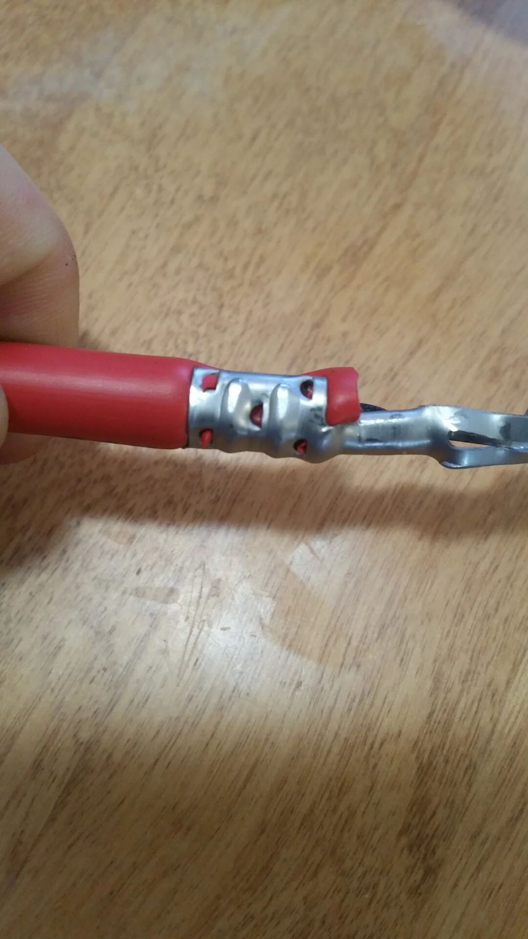

pics below. how bad am i doing?
im having a bit of trouble getting the big crimps to form properly. i tried to bend in the tabs a bit, no luck yet. i keep getting a weird fold in the crimp. overall it feels really solid though.
it seems like the big crimp is getting too squished, i hope thats just because of the technique isnt good yet
