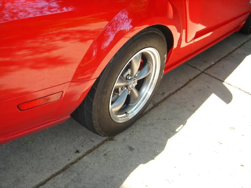

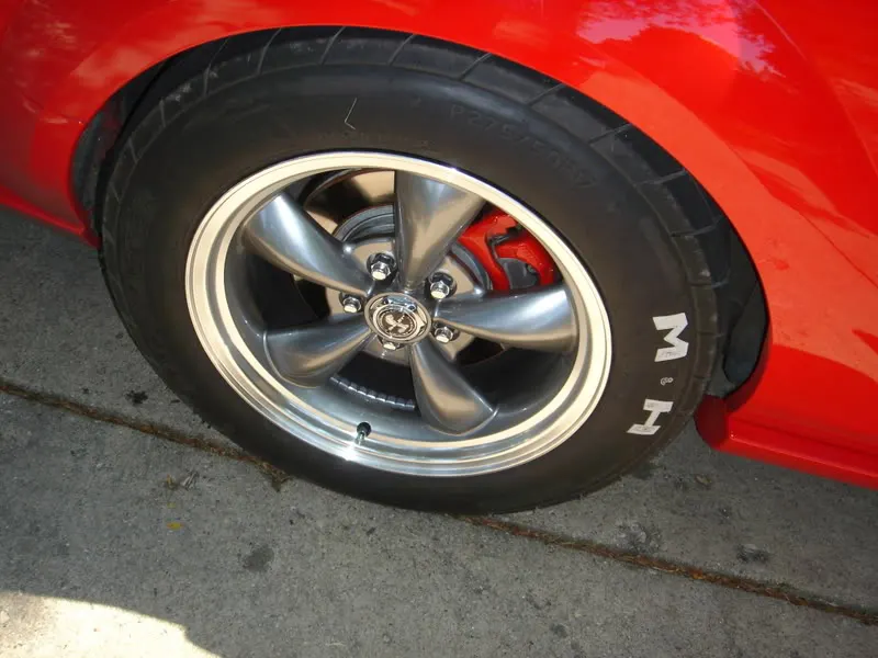

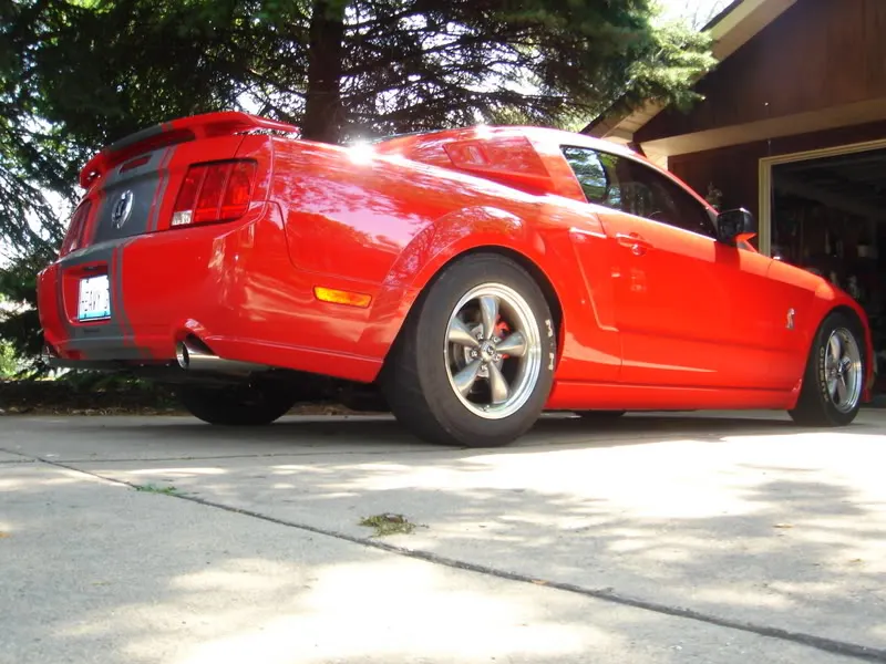

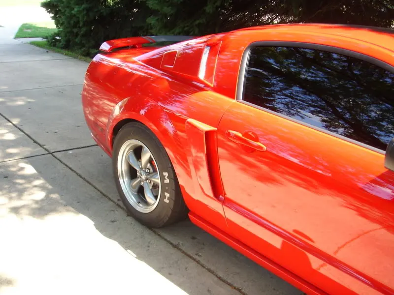

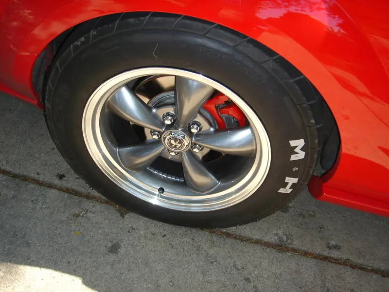

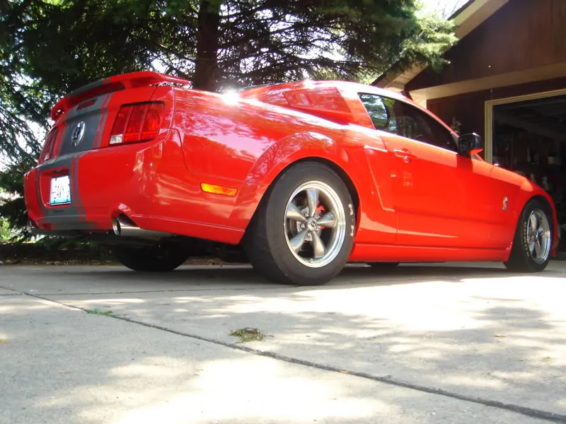

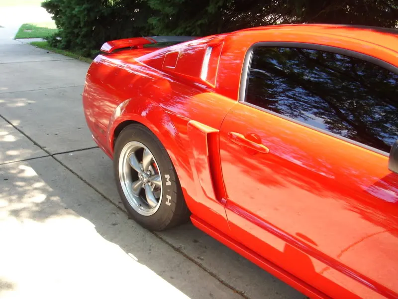

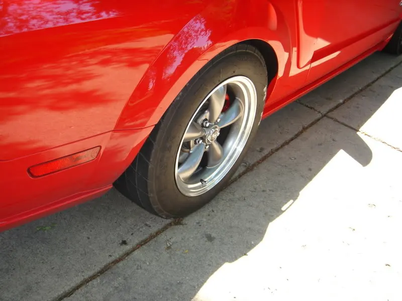

I decided to go with the M and H drag radials for my stang. The car really hooks up wth these plus i love the size... 275/50/17 which fill the wheel wells perfect. Gives it that old school look, which I love. Got the rubber discounted for $180.00 each direct from the M and H tire web site.
What size (width) rims are those ?
Live that tall tire. Be nice on my 65 fastback
