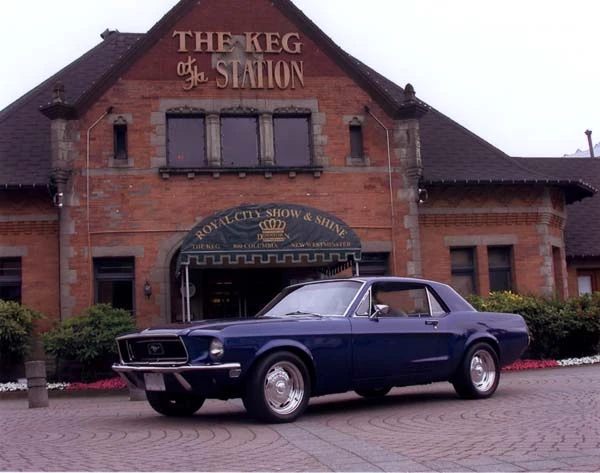

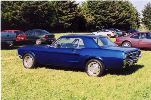

Great68, is that your car in your avatar? It looks good. Got anymore pics?
:D
That black line is NOT a pegleg weird burnout, it's just road tar :p
And a couple with my buddy's MINT 69 camaro. Gotta keep the American Muscle alive.
;D ;D

Based on the pictures, the 1" drop coils and the mideye springs would look great, but that is my opinion others might disagree.
