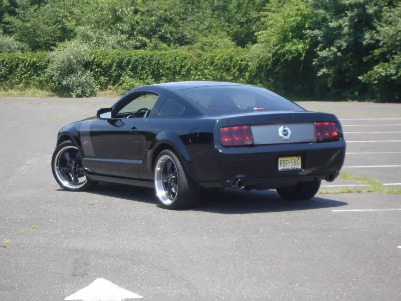

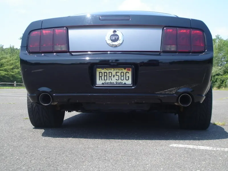

295-30-20 on 20x10's in the rear, 265-35-20 on 20x8.5's in the front. the rears are awesome, look like steamrollers, the fronts are a bit too skinny for me.
