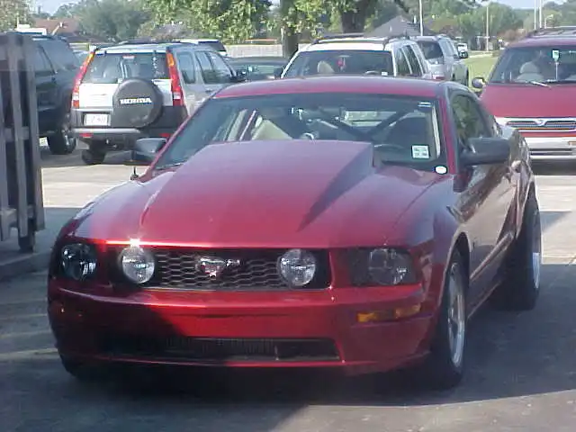

Old pic, since car has not been driven on the street for over a year. No longer street legal.
Back rim looks a bit wide for that tire
Yes...they did stick out just a tad...maybe 1/2 inch. They were M&H Racemaster DRs 325/45/17. The rear rims were 17s deep dish 10.5.
Even back then, car had very little street use, 10-15 miles per week in 25-35 speed zones, so it was OK using the M&H DRs, even on wet roads. They are a very sticky tire, much better than Nittos and the car was running low 11s with them on a smaller turbo at that time. But the stickier the tire, the less efficient at evacuating water. Would not recommend for a true all-weather highway-speed daily driver.

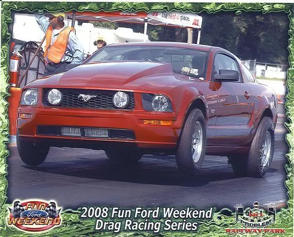

Doesn't count coz not a street application, but here's a staggered look from last year's race season> Pic taken summer 2008... engine blew up around November 08.
