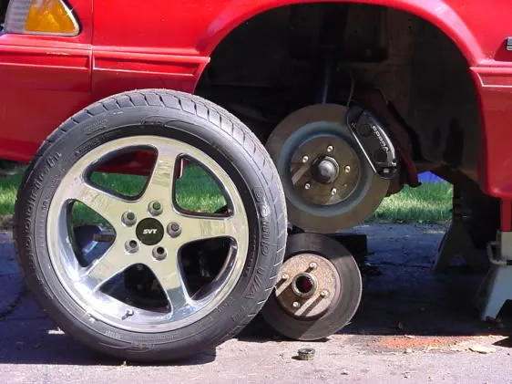

im pritty sure mine came off of a wrecked 95cobra... or a really sweet wrecked gt
