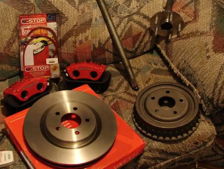

Some stuff is already starting to roll in, this is a good start.
Had to make this image super crappy since stangnet only allows 78K for images.
I also revised my list some after speaking to my buddy who is going to help. I decided just to do all of the suspension stuff now as well. It's amazing how much money this project keeps going up. I still need another 2300$ worth of stuff or so and I already have the axles, spindles, and cobra brakes.
