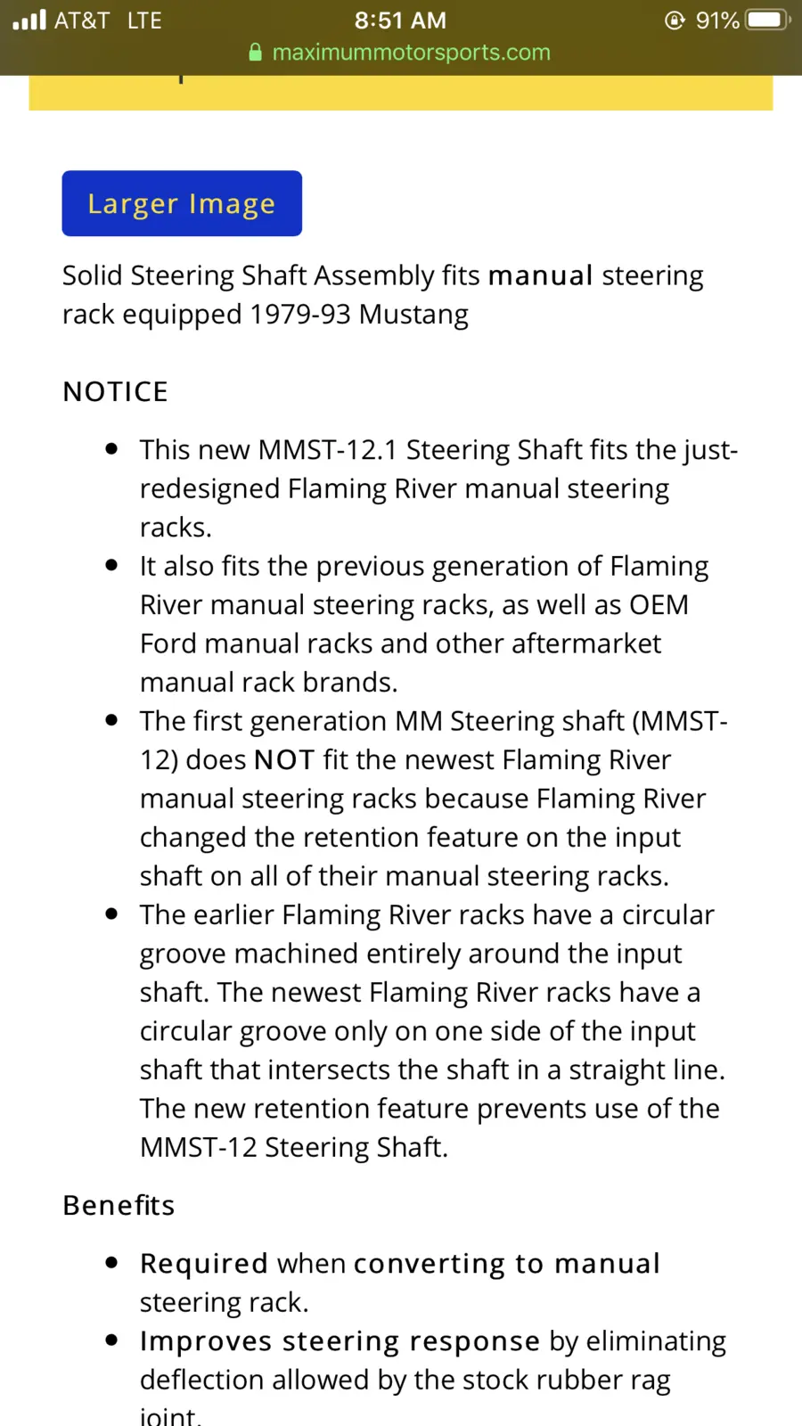

No reason to remove it . I’d fix what’s there and make your life and driving the car easier . If you insist on it , the maximum MOTORSPORTS steering shaft is light years better then the flaming river with all the set screws
Unfortunately the maximum shaft doesn’t work with the newer flaming river racks. Would be nice if they redesigned it to work.
It does . I just ordered one for a car I have to finish .
