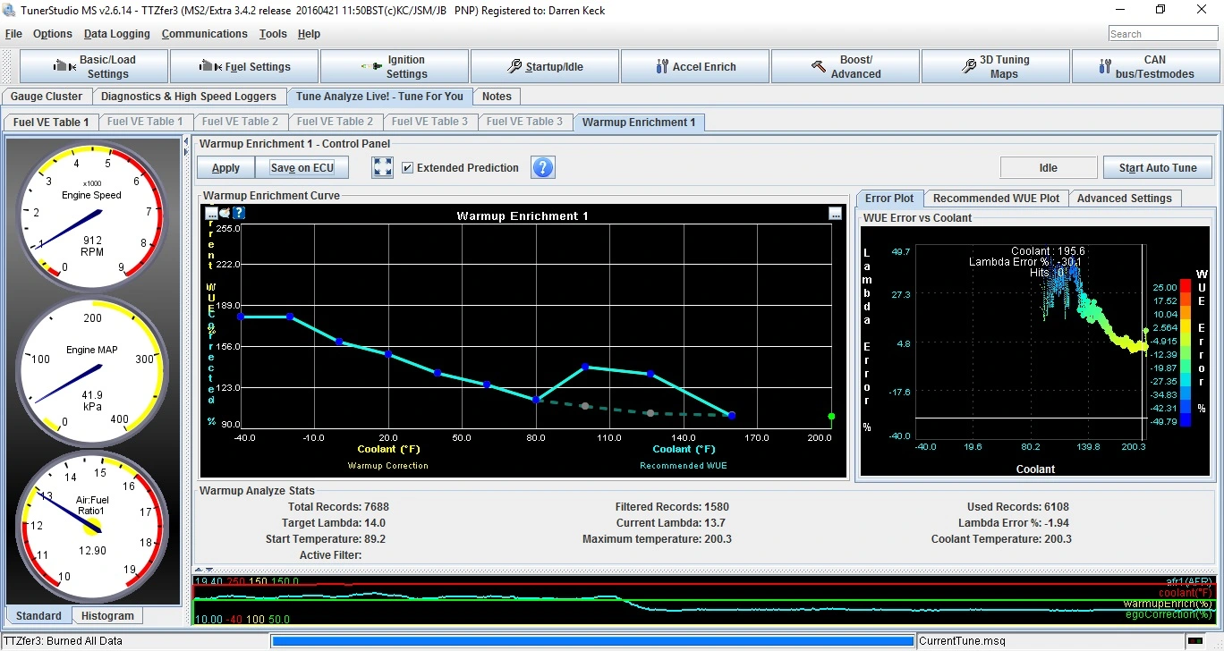

The autotune made some real changes on the WUE, and the WUE "light" now turns off finally, don't pay attention to AFR or anything I had already stopped autotuning when the fan turned on, I just wanted to share the graph changes it made. I also set the timing table to 16° on cells where it was surging, can't wait to test it and see if it reduces the surging any next time I start it after it cools off.
