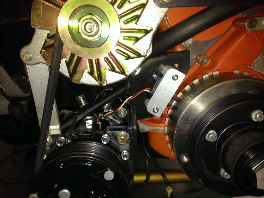

TOOLOW91 said:
So what size crank trigger wheel are you EDIS guys using ? 6 3/4 ? And what are you doing for a bracket to mount a sensor ?
Looking to do this with my fast so I can take advantage of the sequential vs being stuck bank to bank .
Granted this setup is on the Monster, but the Balancer is 5.0. The trigger wheel is the smaller size, mounted (custom drilled) to the back side so that it wont interfere w/ the other pulleys on the front. The VR sensor is generic (probably) from some 4.6 Ford application.
Thanks bud

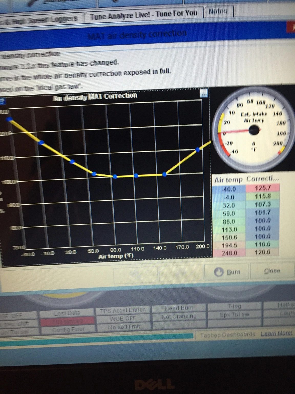

I have a quick question about the MAT air density correction table. My table is the one pictured if I'm reading this correctly would that mean at 194 degree temps it's adding 10% more fuel?
Sent from my iPhone using Tapatalk
Yes, although I'm not sure why you would change the table at all... The base table works off the laws of physics lol... messing with it affects the fueling drastically. the base table ensures that the temp doesn't affect the AFR and the same rpm*kpa value delivers the same fuel no matter the mat temp. just a FWIW...
for temp fail safe I just pull butt loads of timing.

I had the car Dyno tuned so I didn't make those changes and yes the runner did it as a fail safe since the car is boosted but the problem I have it I regularly see intake temps above 190 so everytime I'm in boost my afr drops to around 10.4
Simple way to fix it. Post your tune up and I will look it over, if you like I will upload a base mat correction table to the tune. then I will set up the mat temp retard table fairly aggressive so that it pulls enough timing to affect the AFR. I am boosted as well this is how I do it.
You just need to save your current tune use the "save as" and give it a name like...'Dyno tune' then save the one I give you under something else so you can tell them apart. when you go to upload the one I adjust it will show you a difference report.
for instance at 194* you have 30% more fuel than you should..... just sayin.
