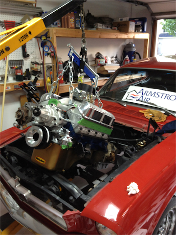

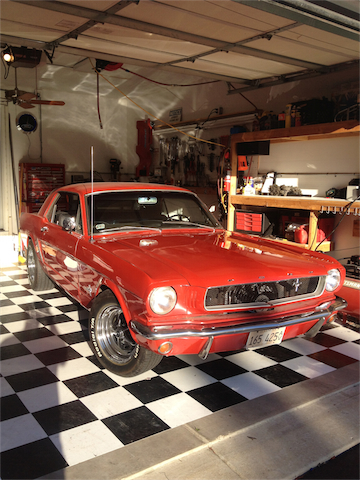

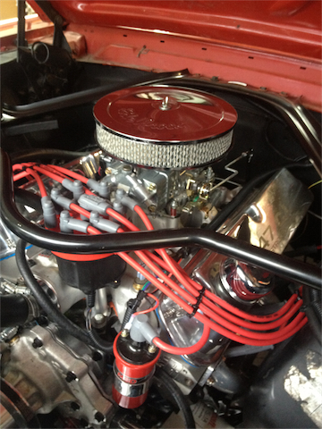

Well its finally done.
it was a long expensive road. an I6 to v8 conversion is not for everyone. There were soooo many times I wanted to just throw a match in it. But in the end it worked out great. I am driving the car now, and enjoying it with my daughter, which is what the whole project is about. Oh and it dyno'd out at 375 horsepower at the rear wheels, which makes it fun for me.

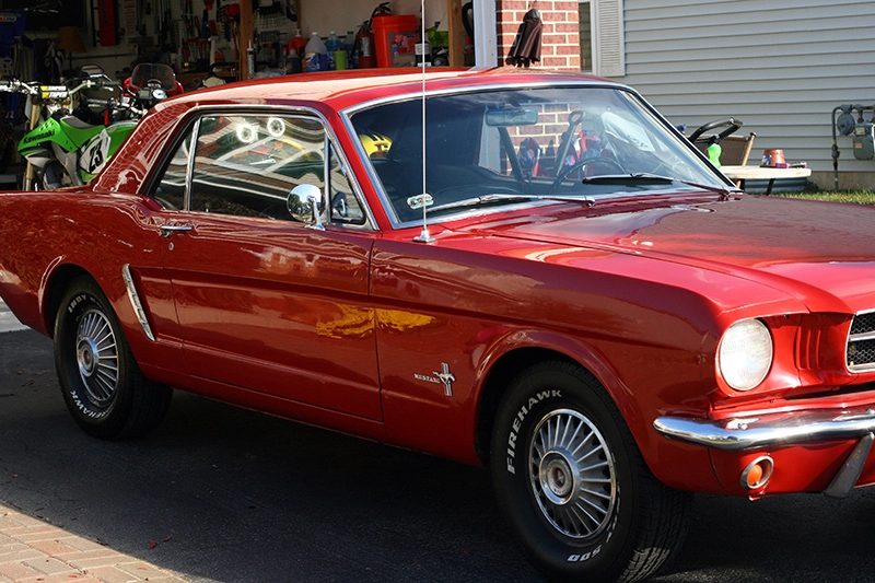

How it began life:
After the transformation:
Yes, Body and paint are next, but its going to be a little bit. she looks good now, but she's not perfect. But being an Arizona car, she is in great shape.
