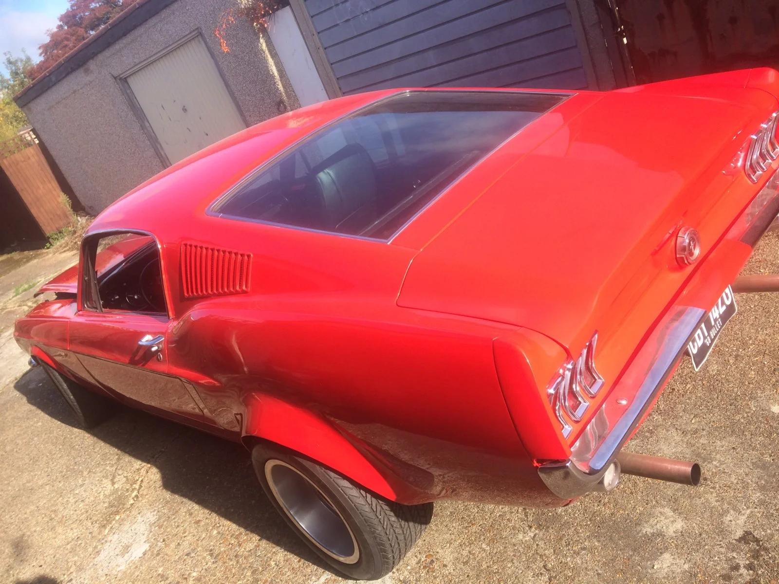

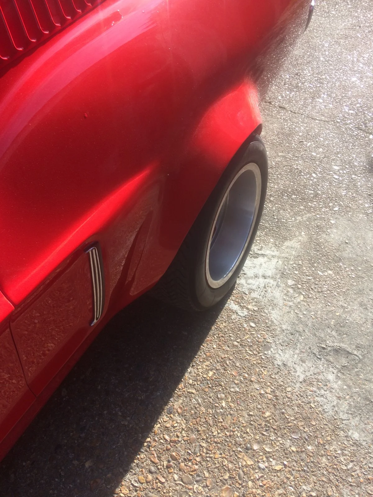

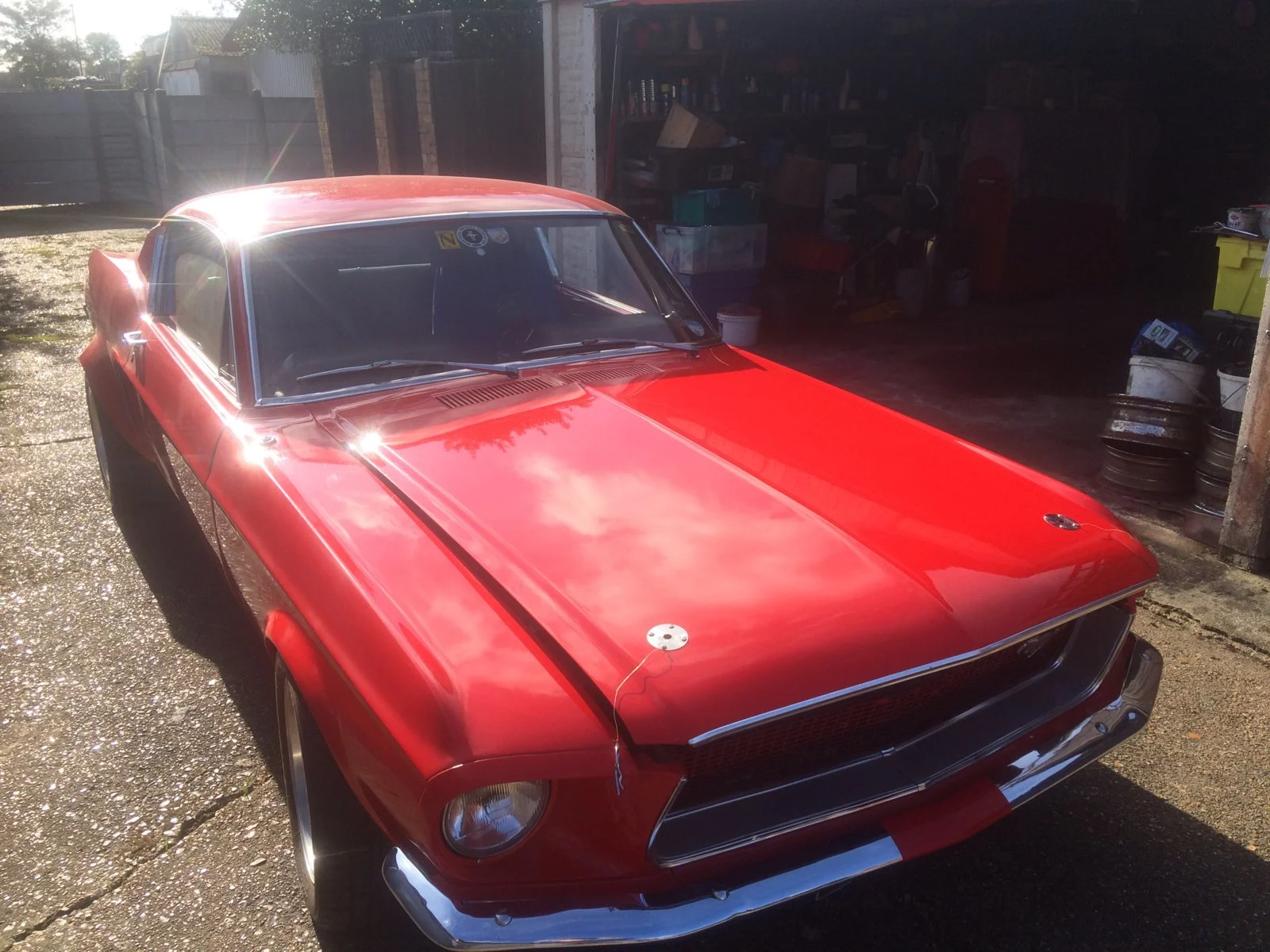

I bought a Mustang 6 pot 20 years ago, since then i have sourced all the parts (new/second hand) and transformed it into a 289cui v8, 4 speed top loader, and a 9" Locker axle.69/70 front axle with discs and servo, drums on the rear.Bodywork has arches widened to accept 8"x15" Wolferace Ally Wheels on the front and 10"x 15" on the rear.It has been lowered and stiffened suspension.All steering changed, now with Power steering as well.Interior now has 69/70 High backed seats Re- upholstered in Black. Was resprayed 10 years ago, and is now Porche Guardsman's Red.All work carried out by myself (accept the Body work/spraying)

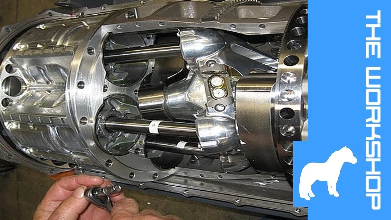

If you wanted something REALLY unique and super smooth, you could go for a Duke rotary engine:
3 "cylinders"(or rather 3 combustion chambers) and 5 pistons in a very compact package and so smooth at 6000RPM it doesn't disturb a glass of water sitting on top of it. Australian company makes them, but I would love to get my hands on one...reminds me of a revolver...probably where they got the inspiration.
