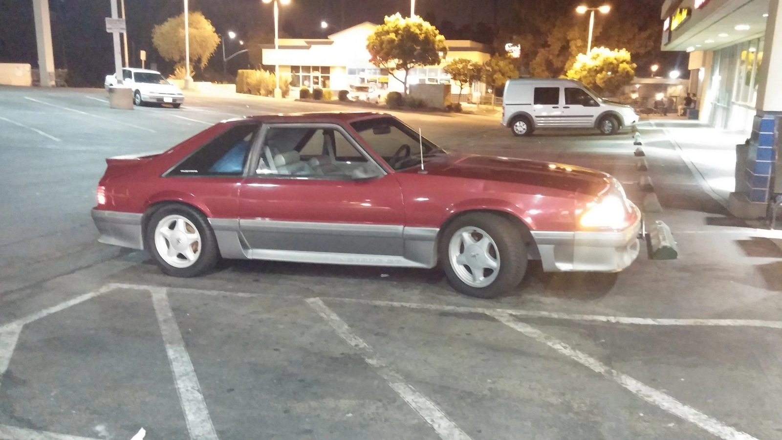

Hello i was wondering what i can do to make my fox faster i dont want a track car . dont have money for a new engine i have a stock 302 v8 the only upgrades i have is a summit racing intake, msd coil, and hedman headers please help​
