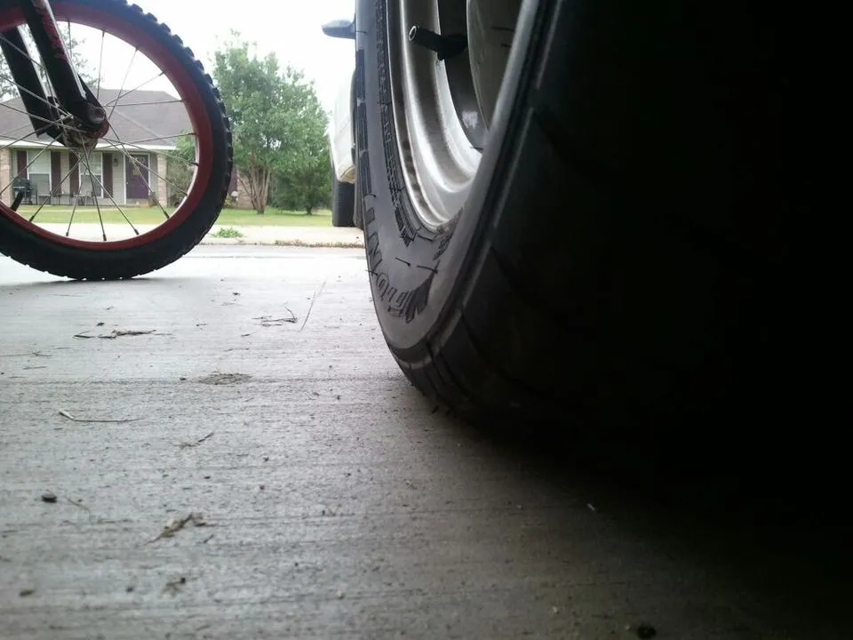

I disagree. Looking at the picture, it is pretty much what I am making it out to be. You have a tire almost three inches wider than your wheel. If you cannot imagine it being an issue, why did you stop at 275's? Why not 315's?
Is there a point where you think there might be a potential safety issue?
Well of course. But a 275 on an 8" rim is not to that point..
My question is where you would draw the line?
I look at your picture and see a tire clearly too wide for the wheel. We all know you don't. What nobody knows is what you think IS too wide.
I don't use my car for drag racing. I could see being comfortable with your combo if that's all I did with my car. I have a feeling our difference of opinion stems from the way we use our cars. I like my car when it sticks to the road around a corner with the gas matted. If that's not something you enjoy then I can see being fine with an iffy wheel-tire combo.
I guess I'd draw the line at 275s. I'll admit they're on the verge, but I think they look great and I know they handle fine.

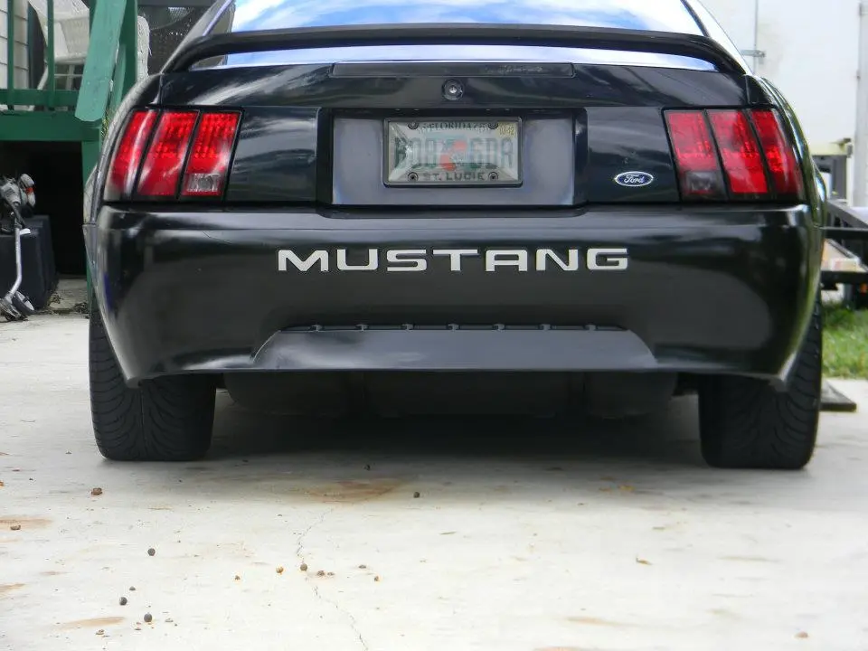

Ive seen 295/45/17 Mickey thompson radials on 17x8 rims, i have a 275/60 on a 15x8, whats the difference its still a 275 on a 8 inch rim.....?
To op 275/40/17 would look great on stock wheels i used to run them on my starfish wheels they looked great
Heres a pic
