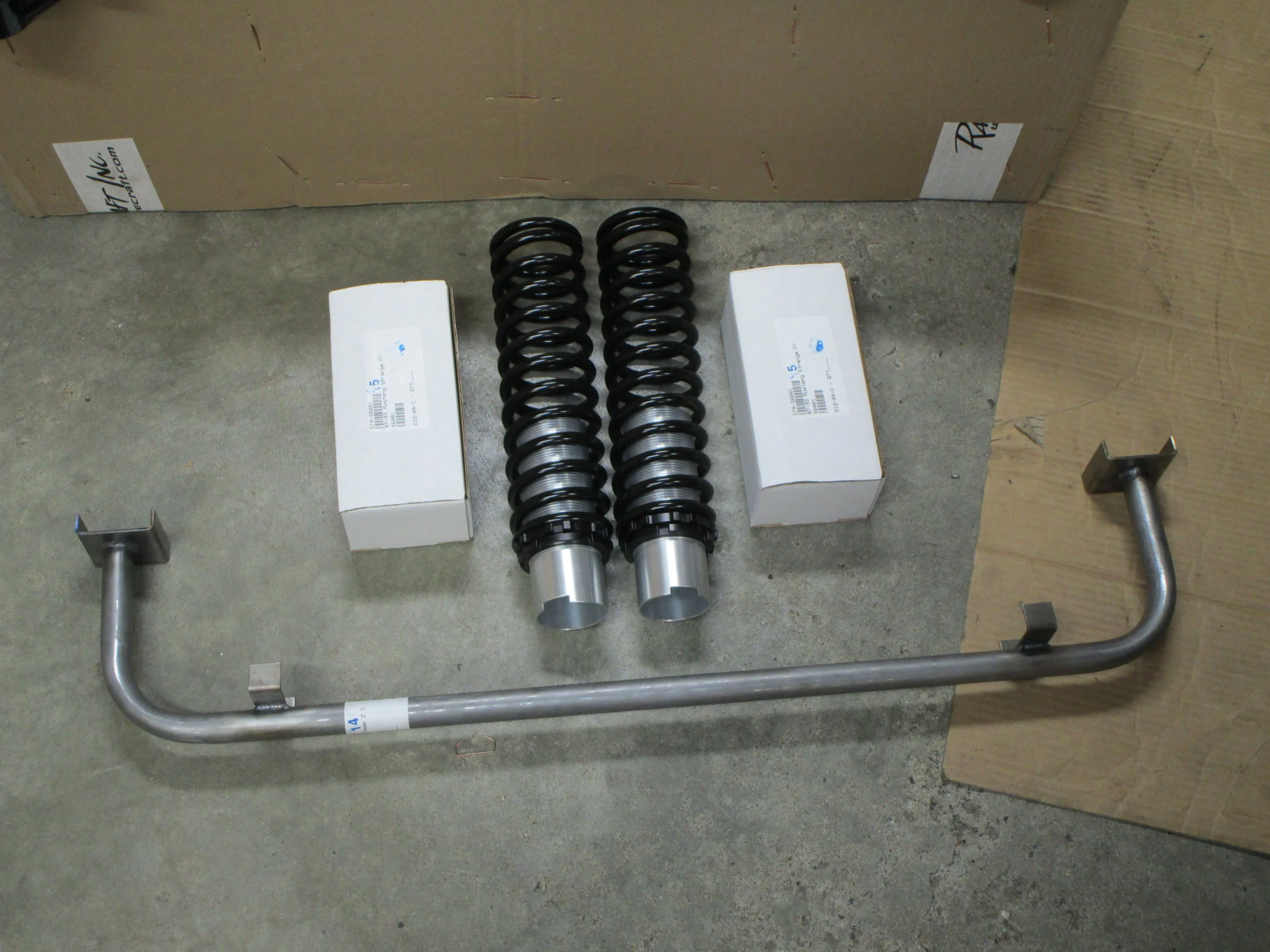

So this came today
The rest of my black friday weekend loot
And as far as I got yesterday. Today is just too damn cold for my little heater to keep up (high of 30 ) so this is how it will sit until at least tuesday.

Very nice, I like that k-member a lot.

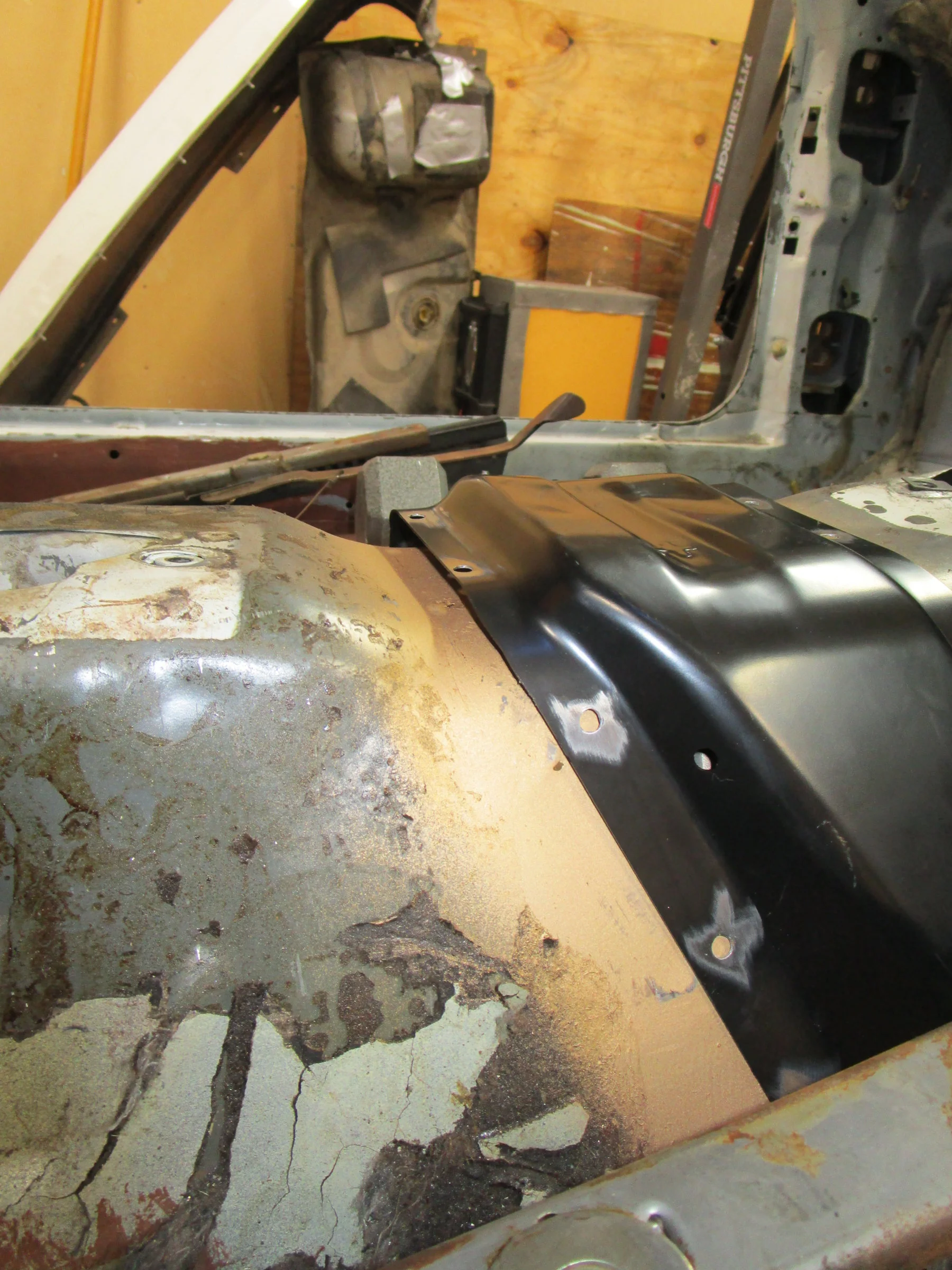

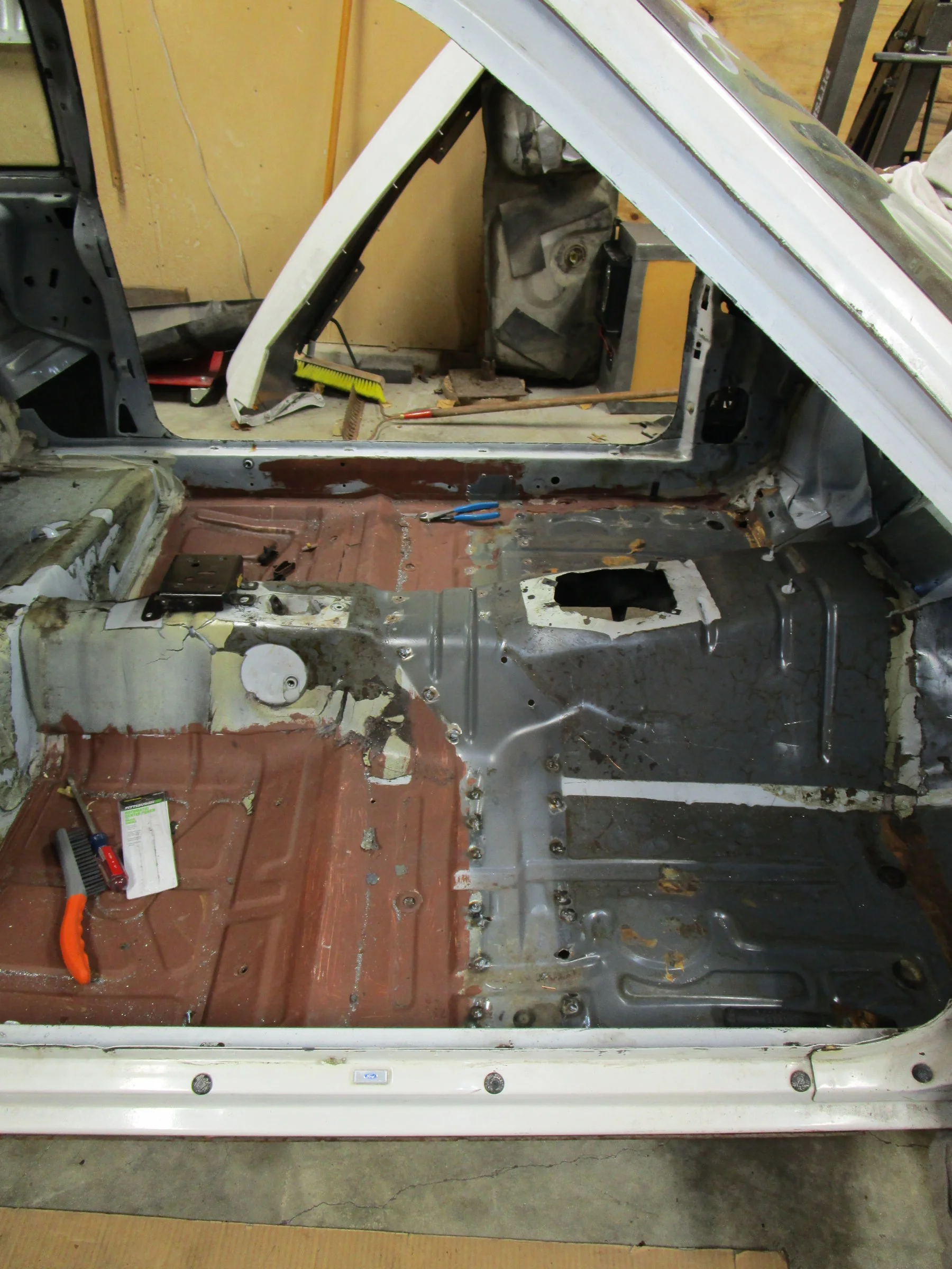

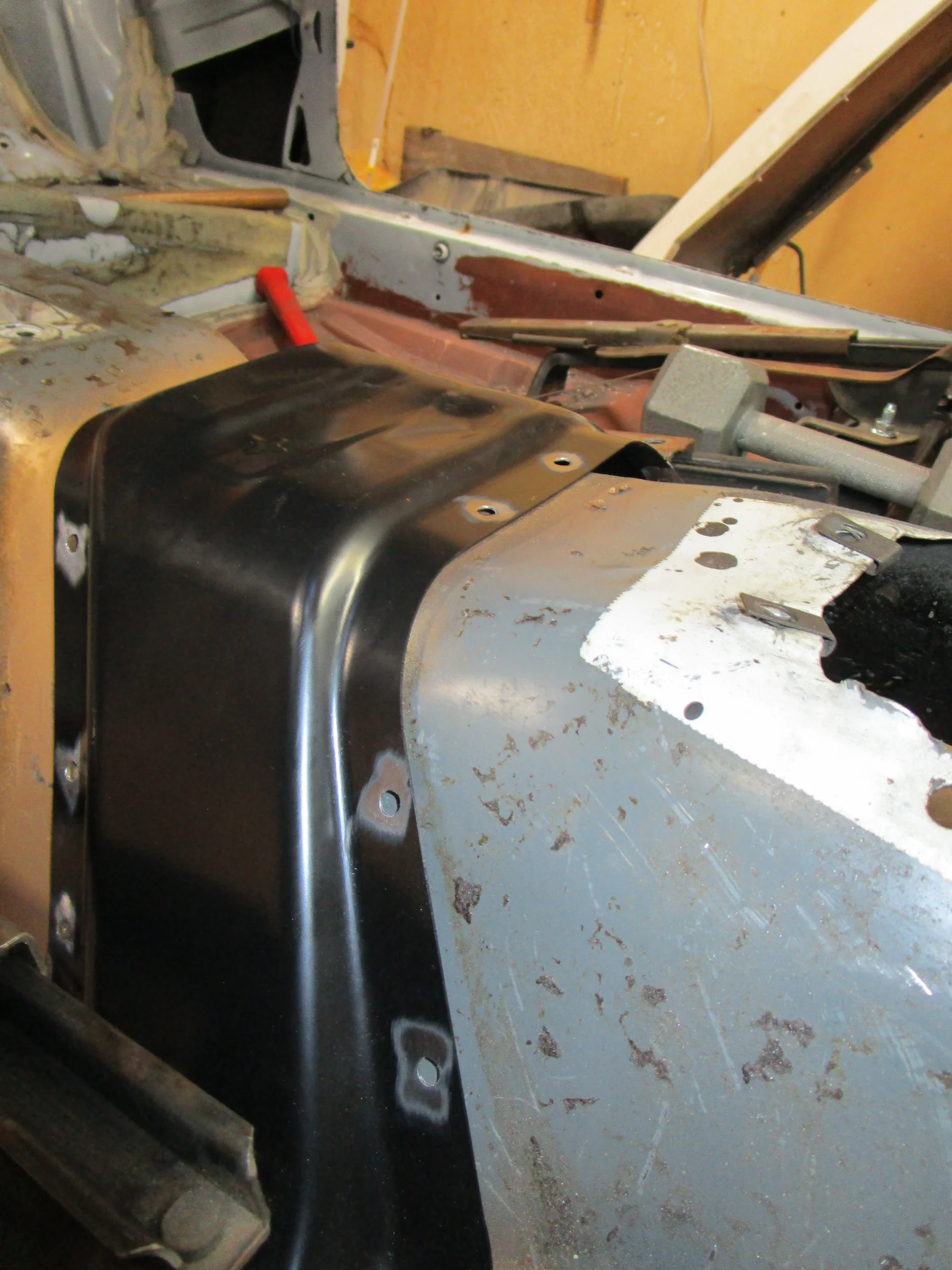

Finally got the garage warm enough (despite it being 18F outside ) to actually do some work this morning
Got some starter holes drilled in the seat brace to plug weld through, bolted on the seat tracks to make sure it was in the right spot before i welded it in, and well.....
you guessed it, the fit is sh1t
without the seat tracks, and sitting back about an inch, the big gap at the top of the trans hump was virtually non existent (its about 1/4 - 3/8" right now after a couple whacks with a deadblow to maybe try to spread it out). going by where the old spot welds are, it looks like the two horizontal legs are right about where it needs to be, but the middle hump (and the verticals) need to go back about 1/2 - 3/4".
not exactly sure how to go about fixing this so if anybody has any ideas???

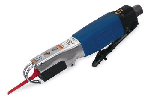

I'm sure Dave or one of the others will have a better idea,but here's mine:
And then:
Reactions: A5literMan
And then:

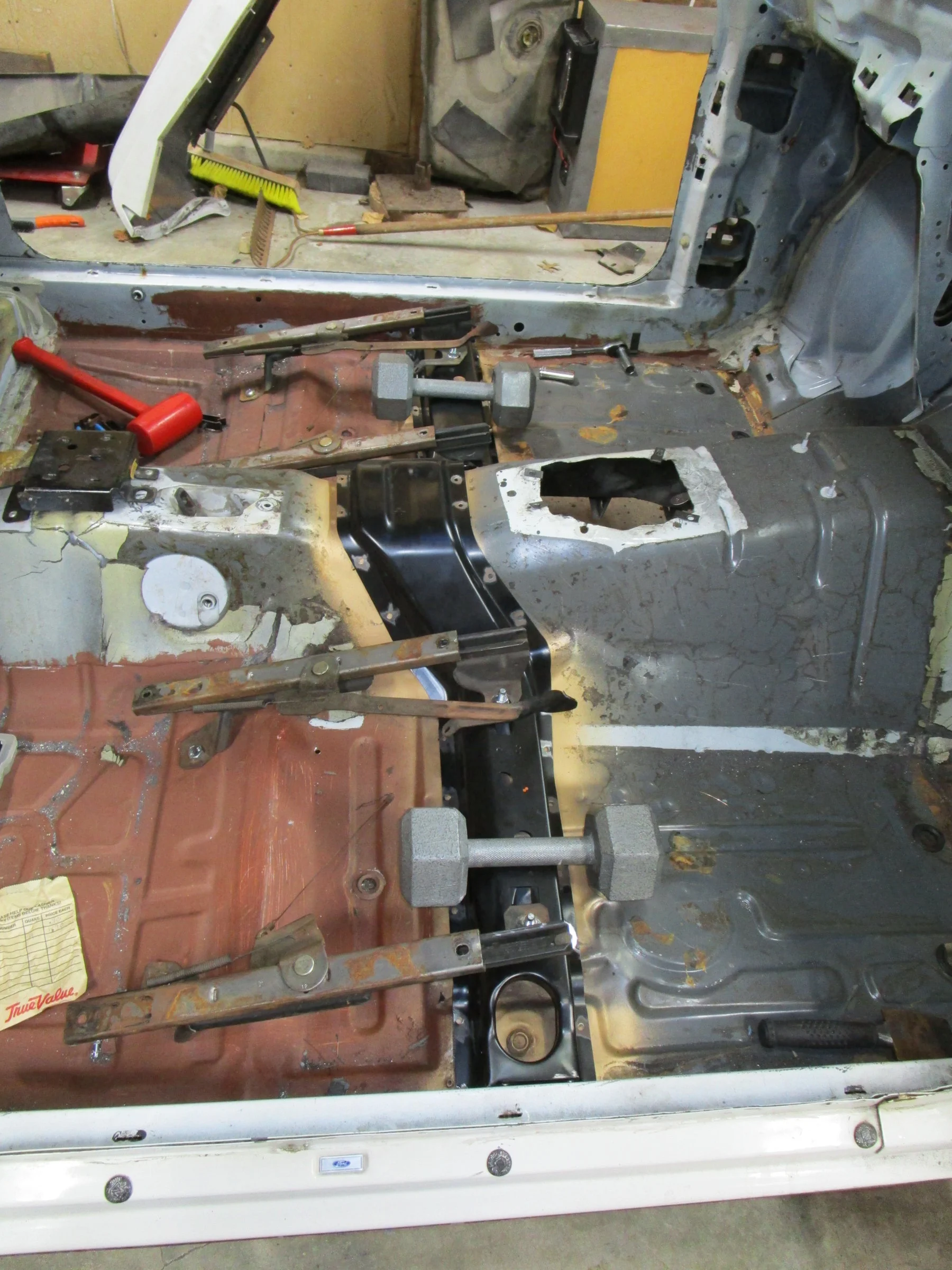

That was about my 2nd idea, was trying to avoid doing all that though.
Idea 1 was just to stand on it a bit out of the car, seemed to have worked, lays in there a bunch better but still not perfect. Got the gap at the top down to less than an 1/8 with a 20lb weight on it.

BFH?

A5literMan said:
BFH?
Looks like that with a bit of BFF (big friggin foot, not the other) is working. Half welded in, warming up for a few minutes then back to it.
And then:
Honestly, i have to agree with Chris here.
Aftermarket parts can be real sht at times. What a pita, i hope you get it to fit however you decide to proceed.
