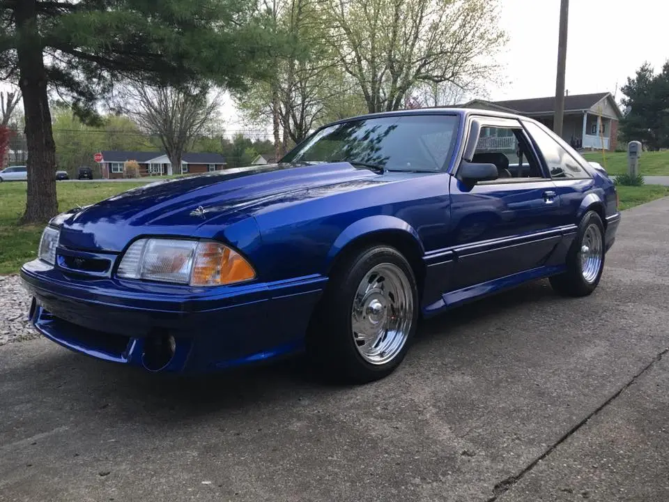

this popped up on bookface last night, it's about exactly what i'm looking for, cant tell if its got any flake or not (kinda looks not), also not sure if its an oem color or not

Same name almost, you're seeing Atlantic Blue Metallic (even though it's a pearl that makes the sparkle) on that car. It's roughly that tone, but solid.
The fleet blue color I used to see on a lot of E150-350 vans. I thinks Sears vans were that color for a while.
You really limit yourself on it being a solid color, there aren't many mainstream ford solid colors beyond Grabber Blue. I understand though. I think to find an attractive solid blue you might want to step outside ford's limited world.
Solid blues really haven't had any popularity in the past decade or two. What you might want to do is go to one of the local automotive paint stores and look through their catalogs and chip books for the paint system they sell.

Looks like Deep Impact Blue to me, google Save a Fox project. Looks fairly close

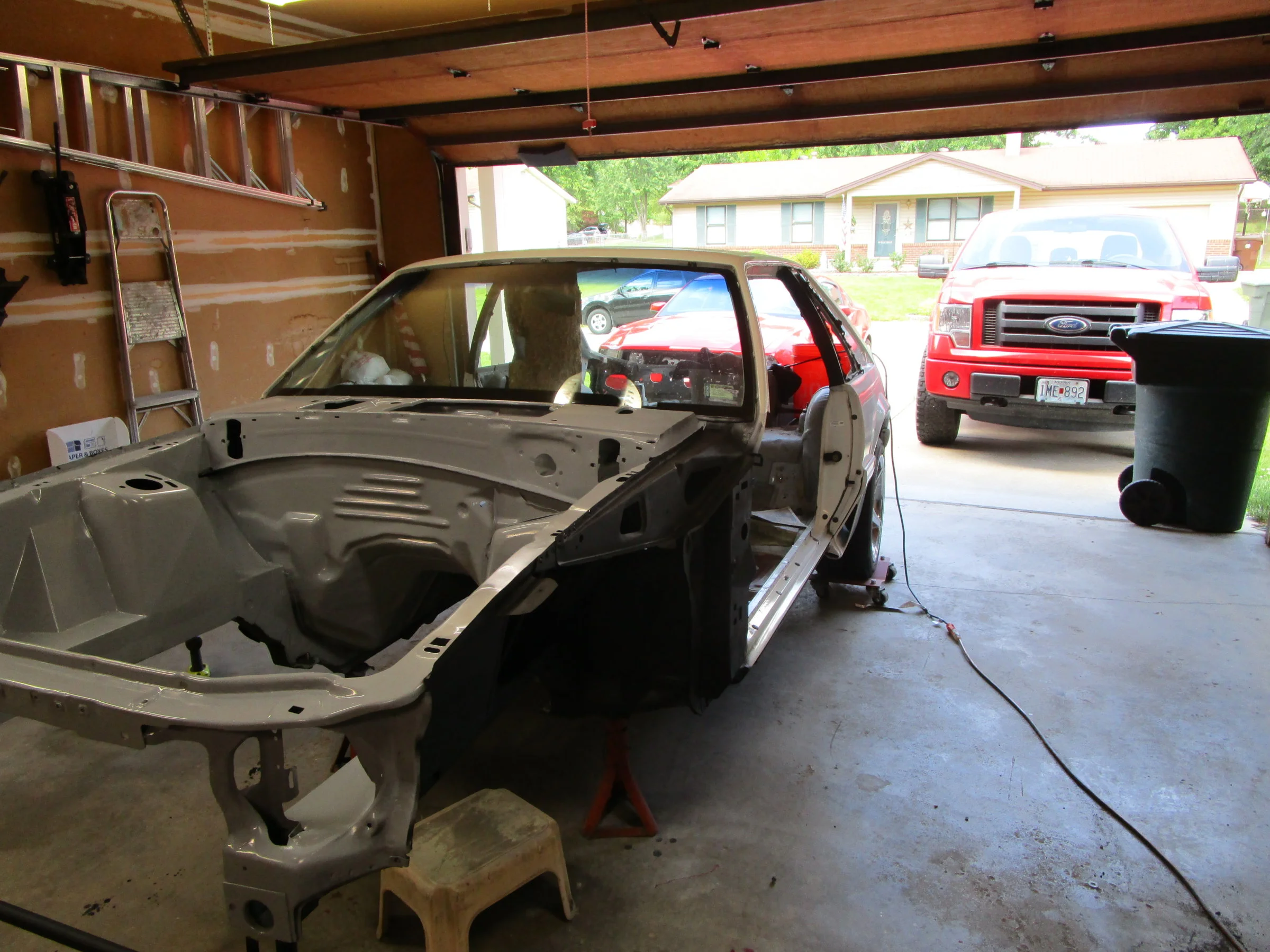

got about 99% of the filler work done last week, just a few pinholes left to deal with. of course it won't stop raining around here until saturday, so i wont be able to get a fresh coat of epoxy on it to seal it up until at least monday afternoon/evening. after that, i dunno :shrug: gotta rebuild the bank account after paying taxes and buying the primer/guns/supplies to get here. i'll probably get the front suspension on sometime next week, then maybe start getting doors/fenders disassembled/stripped/repaired/epoxied while i save up some $$$$.

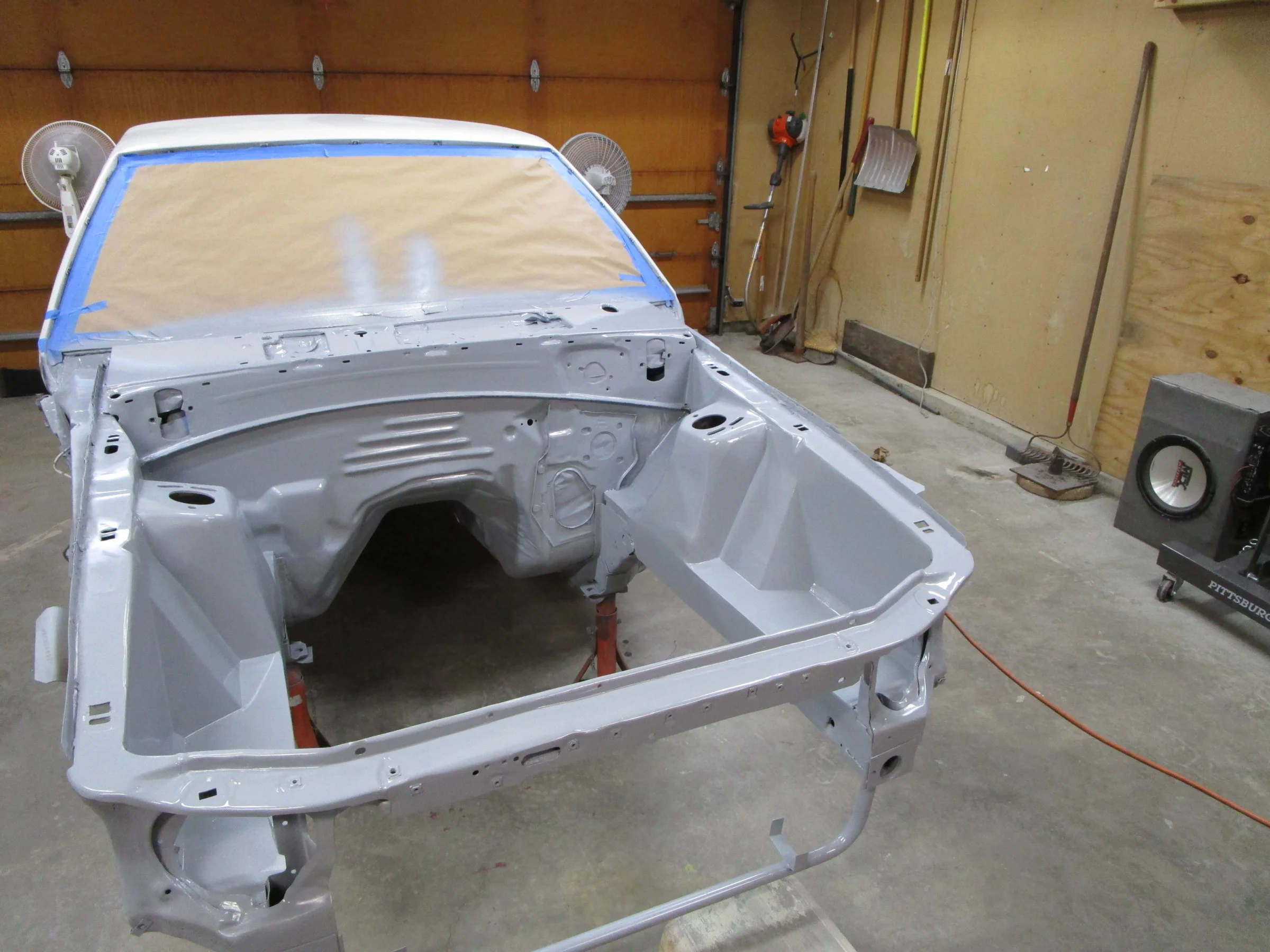

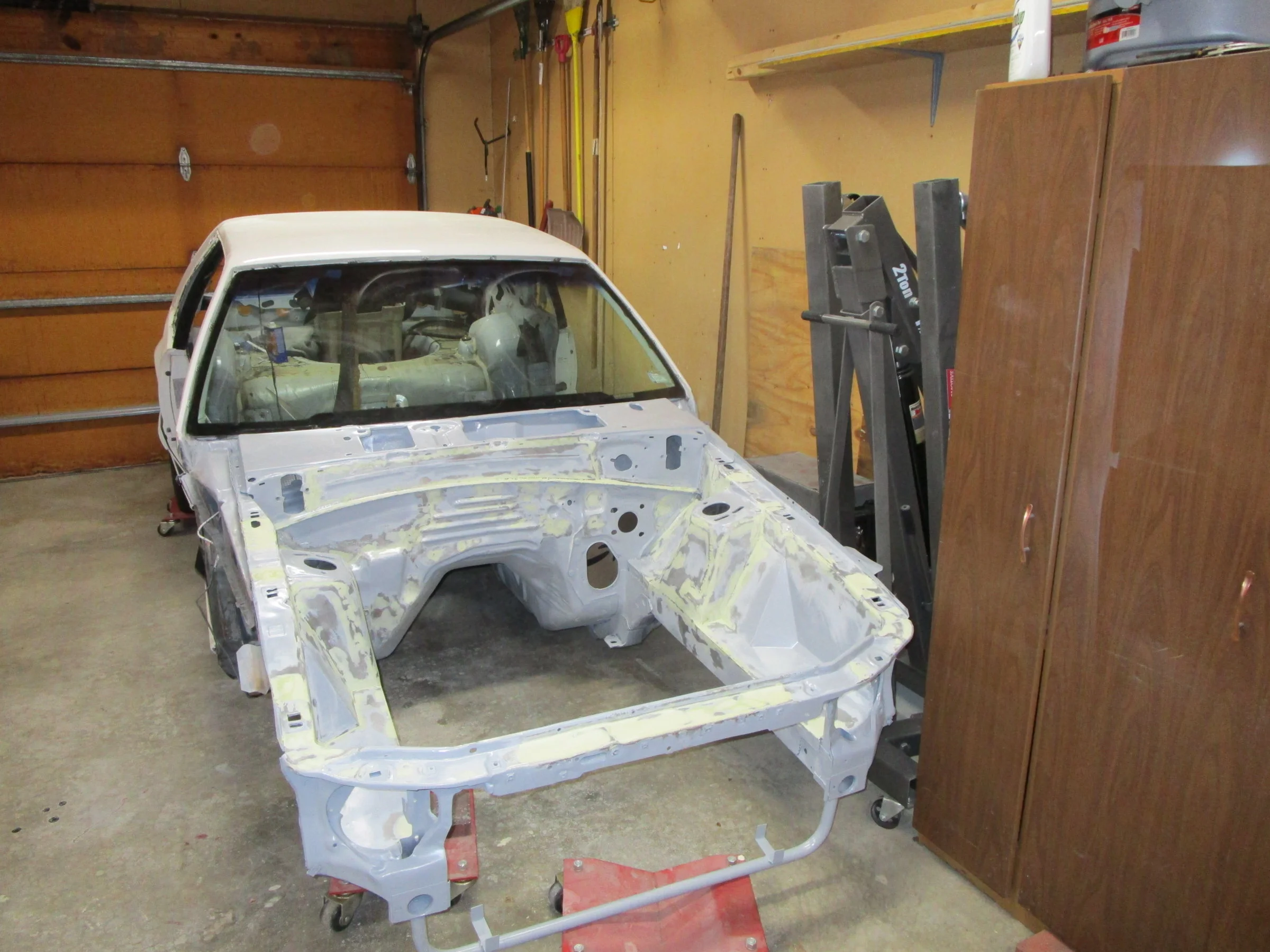

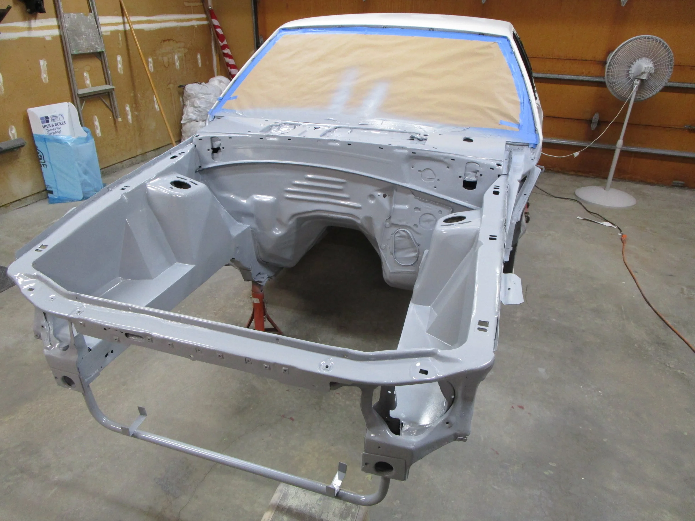

I know, it's been a month since the last update. Got unhappy with some (a lot actually) of the bodywork (mostly cause i stopped at 80 grit when i should have went to 180), so went back and fixed it. There's another solid 80+ hours of filling, sanding, and refilling and re-sanding to get to this point (most of that is due to sloppiness on my part, and a lack of motivation due to lack of visible progress).
Anyway, finally got all the filler and old epoxy blocked down to 180 Wednesday night, cleaned and hosed out the garage after work yesterday, and then sprayed 2 more coats of epoxy this morning and it looks a :poo:ton better.
Now the question (which I asked a similar question in the 101 thread) is, do I go ahead and throw on 3-4 coats of surfacer on Monday/Tuesday while I'm in my 7-day recoat window and then let that sit until I've got all the big pieces test fit, or leave it as is and when I'm ready for it just scuff the epoxy down to 180 again then surfacer? I bought a gallon the other day just so i would have it when the time came, but I'm kinda leaning towards option 2.

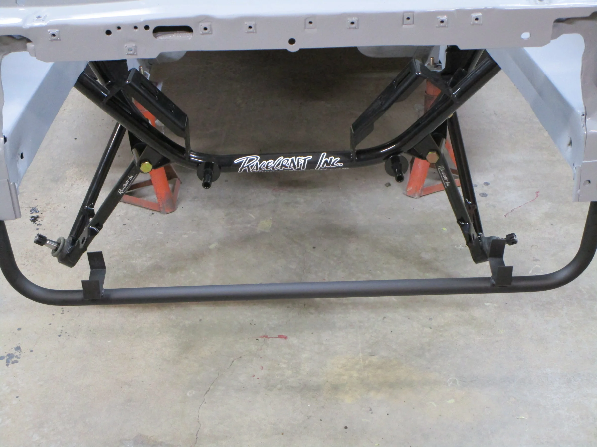

Finally, I'm putting parts back on the car!!! The past year has seemingly been nothing but welding, grinding, and sanding, feels awesome to finally be doing some bolting (even if all it is, is test fitting). Of course, nothing on this car is without setbacks.

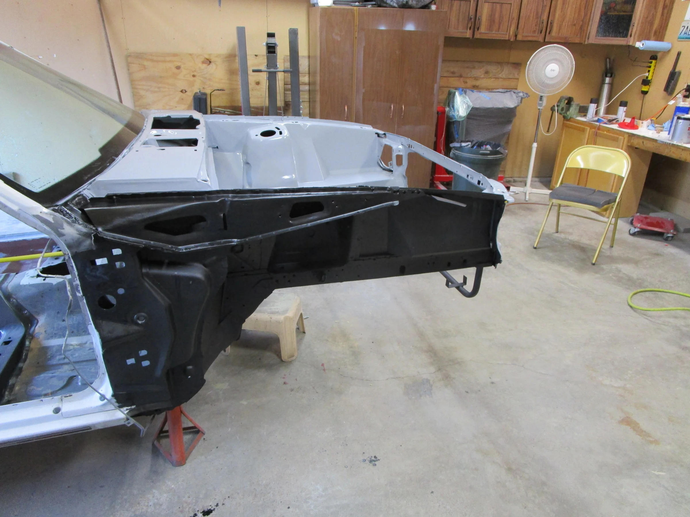

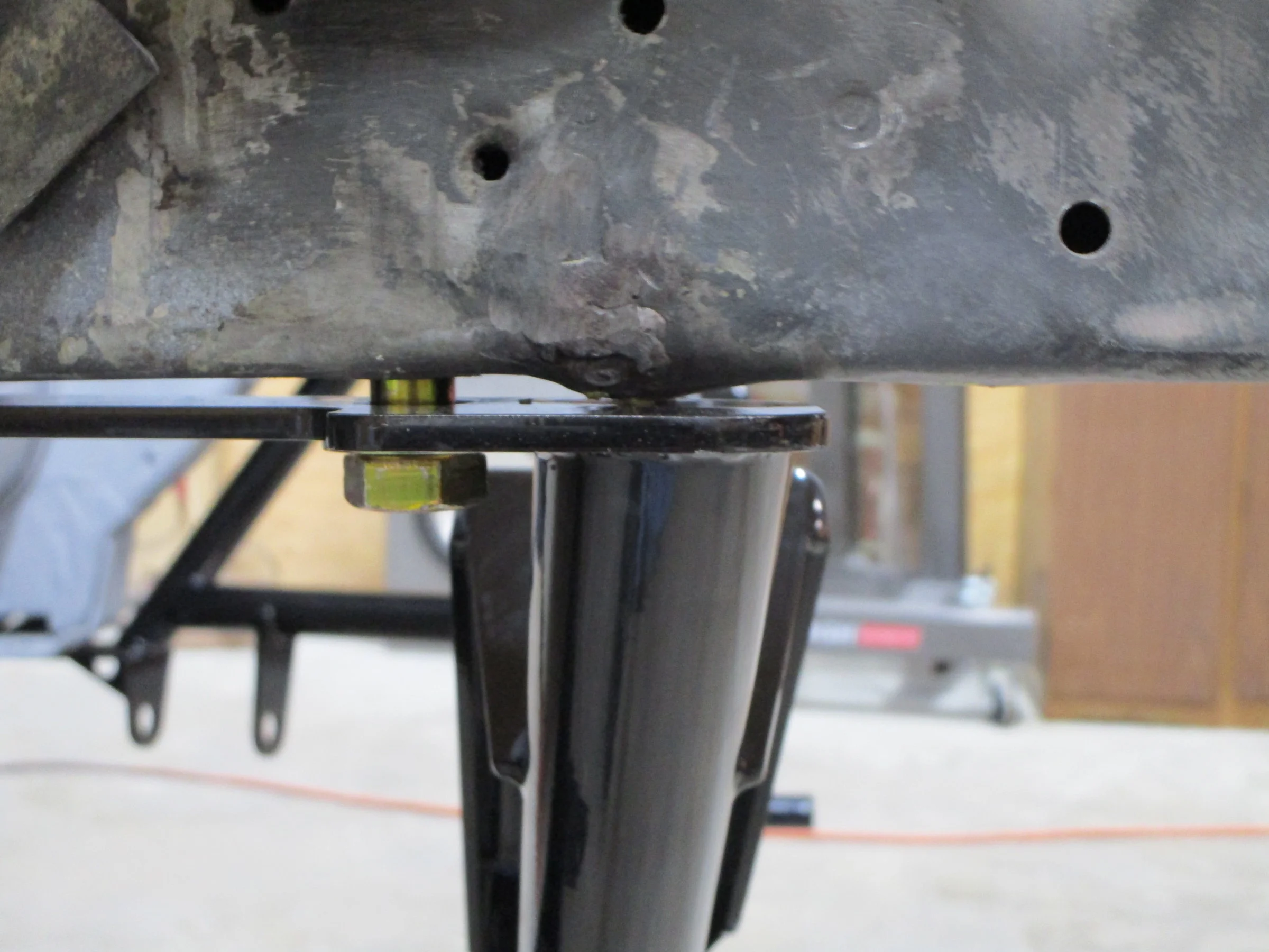

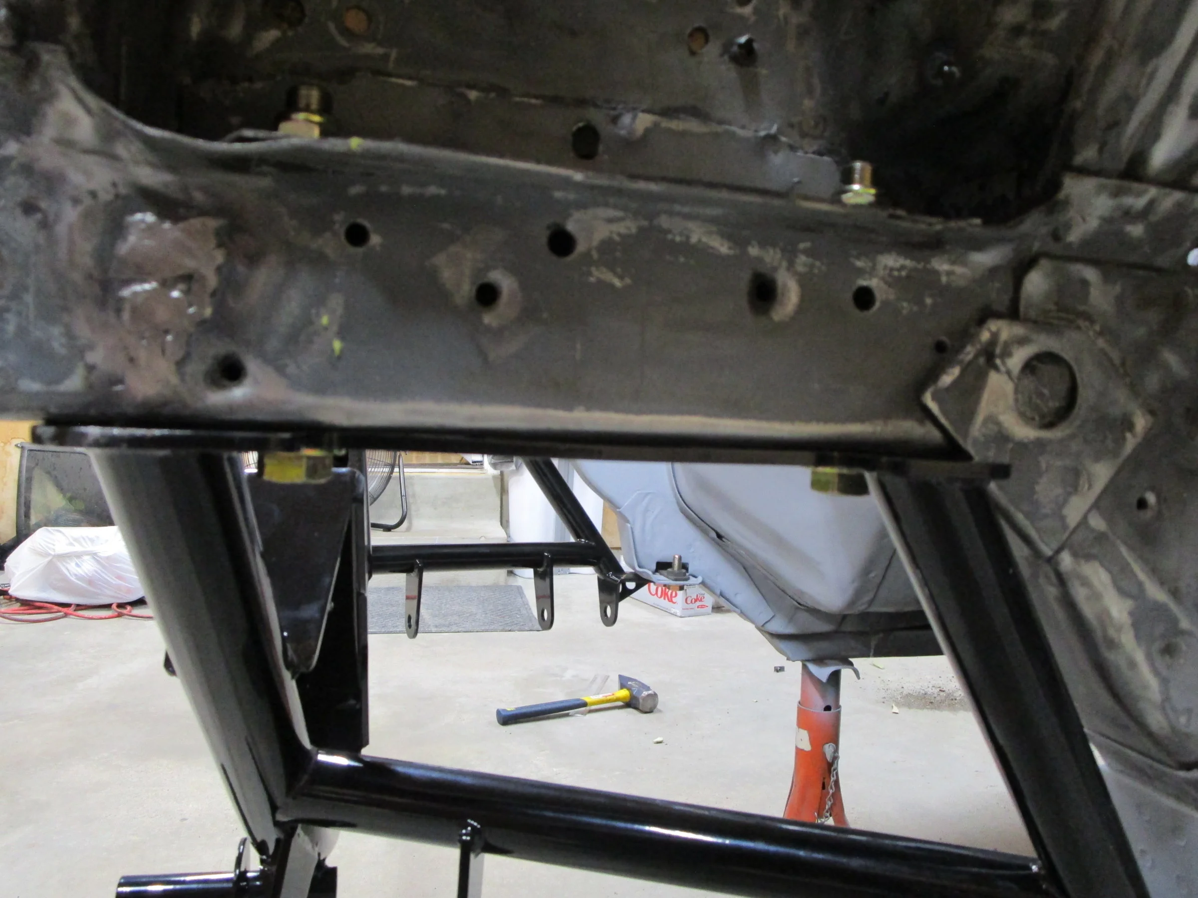

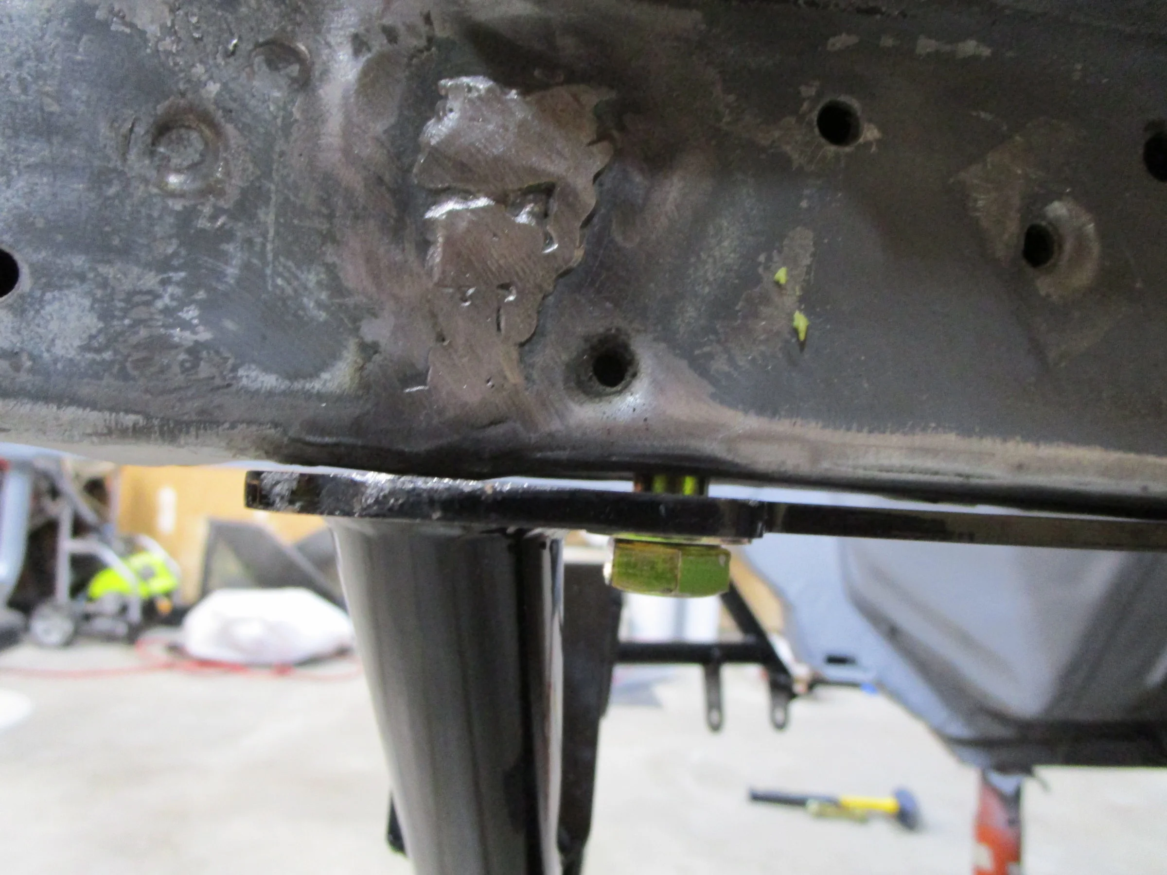

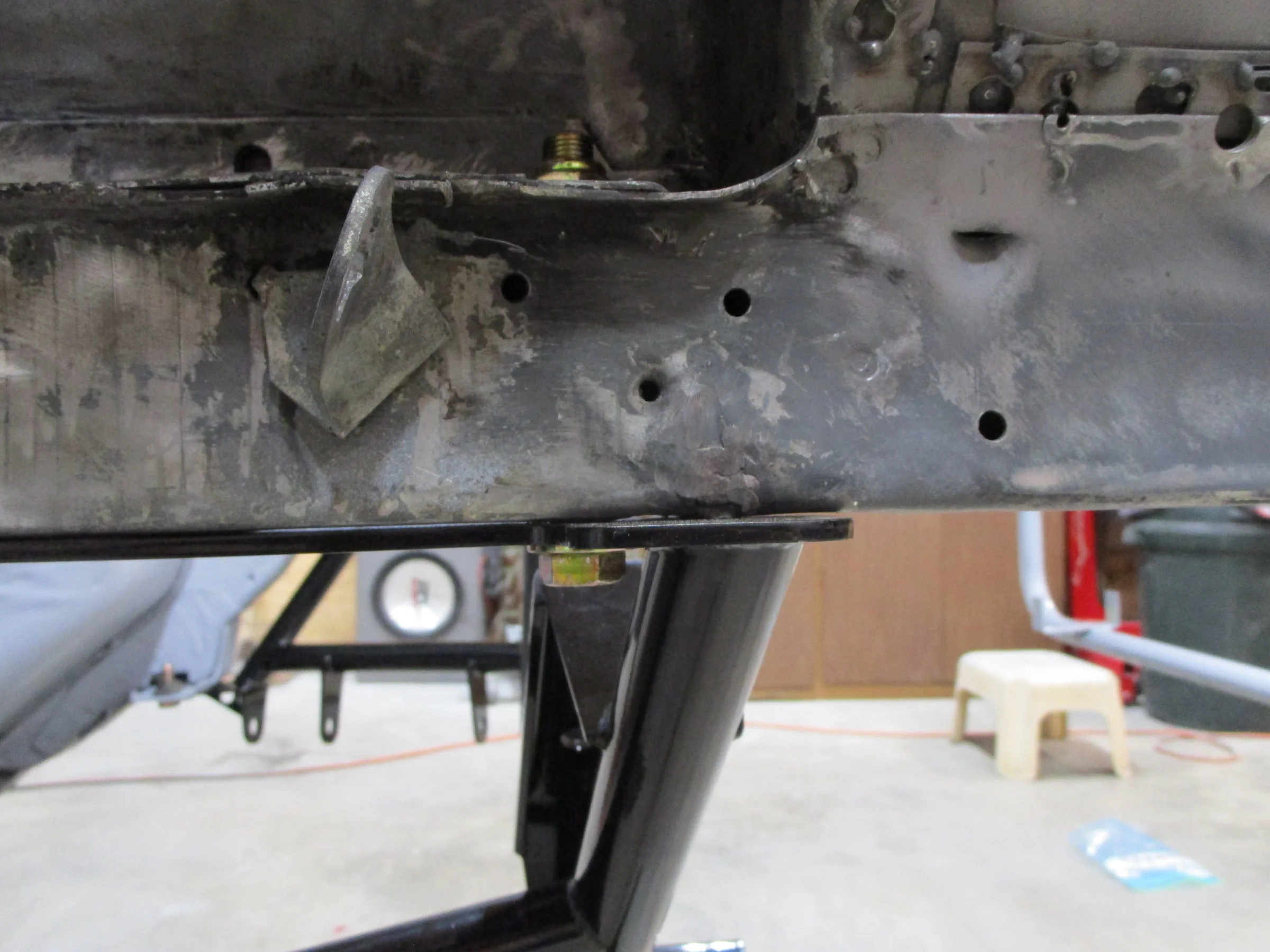

Setback #1: Remember how I've mentioned this car has been hit in the front? Well, that reared it's ugly head at about 6:00 last night trying to install the new K,
You can see where the frame buckled/kinked right in front of the stock K and bunched up the metal. The frame was pulled (maybe not enough?) at the time and there's been no "weirdness" with the way the car drives, so I'm guessing this is where the metal was just stretched out and the shop doing the work just didn't care. Also note the bit of weld there (not mine).
Here's the drivers side, not kinked as bad but more weld (ignore the driplet of body filler that fell through the strut tower)
After a couple test taps with the bfh, I thought for sure I was going to have cut some out of the kink and weld it back together, but a bit more oomph with the hammer gave me this:
As an added benefit, all this garbage fell out of the hole between the k-member bolt holes on the pass side, apparently one little rock plugged it up :shrug:

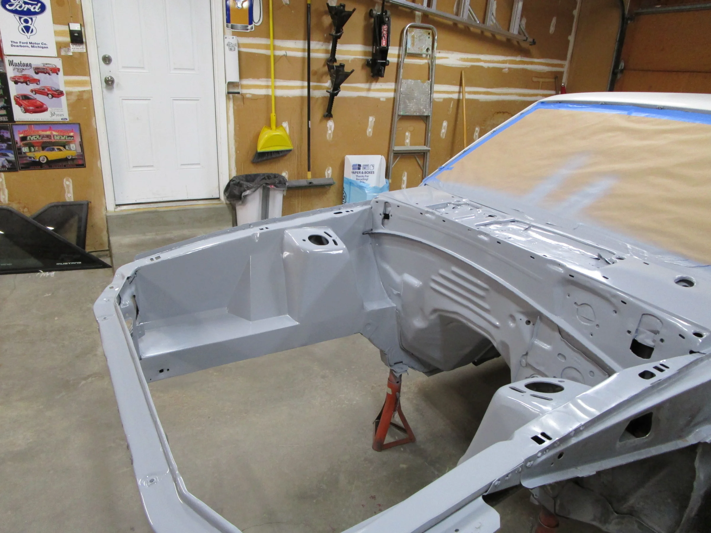

Now this morning, after 2 cans of cheap spray bombs, then a trip to wally world for two more, the inner fenders are all one color and no bare surface-rusting spots.
K and control arms are in (not all the way tight yet, needs grease and it's all coming back apart anyway):

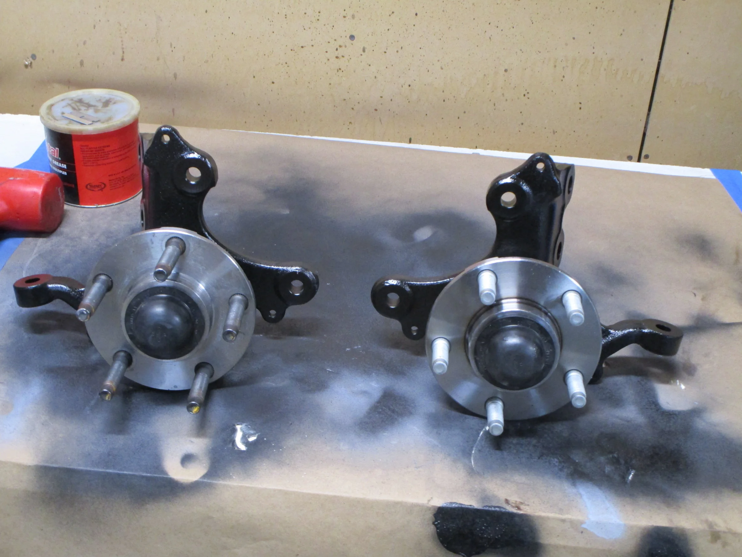

Then after a tearing apart the spindles, going and getting yet another new hub for the passenger side, then another store trip for some degreaser and a container (which I thought I had), then somewhere between 1-2 hours of scrubbing and soaking, and then another store trip for some gloss black engine enamel (again, thought I had more than I actually did), here's the spindles ready to go on.
I'll get the rest of suspension together tomorrow after cutting grass.

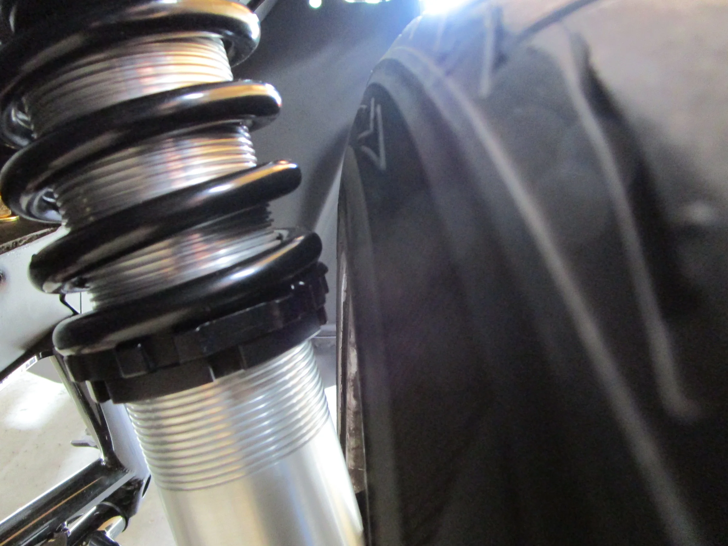

Strange coilovers are finally on. 12" 150lb springs. Reusing my existing Strange shocks and MM cc's. Threw on the GT rotors and the 17x9 245/45 wheels that I've had forever, was a bit concerned they wouldn't fit, but there's just enough clearance.

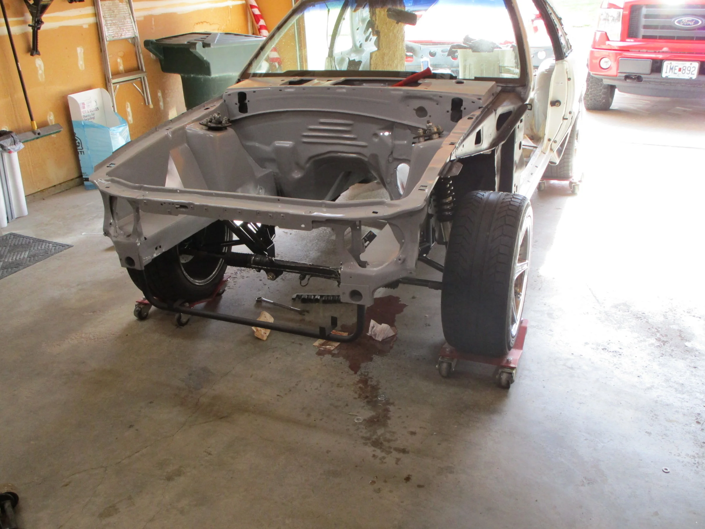

Finally on all four again. Ignore the blood puddle, even though I drained the rack before I put it on, as soon as you push on the rod ends and it "steers" it just pukes fluid :rolleyes: who knew?

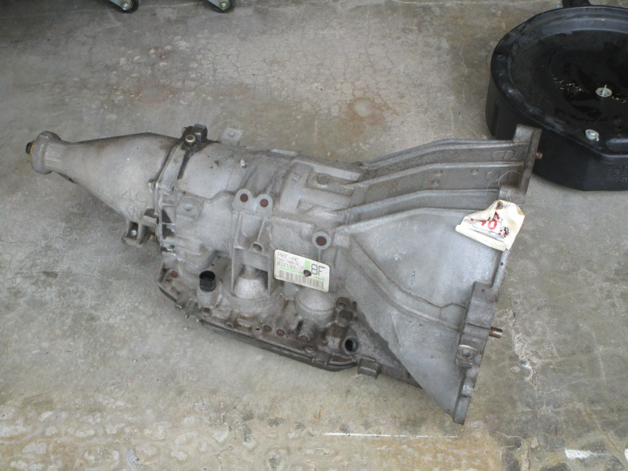

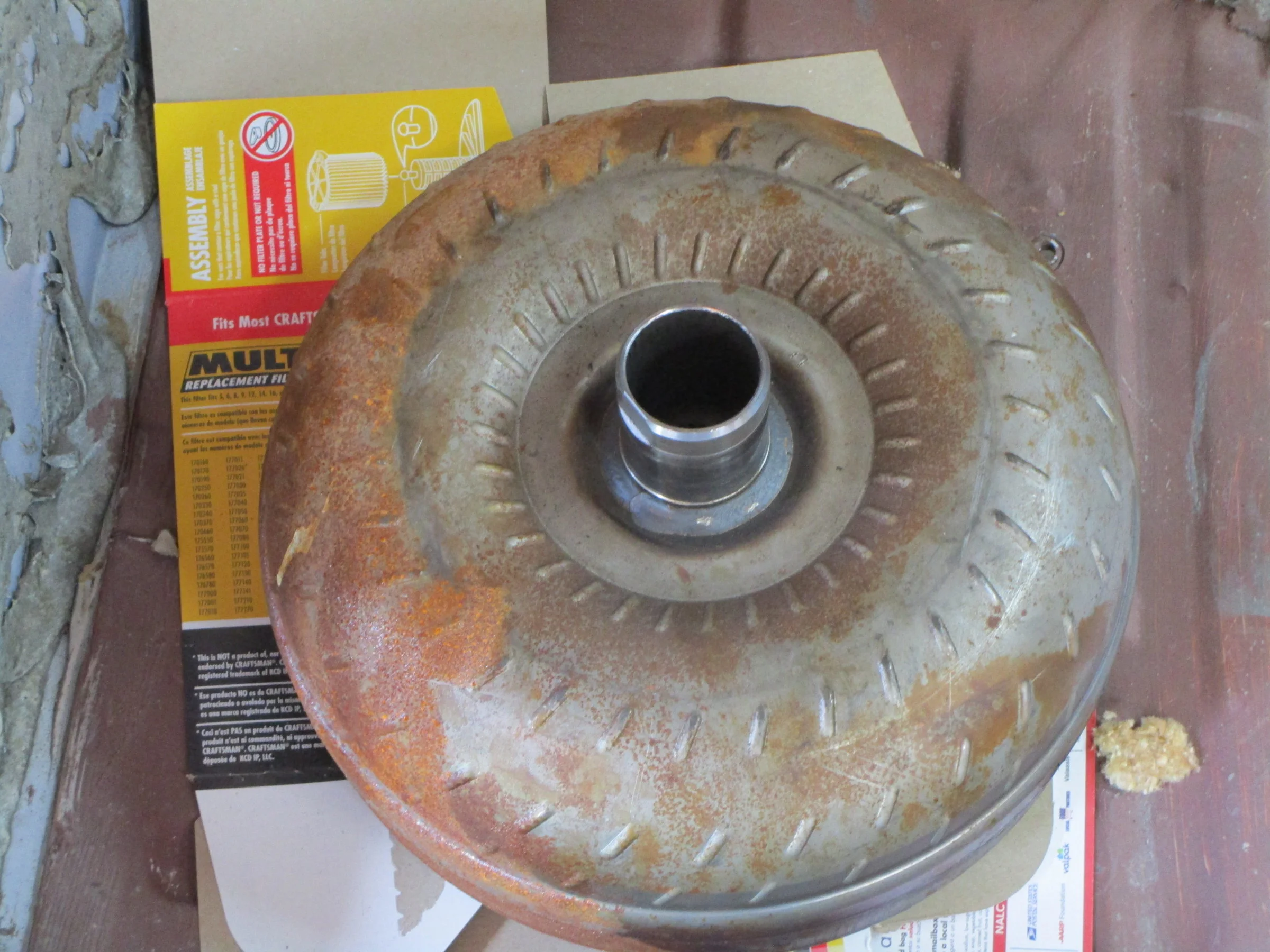

So last week I bought this junkyard fresh '98 4r70w, which promptly bled all over me carrying it from the truck to the garage :(
Also got the converter for it, will probably do the first start with the trans and converter as-is so I know everything works (whenever that will be)

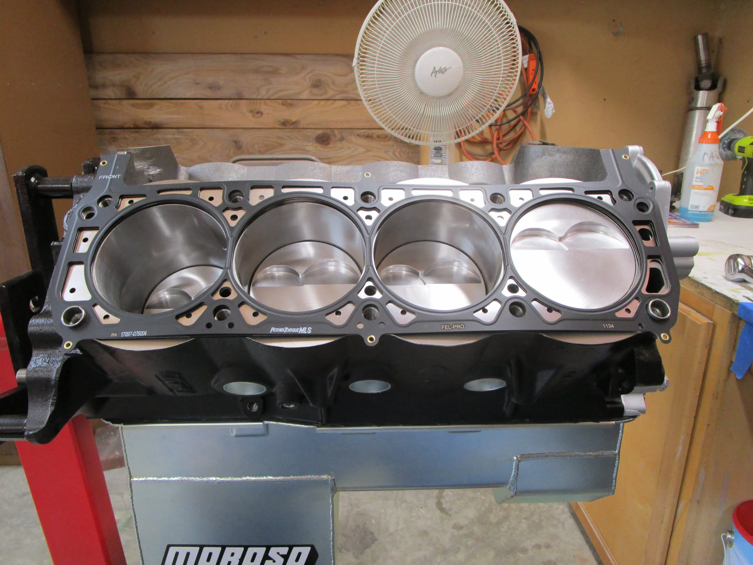

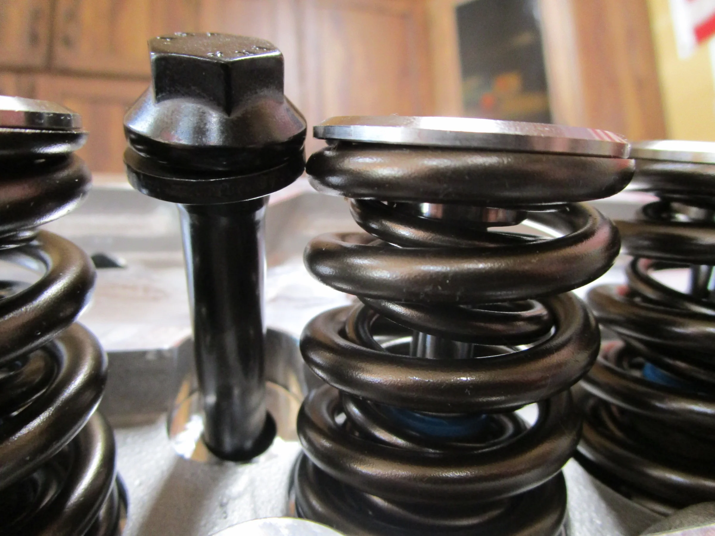

So here's why I love Summit. You'd think a standard 351w head bolt would work for this, and it really should, but, well.....
Yup, the head of that bolt is blocked from going into the hole by the big 'ol solid roller spring. oops
One call to Summit, and a full refund and exchanged for a set of studs (that are unfortunately are on back order until next week:( ) with no questions asked. :thumbsup:
Since all i'm trying to do is test fit this monster, not a huge deal right now, a couple g5 on the corners will do.

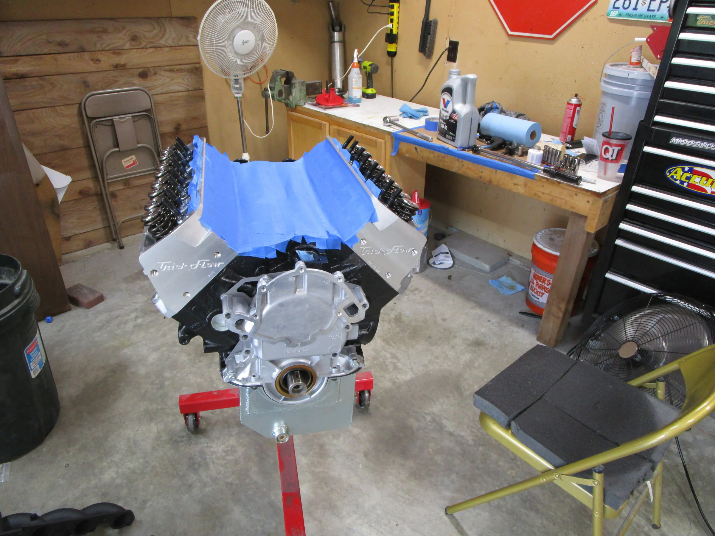

Head gasket, Fel-pro MLS (yes, its upside down, i noticed it after i took the pic and fixed it :doh:).
Heads on and taped up ready for a test stab. This is going to be AWESOME.

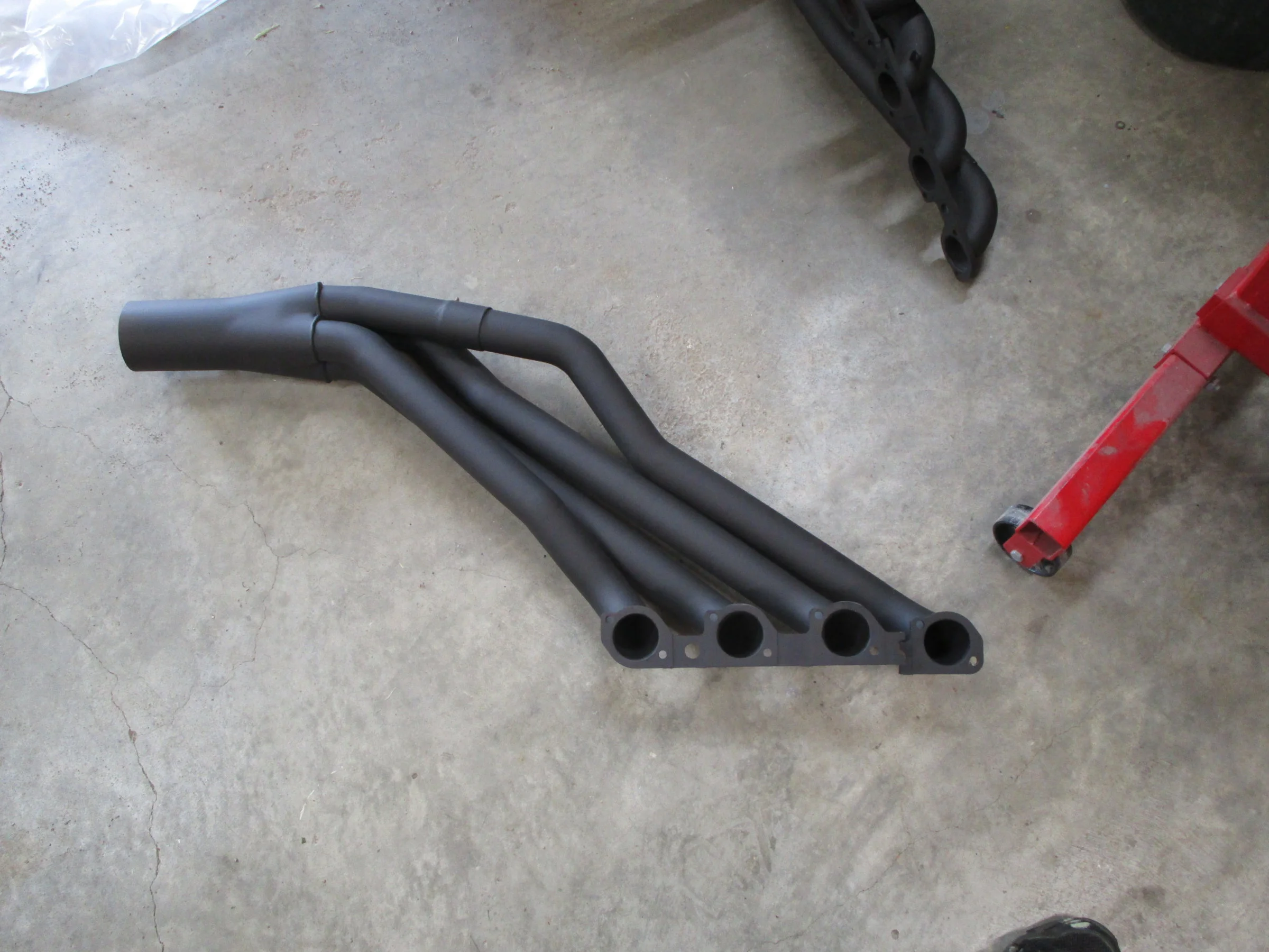

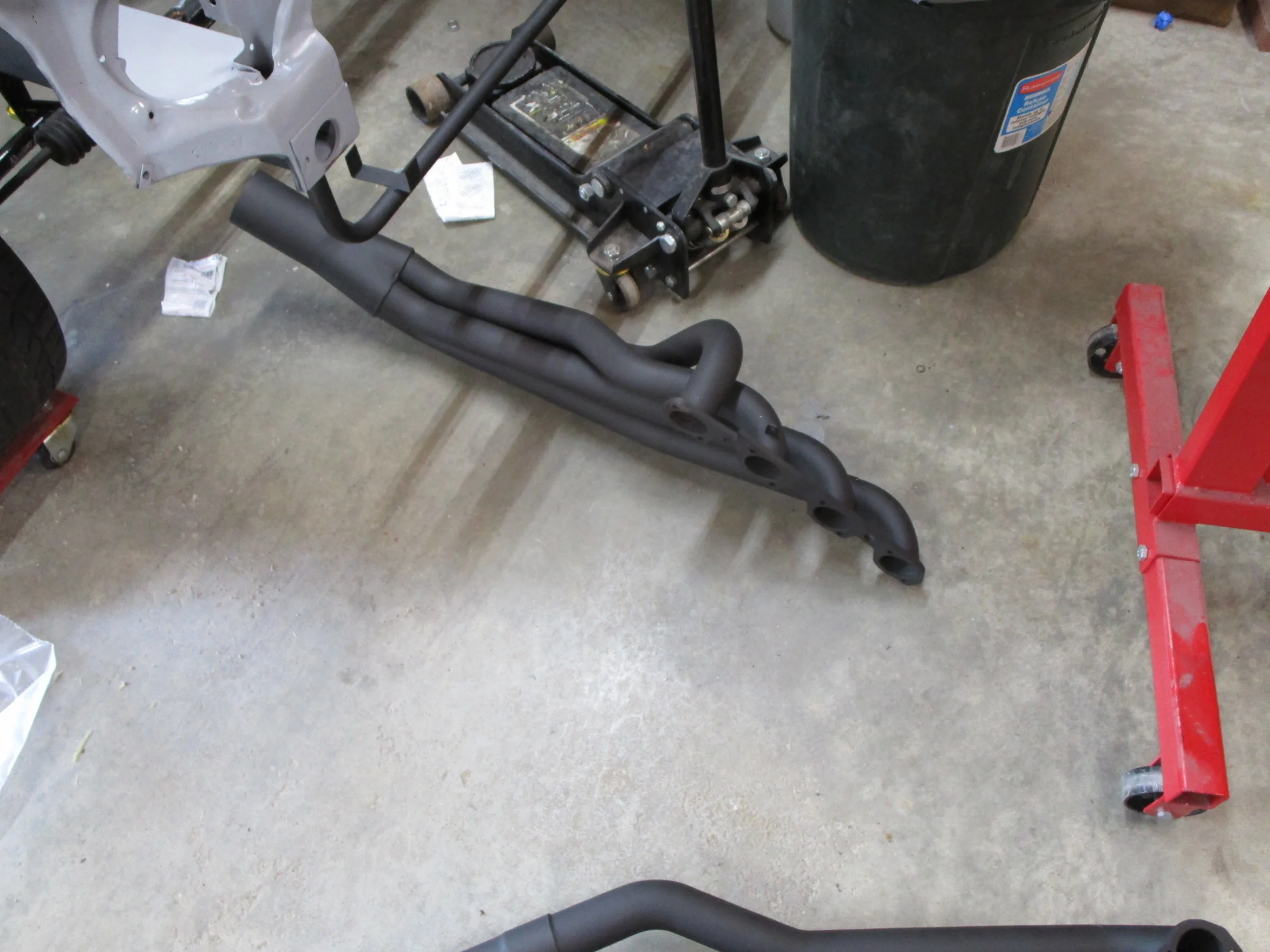

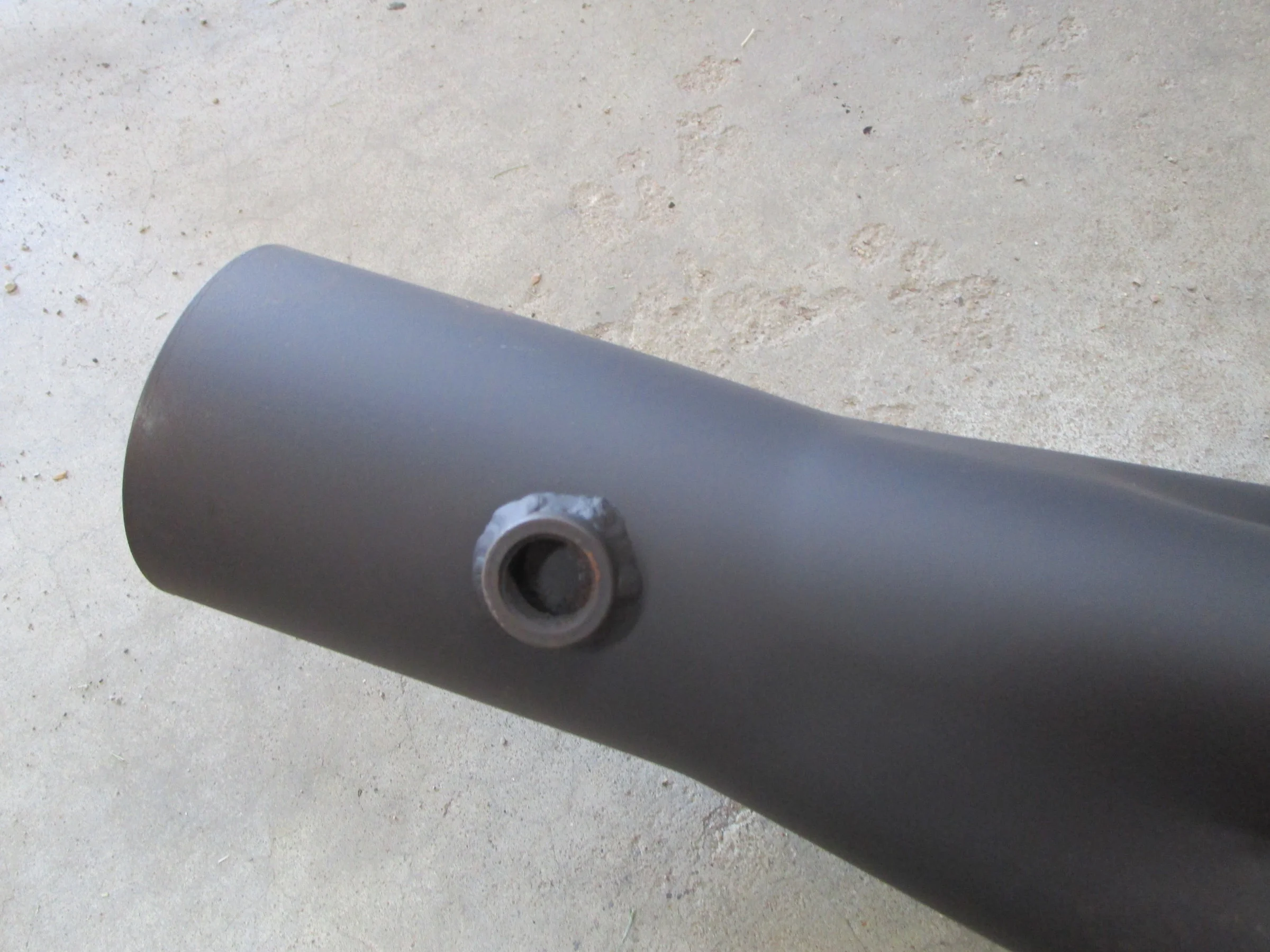

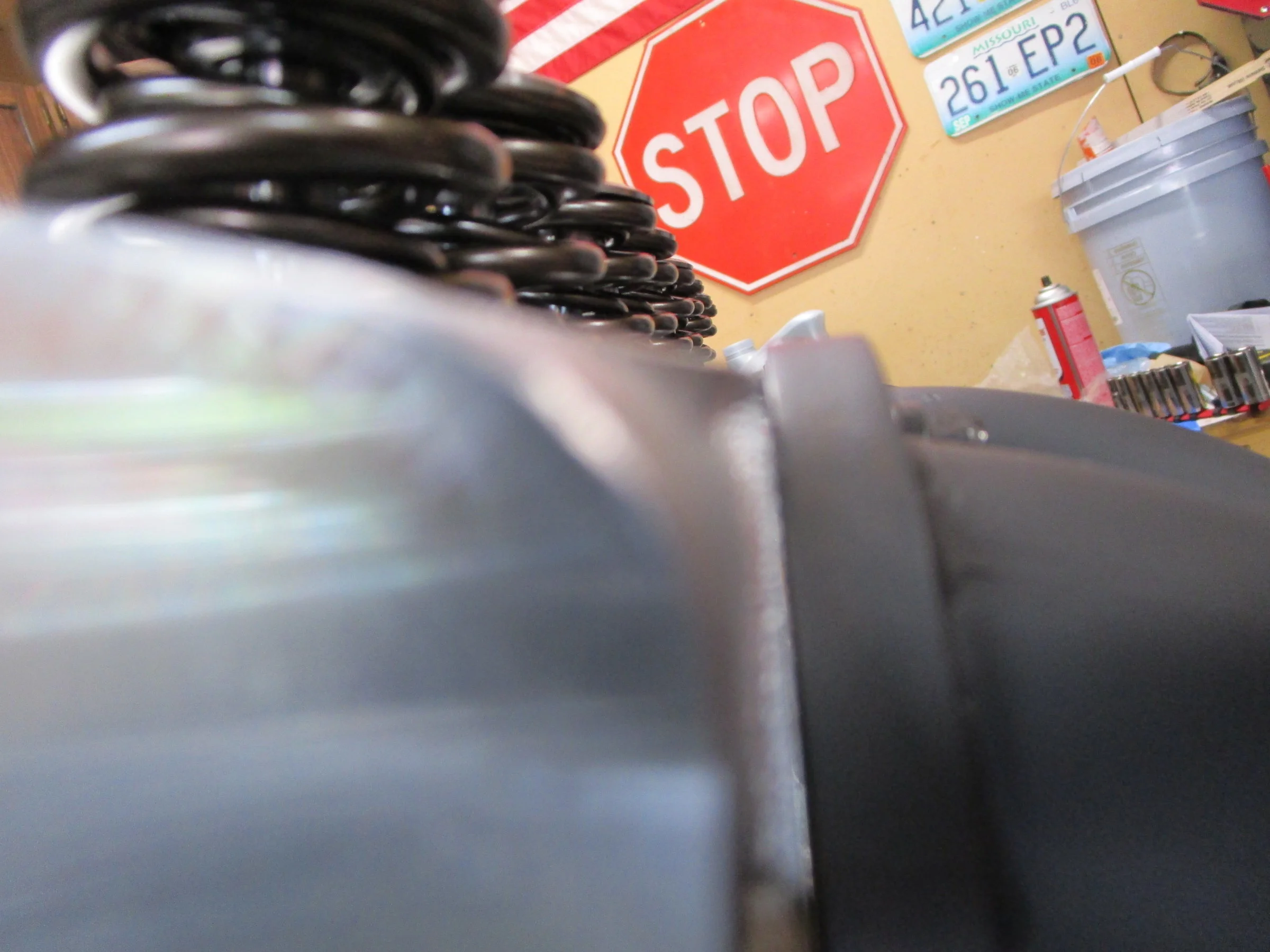

Headers out of the box. Came with adapter plates, which i'm not going to use since the high-ports have the right pattern already. Just the painted ones since I know theres going to be a bit of grinding/bending/bending before they fit like I'm going to want. Btw, even though theres bungs for the O2's, the collectors themselves arent drilled. Found that a bit odd but NBD.
And of course, already have an issue (which research before hand prepared me for). Flange sticks up above the valve cover rail. Shouldn't be a big deal, a little flap wheel or mill action and she'll be perfect.
Got that far today before I was waiting for ups to deliver a new block plate.
Tomorrow I'll get the trans and block together, and see how much i'll have to manipulate the headers to fit around the trans. If all goes well, may even get the assembly in the car.
