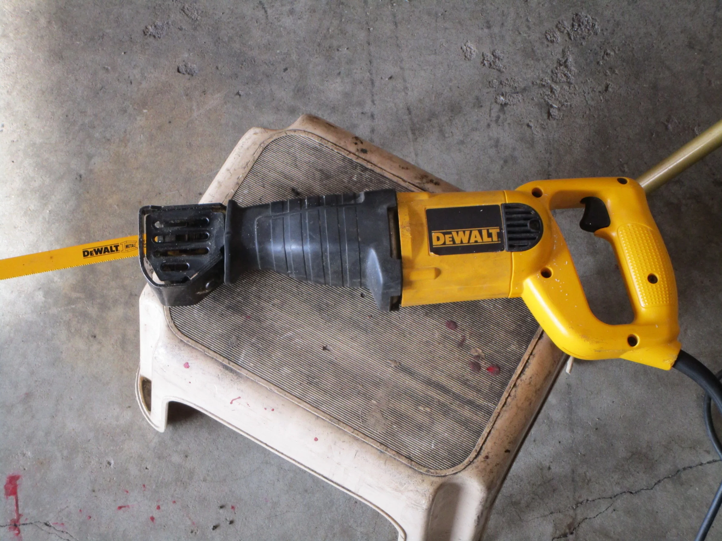

This guy hasn't seen any action since two houses ago, cutting down dead trees and brush. He got some exercise today.

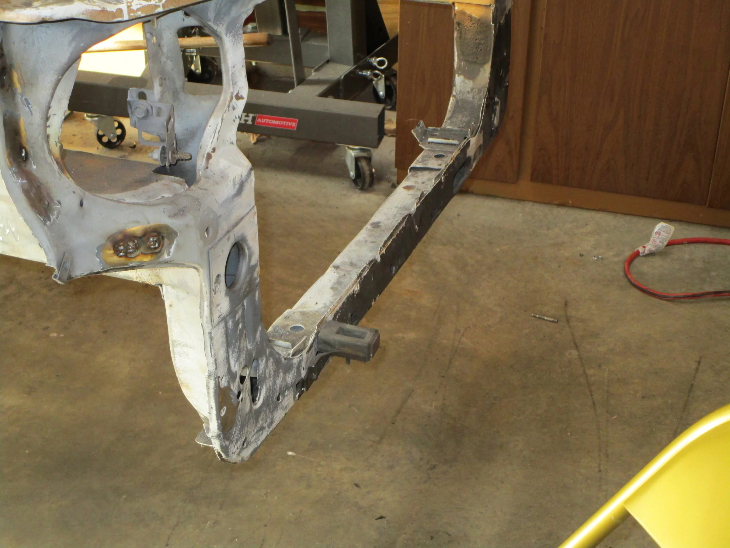

The unsuspecting victim:

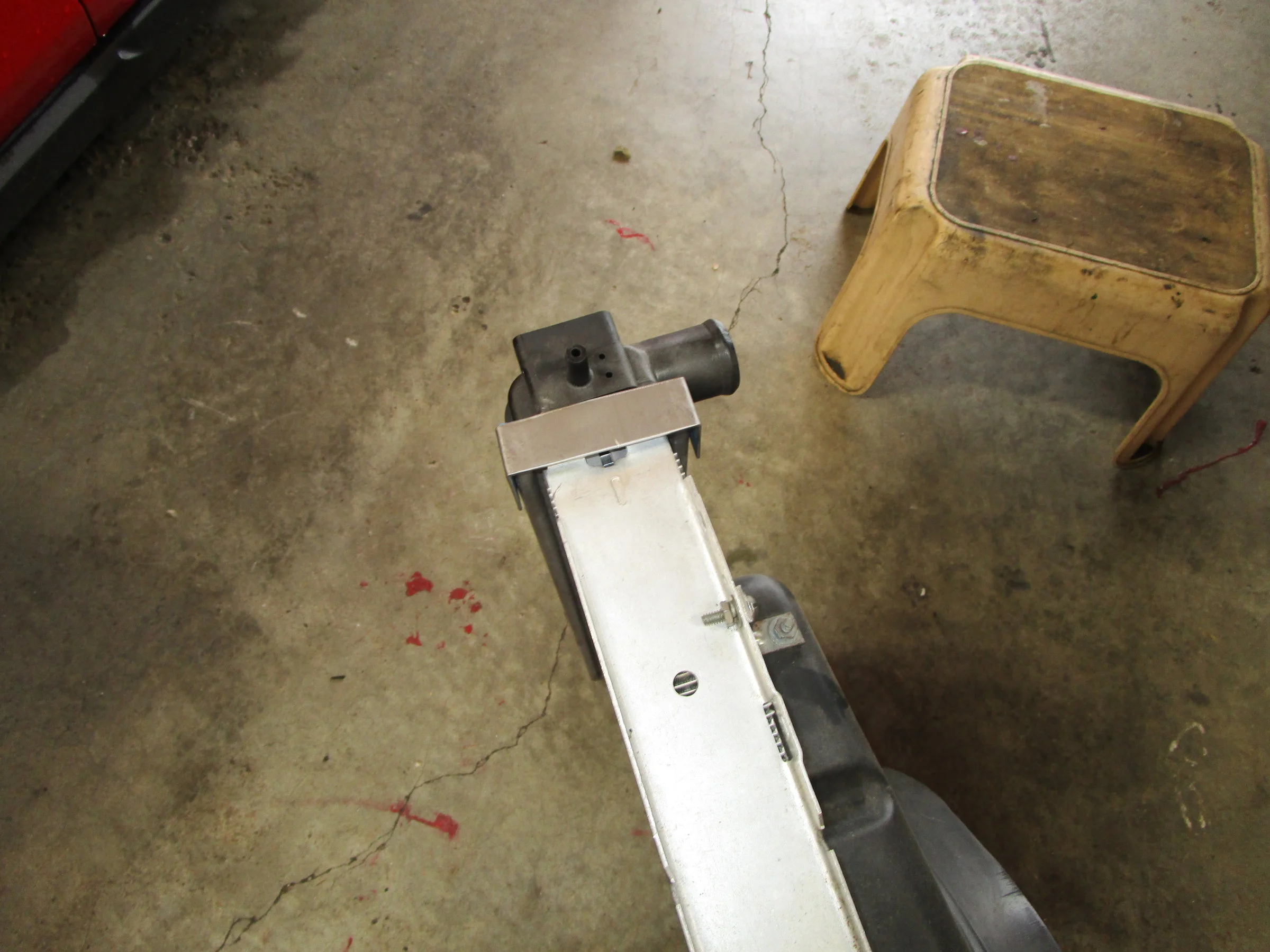

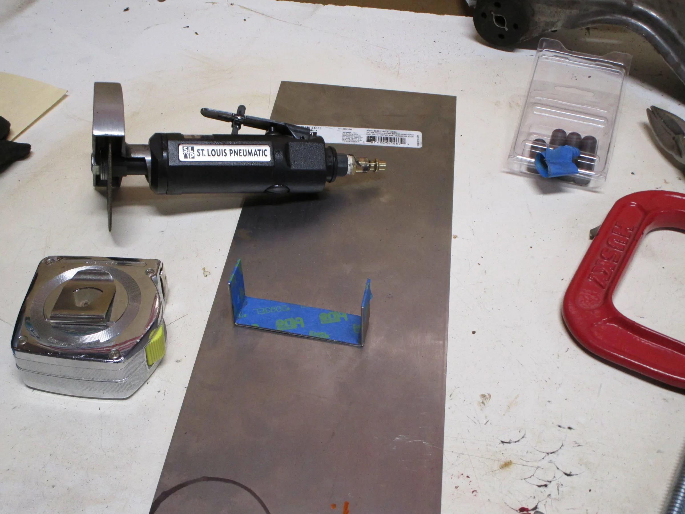

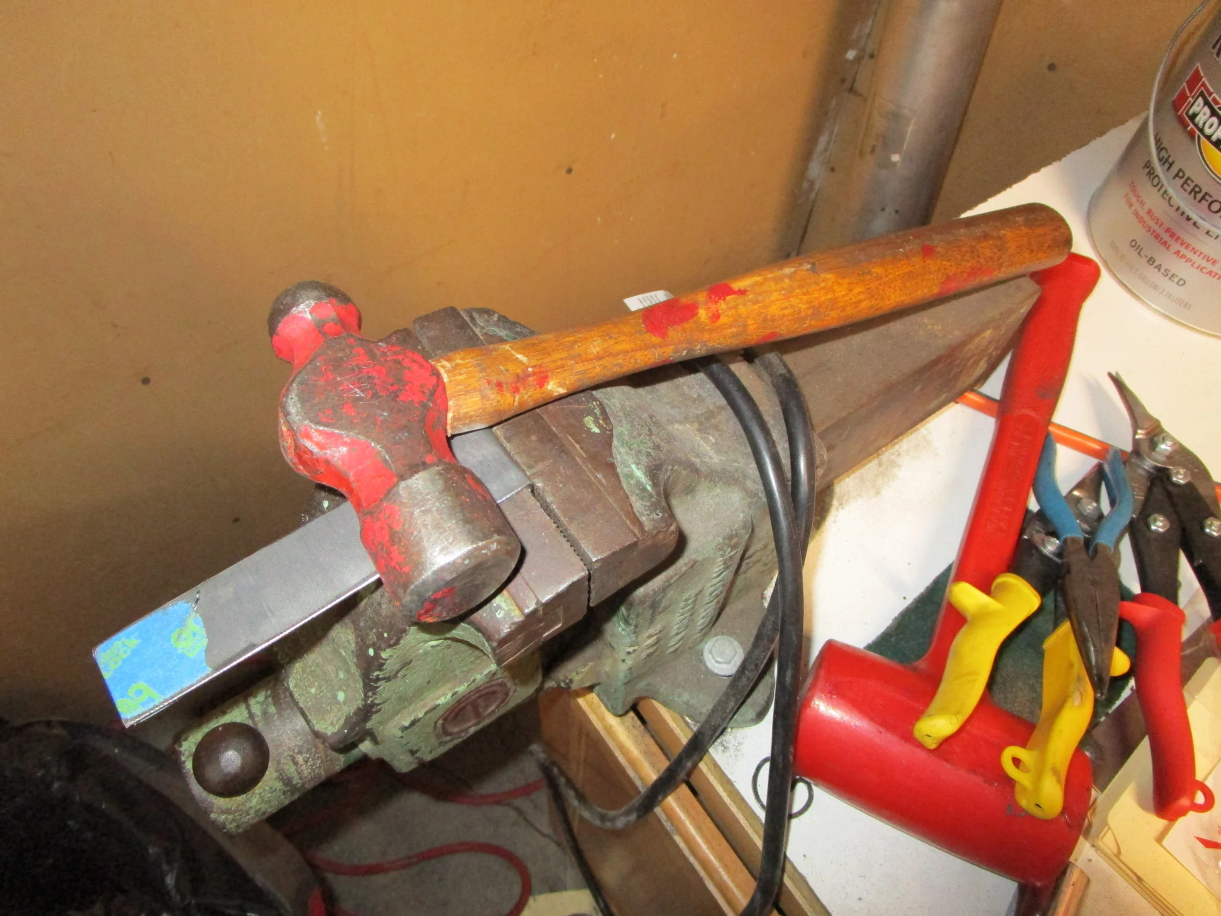

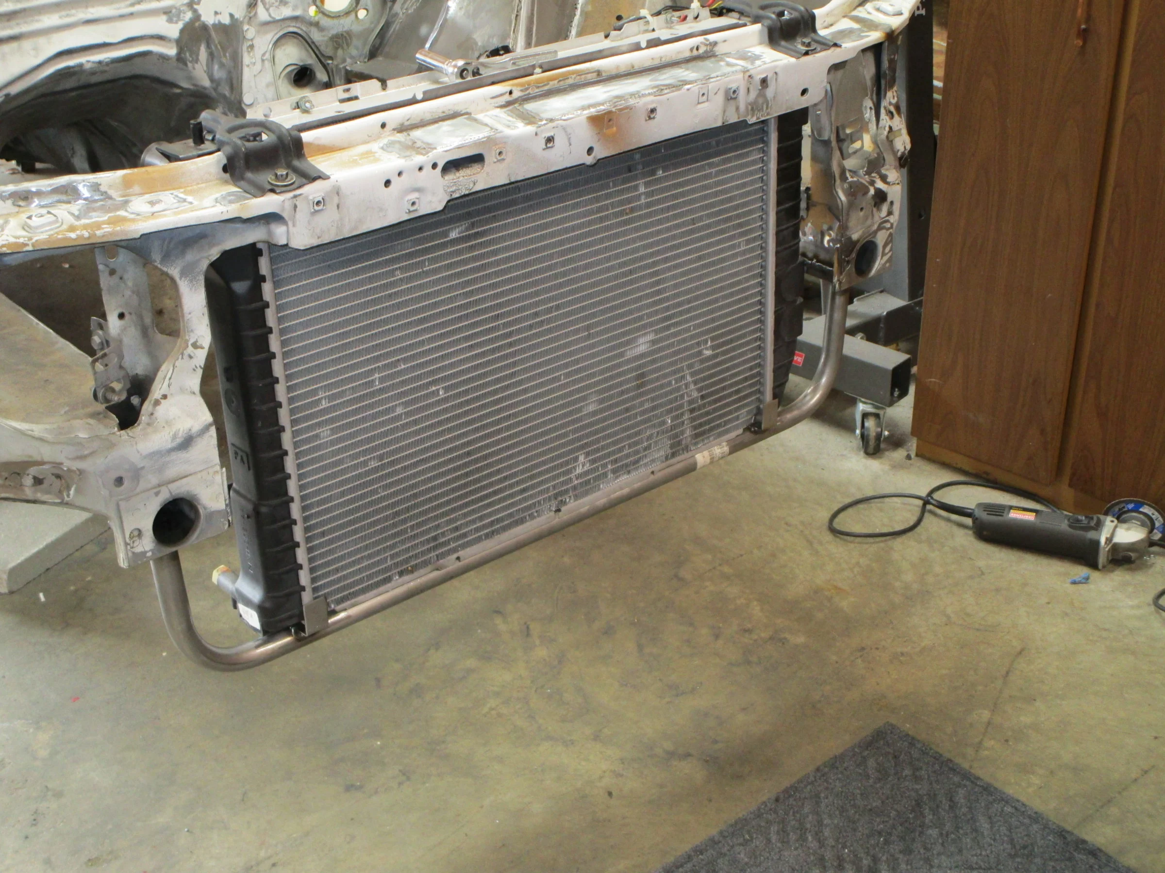

Test fitting the TeamZ piece, would not recommend it, the overall spread was 7/16" too short (leaning on it in a vise opened it up), the channels that are supposed to wrap around the frame rails were about 1/8" narrow (again, a little vise tweaking), and the big killer were the tabs (more channel) were 1/4" too small to fit my frpp rad (3 1/4" across where stock support held it), and since they were centered it meant that the plastic protrusion on the tank (probably just for fixturing the thing during assembly, but NOT taking the chance to cut it off) hit the bar and wouldn't let it sit in the tabs even if they were wide enough.

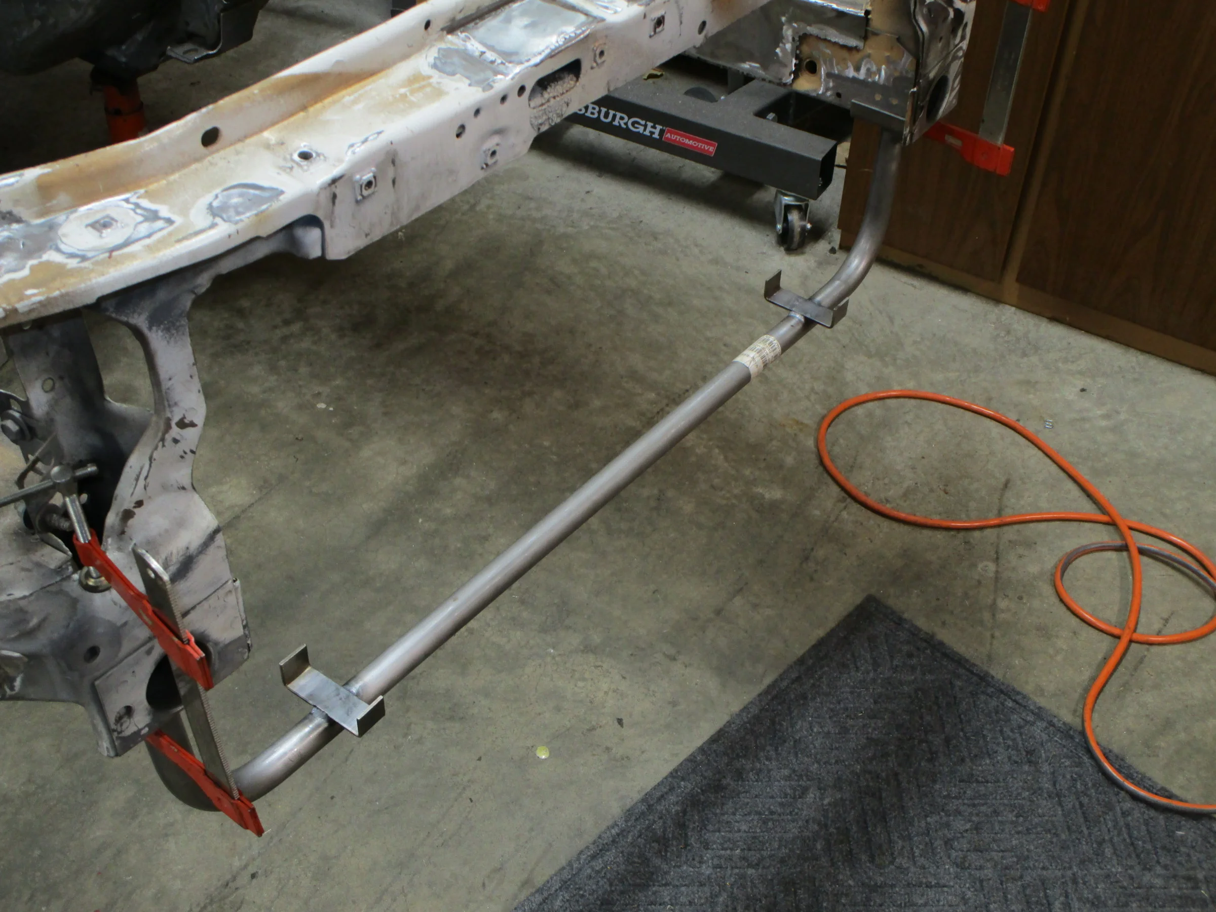

Made new radiator mounting tabs out of 16ga steel and cut off the old ones
IT FITS!!!! Was actually surprised it worked the first time, figured for sure I'd eff it up somehow
Bending up the second one
All welded up. Welds are ugly (my auto darkening helmet gets a little too dark) but they're strong enough for my fat butt to stand on it so....

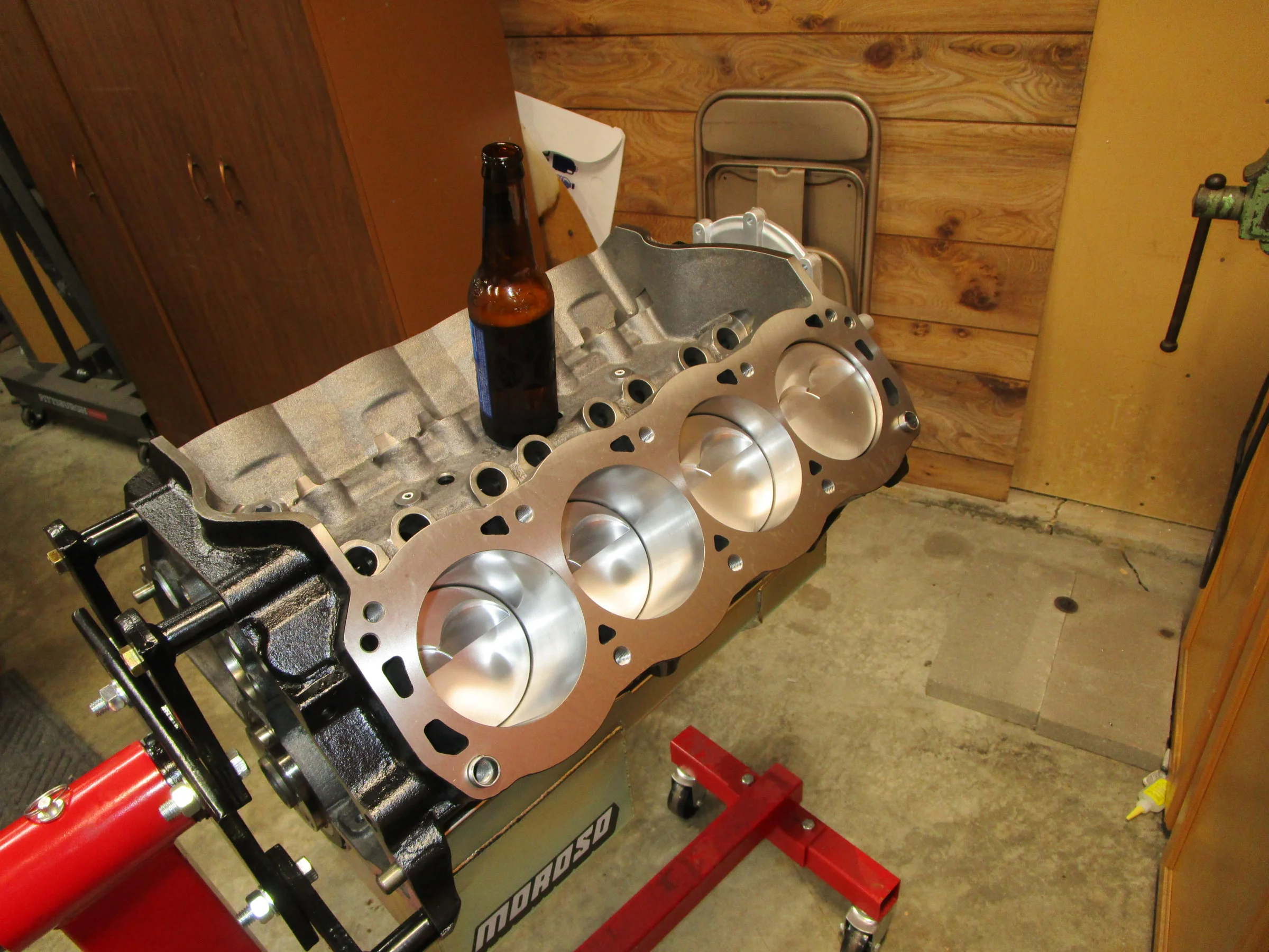

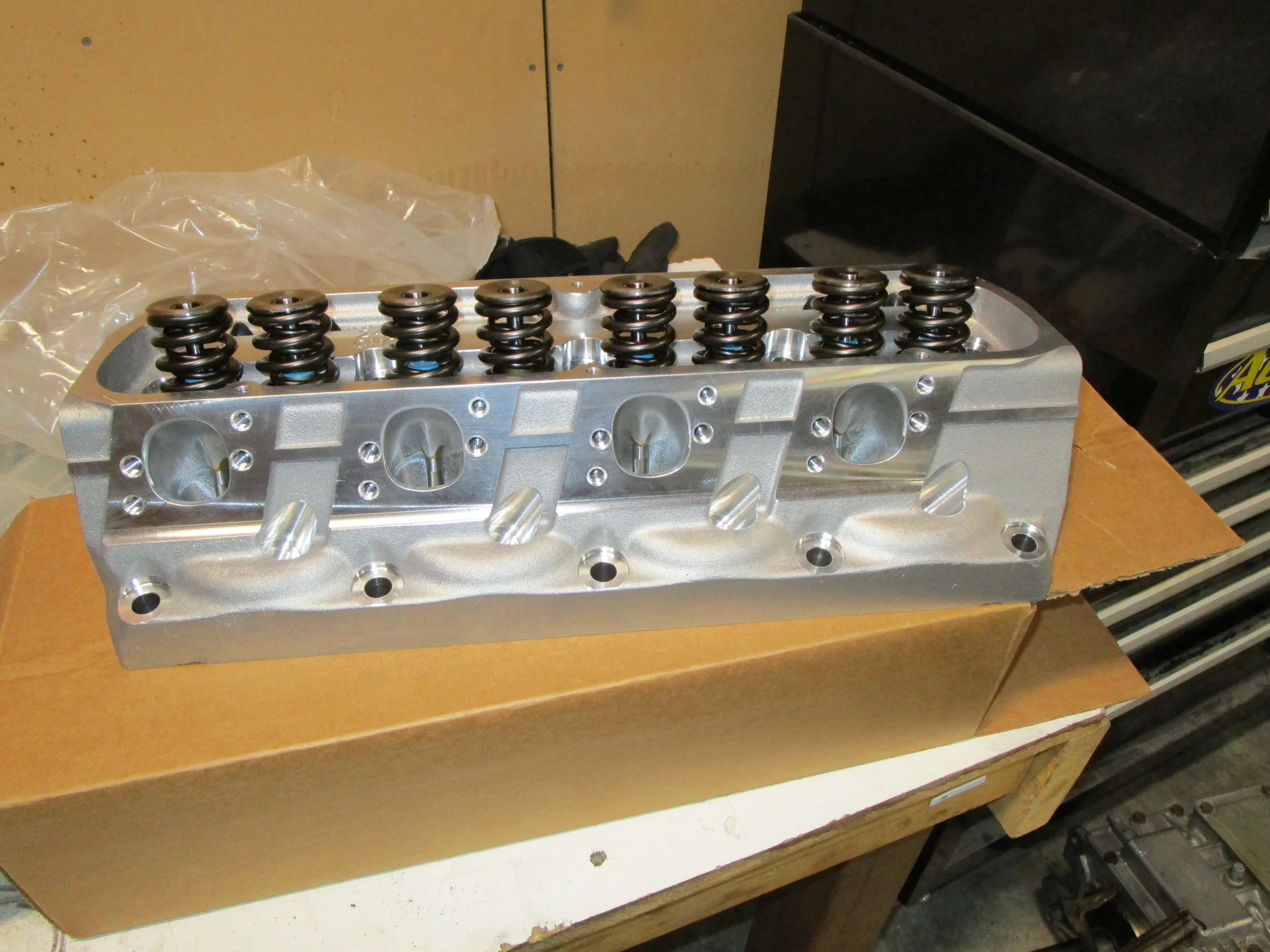

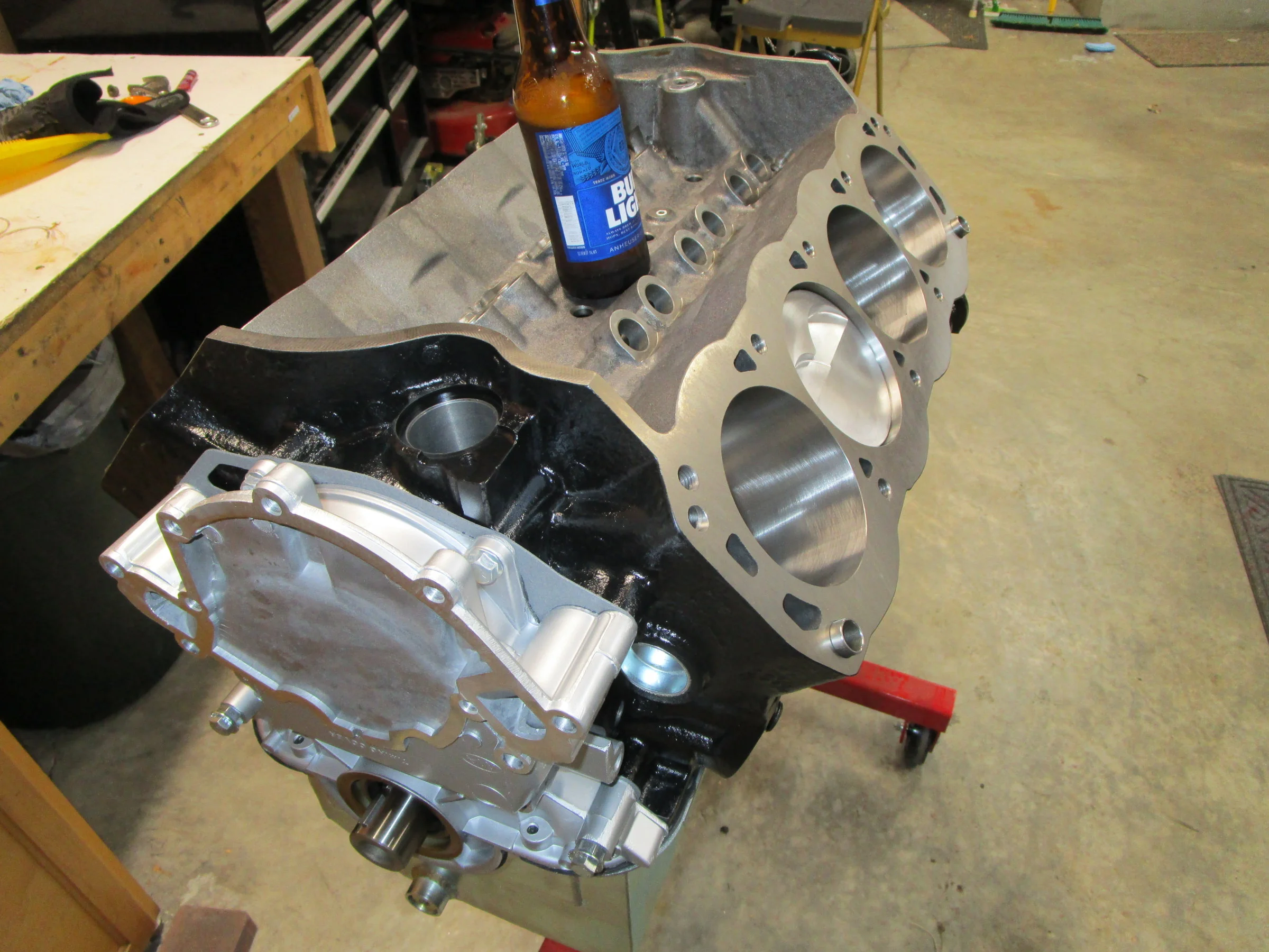

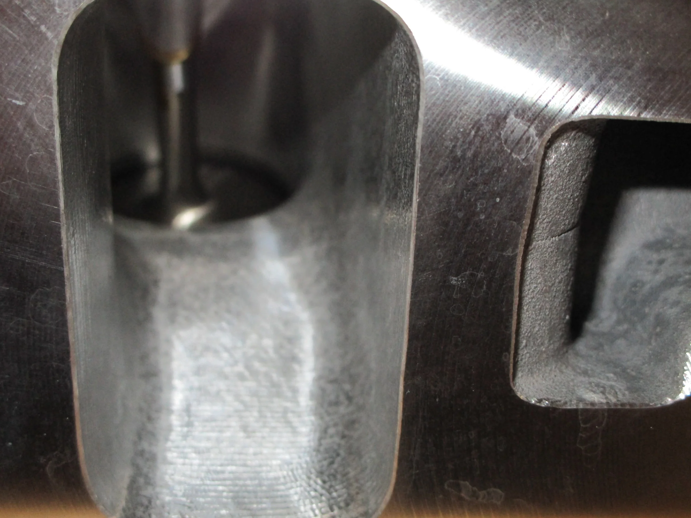

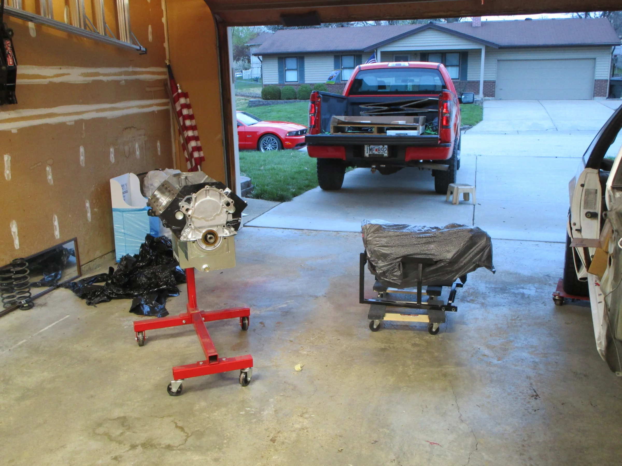

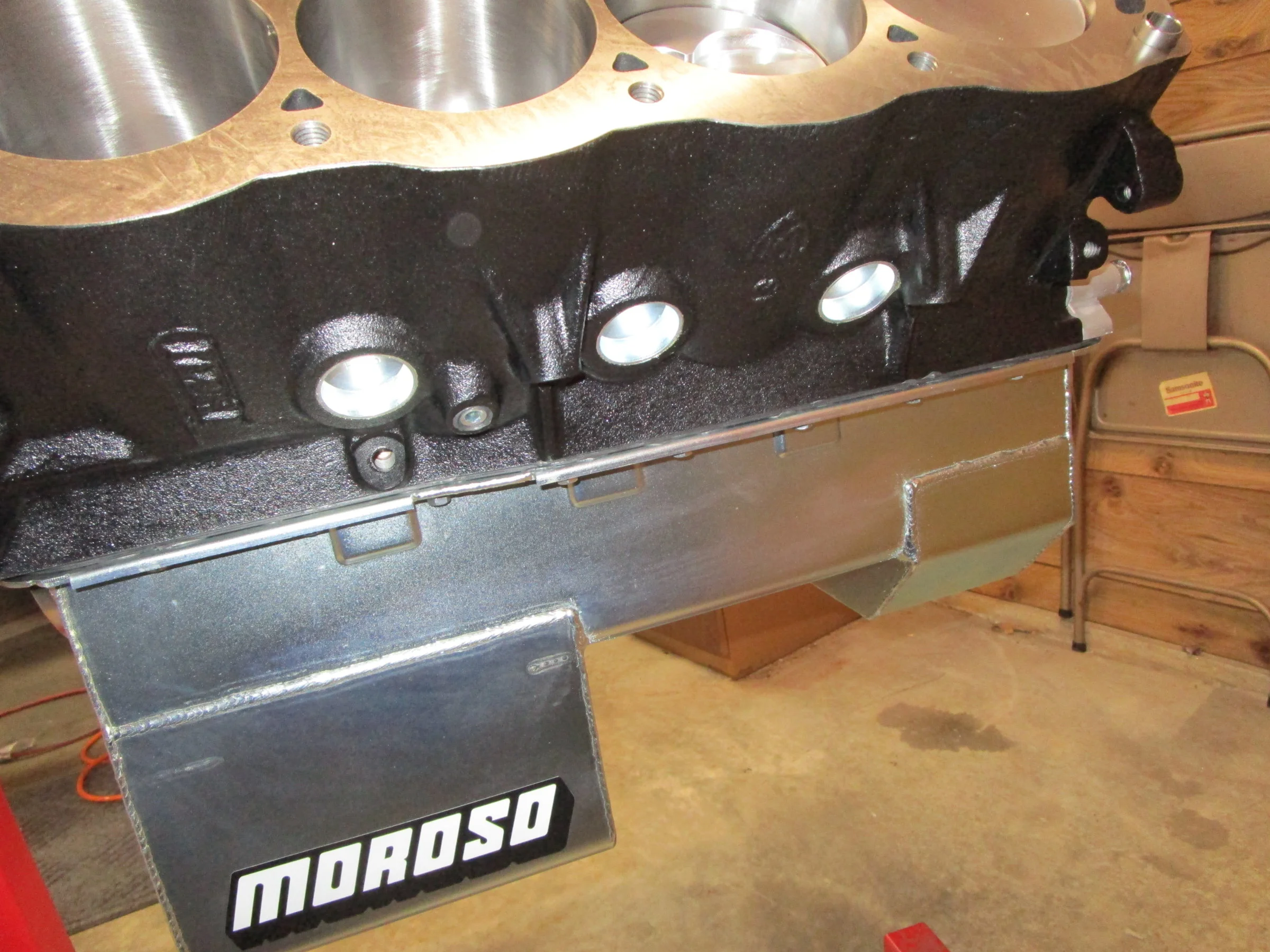

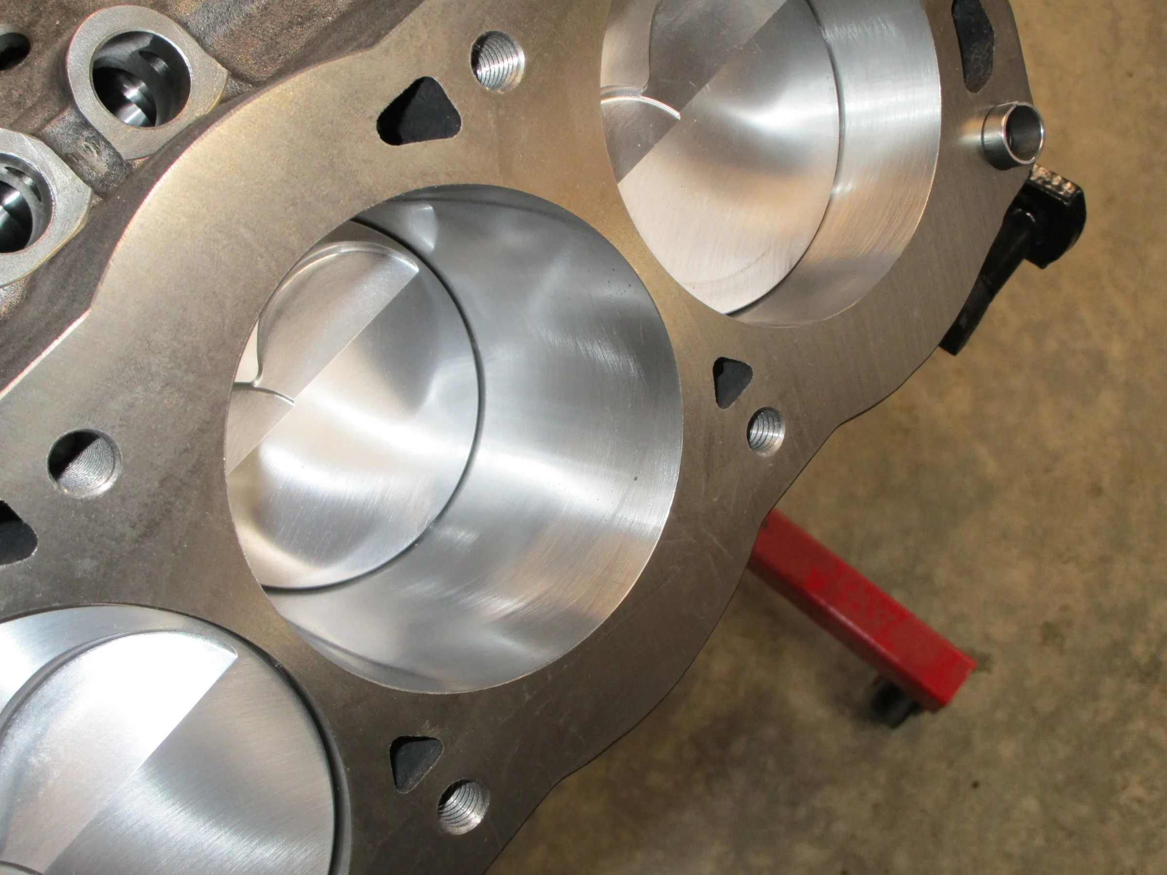

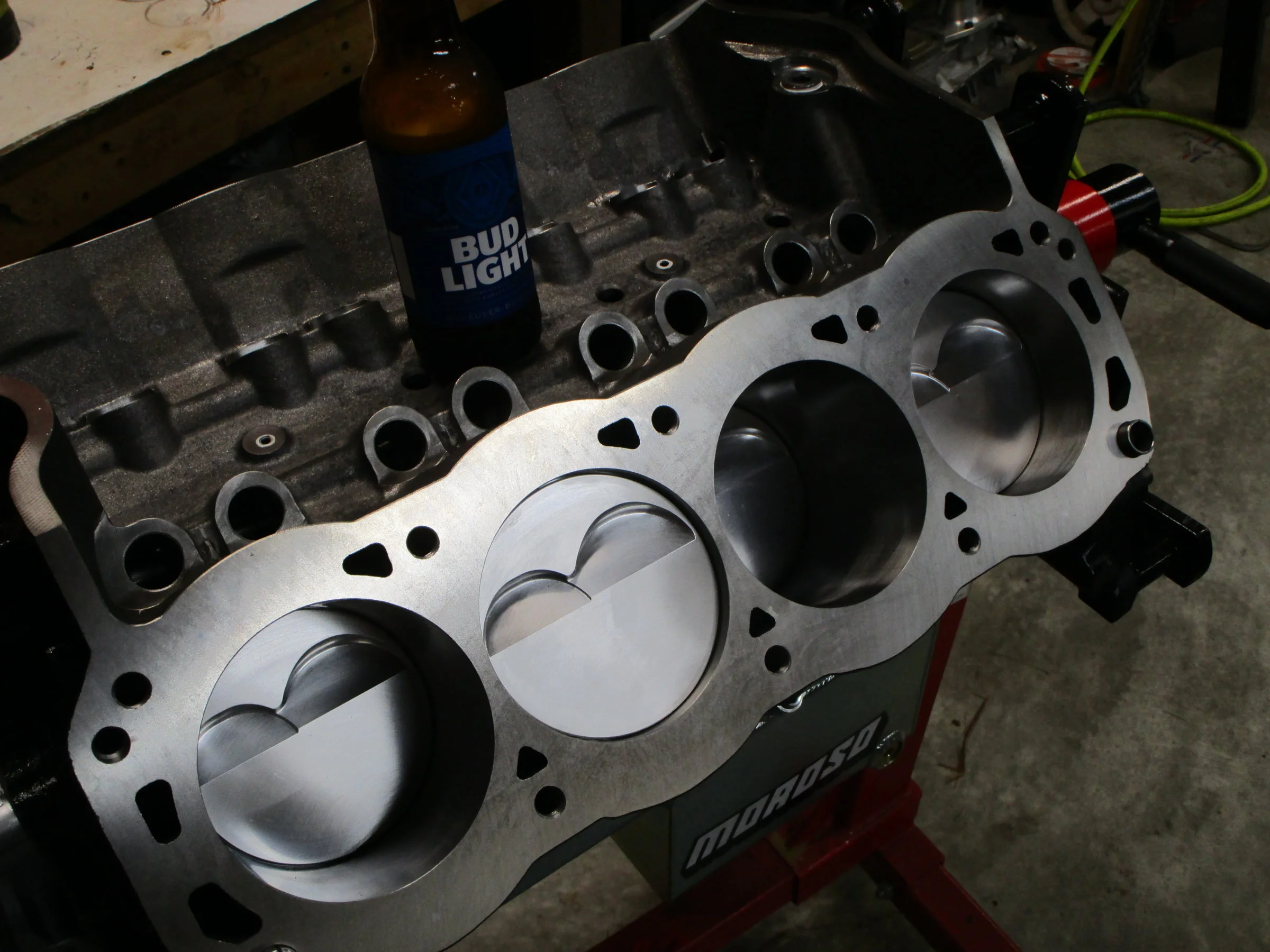

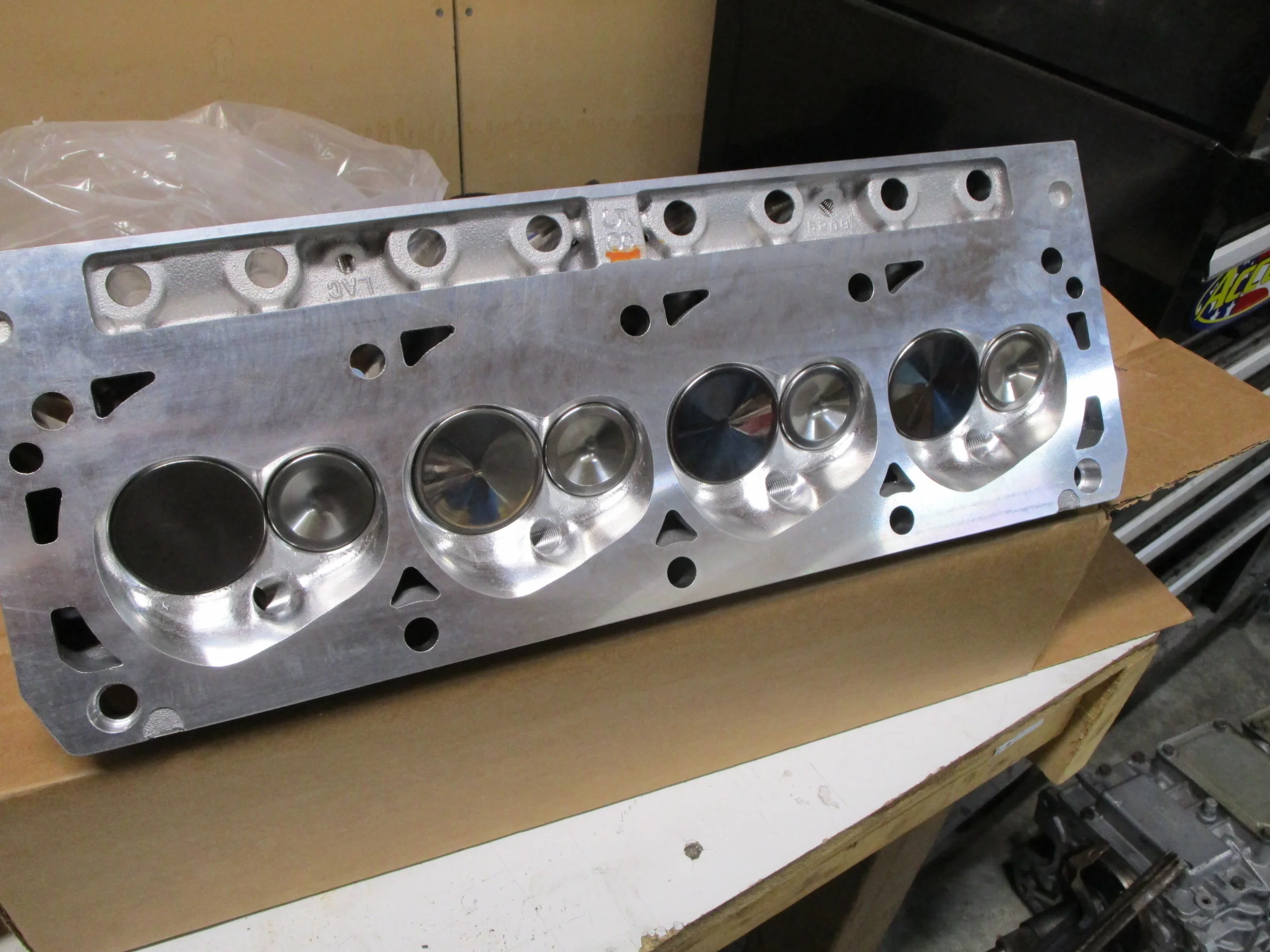

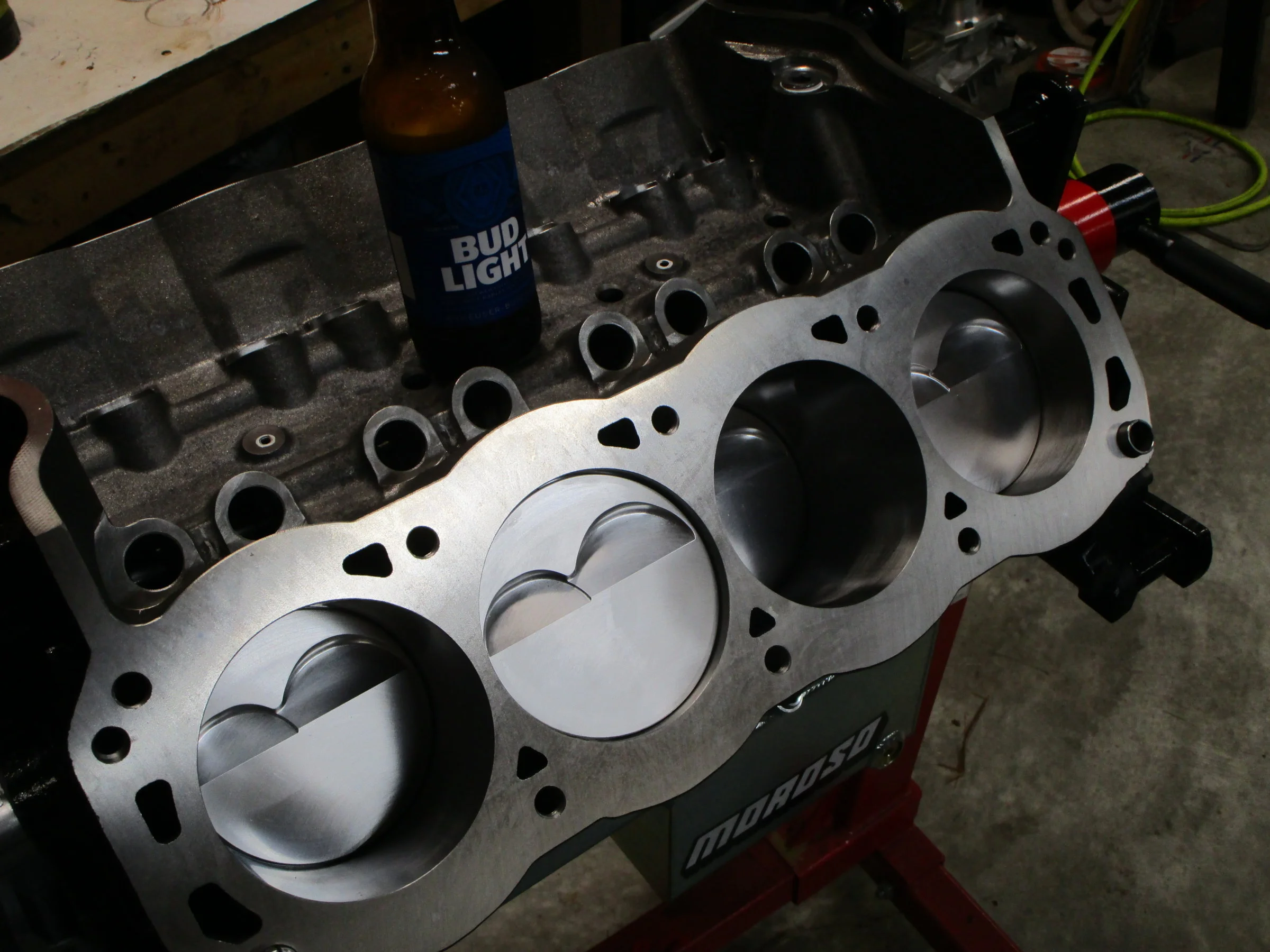

A little musical engines (the old 302 will get shoved in basement whenever it decides to stop raining)

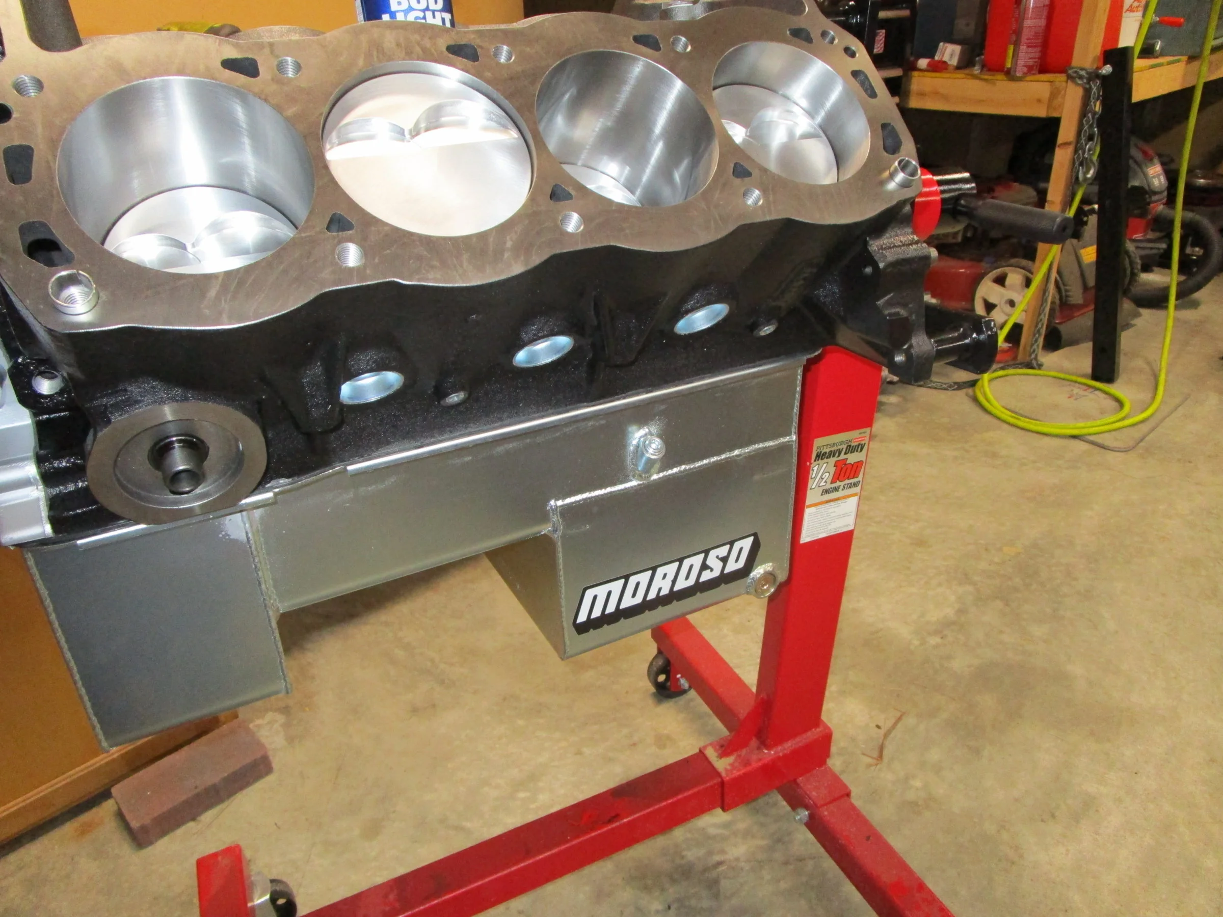

Detail pics:

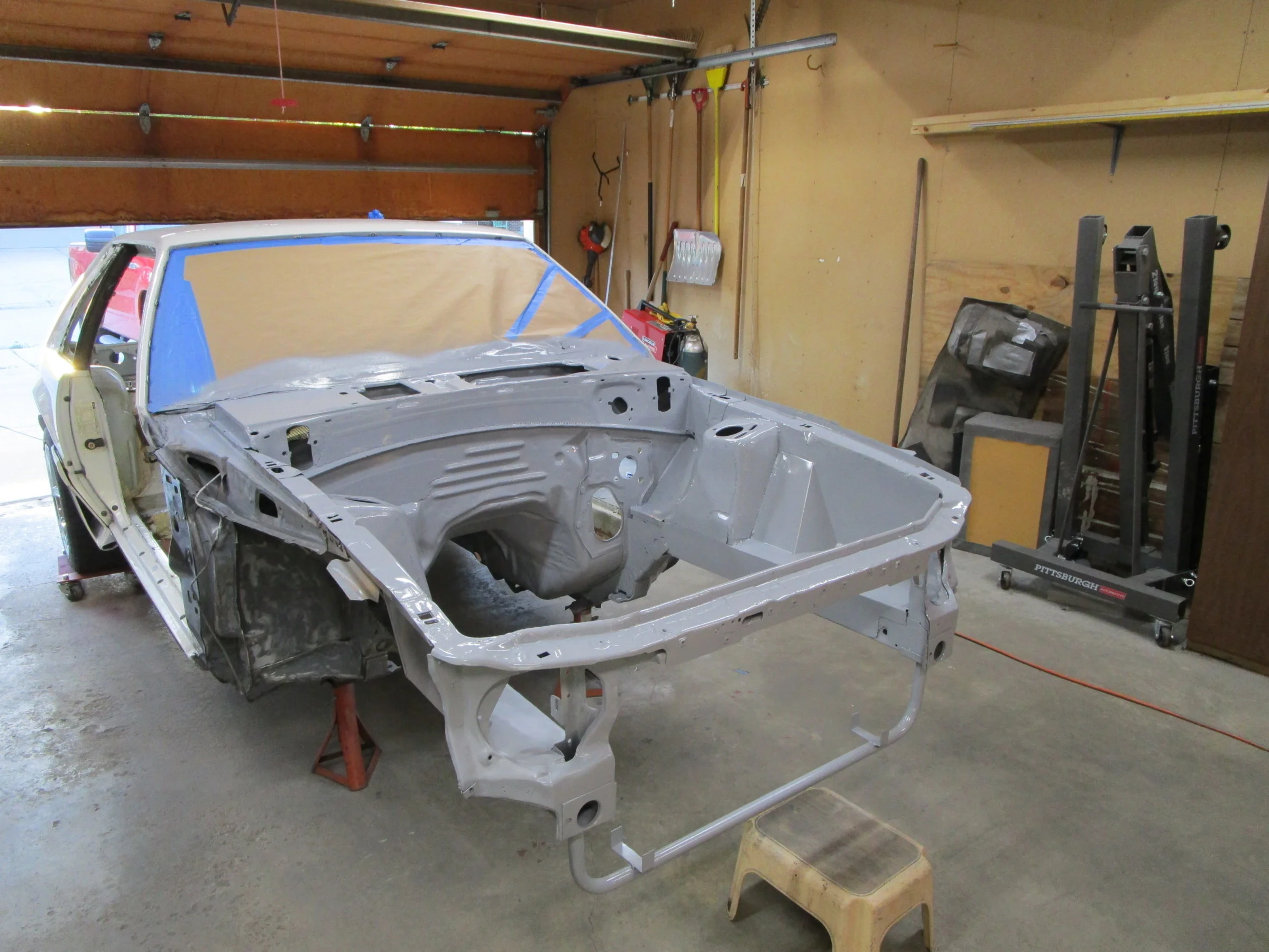

Just came in from getting 2 coats of epoxy in the bay. Will start filler Wednesday (needs 24-48 hours to setup, need to cut the grass sometime anyway). Inner fenders will get something different done, so didn't bother spraying them.
Just going to epoxy, fill, and then do another sealer coat of epoxy for now until
A) I know I won't need to cut anything else
B) Decide on a color
C) damn dog stops costing me ~$150 every three weeks getting rid of an ear infection :dammit:
