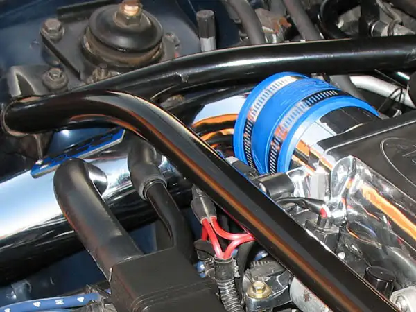

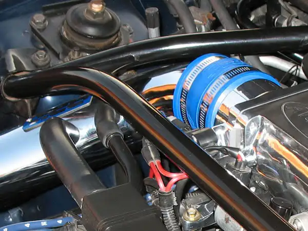

I used my stock brace with when i put the Accufab on. I also have the BBK CAI.
When you look at it, it doesn't seem like it will work. Actually, it seems impossible, but it will work. I removed the passenger side bolts to the brace, held it up, and installed the CAI pipe. I had to twist the pipe down where it bends going into the TB, so it will clear the brace. I put the bolts back in for the brace and i have a good .5" clearance.
Here's a picture. When i twisted the CAI pipe, it pointed the hose that goes to the IAC up farther. Get it to look like mine and it should work. If you can't get it, just keep moving it around to get more clearance. There is no cutting or welding involved.
