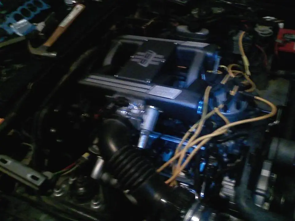

:lol: the throttle linkage won't clear the tall valve covers.
It started over a bit but it's still out of time. I think the plugs are fouled and the battery is almost dead. It'll be cranked tomorrow :nice:

Done:
GT40X heads (58cc)
b303
BBK SSI Intake (modified :rolleyes:)
Ford Racing 1.6 roller rockers
Accufab 70mm TB
C&L 76mm(?) MAF
1 5/8" Shorty Headers
Offroad h-pipe
Trashed the smog
Trashed the A/C
To Do:
190 lph fuel pump
24lb injectors
Subframe Connectors
3.73 Gears
That b303 cam bogs down with the factory 3.08 gears. I have to keep the car above 2,000 rpm or she starts to jerk a bit. Took awhile to figure out that the timing has to be advanced higher than factory settings. I was expecting to lose some low end but I didn't. It feels like a normal bolt on car until you hit 3,500 rpm.
Still feels a bit slow for the combo. Something's not right. I bet that the injectors, fuel pump and 3.73's will wake it up. It will definately put you in the seat tho.
