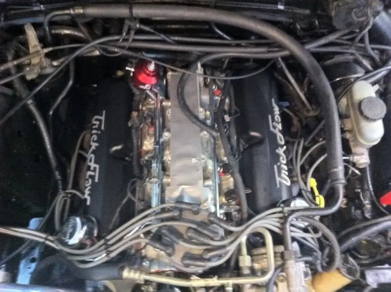

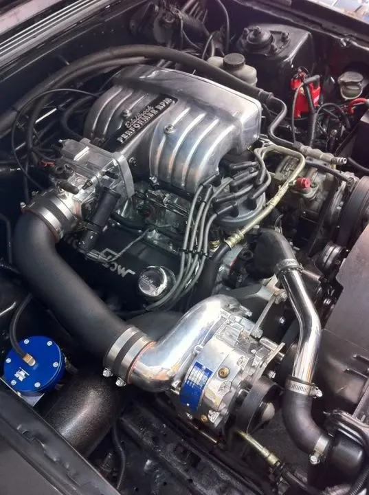

Currently our 92 with Vortech Blower is running 30lb injectors, FMU, Aeromotive Fuel Pressure Regulator and Walboro 340 fuel pump. It's not running 100% but as soon as it is we are taking it for a dyno tune session right away. I'm sure after the dyno session probably 42lb injectors will be needed. Air/Fuel ratio during the dyno session let us know.
You can see the FMU (blue circular type bottom left) in this picture.
You can see the red 30lb injectors and red Aeromotive Regulator in this picture.

That's one way to do it, but if you're buying the injectors, just go ahead and get the 42s and be done with it. No FMU will be necessary, just a boost sensitive AFPR and an MAF calibrated for the 42s. Plenty of people idle just fine with those injectors, so there's no reason not to.
I know some guys are going to jump on and cry foul about using an FMU, but it works for some guys. I'd personally rather have enough injector to support the amount of power I'm making without increasing the boost and potentially overloading the pump, but to each his own.
