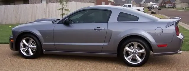

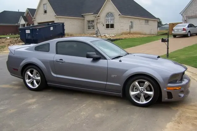

I am really happy with the way the car sits now. It is level and the gap over the wheel is perfect to me. It rides pretty much like stock and you can only tell it's lowered when you hit something pretty big at speed. It handles better and definantly hooks better. I didn't have to use the camber bolts to get the car to align back to spec. I set the adj panhard dead on with the stock one and didn't have to adjust it any once the car was on the ground. I am not sure it's needed with such a mild drop. Install was pretty easy since I used a lift and air tools. I guess it took about 2 1/2 hours start to finish. I think the noise is coming from the passenger side strut. It makes some noise when I bounce the right front of the car. I am going to pull it apart and re-check everything. Here are the before and afters. I don't think the pics do it justice.
Before
After
