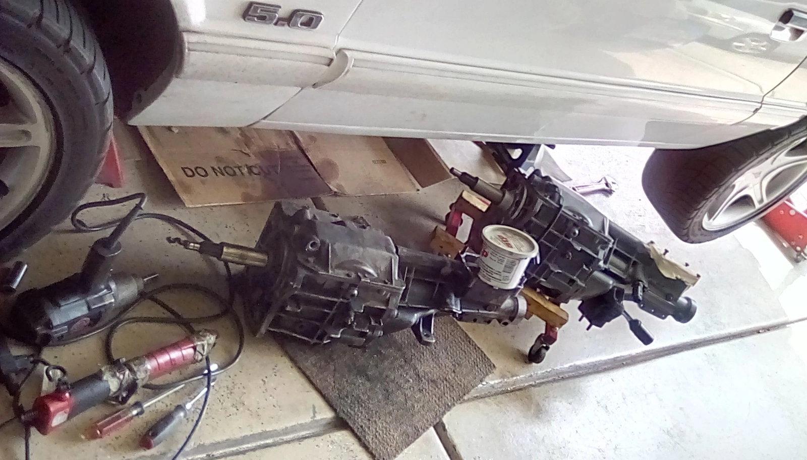

You suckers got me worried now,just put rebuilt( by me) trans. back in.I got a complete kit from 5 speeds.com and I don't remember if speedo gear clip was included.:poo:,:poo:,:leghump:.sonofa.

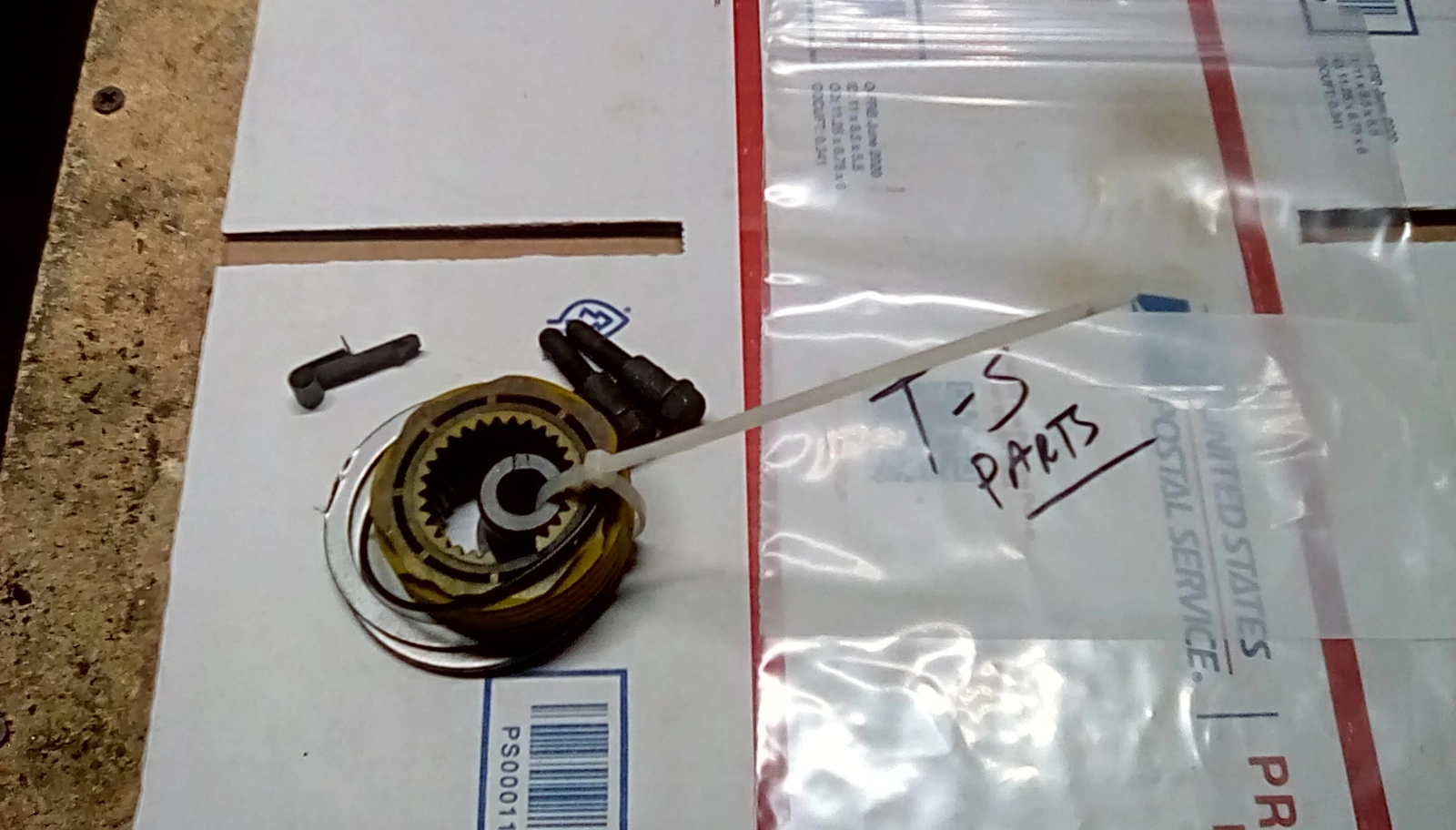

Woooo,looked at some parts I saved from rebuild.
