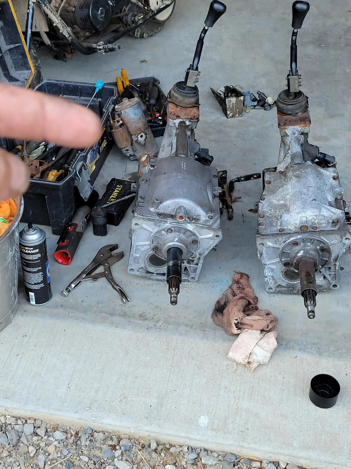

Found this behind the engine! It does NOT match the 89 ho block though! Matches a 92? And a World Class at that! I am pretty sure all I have learned points to this being a 92 Tremec World Class. Do you agree?
I need a verification from someone who knows, I am considering tearing it apart myself and going through it, not because it's bad but because it's out.

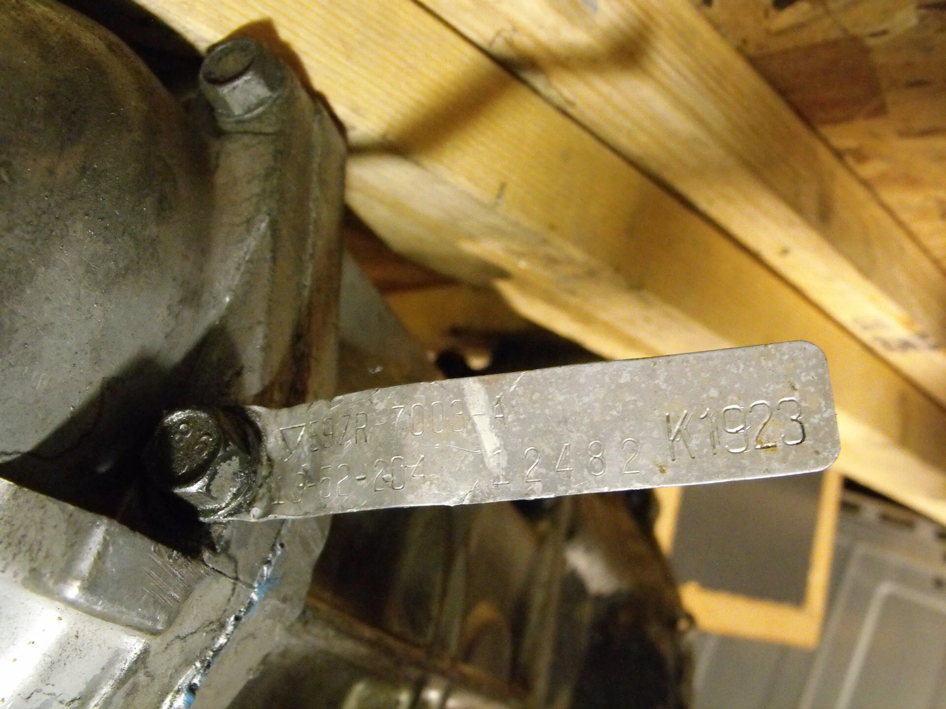

Here is the tag from the case and written here for clarification.
(upside down triangle starts this line) E9ZR 7003-A
13-52--204 12482 K1923
The numbers on the case agree with an 1989 Mustang GT Manual. Dates stamped in the case, the round date stamps, have 92 in the middle.
E9ZR refers to a '89 GT manual and is repeated on the tag. This is confusing. The number on the tail housing wasn't made until 92!

I usually don't care about the casing numbers on the main case, tail shaft or cover as many are interchangeable. For me the main number is the trans tag. On yours it shows 13-52-204
There are a couple websites that have pretty good lists of the tag numbers:
Ford T5 Manual Transmission Identification
www.therangerstation.com
BritishV8: the site for enthusiasts of modified British sports cars
About classic British sports cars, performance mods, V8 engine swaps, MGB V8 conversions, et cetera
www.britishv8.org
They list that trans as an 85-89 Service (I would interpret that to mean replacement spare part) version of a 5.0 WC.

Most of the time shops will replace the entire tail housing when the rear bushing is bad so go with the ID tag on the case.

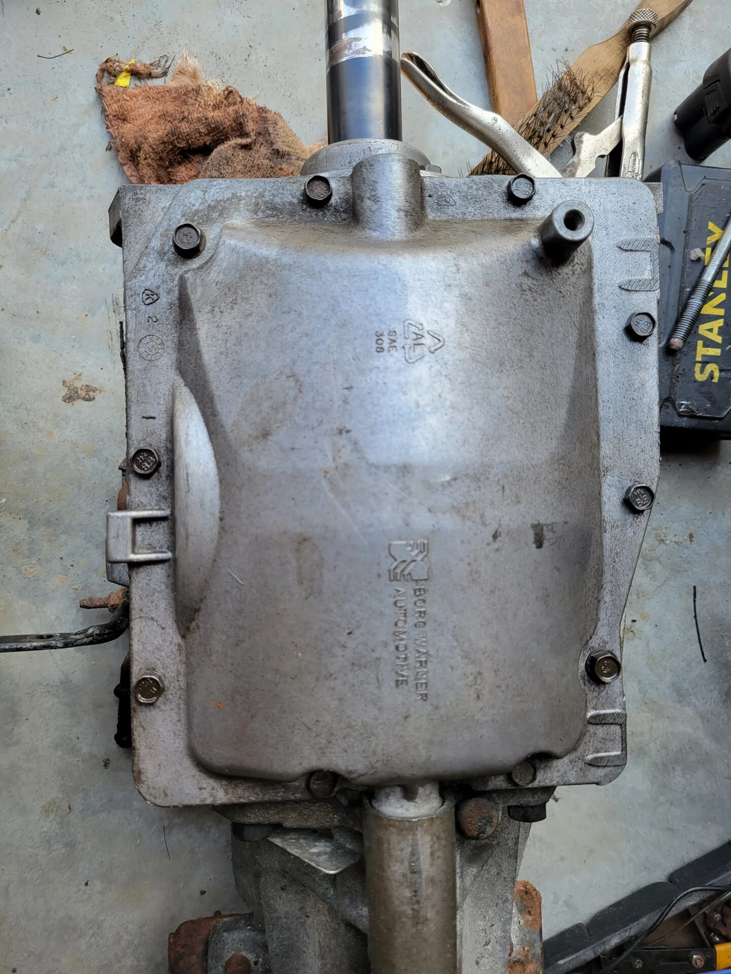

There are two numbers other than the tag that can help ID what it’s out of.
On pass side of the case, there is usually a number in a circle. This is the date the case was cast. In this case it’s a 90 for 1990. The number of dots surrounding it signify the month.
The tailhousing and top cover and input shaft retainer should have similar casting codes, so it will help determine if the trans is a frankenTranny

Date on the tag indicates the transmission was built in calendar year 1992, for a 1993 model year Mustang.
K1923 = built October 19, 1992, on 3rd shift
If the main case had a partial VIN on it, it should start with PF1.
