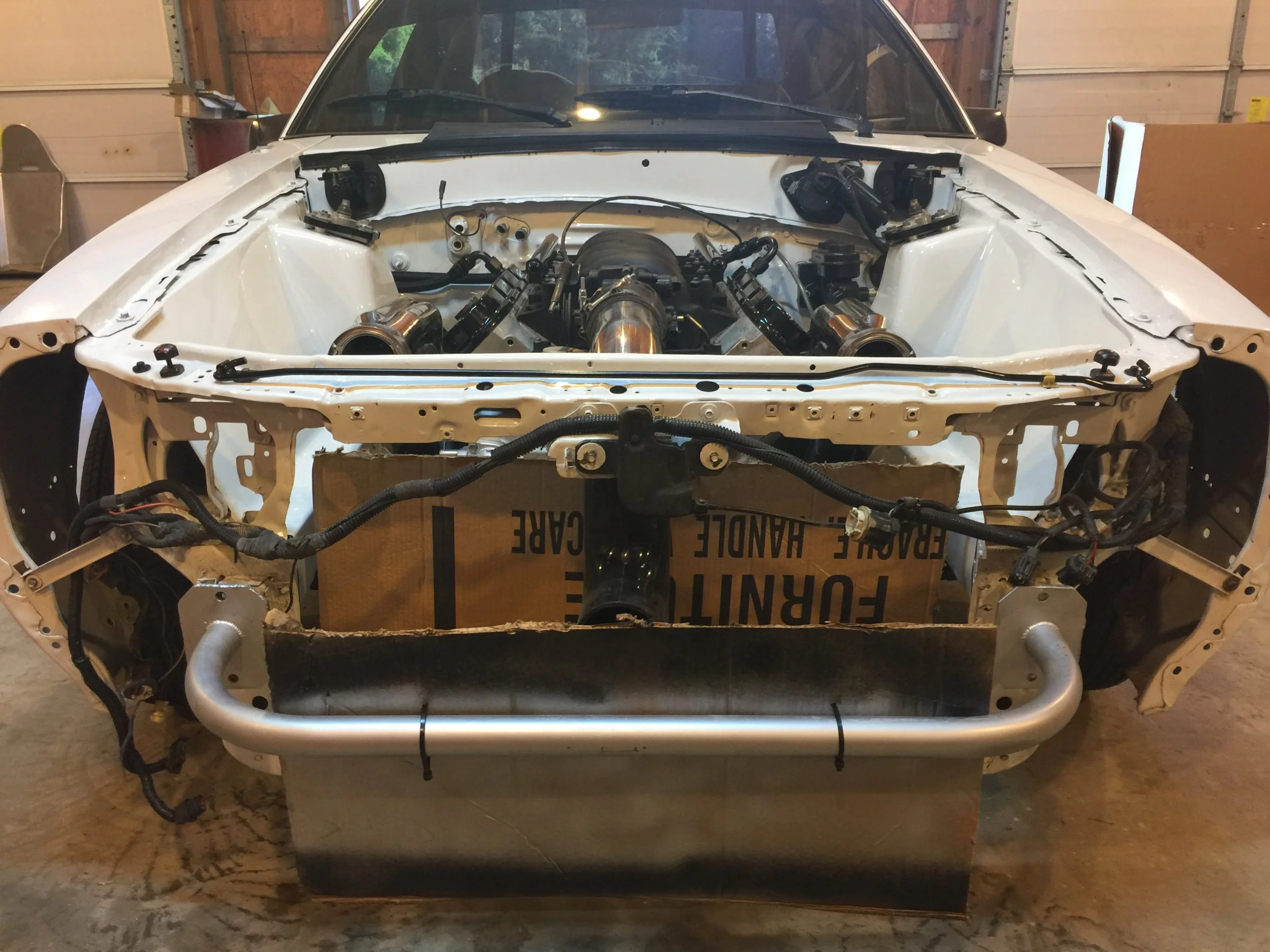

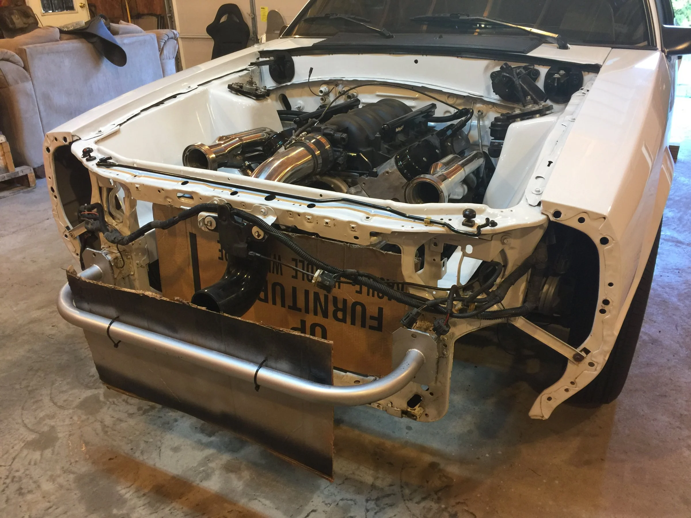

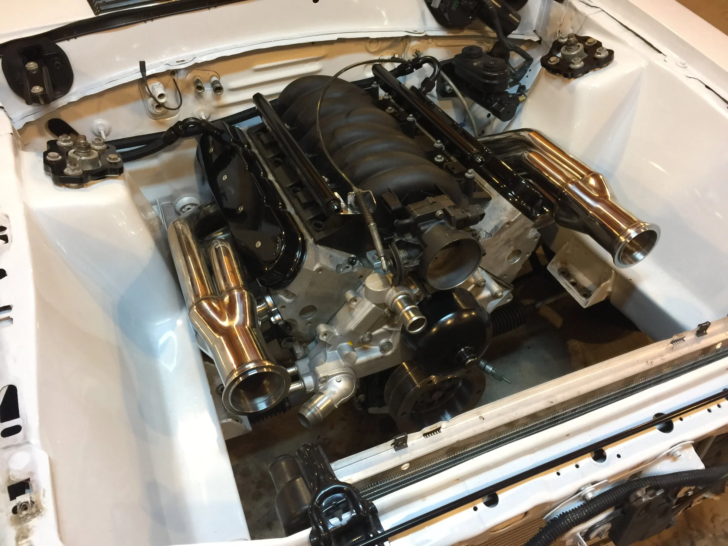

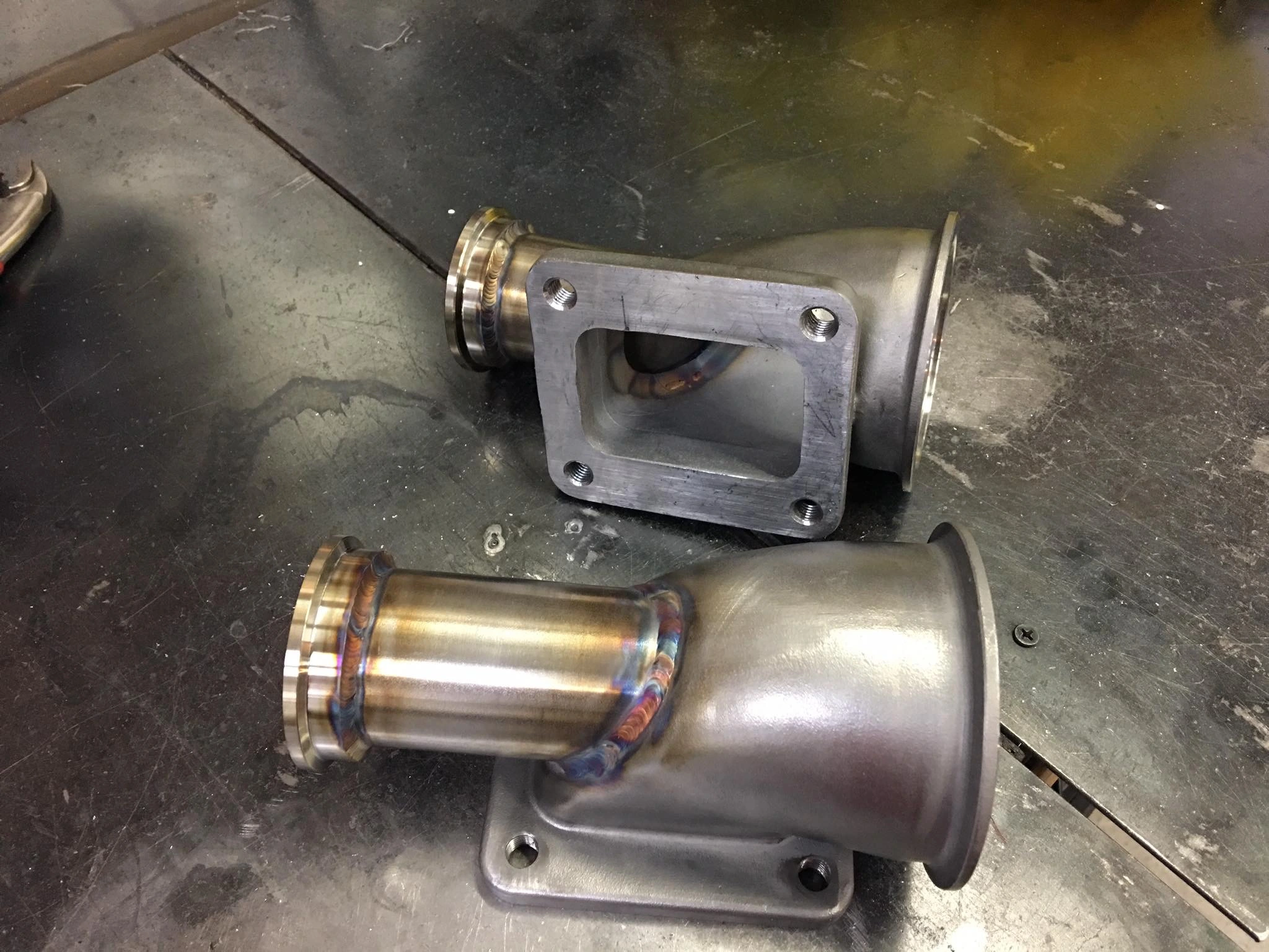

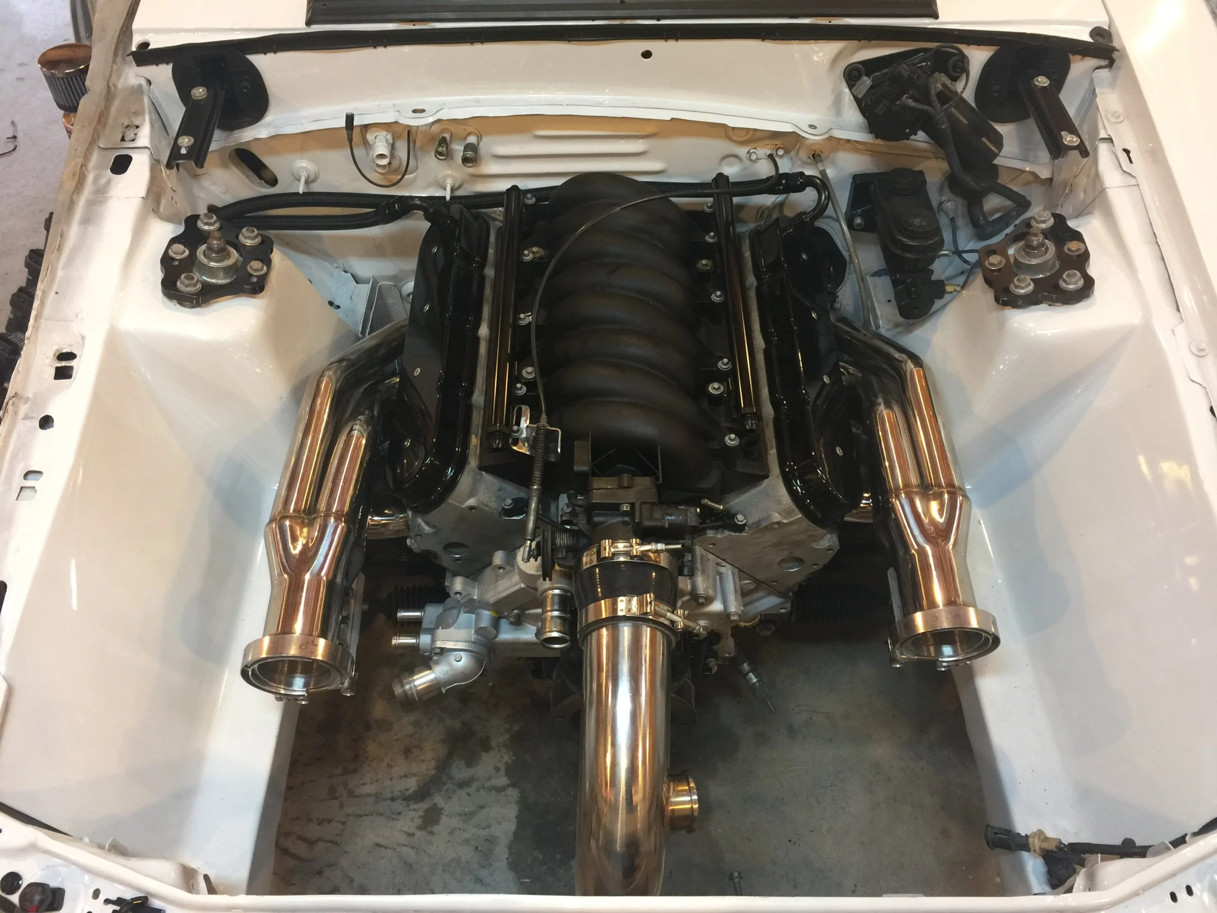

Elbows won't be here for a week or two so I don't have any cool turbo pictures. These headers feel like they'll need to be braced but I'm otherwise happy with my $150 purchase. Anxious to see if they'll need modified or not
What's the rust situation looking like?My V bands are all stainless, welded to mild steel. No issues yet, been through a dozen or so heat cycles, if not more.
Haven't noticed any yet, but the car really hasn't been exposed to a whole lot of moisture either. Regardless, it's all getting ceramic coated soon so rust really wont be an issue.What's the rust situation looking like?
This will be stainless to stainless. I imagine the weld might rust but I'm 50/50 between painting and/or wrapping the hotside anyways.
My downpipes will be mild at least.

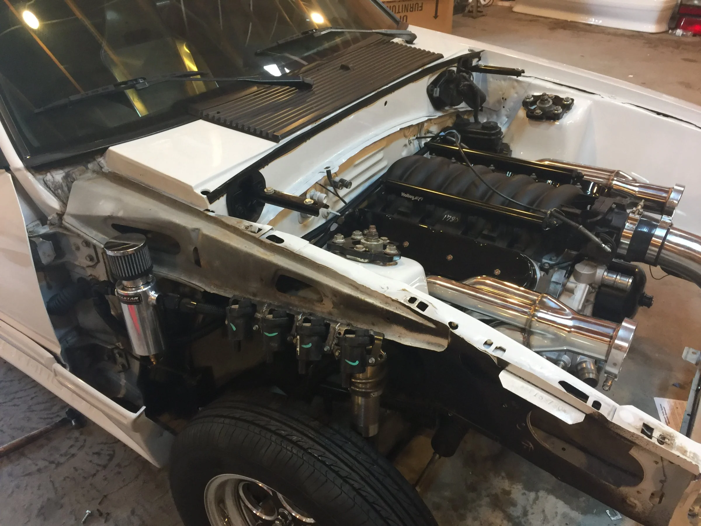

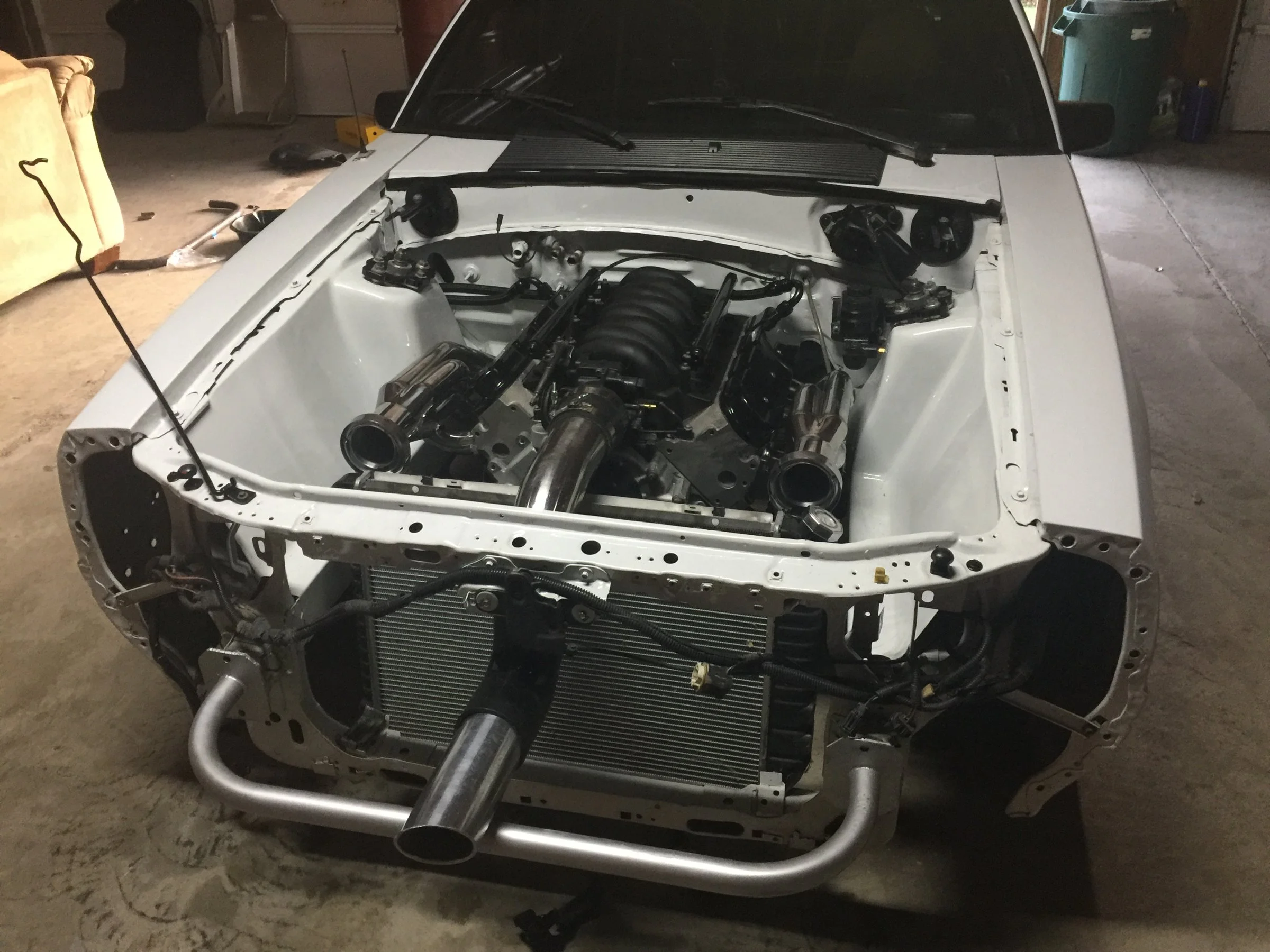

When you can't get an idea out of your head but you don't have any parts for a few more days, you use dimensionally accurate cardboard cutouts.
Still not 100% that it'll work but if I can find the right oddball radiator I think I can do the center outlet like I want to.

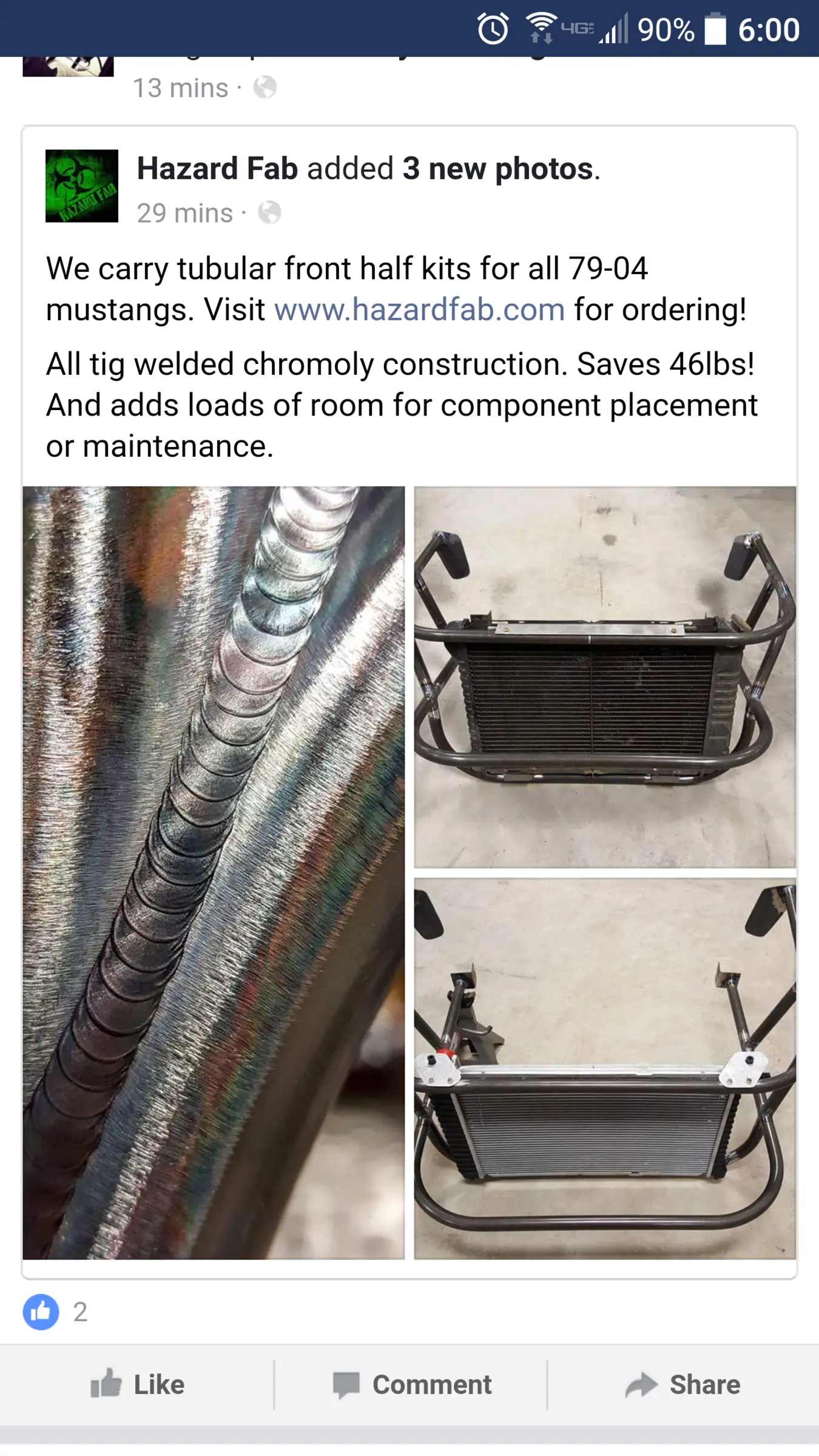

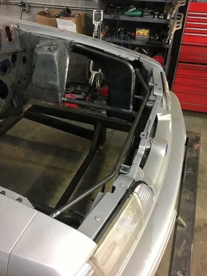

A buddy of mine makes a full tube front end that weighs 17lbs.Maybe something like this or am I completely missing where you are trying to go?
