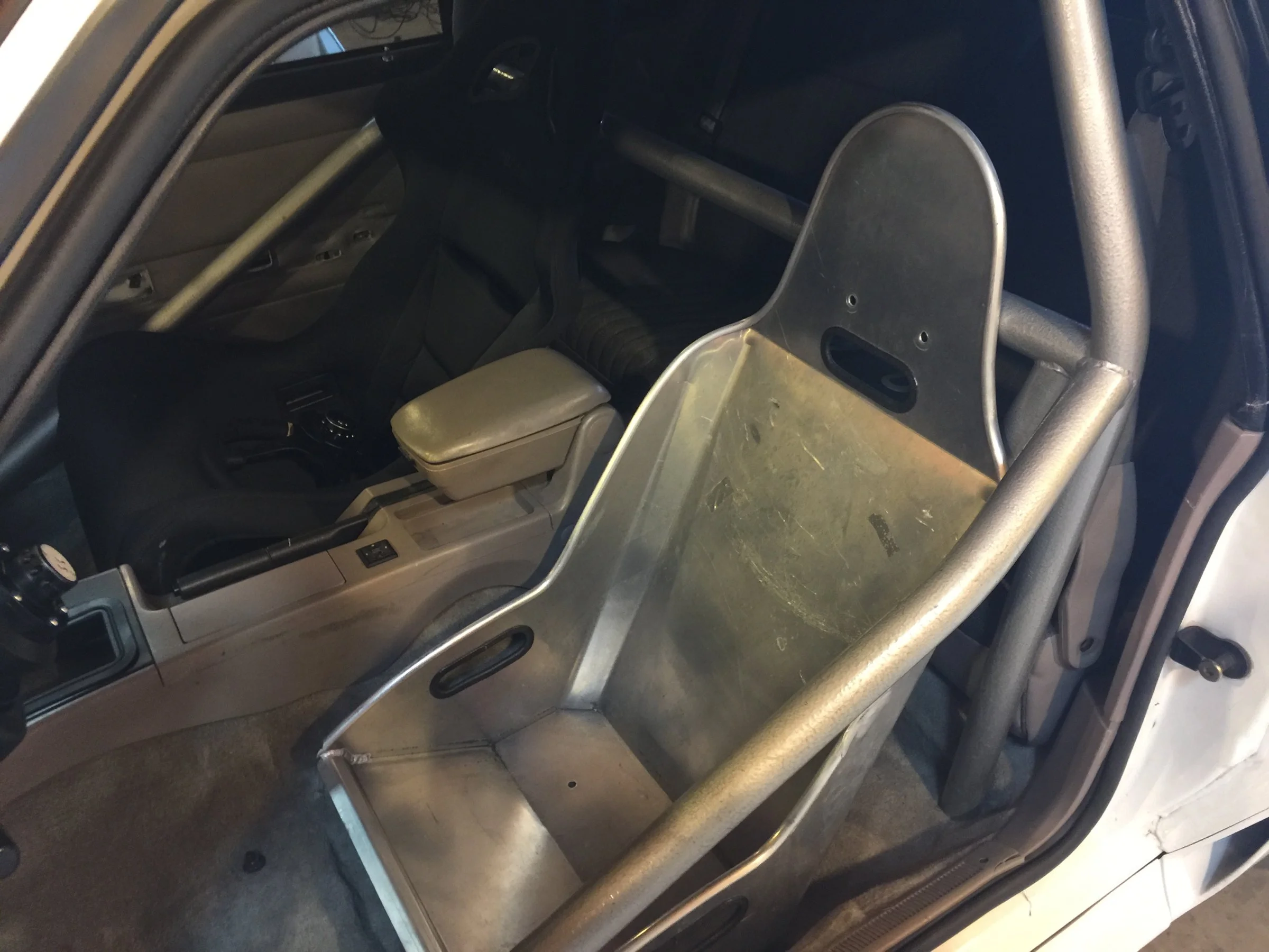

Got a pair of aluminum seats (didn't cost me anything) and I'm not sure I like them. I don't really like the Procar seats and I'm torn between finding a set of stock seats or getting a set of kirkeys with covers. These are Jaz seats and they were in a corvette my buddy bought a couple days ago. I feel like they're too short in addition to being uncomfortable

Comfort > Racecar

hoopty5.0 said:
Comfort > Racecar
Everyone I've talked to says that Kirkeys with covers are pretty comfortable

Those Jaz seats are terrible when compared to a Kirkey. (I've had both) The Jaz hits you across the back of your leg where that reinforcement is even w/ the upholstery, whereas the Kirkey is waay more form fitted, and actually comfortable.
Good to hear. I've gotten a lot of recommendations for the kirkey seat with a cover. Have to see what they cost. Might go on my winter 2017 list. On the fence about some cage additions as well so maybe that can all get packaged together.
Trying to stay focused on getting it running and put off all the other stuff I want to do like change the rear bumper, add to the cage, change seats and door panels and all the rear suspension stuff. If i get carried away trying to improve a car I haven't even used yet I'll inevitably sink the ship.
