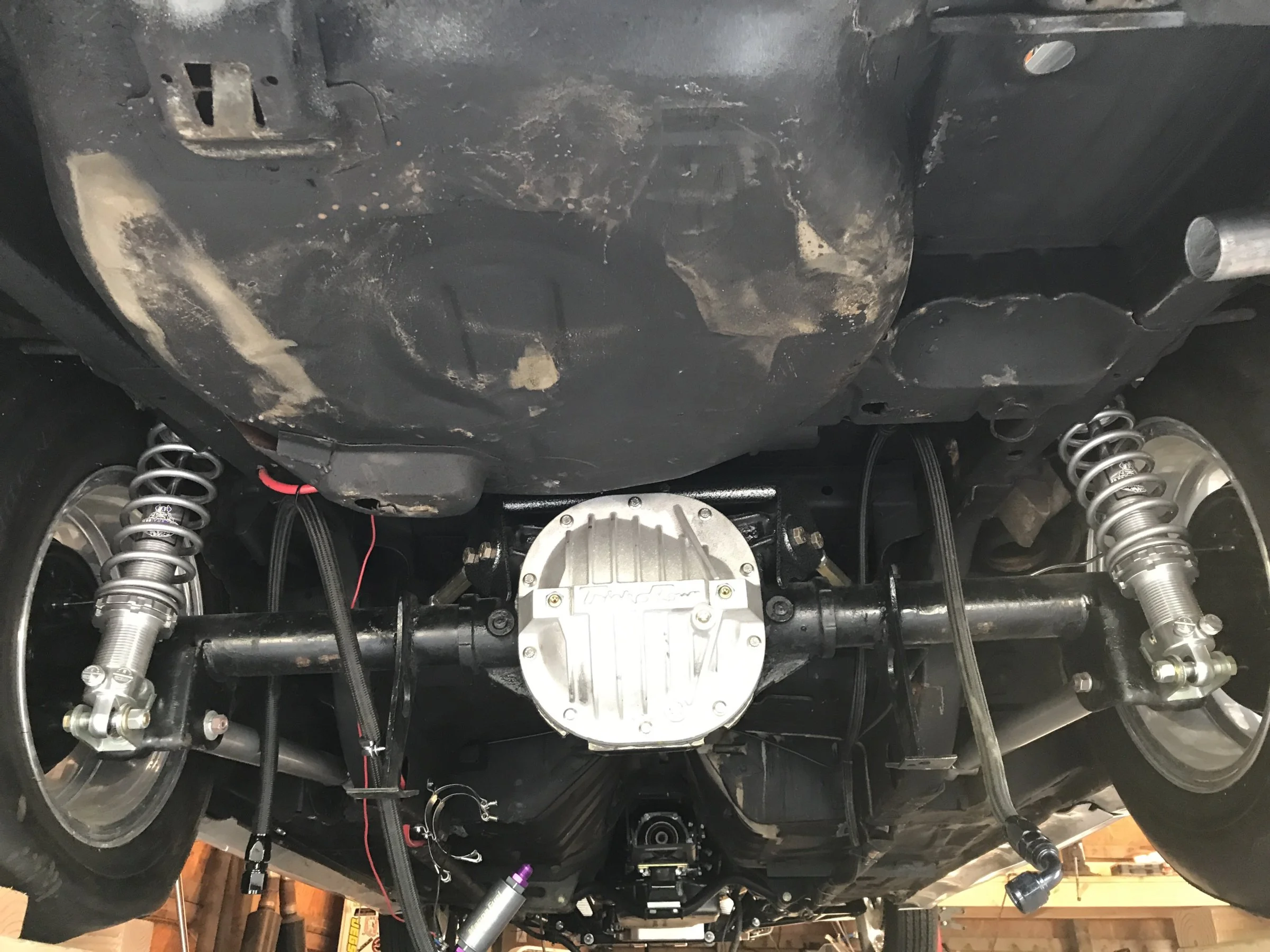

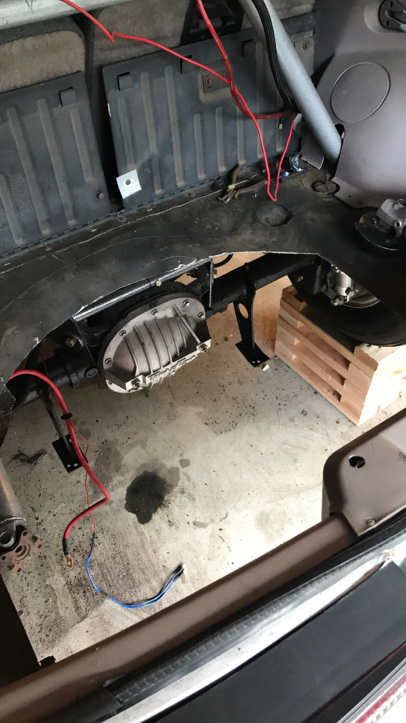

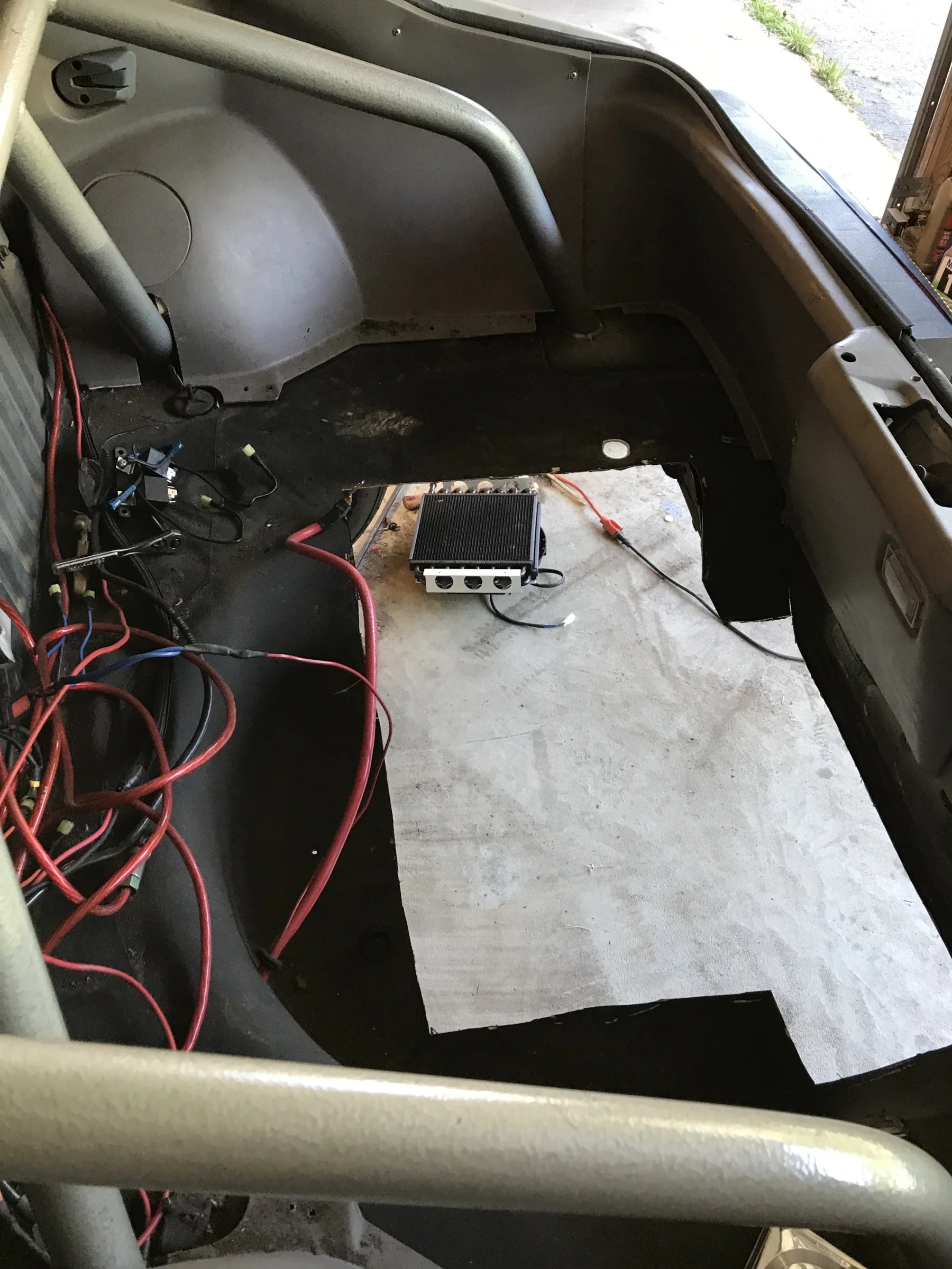

Anywho, little "progress" this afternoon.
Apparently this is what a car looks like when it's "pretty much done" and could "totally be driven"

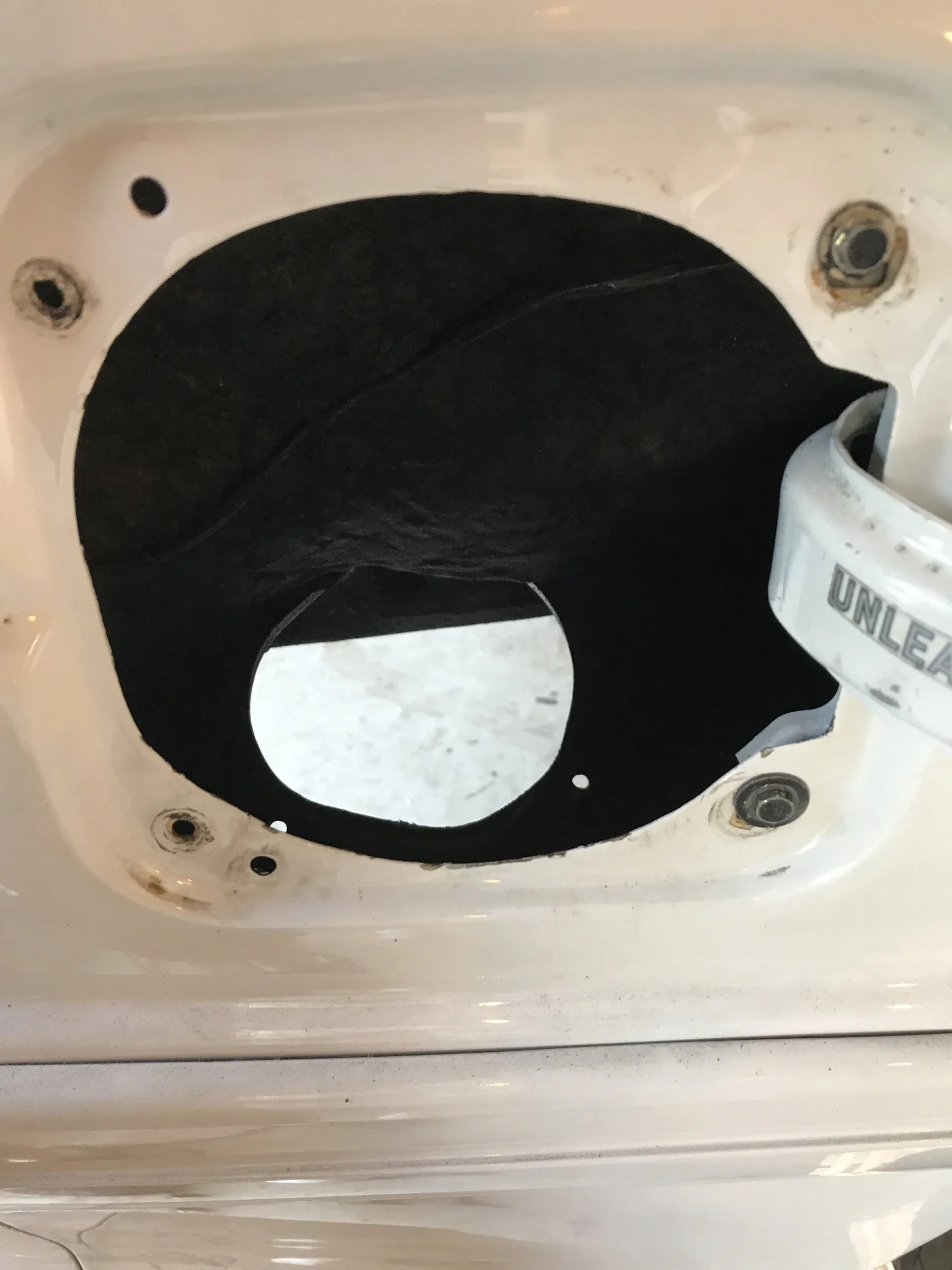

Dropped the factory tank and drained it.
Removed the filler neck stuff as well.

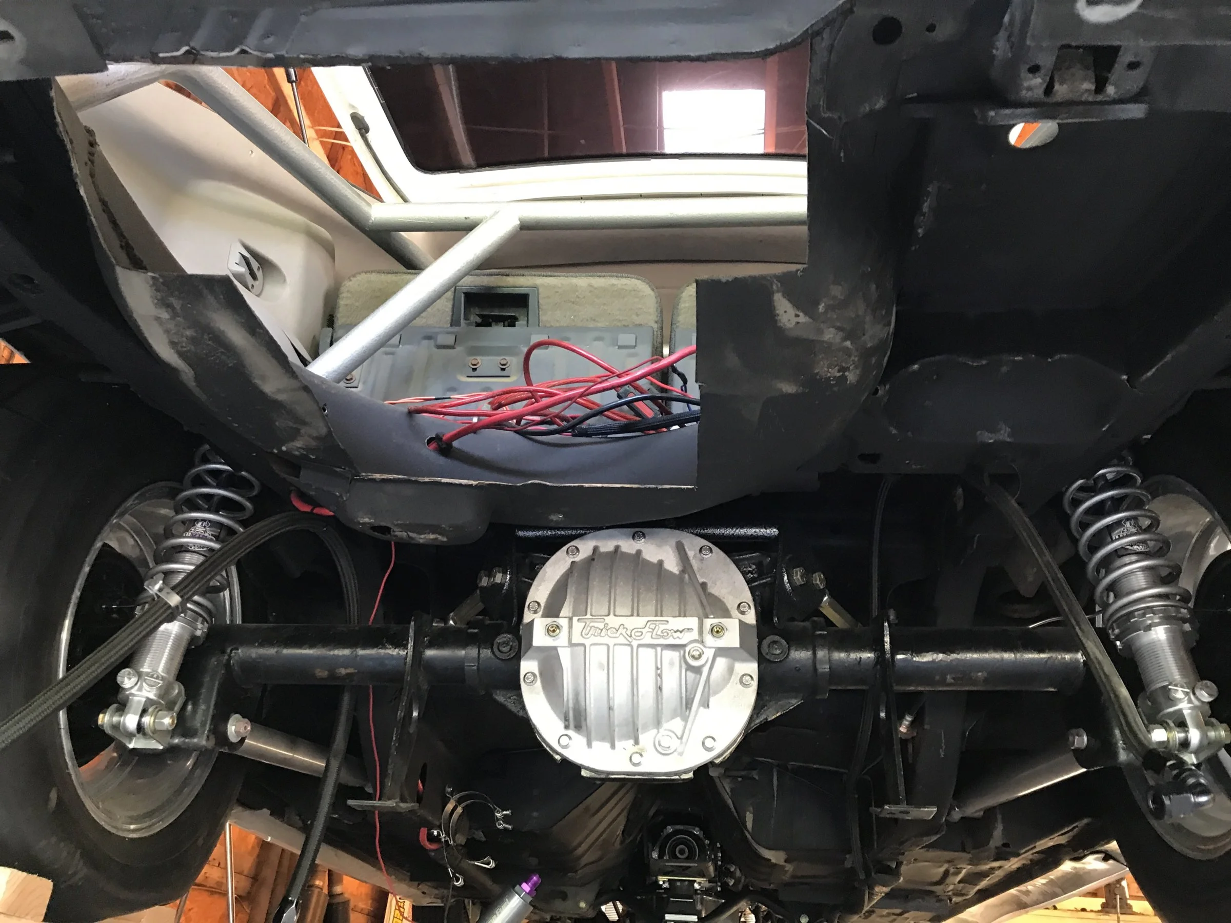

Cut out the dimensions of the tank so that the sump can hang below the trunk floor.
Also had to cut out the hump in the middle.
Ended up cutting out a little extra so that the trans cooler can go out back where I wanted it.
You'll have to see passed the rough cut out and birds nest of wiring. Looking forward to rewiring this whole operation as well here soon.
It's likely I'll cut out the rest of the spare tire well and make the floor flush in the trunk. Just want to get the cell and battery where I want them before I get too carried away (probably already did).
Ordered an adjustable pushrod for the MC and a couple fuel fittings. Hopefully this won't put me down for too long. Only goal for the year is still to cruise it around and work out all the bugs.

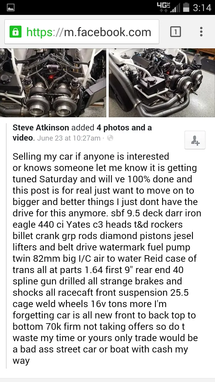

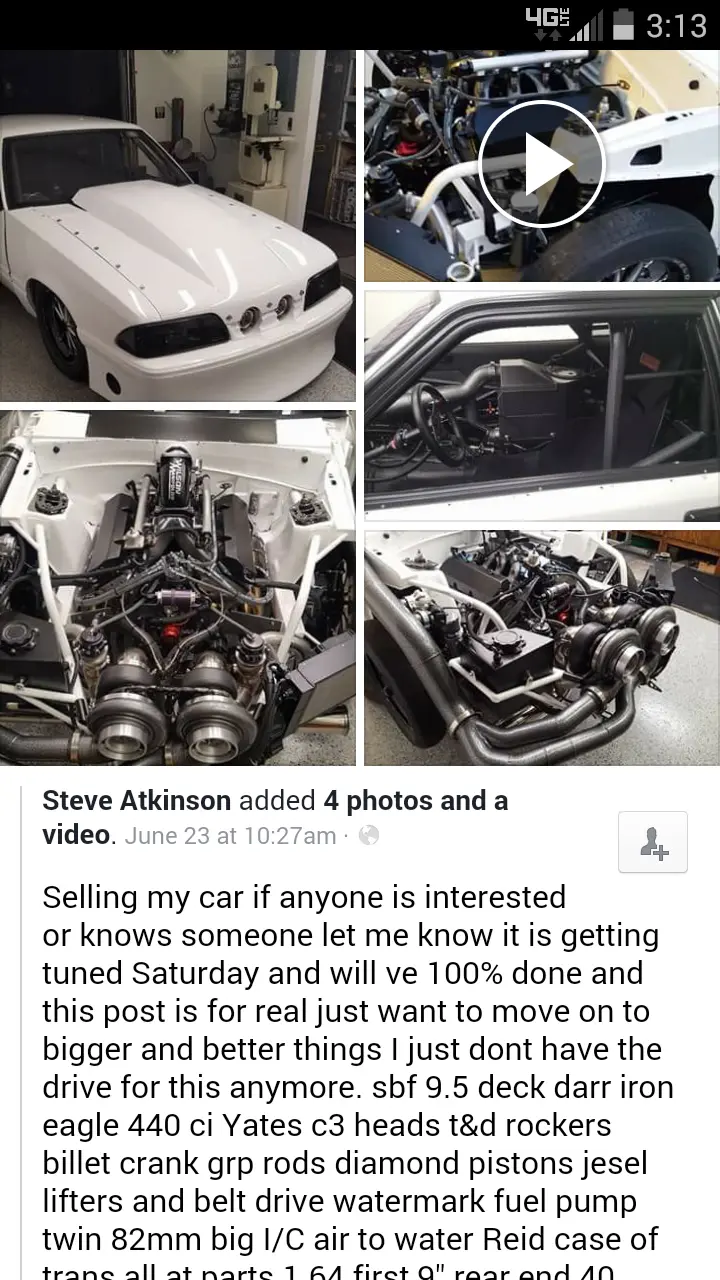

I figure that guy got pissed working on the car and posted it for sale. All of the typos are an indication of that. If he really wanted to sell for 70k he woulda altleast proof read the add...

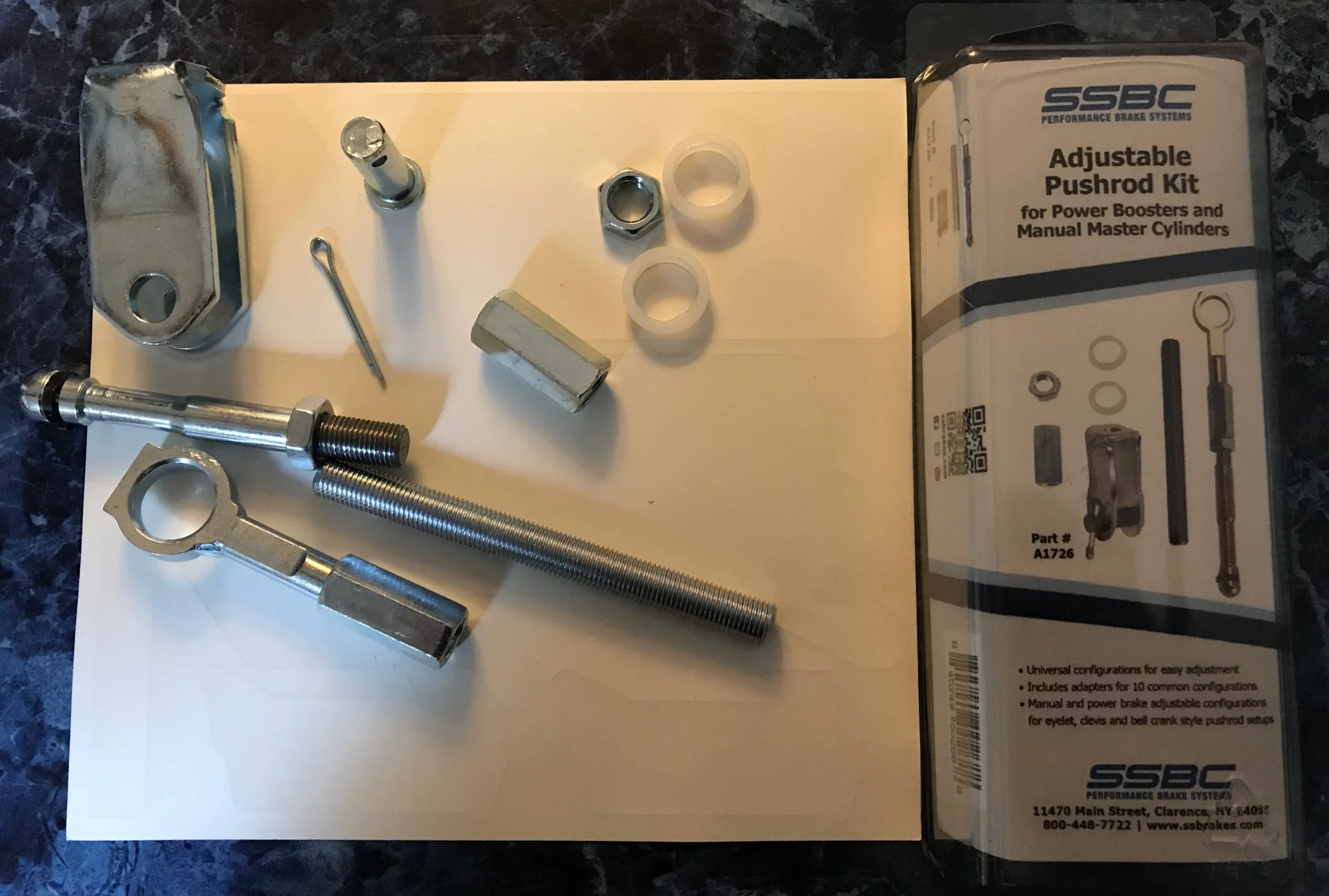

Did find an adjustable pushrod kit to finish out the brakes.

Fixed the broken brake line, the SSBC pushrod kit works great, just broke my neck trying to get under the dash.
