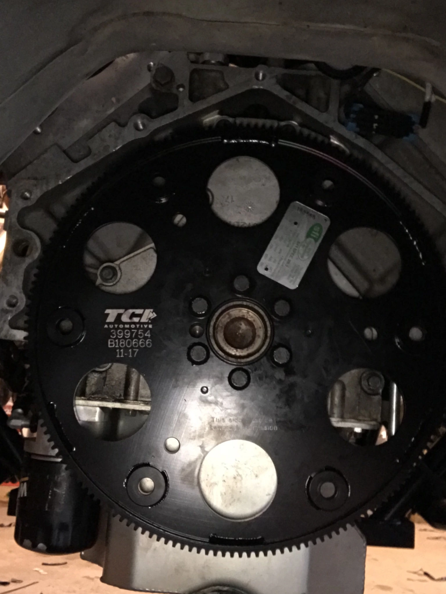

Trans out, flexplate swapped, and transmission back in. All in about 2 hours. By myself, on the floor, with a floor jack.
Unfortunately getting good at this part.
Only dropped the transmission on my hand once!
Finally think it’s in there for good. I was able to toss in a converter spacer that I had honestly forgotten the first go around after I got wrapped up in the converter not bolting up. Which it does now, nice 1/8” gap at the pads and all that jazz.

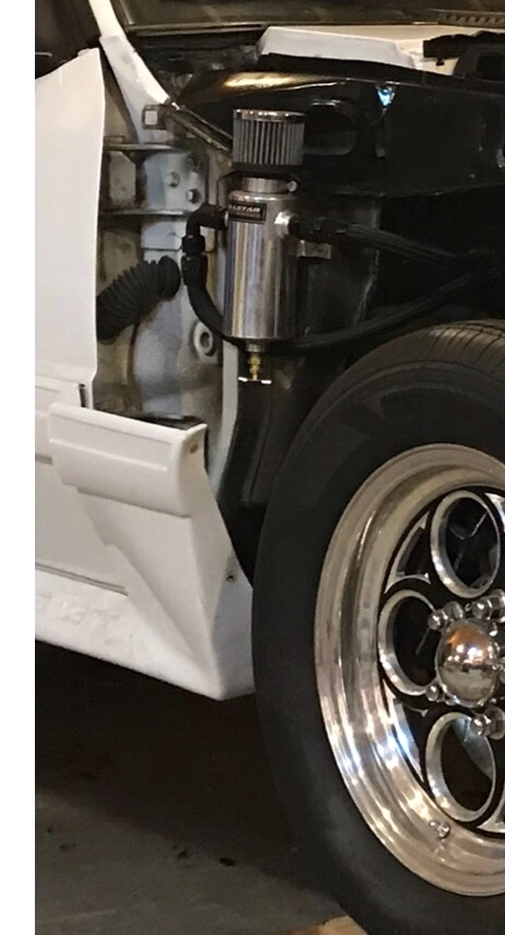

Will you be able to drain your catch can(s) with the fenders on?
Yep, it can be reached through the wheel well. Even easier with the wheels cut. :nice:

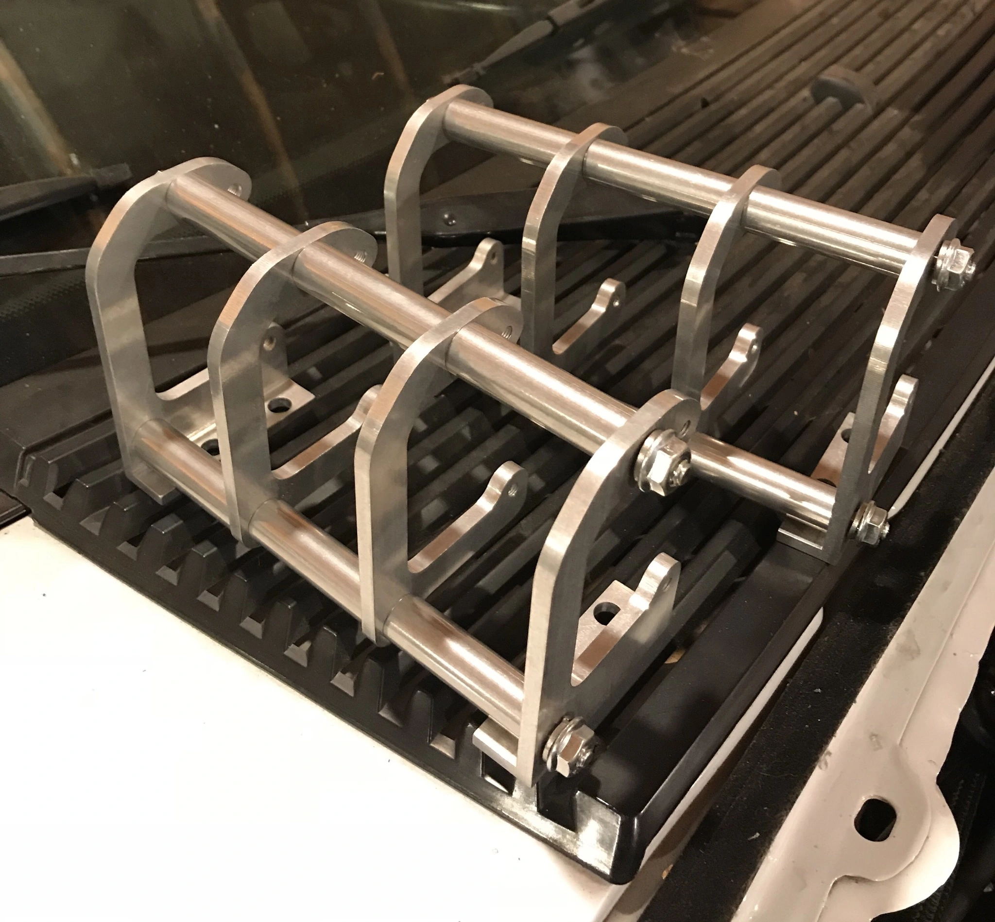

These ICT brackets might help pretty-up my coil situation. Assuming they’ll actually fit anywhere. Still up in the air on where...

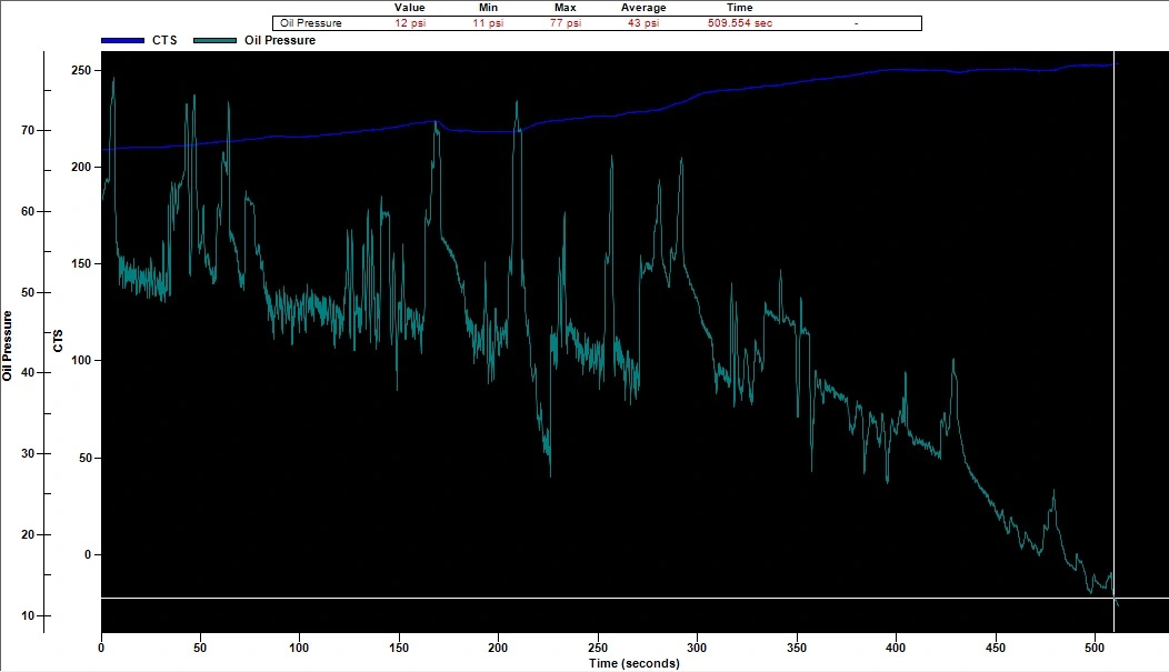

Drove around about 10 minutes before it overheated and I had to shut it down. Sadly I was also shutting it down because the oil pressure dropped down into the low teens. Got it back into the garage before it got dark at least. Don’t have any more info than that at this point.

Before the low oil pressure and overheating- How was the drive going?
Nothing to hide here.
Engine temp reached 250 and the oil pressure was at 14 when I shut it off.
I had put some BR7ef plugs in and the car ran like hammered hell. Changed to a known working tune file and when that didn’t help we switched back to a TR6 plug.
I missed that the fan output was no longer pinned in the ECU.
It also wasn’t displayed on my dash like it should have been when I pulled out.
I was monitoring the timing, learn status, oil pressure and IAC position (old car had IAC issues like crazy).
Everything looked great as I drove. Drove about 1/4 mile from the house and turned around in a parking lot.
On the way up an incline I noticed the oil pressure was dropping out and there was smoke (steam) visible through the windshield. I assumed I had lost an oil line somewhere and when I got to the top of the hill I shut the car down.
I hopped out and saw it was a radiator hose and the coolant temp was reading 250. Obviously that was a major misstep on my part.
I believe the scaling for the oil pressure sensor is innaccurate so the numbers themselves may be wrong, but the decline would be real either way.
I think that the oil pressure was a direct result of the engine getting far too hot.
I also was unable to restart the car due to some sort of electrical issue so even after it cooled down we ended up pushing it an 1/8 mile or so to my garage.
The oil isn’t milky, the pressure relieved at a hose connection. I don’t know what the hell was going on under the dash electronically.
