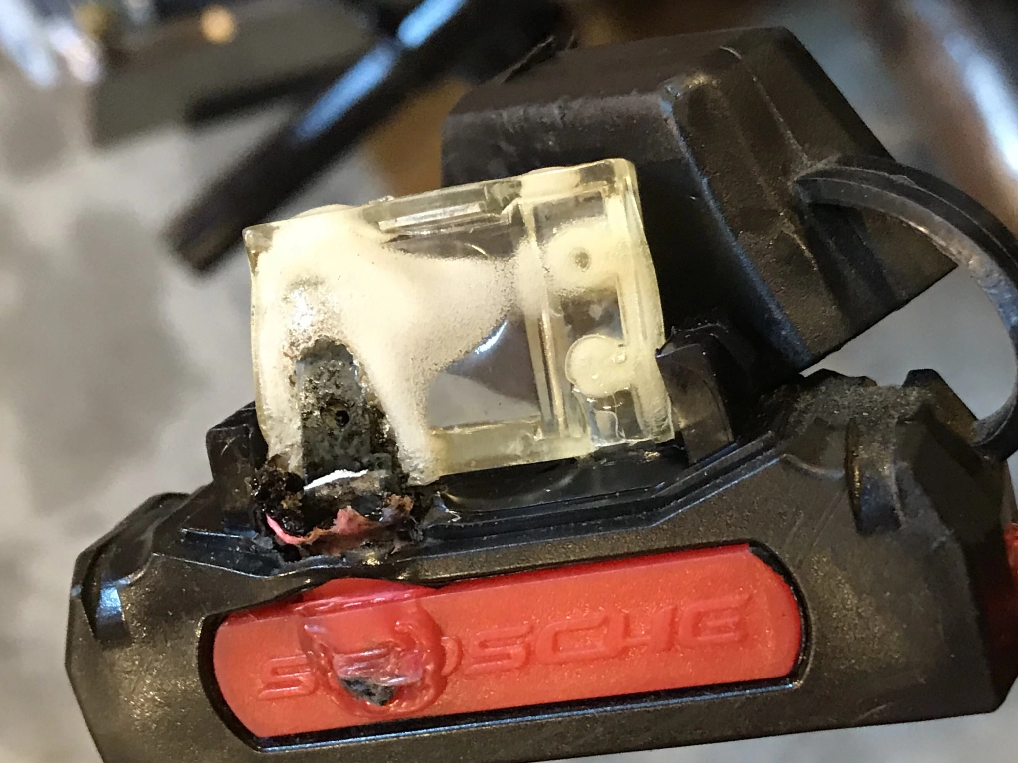

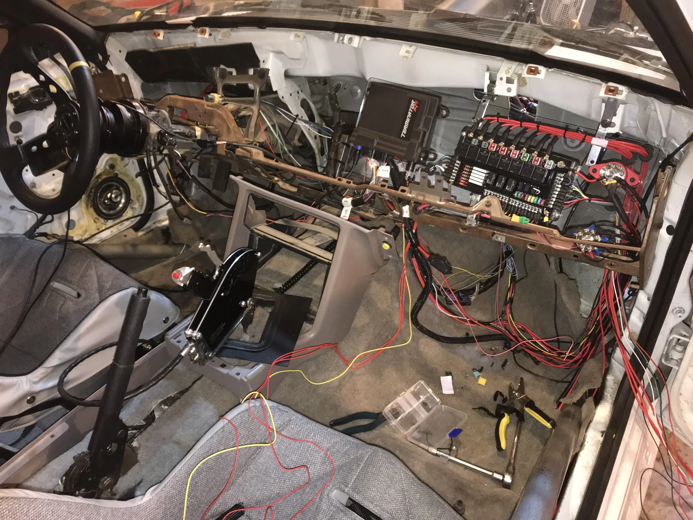

Pulled the dash out, undid all the wire wrap and went to work with a multimeter. 2 hours later I found a fuse that had completely melted.
All is well electronically. Other than i have to put it back together.

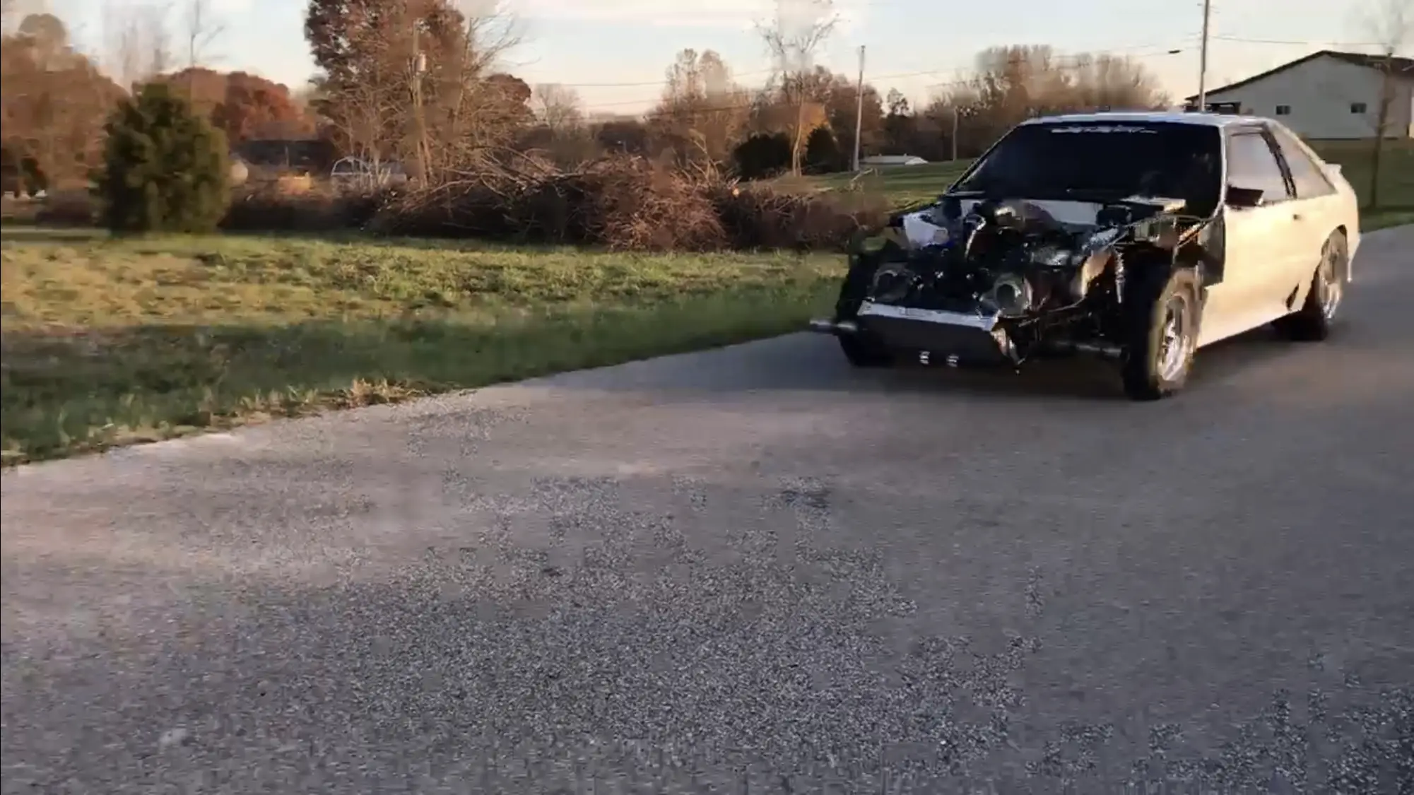

Little change of scenery
What's the full load across that fuse block? What size wire.... I Only ask cause usually they don't just spontaneously burn up for no reason.
I think it shorted through the side of the fuse holder where it was laying. It melted through the side and I had to use pliers to open it.
To be honest it probably shouldn’t have been there to begin with. I was concerned with protecting my circuit board when I was wiring and testing everything. There’s 2ga running from the battery to the positive post under the dash. That post is just for power to the Leash board. The ECU is powered directly from the battery and the starter draws direct from the battery on a separate circuit as well.
The relays on the board are 70amp rated (total) and the fuses for the fuel pumps are 60amp (fans and other things have smaller rated fuses).
The fuse that burned up was an 80amp.
The trunk isn’t finished so there was some wiring just kind of... tucked away and I think it shorted to the floor of the hatch. I will find out I guess.

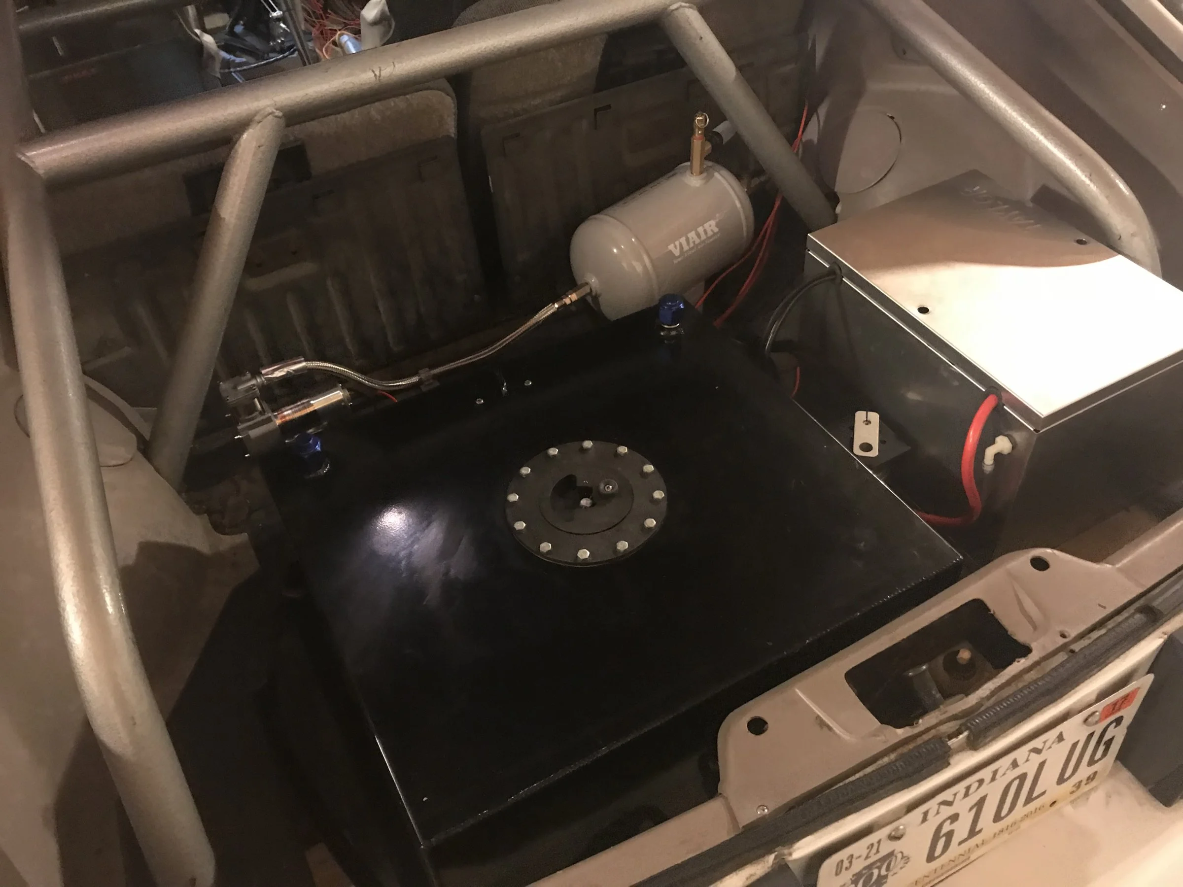

Compressor is mounted in the hatch. Thinking about flipping it over and mounting it under the car but it really isn’t loud at all.
Tank isn’t mounted as I’m waiting on a regulator to know where it will fit. I neglected to order one hoping my c02 regulator would carry over but it did not.
Rather than buy fittings to make it work I’ll just leave the c02 kit whole and try to sell it.
Explain to the simple minded folks like myself what the CO2/compressed air controls? Wastegate only?
Yeah, it’s for the wastegates. Co2, or in this case compressed air, is being applied to the top of the gate. I’ll be regulating to 60psi most likely. It gives more precise control than you can get from just applying manifold pressure.

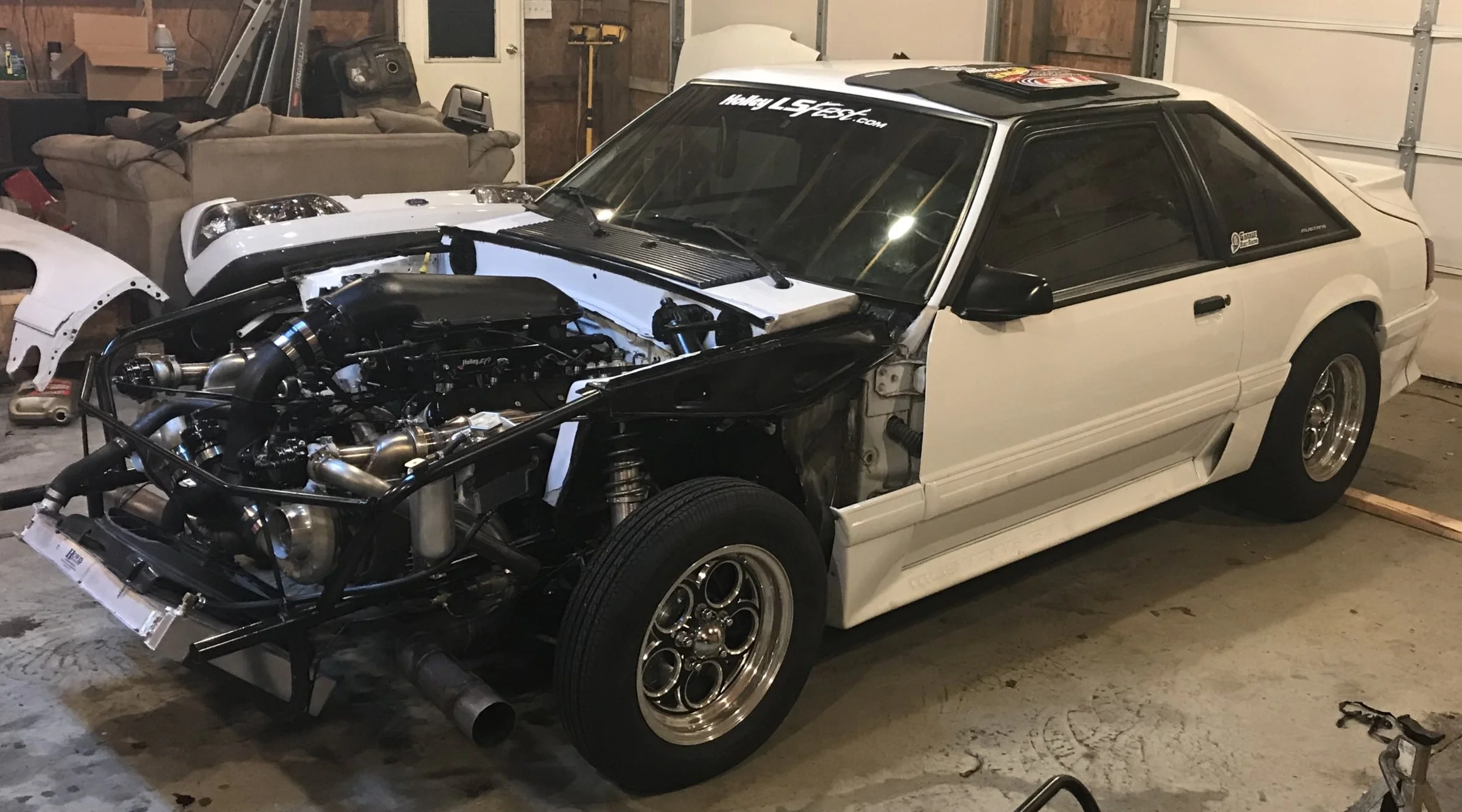

Got the chance to put an 03-04 (roller) car back in my garage and so I grabbed it up.
Even took the holesaw to it the first night for a chute mount :nice:

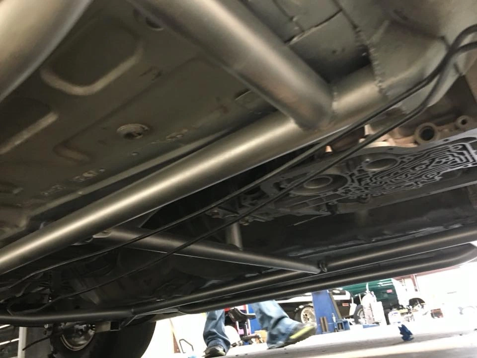

Car has a lot of nice parts and a very nice custom cage. I’ve got an awesome chassis shop building a badass 8.8 to put under it and some other cool stuff in the works.
The foxbody is even going to get some hand-me-down love in the form of the disc 8.8 currently under the cobra. And will get her wheels back of course :rolleyes:

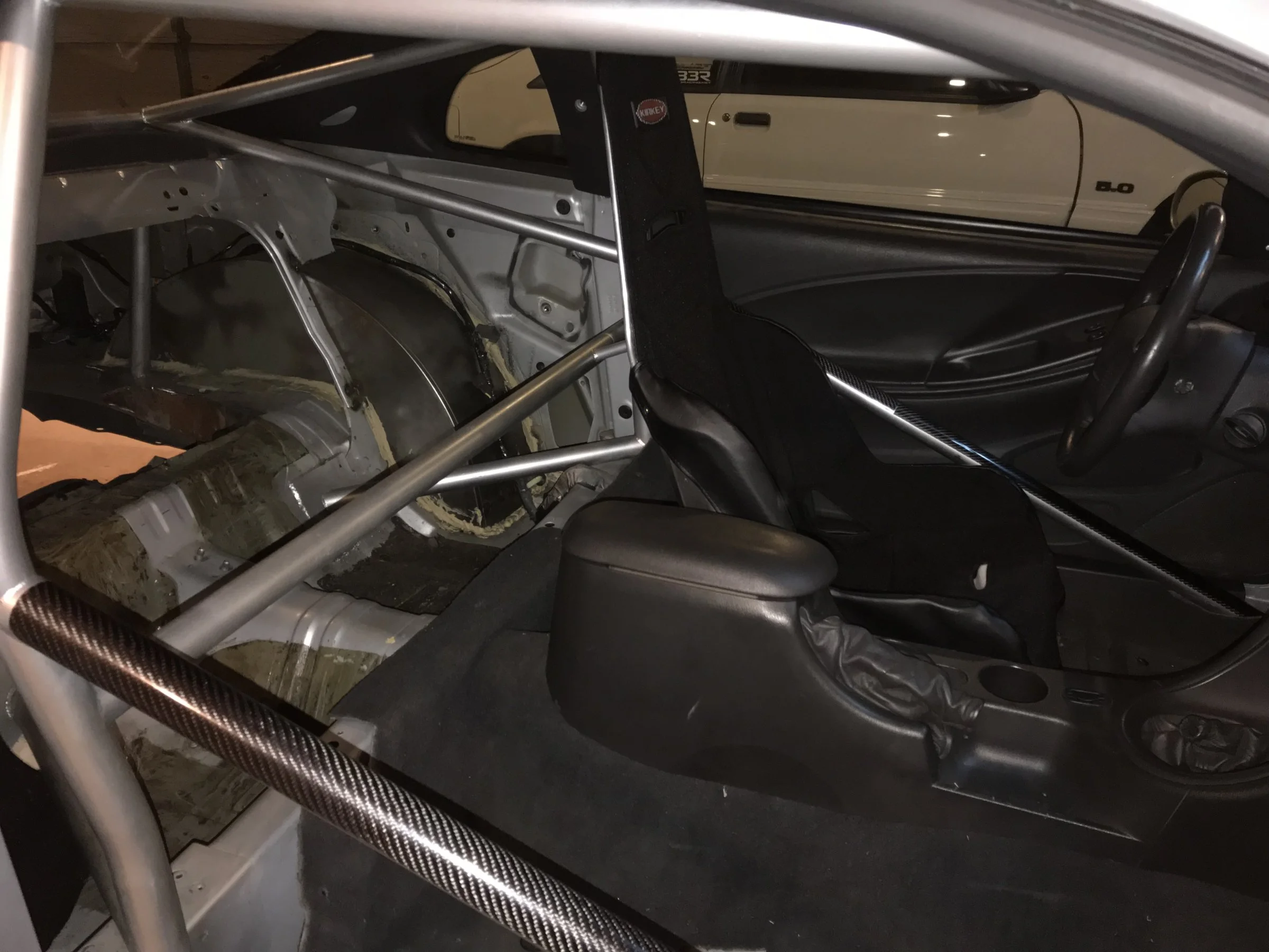

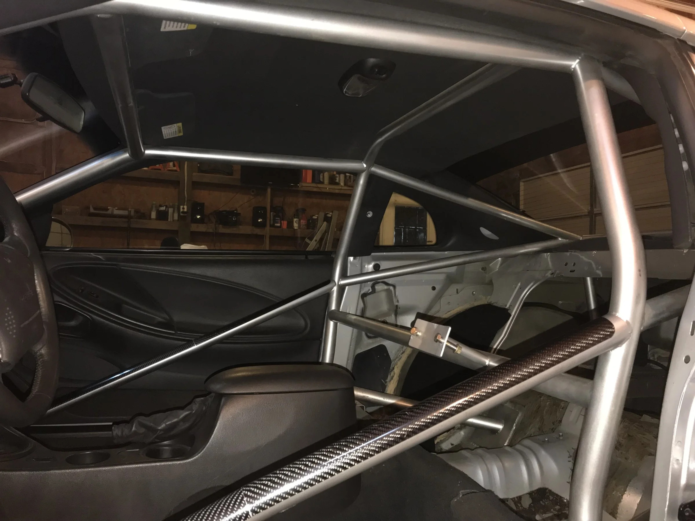

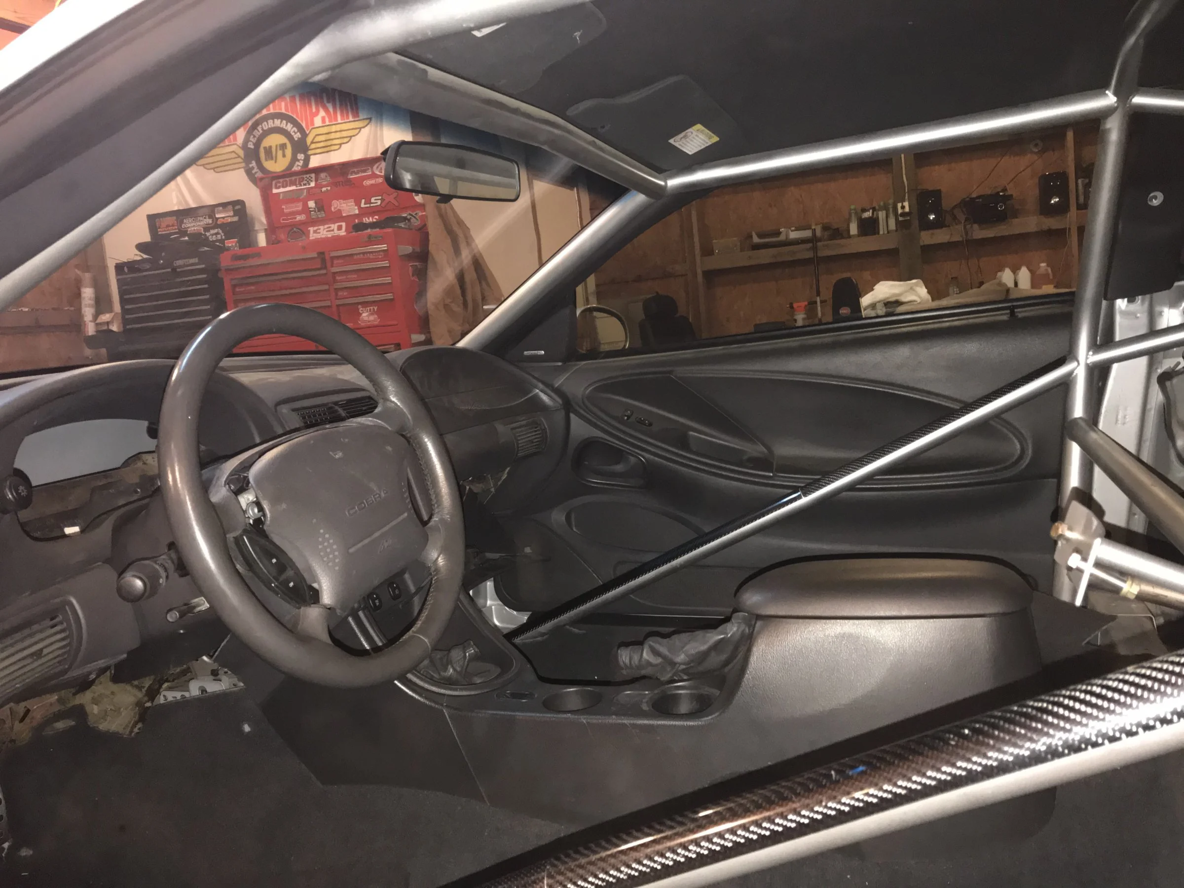

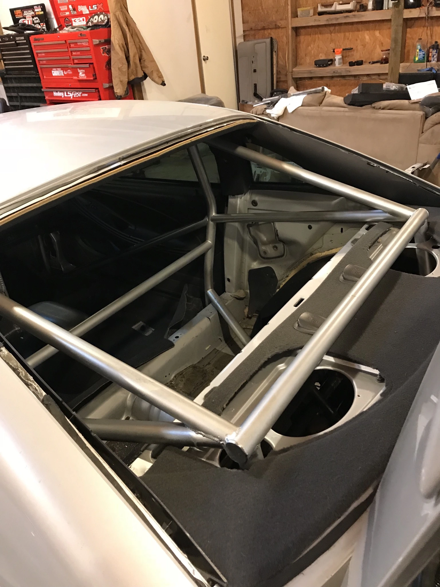

I know you where talking about race classes and lack of safety awhile back-is the Cobra the answer to that?
Yeah. It’s got the kind of cage I wish the white car had and then some. I added the parachute as well.
