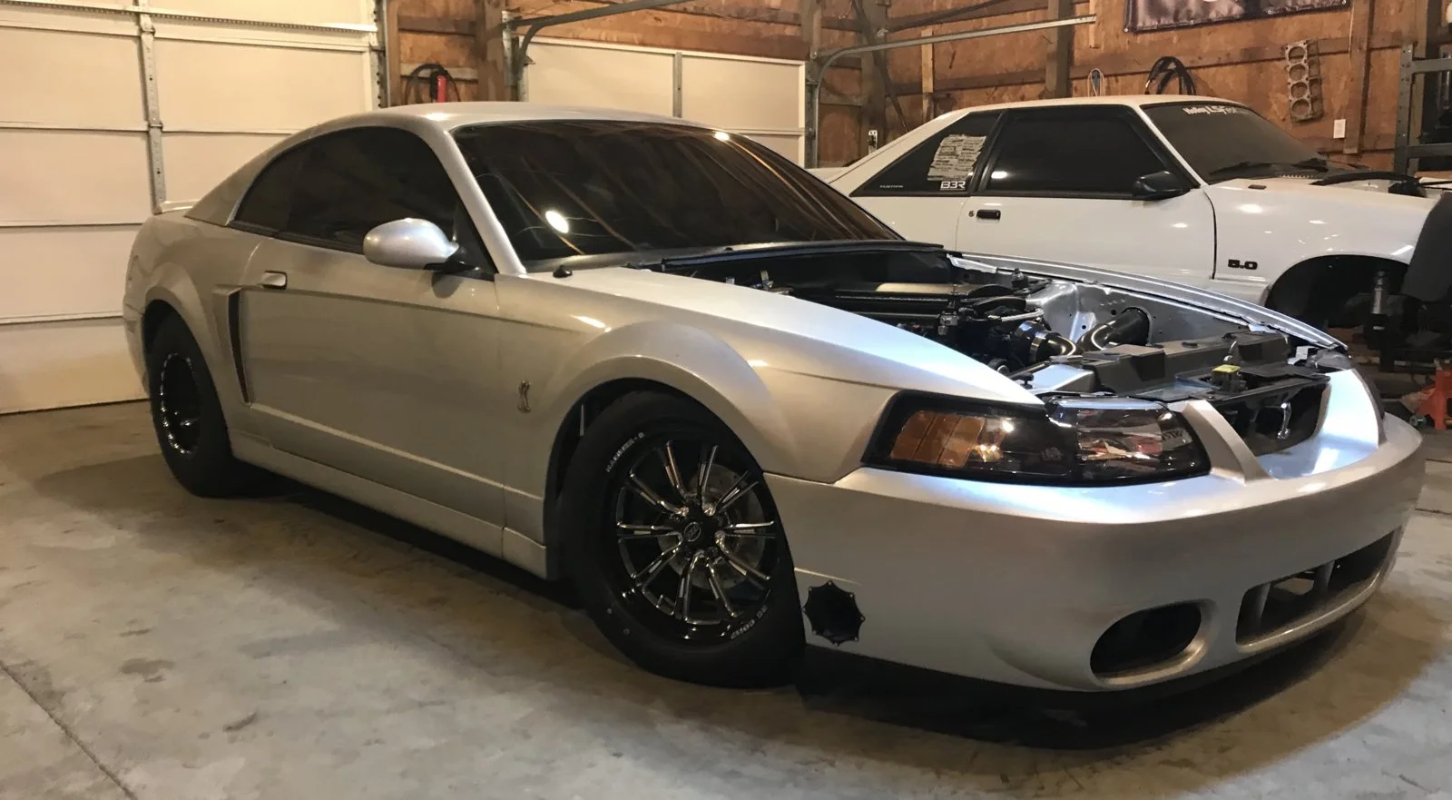

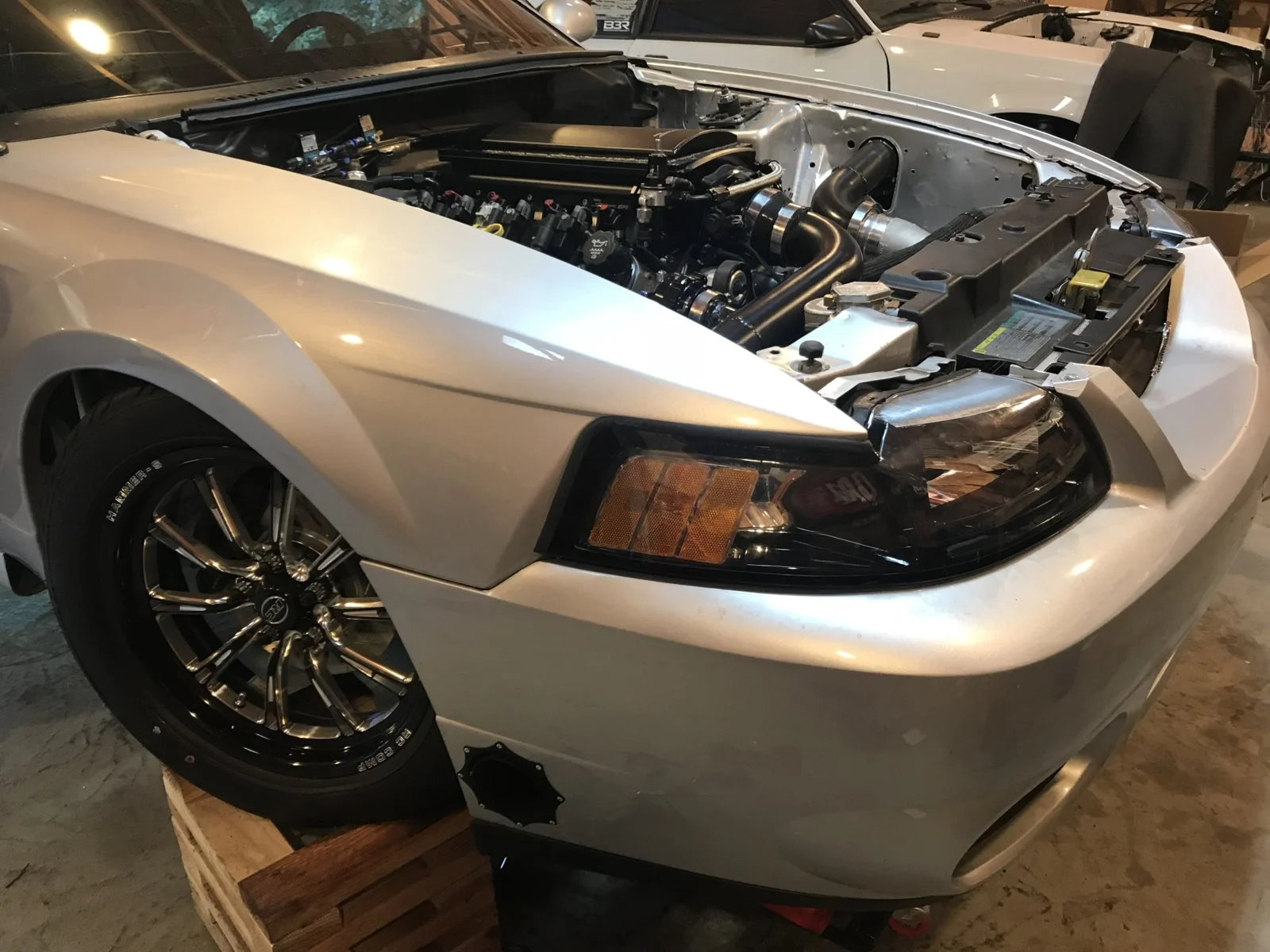

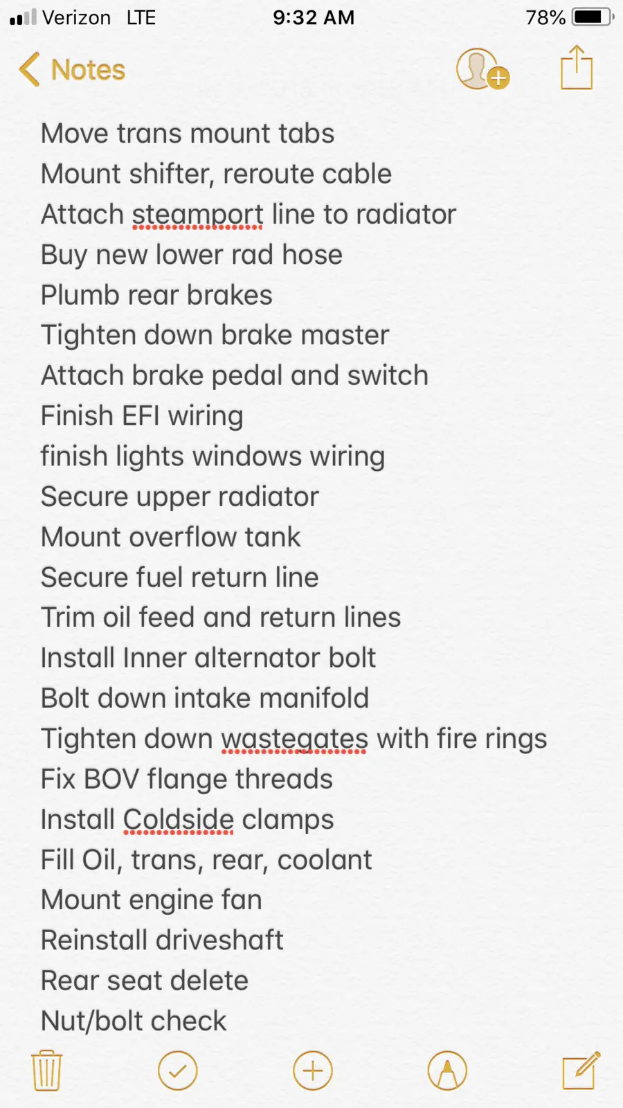

Hopefully get some of the smaller stuff done this weekCan't be much left to do, right?
There's nothing pretty about an engine fire from an electrical meltdown, you did right. I'm loving that front bumper, where's it from?tannerc91gt said:Not as pretty as it was but far more functional. That’s how I’m coping with it at least

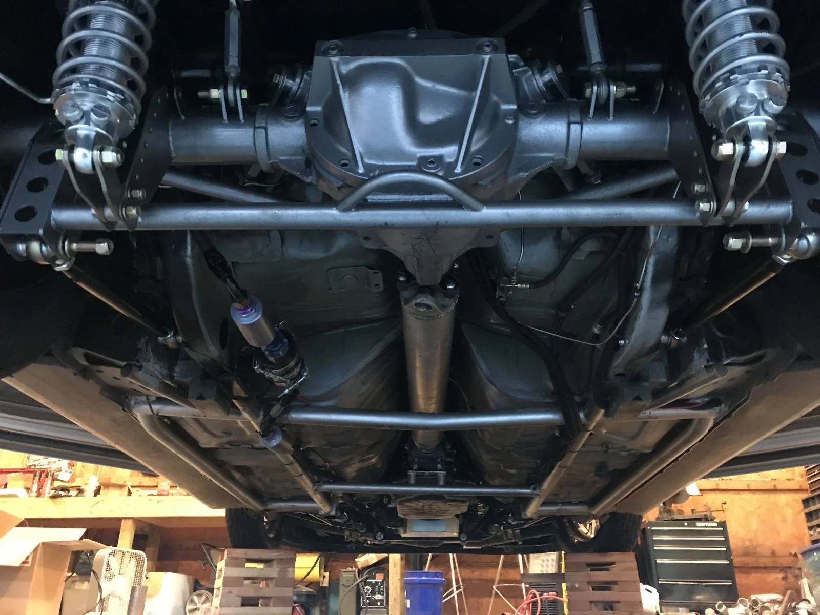

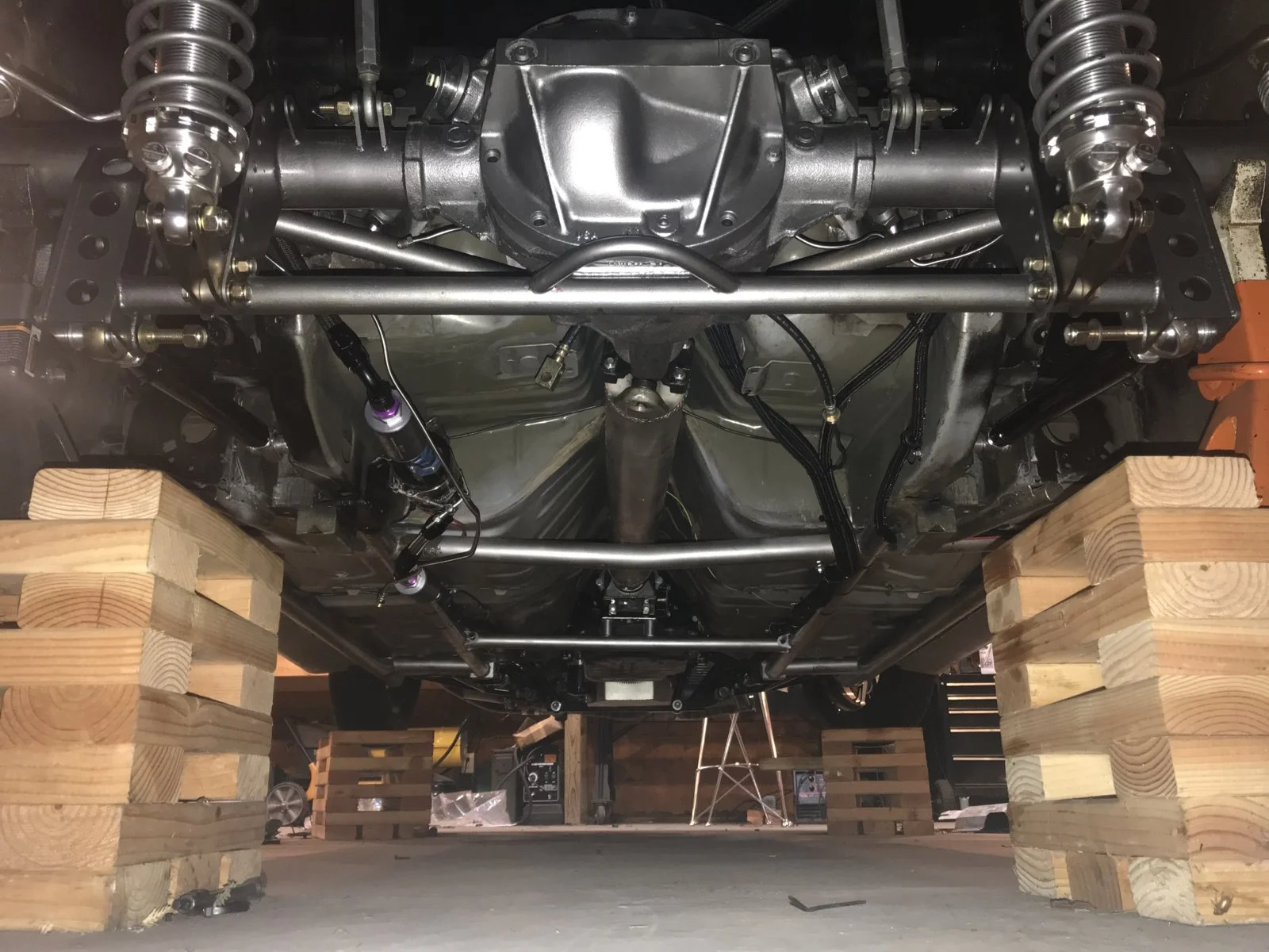

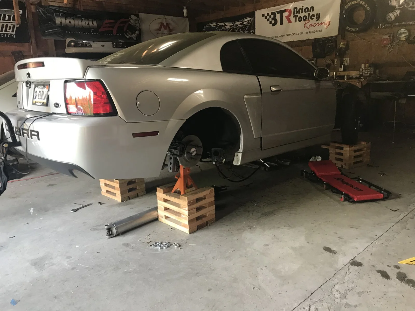

Trans mount cut off, moved and rewelded. Driveshaft installed. Fancy Amazon turbo blanket installed .

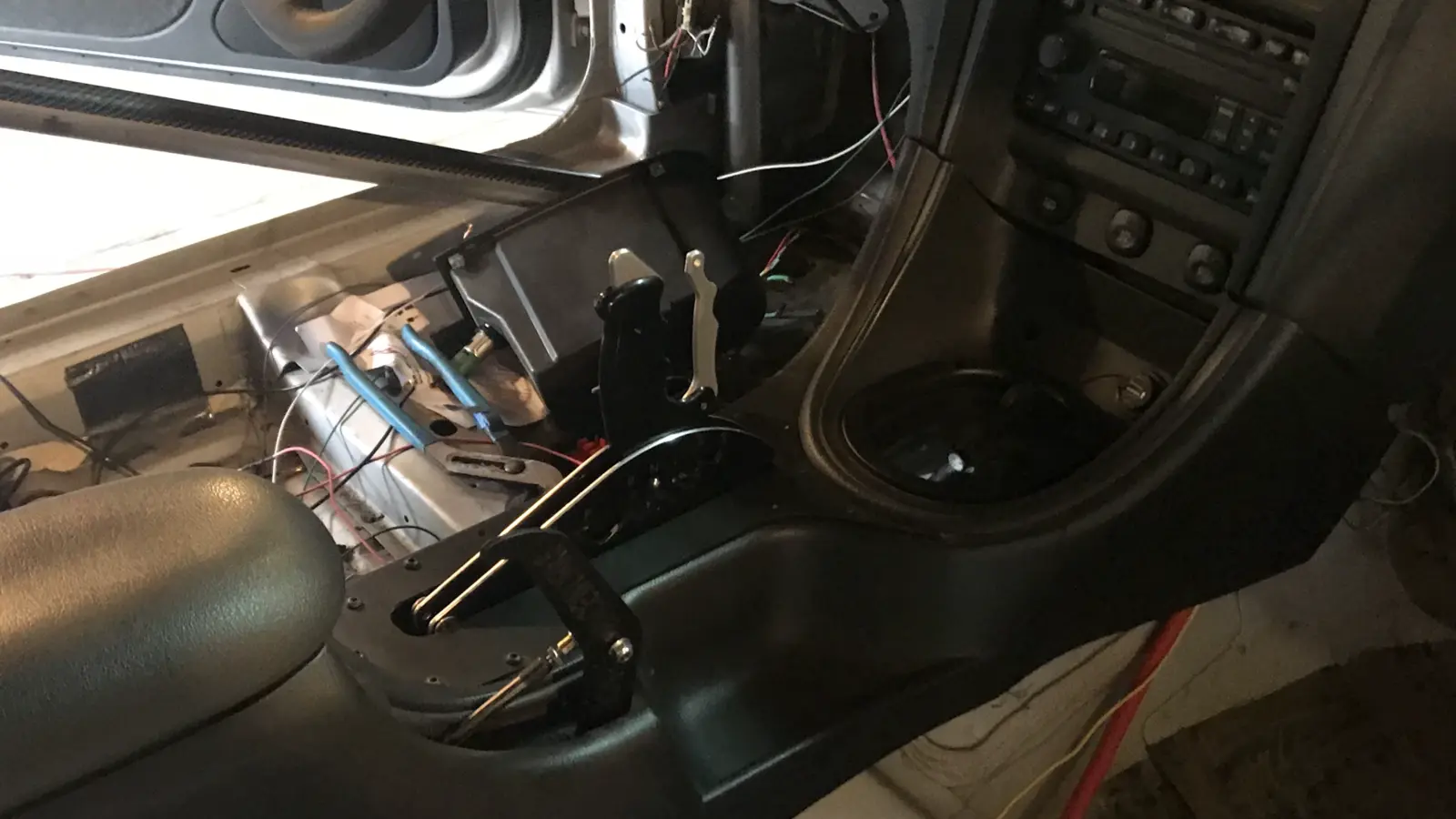

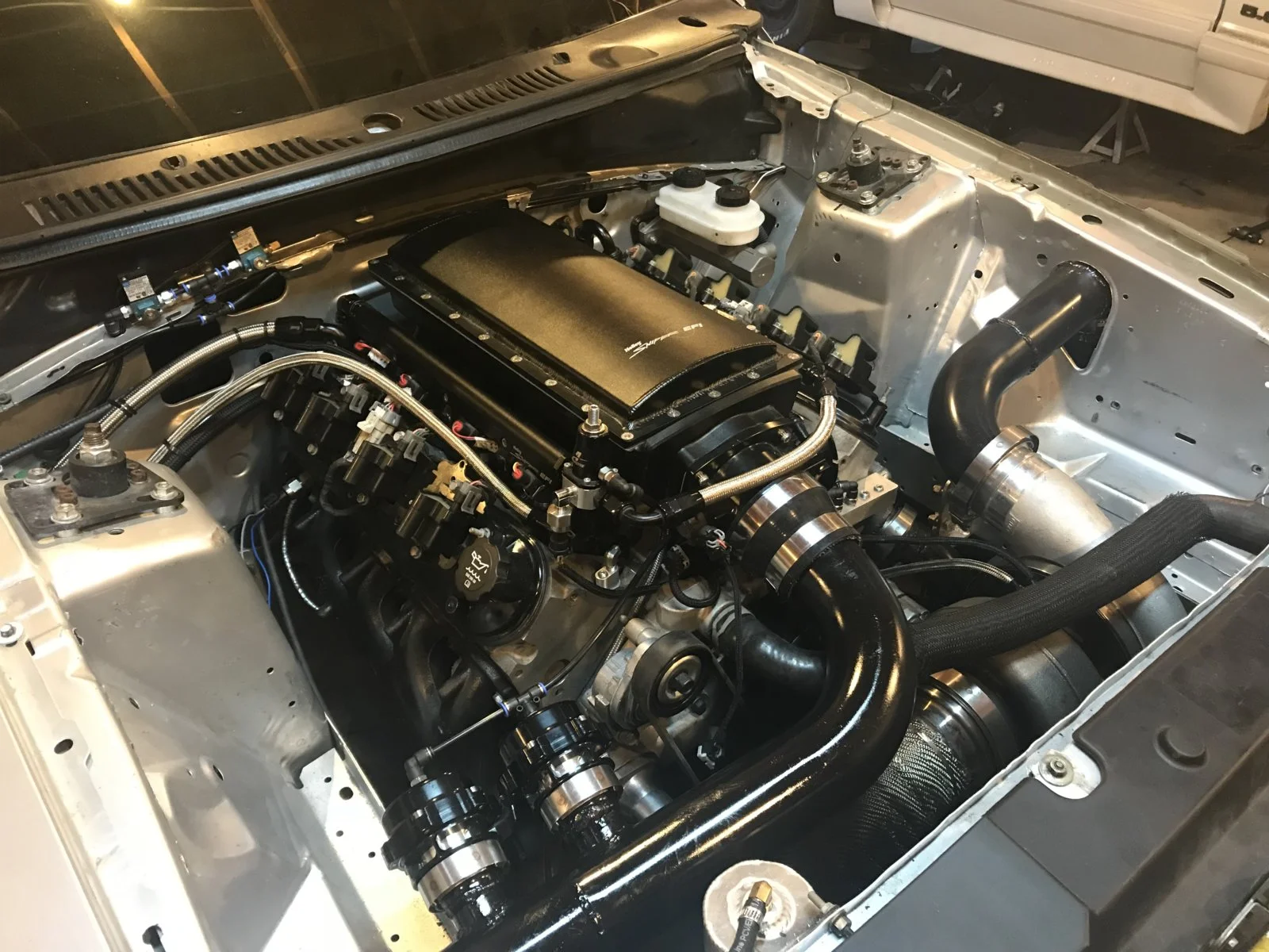

Tomorrow I’ll address the jungle of fuel lines and wiring down there. Didn’t want to secure it and have to weld/cut near it.

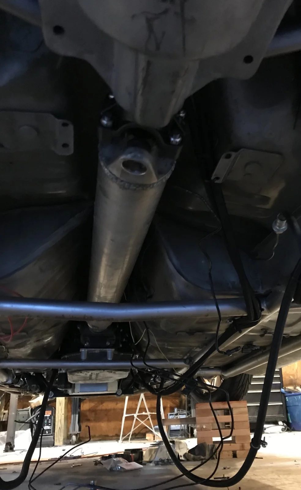

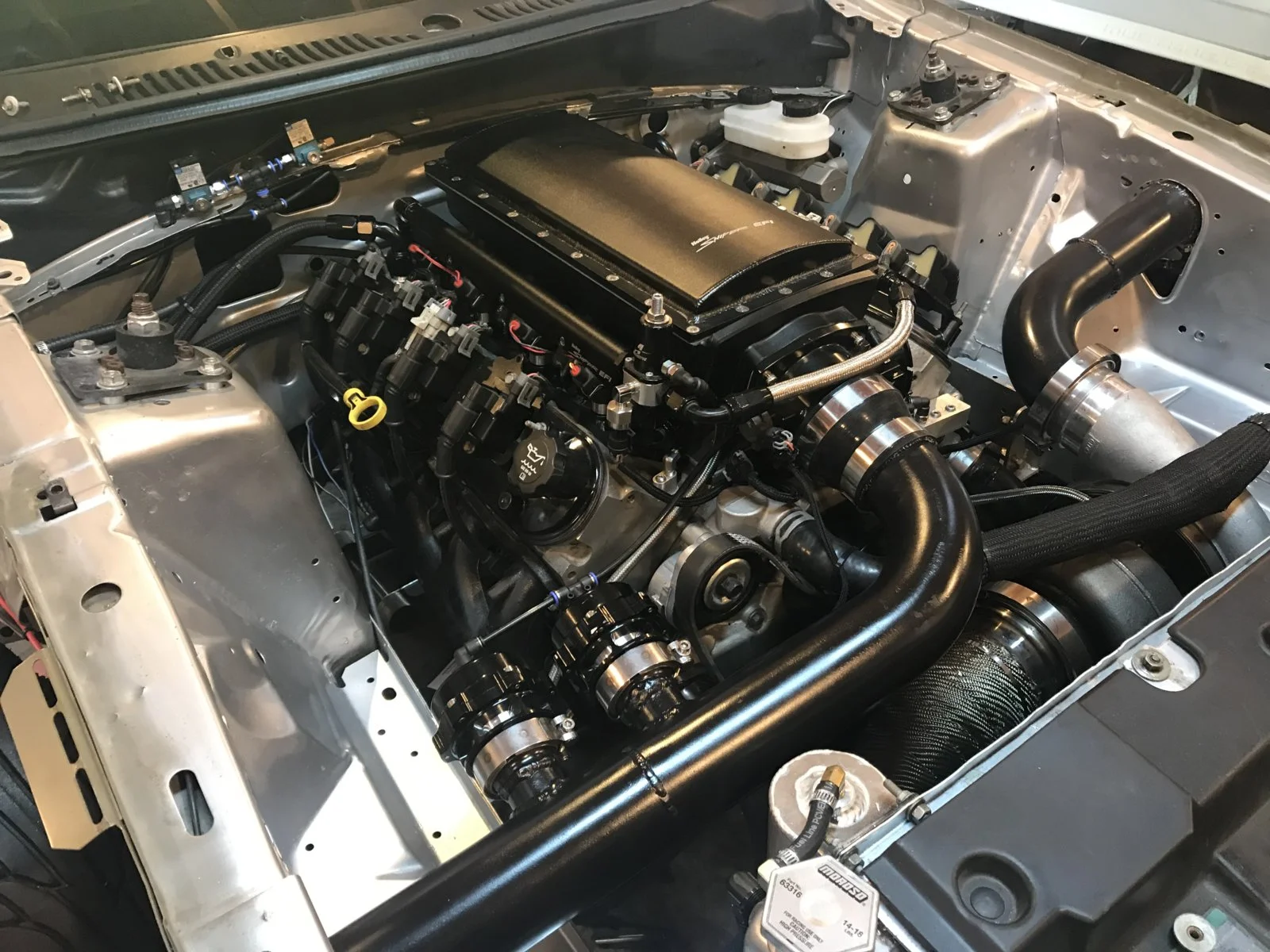

Then the downpipe adventure begins

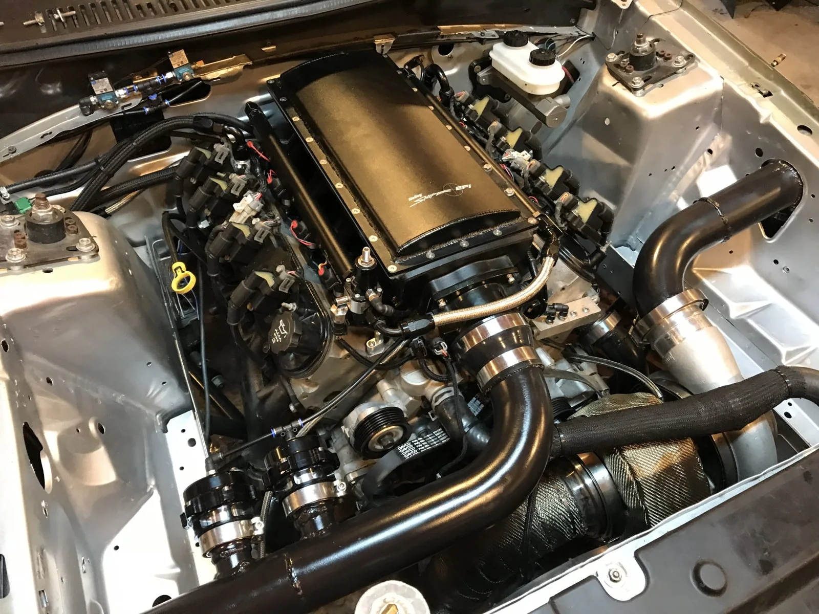

It’s a billet 85. Coldside is 3”. Plenty of room for the turboguard filter I intend to use.Looks to me like there's supposed to be an air filter adventure too....but seems like the frame rail is bringing that adventure to a quick end.
It also looks like that's only a 2.5" line coming off of the turbo...how big is this thing again?
