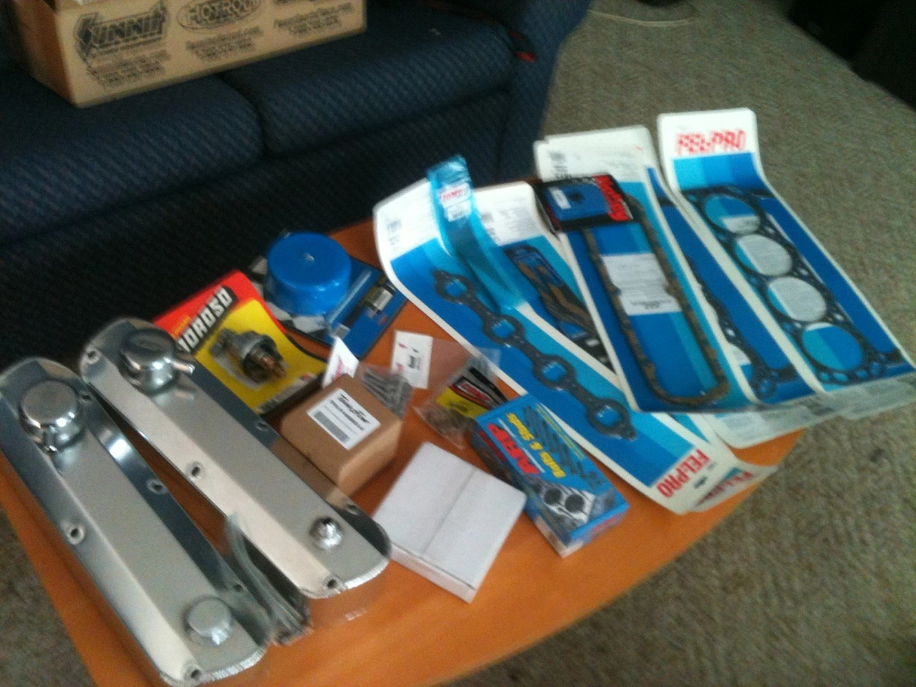

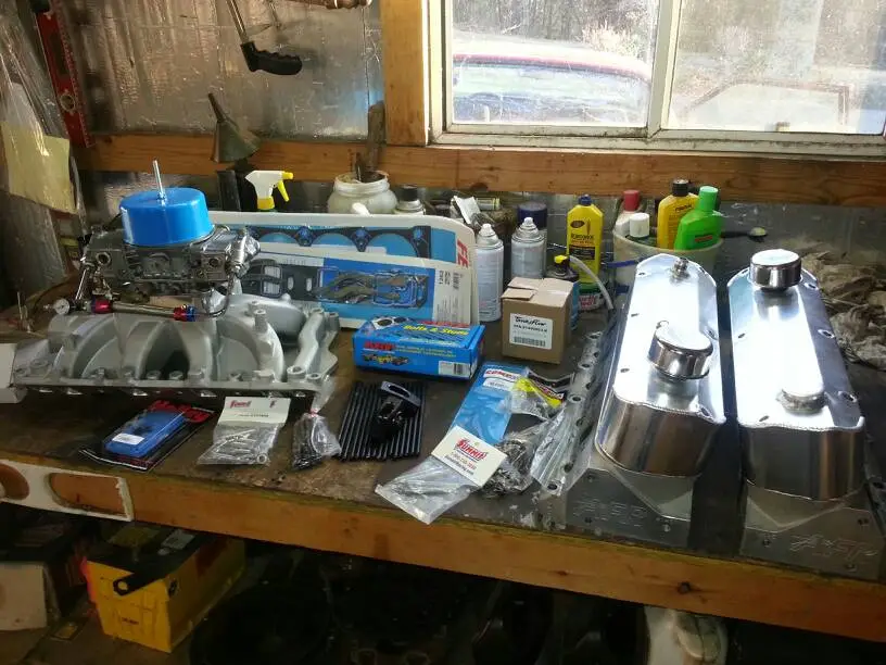

Sat down and wrote out a list of the things i knew I needed to get this thing breathing and moving under its own power.
Then through the classifieds on another site and a few phone calls with summit I ended up with a good haul.

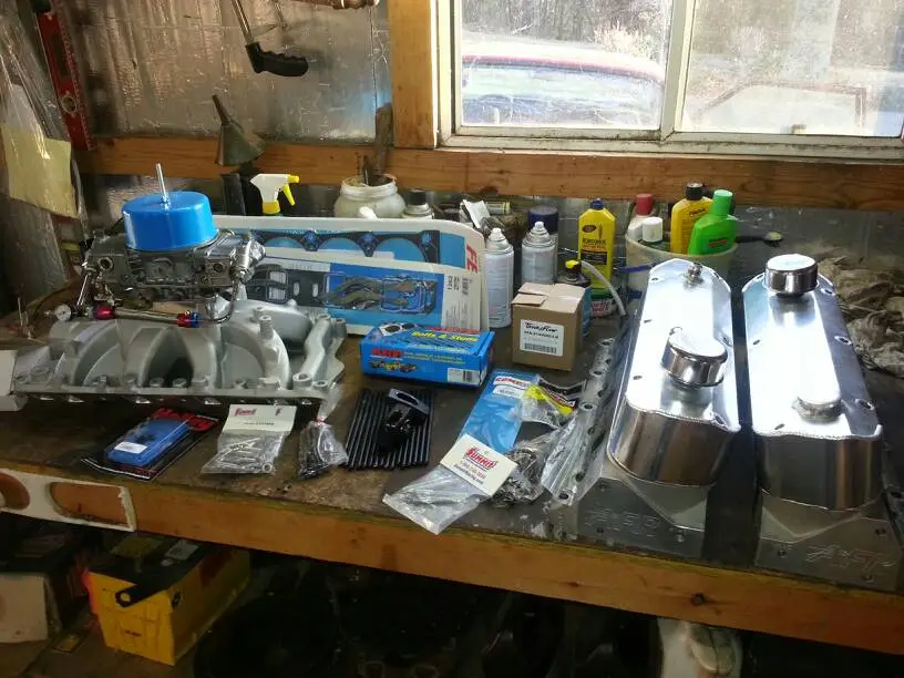

Other than the fabbed valve covers and headlights that should be here tuesday I went ahead and got
Headgaskets
ARP head studs (not messing with bolts this go around)
Intake Gaskets
Exhaust Gaskets
1" carb spacer
gasket set for the Holley
extended carb studs
intake studs
flush fabbed cover bolts
VC gaskets
a cap for the carb since it wont be seeing a filter often
a set of Trickflow Stud mount 1.7 Rocker arms
Compcams magnum 8.5" pushrods that i believe will fit the bill but just in case
I also picked up an adjustable pushrod and checker spring to do a little measuring if the 8.5s wont work
The 205's being the "renegade" head with the raised ports and big exhaust runners dont take the standard Felpro series that most of the other AFR, TFS, ect heads use so they were a hair more expensive but I went with what the AFR rep suggested so hopefully there wont be any problems there.

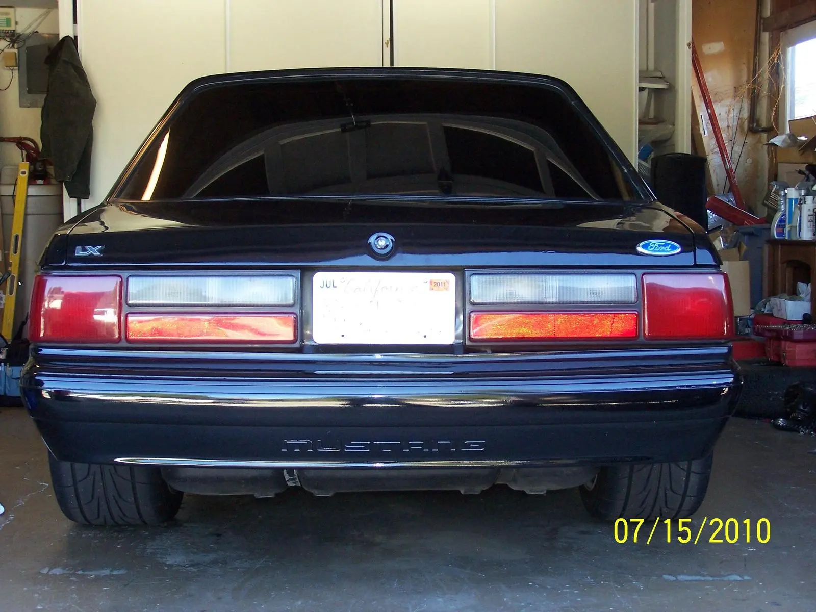

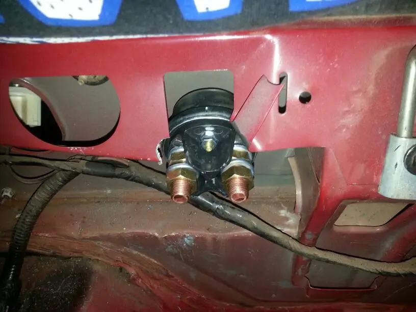

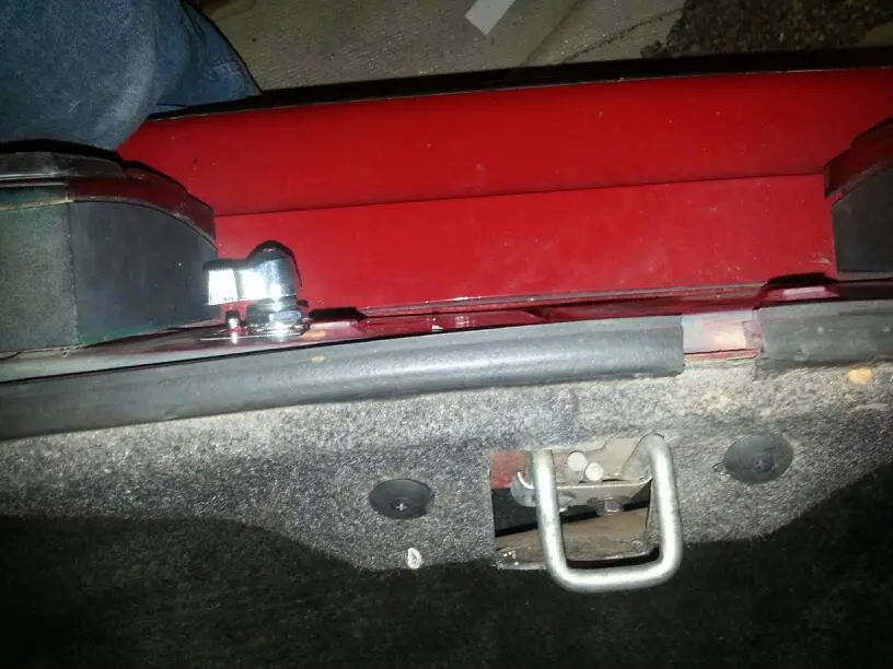

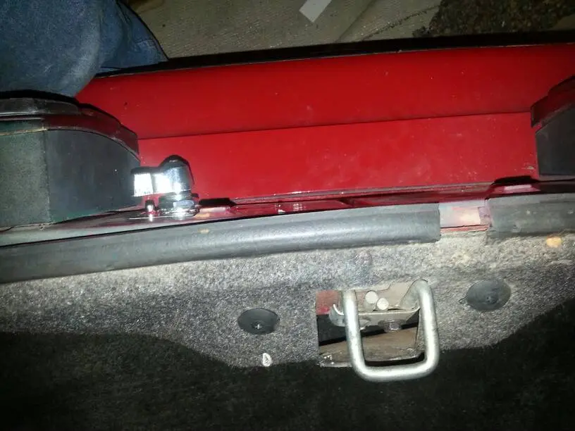

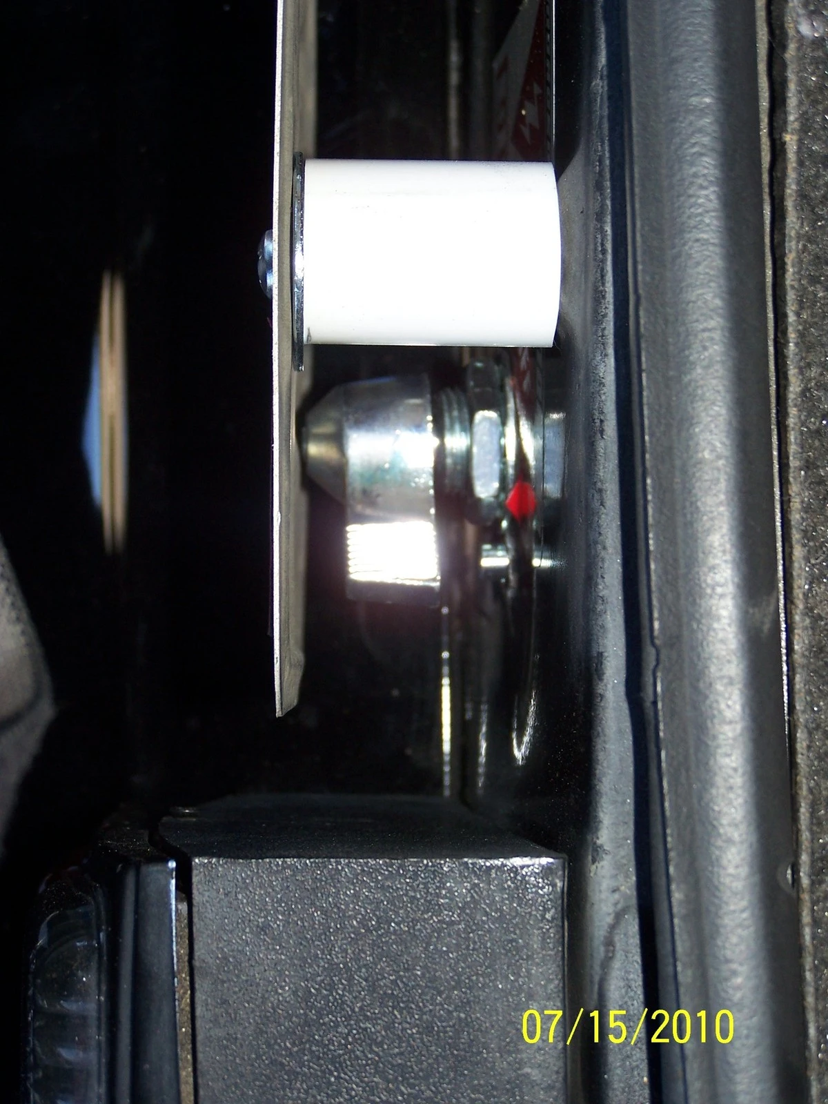

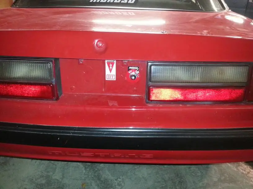

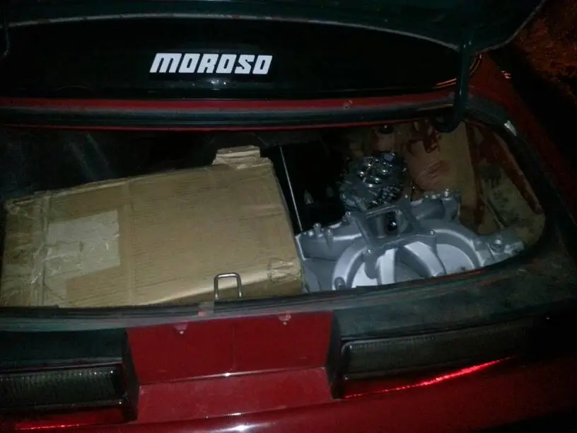

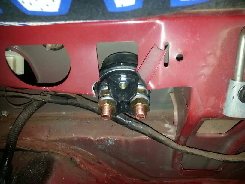

Got a Moroso Battery kill switch as well. 300 amp 4 post version. Mostly so it will be track legal when the time comes but I also found a trick way
to mount it so I wanted to go ahead and get it all lined out while im wiring up the 1-wire alt and the rest of the electrical system
went with the switch over the push/pull type for now as both are NHRA legal and the switch I feel is much cleaner.
Plus it will allow me to mount it in the license plate area and run a trick setup that I found a couple other guys doing on a different board.
Will be able to extend the bolts and use some washers to push the license plate out a bit and keep the switch concealed during street duty (mostly so people wont feel the need to flip switches and push buttons like they always do). Pop the plate off and roll into the burnout box, I think it will work well.

So i had plans to mock it all up and measure, and that turned into going ahead and assembling the top end anyways. I have the lifters soaking for a bit to make sure theyll stand up when the time comes, only concern now is piston clearance with the 2.08s and the springs being stiff enough to do valvetrain damage with the flat tappet. Going to do a little more reading for the next few days and figure out what steps need to be taken. Always up for helpful advice, but i realize this isnt the route most of you guys have/would go anyways.

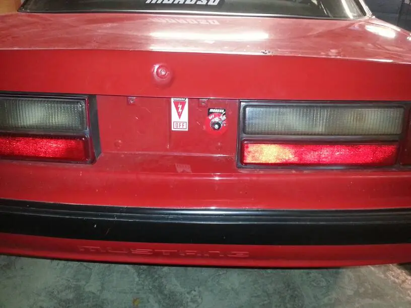

Sorry for the confusion, that picture went along with the post about the kill switch. Showing it hidden behind the plate. The blue car is gone.

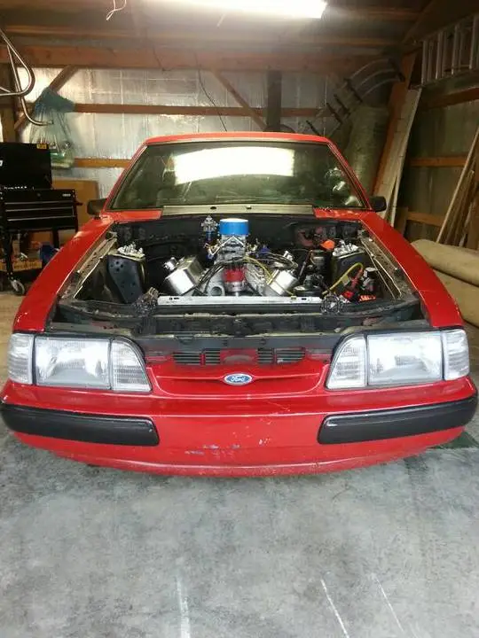

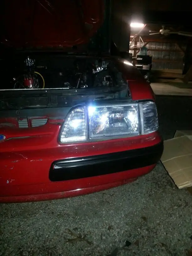

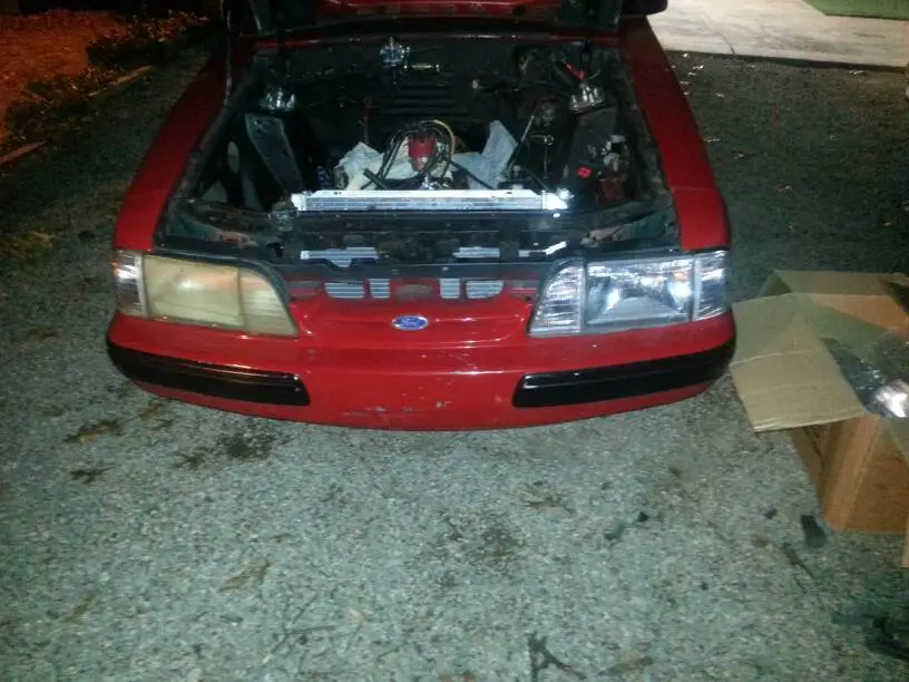

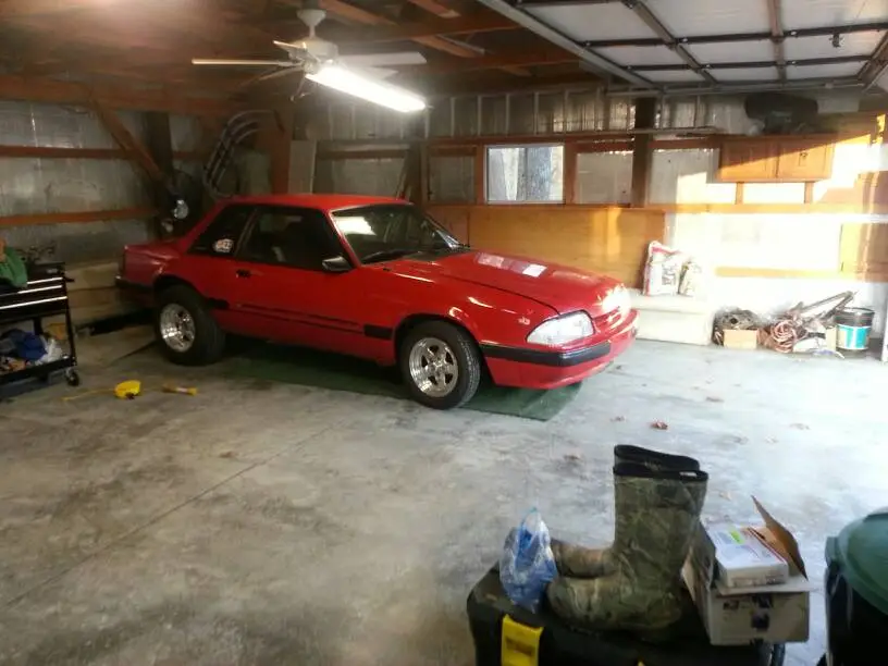

Well I got my headlights in. One at least, got too dark and I cant push the thing inside myself.
Really bummed at the current condition of the car. Less race car more storage unit at this point. But its where im at and hopefully will get it pushed in, cleaned off and get the motor on the stand here soon.

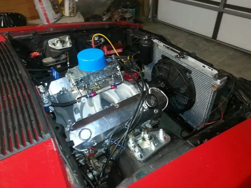

Going to go ahead and assemble the motor for now. Keep an eye on the camshaft and be able to line the car out and cruise a little bit.
Still going solid roller, Ed Curtis is supposed to have my cam speced by monday.

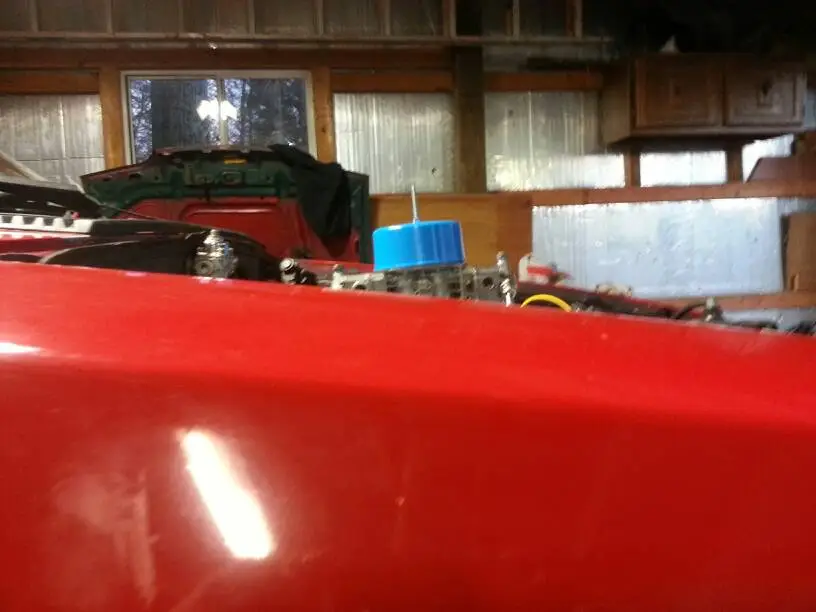

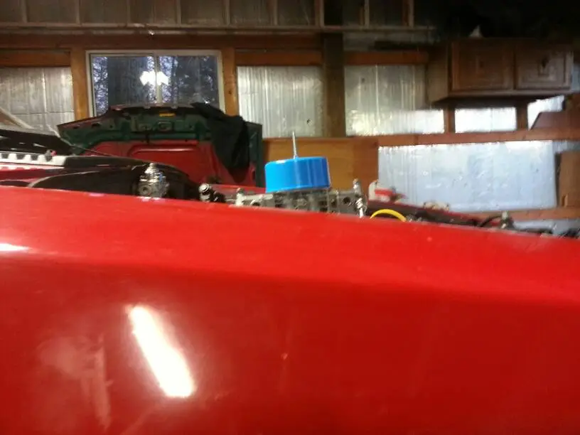

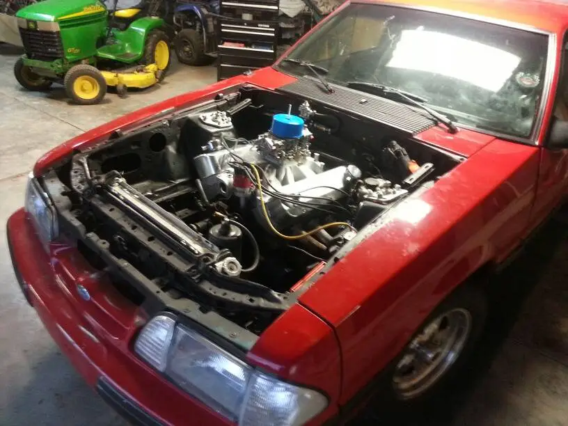

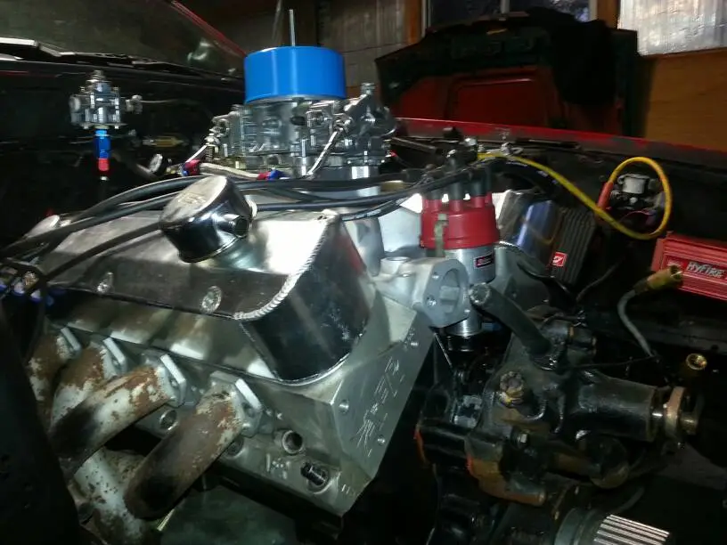

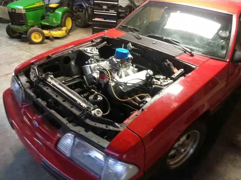

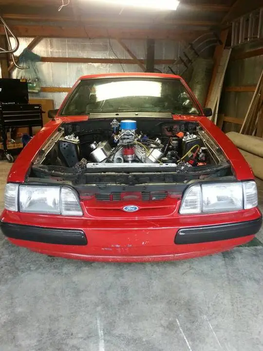

Having a bit of a hood clearance issue, go figure.
Really want to coat the longtubes again, but I'm nearly positive the car was built around them and they're never coming out.

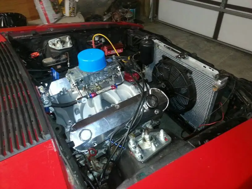

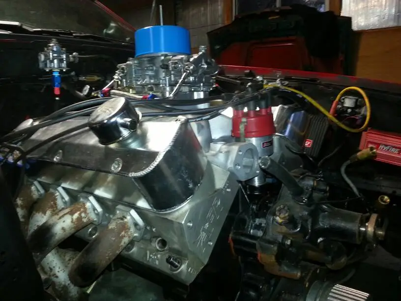

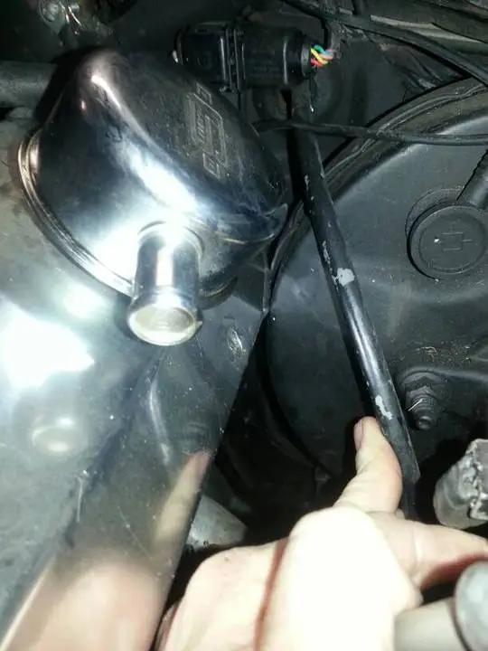

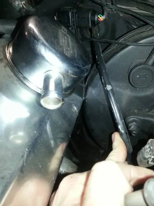

Also having a clearance issue with the driver's side VC but I think I'm going to convince them to fit. 4cyl booster is thinner but a larger diameter. Looks like manual brakes are in the future :)

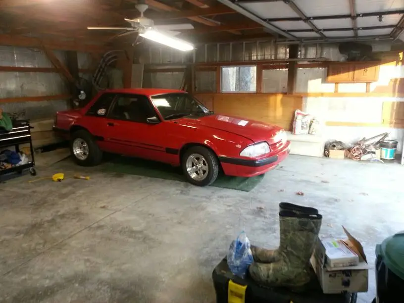

Happy I cleaned out the garage, all kinds of space now. Just a few odds and ends I still need and we'll be rolling.

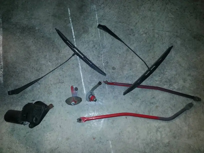

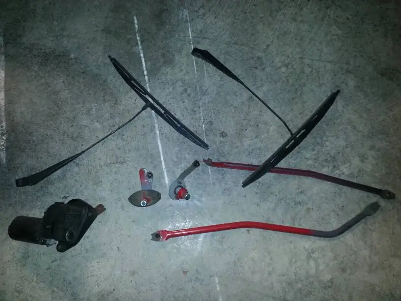

Clearanced the valve cover. Measured for my hoses.Removed the wiper assembly. Rebuilt my carb. Mounted the radiator. Ran some wiring.
Going to relocate the alternator down by the crank. Run a Moroso electric pump conversion and get my pullies through March. Have to run tapered polylock nuts due to a different bearing design on the trick flows. Going to do some wheel well cutting tommorow and button up some more small stuff. Try to get the rear end loosened up and the driveshaft under it.

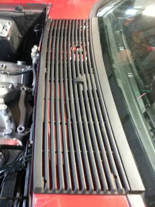

This has since been trimmed up and cut down but fit very well

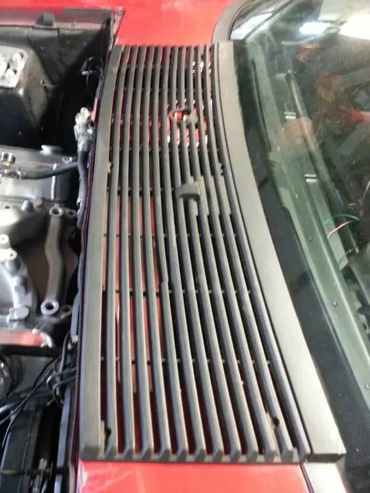

Will need a cowl panel with the molded pod as I don't want to run the fuel gauge in the cabin. Hopefully can get one without the wiper hole
