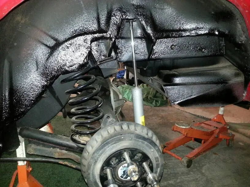

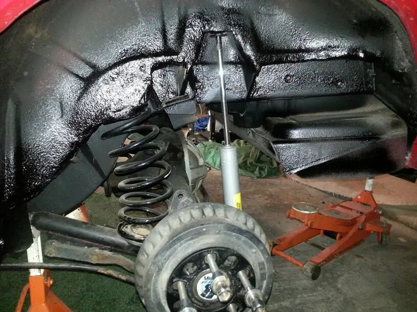

Tried to clear some more tire room. Was a learning experience for sure.
Definitely made room for a taller tire, not sure how much width. Running a 275/60 on a 15x10 6.5BS right now and it rubs. Surely I'm not limited to an 8" wheel and an 8.5 tire??
Edit: this same combo fit great under my 88. same rear end, same UCA/LCAs and same wheels and tires. Hmmm

Its very tight. But fit great before. Thinking the difference is it used to be on cut gt springs so the position of the wheel in the well was higher. I don't think id have any performance loss running a 15x8 with an 8.5 slick or radial instead of a 10.5 but its the hassle of finding new wheels.
Currently running a 5/16th spacer with no change.

I have since gotten the wheels to fit without spacers, so no worries there.
