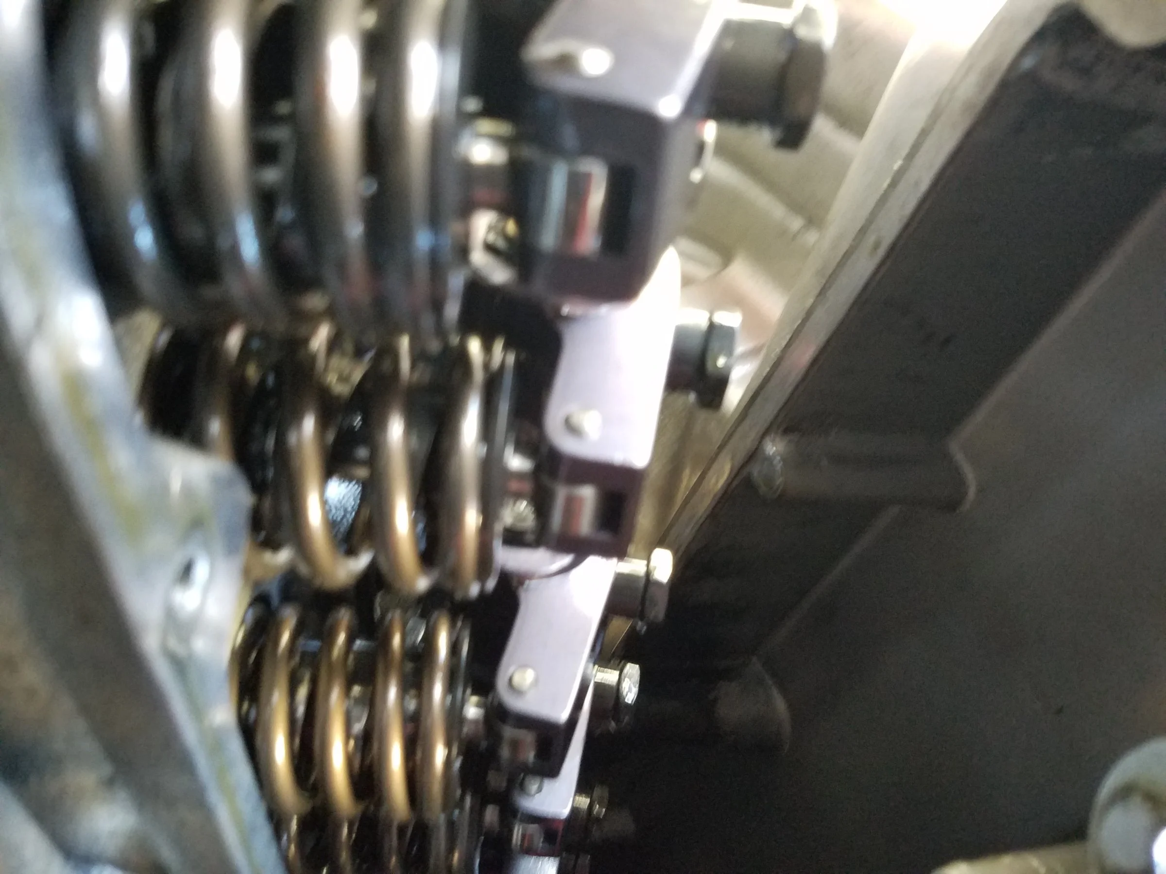

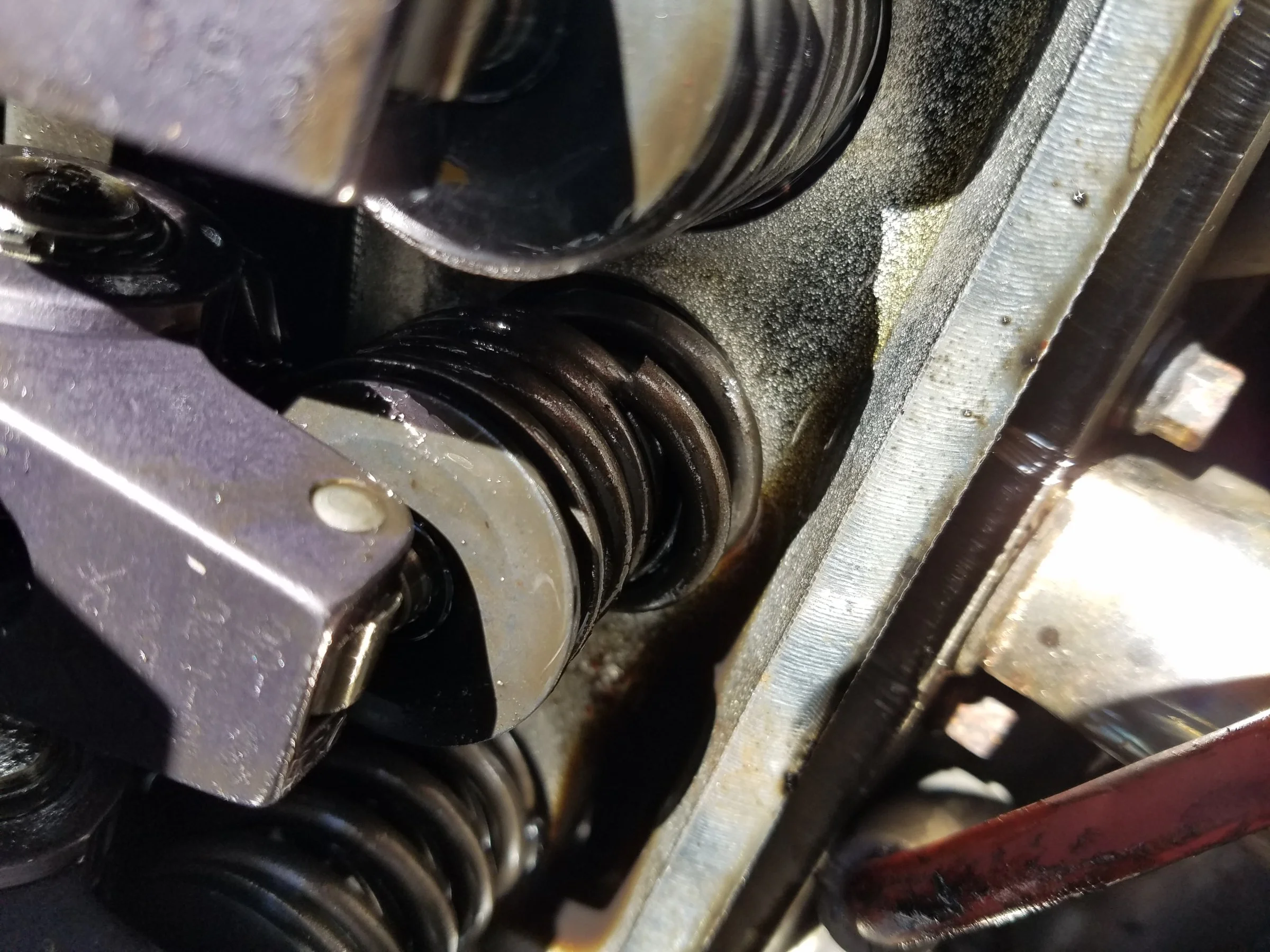

Hey guys,
I heard a loud tick that increased with engine speed, so I pulled the valve covers. I found an exhaust spring broken, so I will call trickflow tomorrow for proper identification. I know I have twisted wedge heads, probably 170s. My question is the car still ran ok (rough idle & slight performance issues) do any of you guys that have or have owned twisted wedge heads know if I can get away with just replacing that spring? Does it help at all that they are twisted wedge over conventional in that maybe no more damage was done? I believe these are double springs, not sure though. Thanks in advance!

Thanks guys for the input. I replaced all 16 springs with the TFS springs that came with my 170 twisted wedge heads. Unfortunately, I could not preload that same exhaust valve that the spring was found broken on. Only get about a quarter turn before I can't go any further. I checked the pushrod and it's straight, all other valves preloaded just fine so now I'm pulling the lower manifold and checking that lifter I believe is stuck. Hopefully my cam lobe is still good and I can get away with lifter replacement...I'll keep you guys informed.
