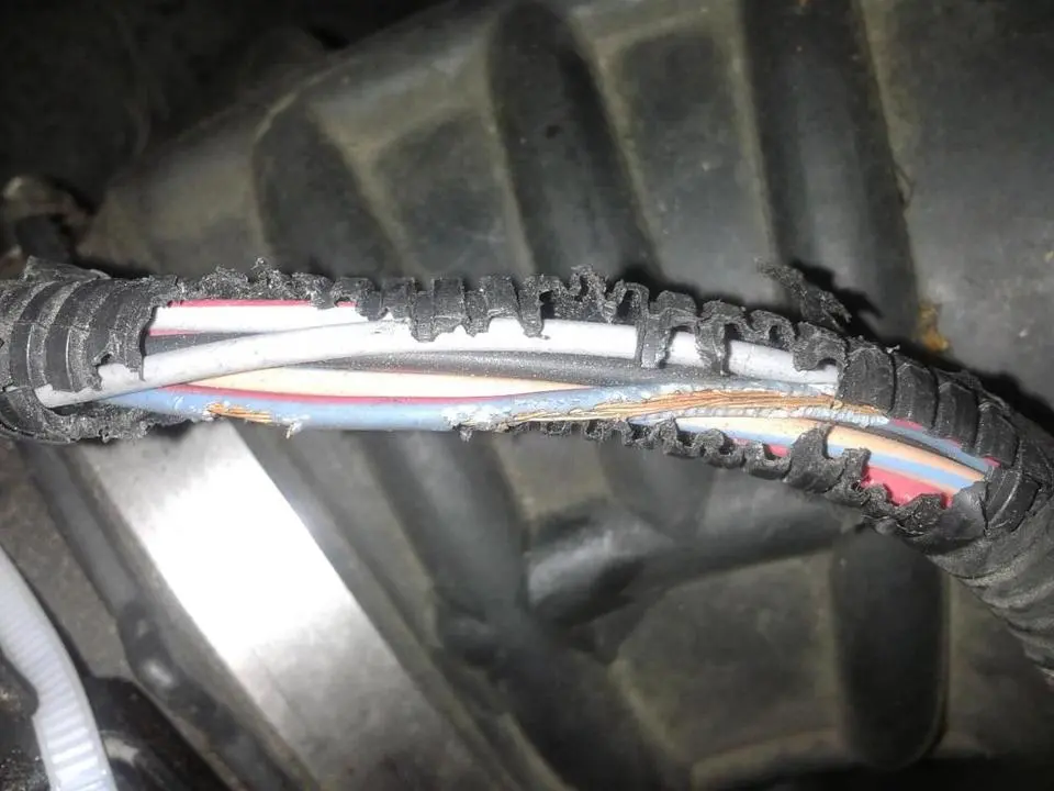

Well, as much I visit Disney since I live here and have season passes, I think Mr. Mickey Mouse paid me a visit. I have been having a driveability issue for quite some time. The car feels flat, makes a whole lot of noise and wont go anywhere and seems to stumble often. I started to work on it today. So far:

Cleaned MAF

Replace MAF housing (cracked) so, there is some of my problem
Fuel pump (data logging was only showing 25-35 psi and bouncing all over in that range)

A new pigtail for the MAF, which I am sure this is where the majority of the problems are coming from.
