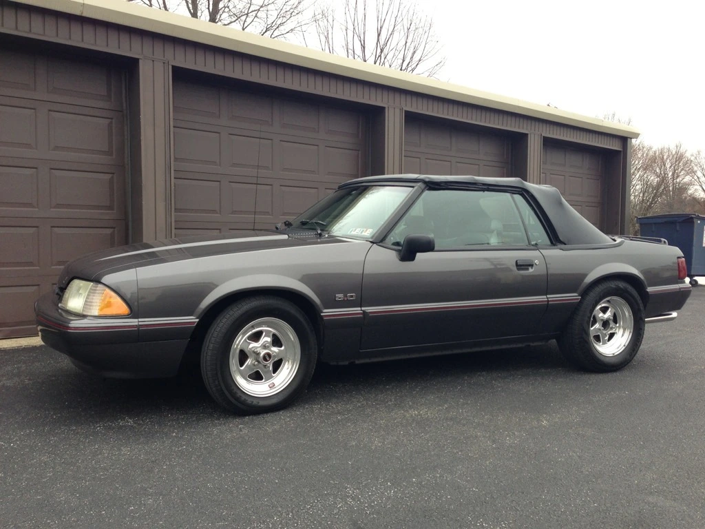

This time a convertible, almost all stock. Starting over from almost scratch except this one is AOD.. Any suggestions? It has 3:73's and exhaust.. That's it..anyway it's great to be back.. Another good thing, I can part out the 88.. Lots of good stuff left on her.

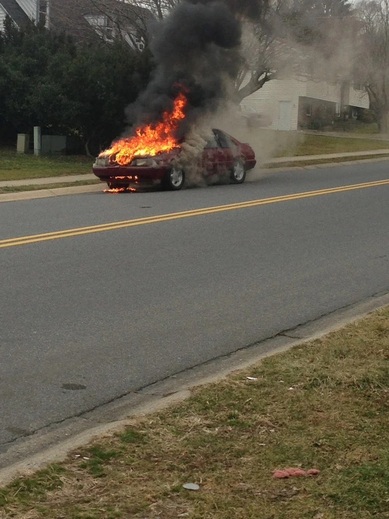

Moral of the story.. Make sure the fuel lines are fully engaged.. It will idle and drive for a bit... Then this will happen.. I did not have an extinguisher to put it out...

By the way, new car looks good! If I were to start over, I'd do a set of Twisted Wedge FAC 190s, a decent intake, stock or some super mild cam, and some kind of boost. Built AOD would tie it together and be all sorts of fun!
I still have all 4 of my wheels, still in good shape. The one tire got crispy on top though. I am gonna pull the motor and have the heads checked to see if they are any good. The fire was more on top of the motor and hood than anything. Fiberglass hood lit up quick. I am 95% sure the bottom end of the motor is fine. Prob the cam also. We will see
Ok f8tlfiveo, explain the fuel line leak thing. I gotta know. I'm sorry for your flames (great pic by the way :(). I love the vert. I hope you had insurance.
One of the fuel lines that connect to the rail was not fully engaged.. It was in far enough not to leak while idling and light throttle, but as soon as I pushed a little harder on the skinny pedal I smelled gas.. Pulled over right away, but it was too late. Yes I had insurance..paid 4k for the vert. Still have 500$ left from the insurance money.
