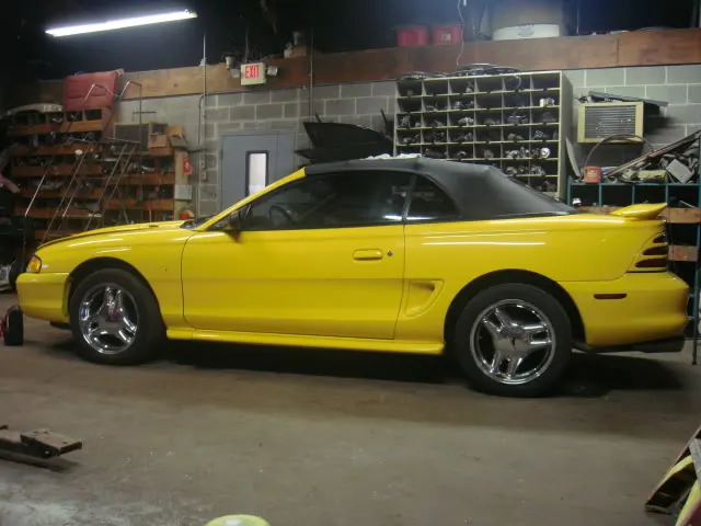

In September I bought a 1995 GT convertible. 114,000 miles, all stock besides Flowmaster weld-in mufflers. AODE trans, black top, black leather. I slowly worked on it after work for the past two months. Car was in great shape when I bought it and better now.
Sorry I don't have beautiful pictures right now. It's winter, gloomy and muddy around here. Just needs the emblems and the interior cleaned and she's gonna be parked til spring when it's going up for sale.

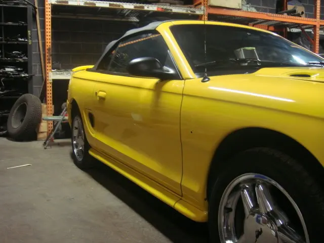

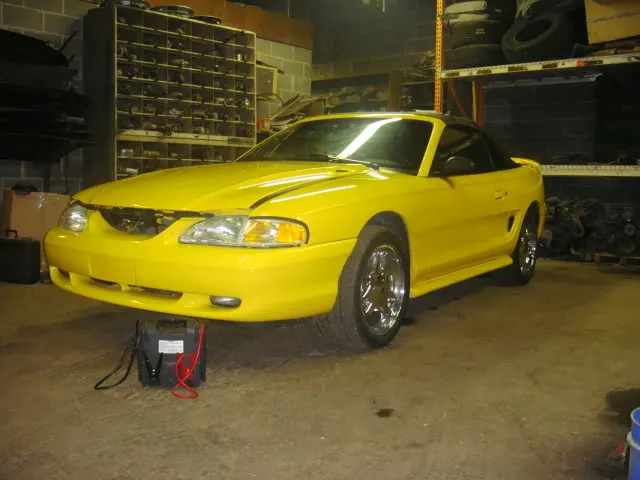

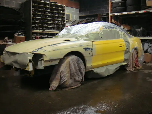

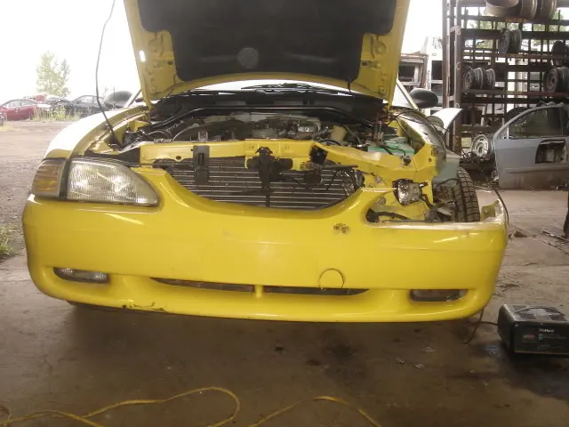

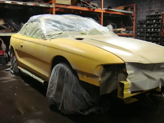

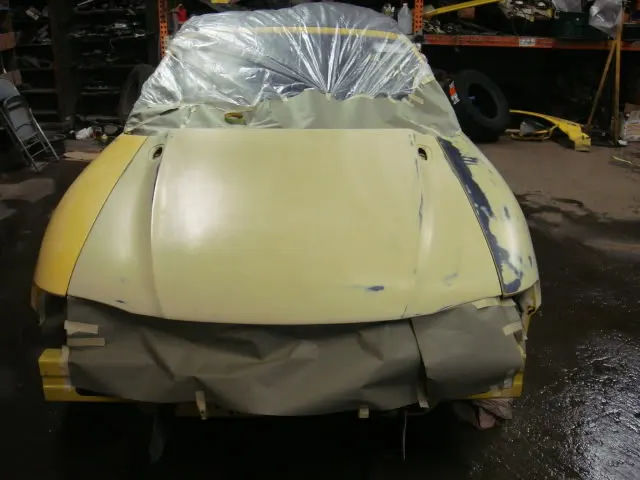

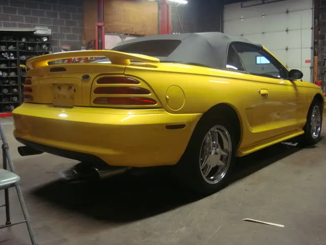

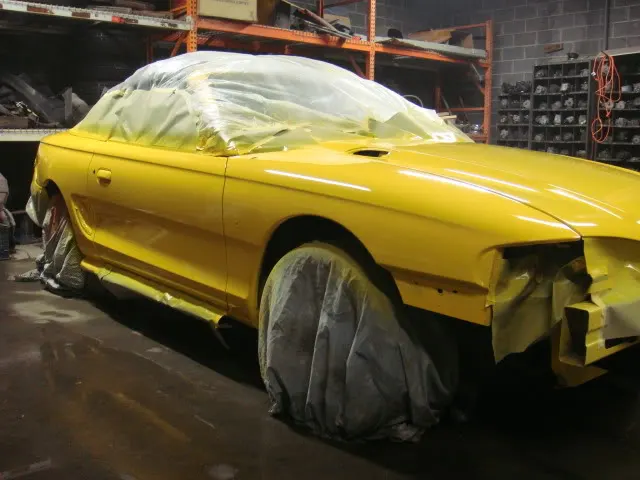

The paint came out excellent. I am really happy with it. This is basecoat clear coat on the entire car, except for the front cover. I single staged the cover because it holds up better against rock chips. The single stage is left over Hack Job paint. Same color code. The new headlights and turn signals were a must and I wetsanded the fog lights because they were hazy. Interior will get a clean up when I get it home. You can't clean an interior in the shop because the floor is filthy, you just track it everywehre inside the car.
The tri-bars are chrome. They did a good job, whoever did them. They are pitting slightly, and I mean slighty. I'm shocked to how good of shape they are in. And I'm also happy somebody put on new Yokohama tires before they wrecked it. That's a huge plus.

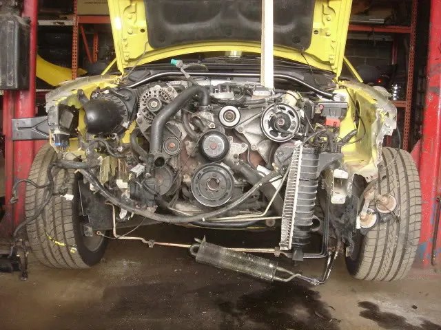

Didn't really follow you for the reason to cut the rad. Would it pump tranny fluid every time you moved the car? My experience with auto's = fail.
Once again...not surprised. :rolleyes:
Great job. :nice: You can really sling some paint.
Thanks man!! And yes, everytime you move that thing, the pump will turn and the fluid will pump out all over the place. It's a mess!!!:eek:
