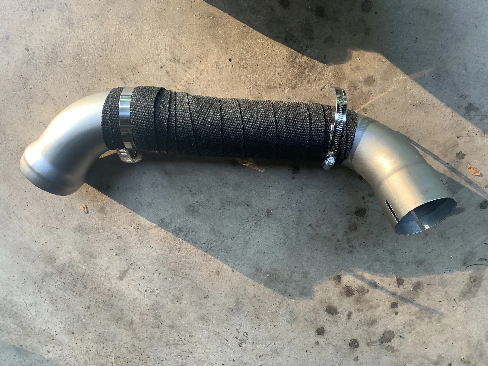

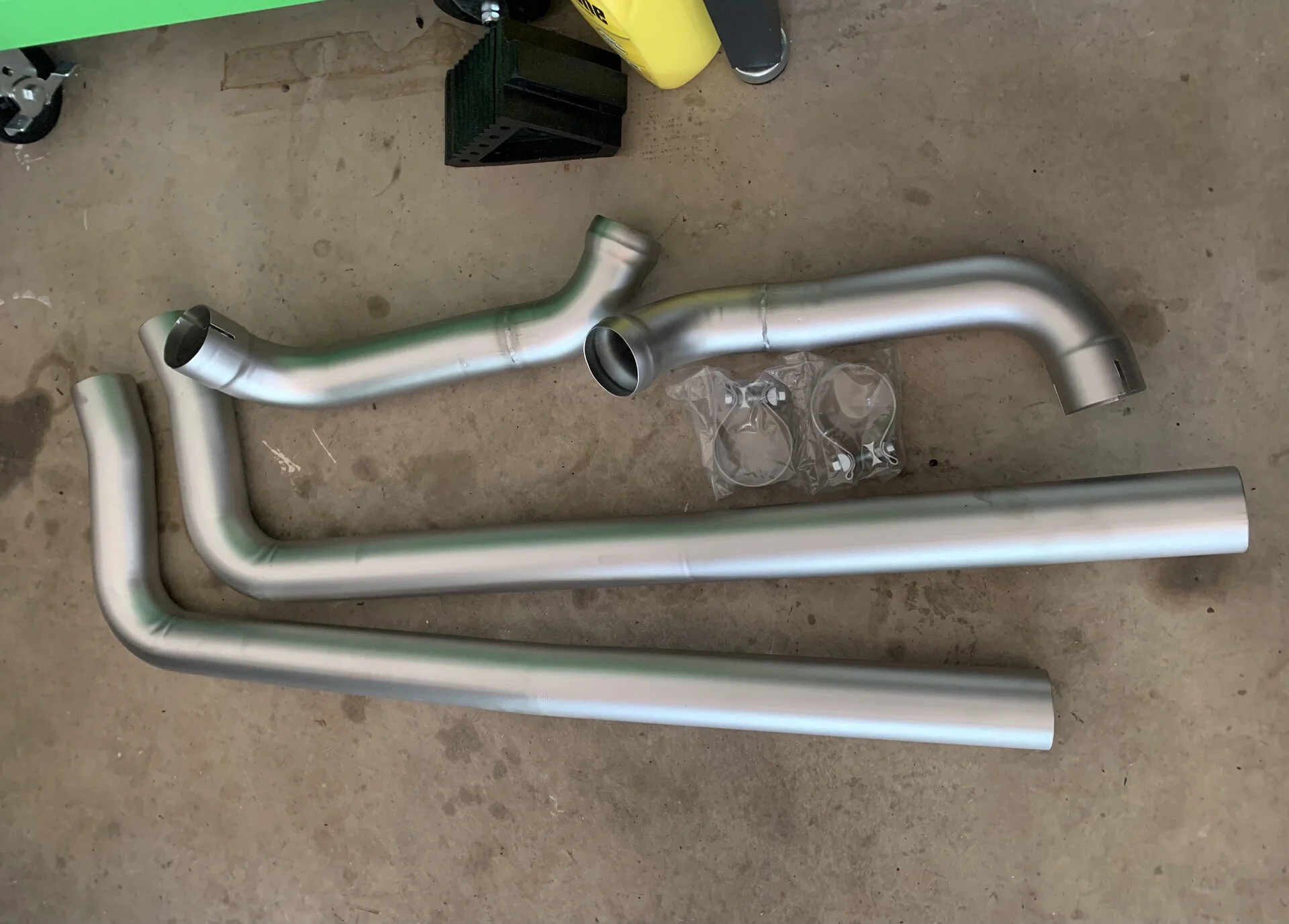

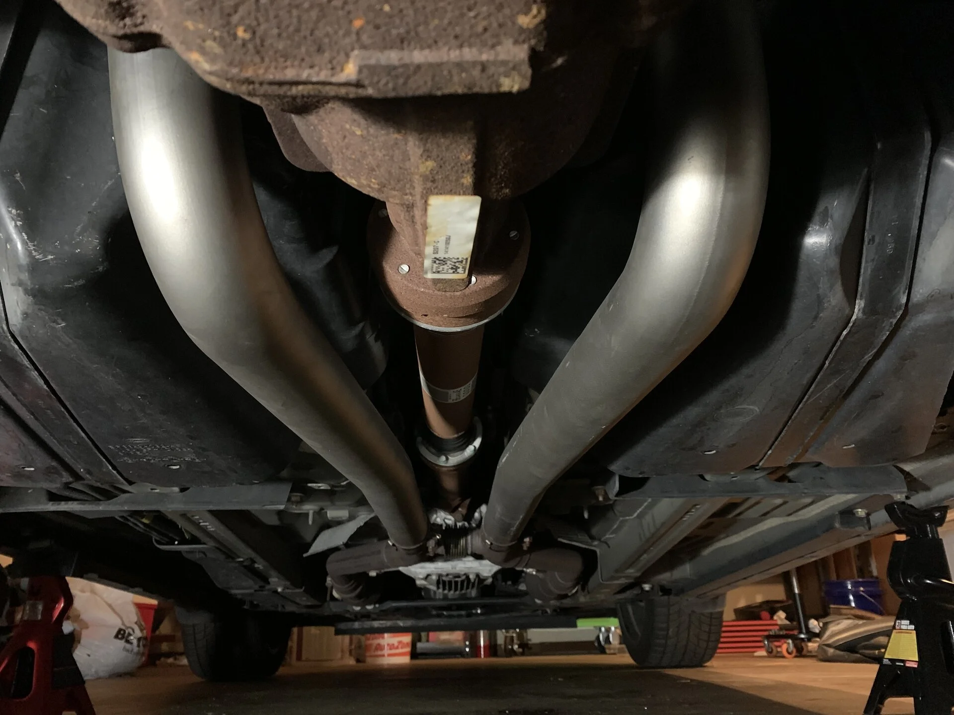

So I recently picked up the LTH over axle pipes for my 2014 GT. I chose these over the Borla because I figured the two piece design would be easier to install than the single piece design on the Borla.
I did notice the Borlas come with “high temp insulation tubes” and I read in a thread somewhere (can’t find it now of course) that changing from the OEM OTA pipes can put them closer to the fuel lines.
To be on the safe side, I would like to add something similar on the new OTA pipes. Has anyone seen anything available individuallyfor sale? Or could I use something like an exhaust insulation wrap or something like this?
Thanks
Yeah you can use any kind of wrap. My driver's side pipe is really close to the fuel tank after my header install (don't know why but the headers screwed up the alignment of the pipes) so I used some leftover header wrap on the section near the tank./
Thanks man. Yeah I picked up some header wrap from autozone. Going to see if I can make that work when I install the OTA pipes (hopefully Monday).
I found a few other threads where some folks had luck with header/exhaust wrap. I went ahead and used the stuff I had already bought…though I had to buy some hose clamps because the ones the wrap came with were too small.
It was pain but I got one side mostly done. Going to try and finish the rest of it tomorrow after work.

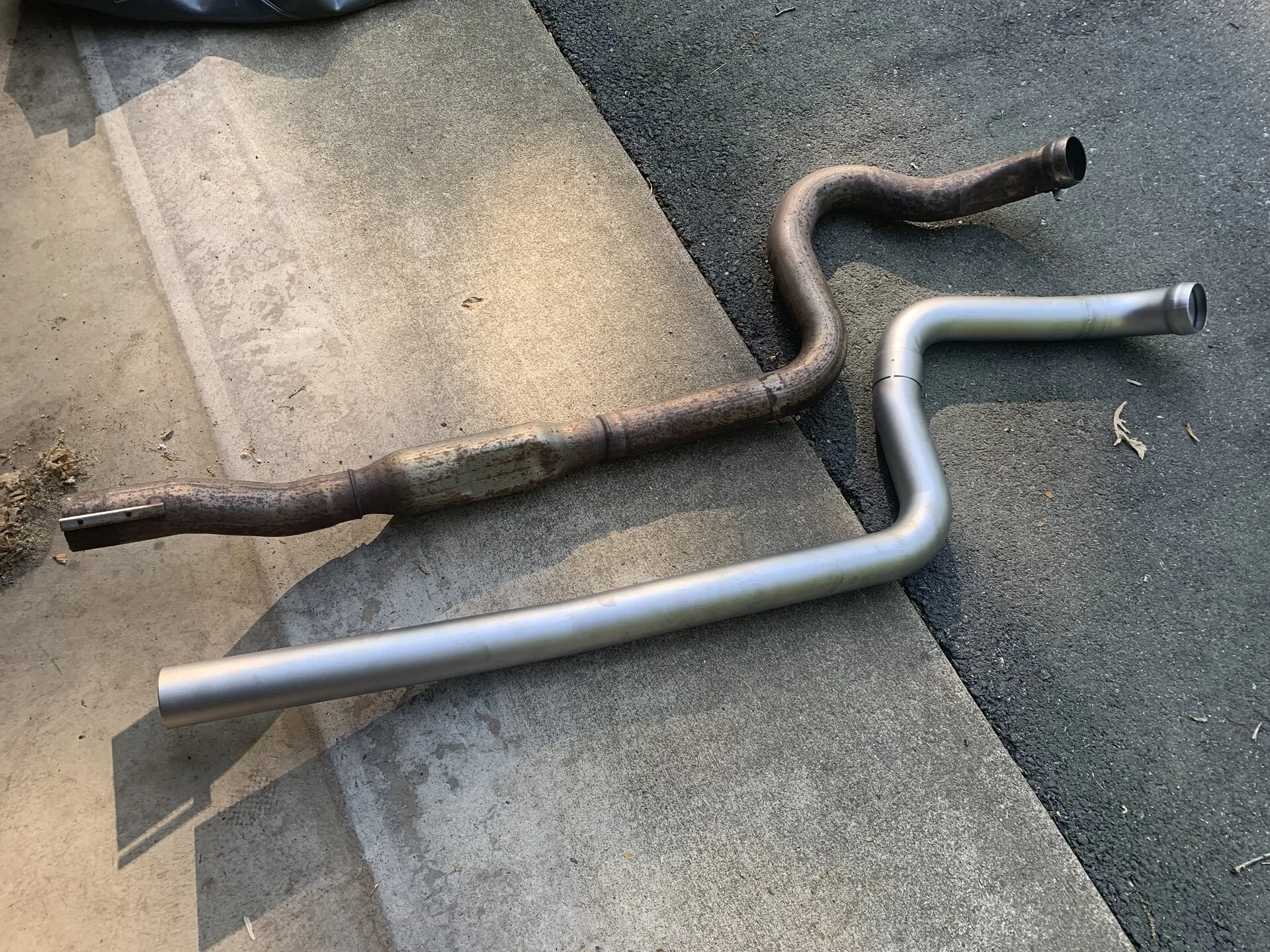

Driver side stock OTA compared to new one:

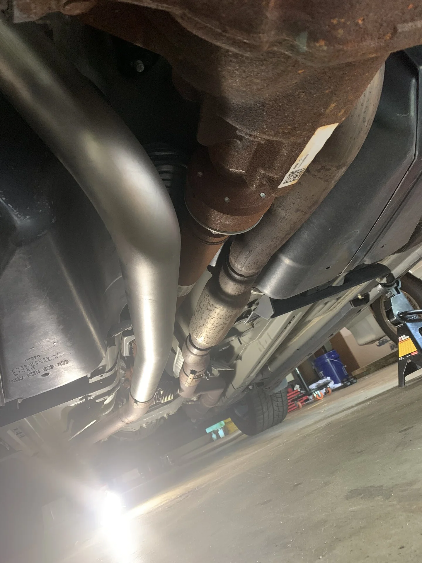

Finished up a couple of nights ago. Took it for a drive and it seemed like everything is fine. I do want to double check the various bolts and clamps in a day or two though, just to be on the safe side.
Pretty happy with the sound. It doesn’t sound significantly louder but it is a little louder and it’s got a little snap, crackle, pop on downshifts…which is something I miss about the Roush setup I used to have (don’t miss the drone though).

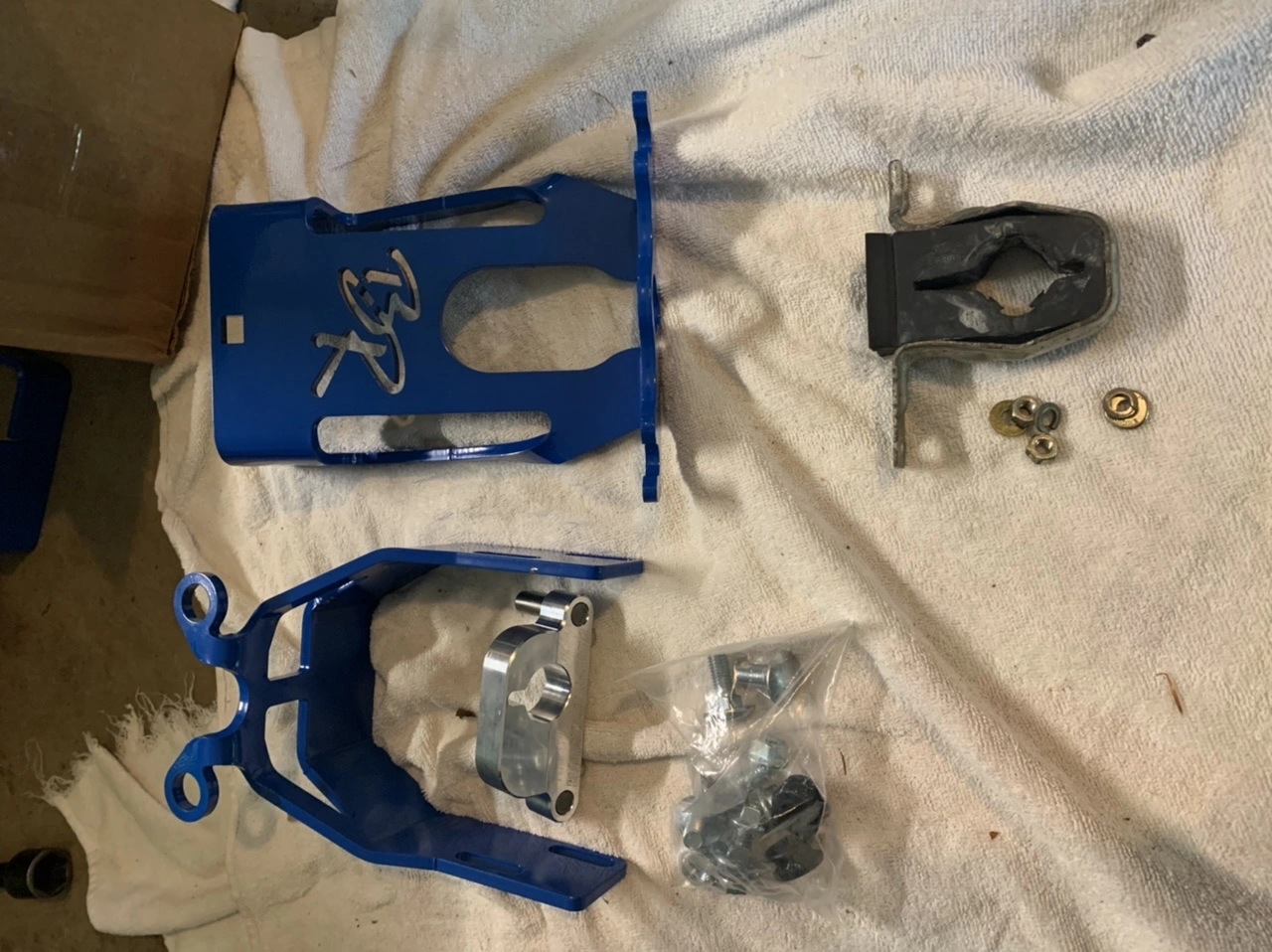

Sort of turning this into an update/“build” thread I suppose - and following up from my other thread where my shifter bracket nuts fell off after driving the Tail of the Dragon…
Things I recently added to my 2014 GT that I should have added years ago:
1. the Blowfish Racing shifter bracket. I tried the Barton bracket, the Barton shifter & bracket, the Steeda shifter + Barton bracket, and the stock shifter with a weighted shift knob. So far this bracket with the stock shifter and weighted shift knob is the best combination I’ve had.

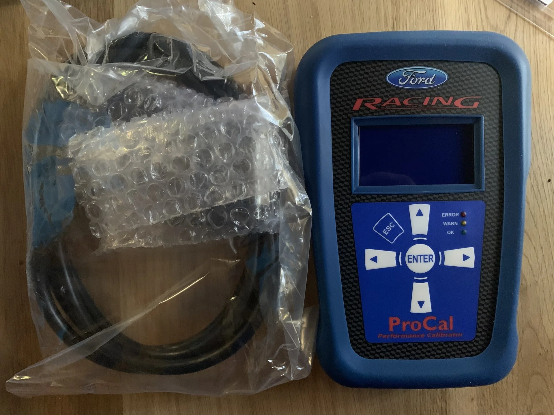

2. the Ford Performance Track Cal. The additional torque, power, and improved throttle response are noticeable. The lopey cam idle is a little bit gimmicky but still pretty cool.
Made a video with a bit on the install process and first impressions

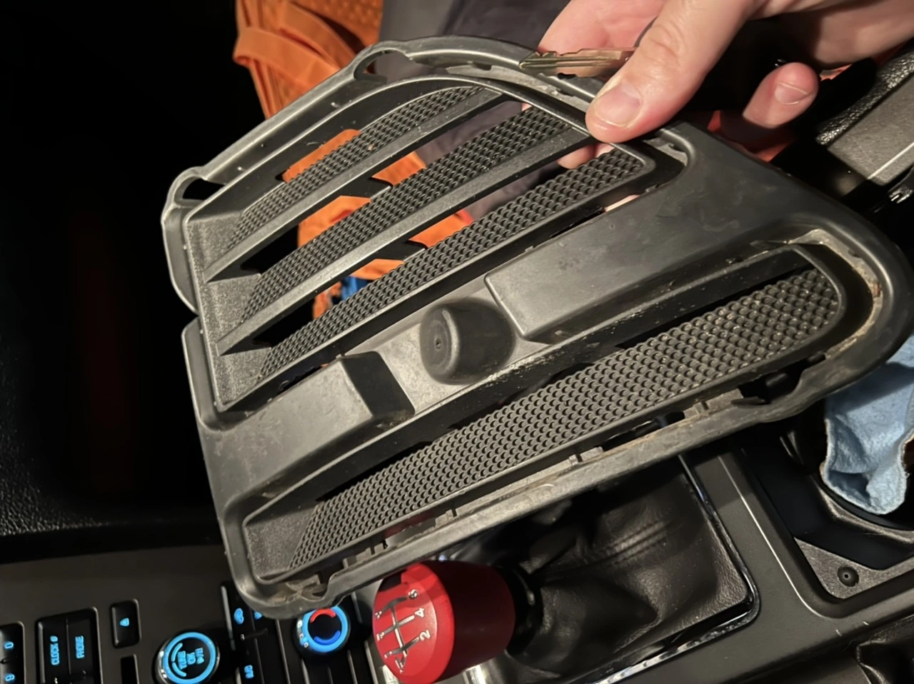

Anyone else have these things pop out with any frequency? I think I’ve had to put one or both of these back in 4-5 times in the last couple of years.
Putting them back in is annoyingly time consuming. Need to find some way to make them more secure without resorting to super glue.

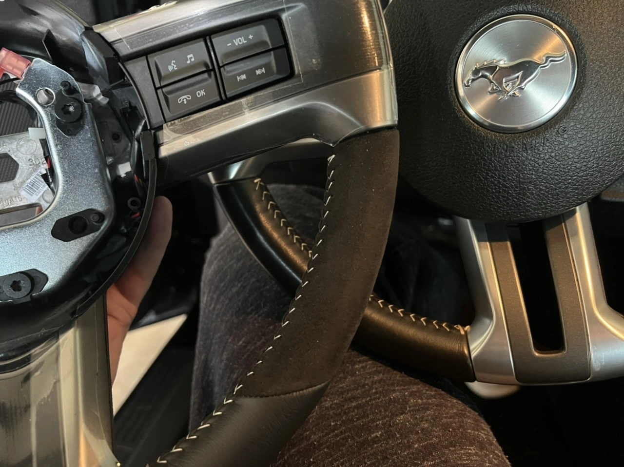

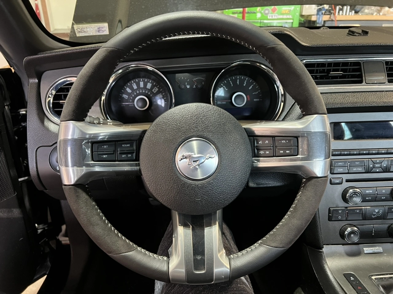

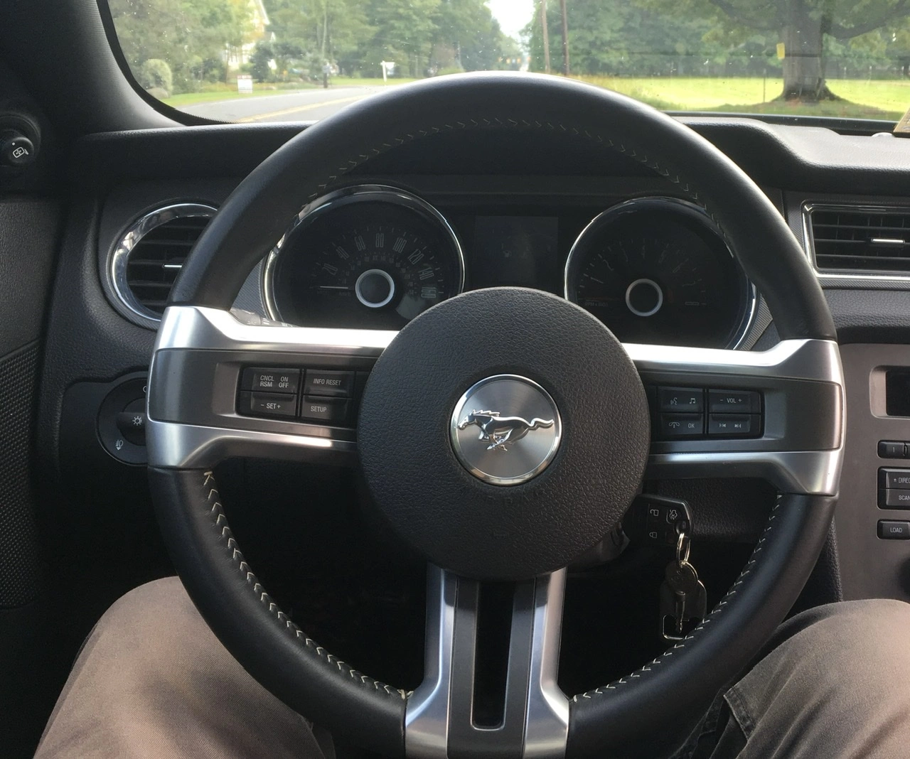

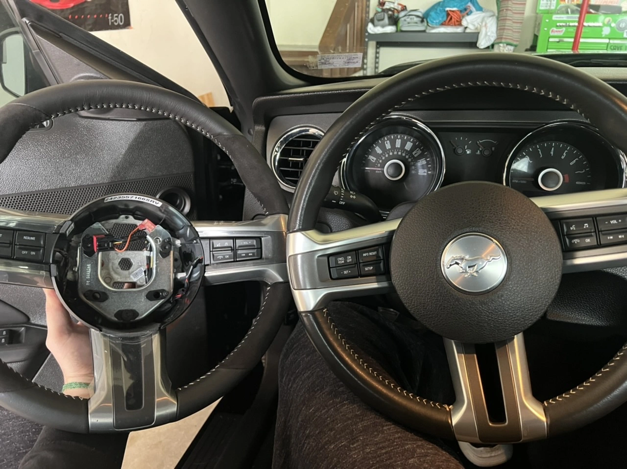

Finally found some time to install the GT500 steering wheel yesterday.
Before
After
Working on a video of the install process, which was a lot easier/quicker than I was expecting.

Today in why you should read product descriptions more closely: Figured out that I was supposed to transfer one of the button panels from the steering wheel controls to the new steering wheel, so now the controls on the left side are different and don’t work the way they are supposed to.
Going to try and replace the wiring harness and left side buttons without removing the steering wheel, so I don’t have to buy another bolt. Fun times. :oops:

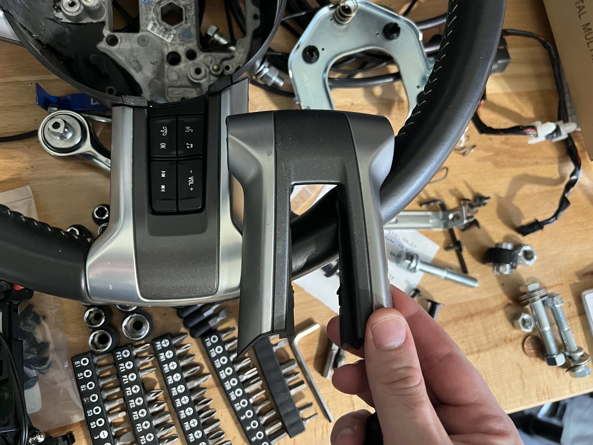

Another example of my failure to notice small details initially - today I was driving the GT and I noticed that the sun was reflecting significantly more from one side of the steering wheel than the other. Upon closer inspection, I realized that the inserts that came with the GT500 steering wheel are actually a darker shade than the ones on my stock GT wheel and less reflective of sunlight. When I got home, I took the missing piece from the GT500 steering wheel and sure enough, it’s different than the GT one I reused when I switched in the correct buttons.
It’s harder to see in the garage light but here’s a pic of the GT500 steering wheel insert in my hand, next to the OEM GT steering wheel, which still has two of the inserts.
Need to clean up the GT500 piece and add it back to the GT500 steering wheel so everything matches. :D
