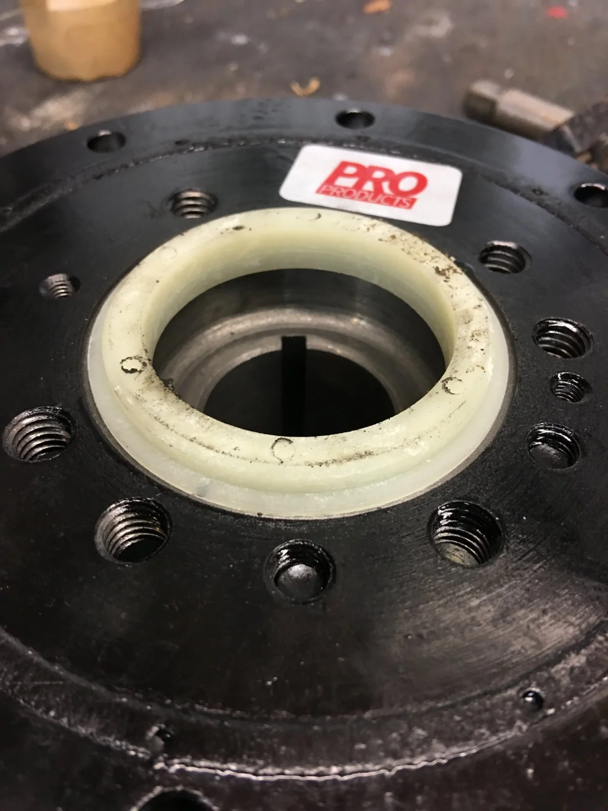

I've yet to pull the balancer off, but I have an idea... I'm going to remove the trigger wheel and open up the hole in the middle just a hair. Then, put 4 small magnets between the balancer and the trigger wheel to hold in place. From there, I should be able to use a micrometer to adjust the trigger wheel slightly until I feel like it's as centered as I can possibly get it. Then weld it back and slide the magnets out.

#1. The trigger wheel needs to be bolted on, and then the balancer needs to visit the machine shop to insure concentricity. If you go into something eyes wide open, some of the processes will not seem so time consuming or costly.

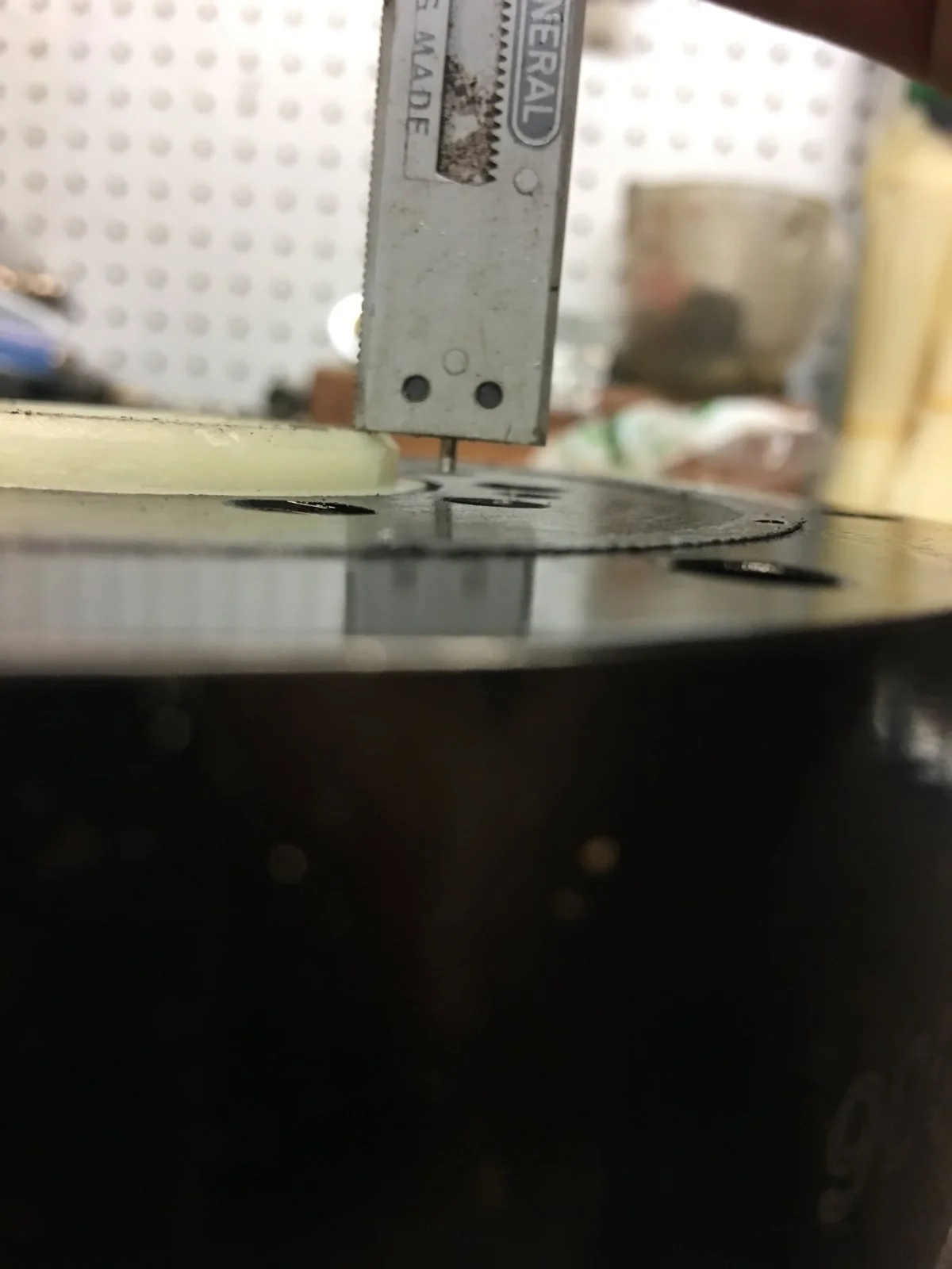

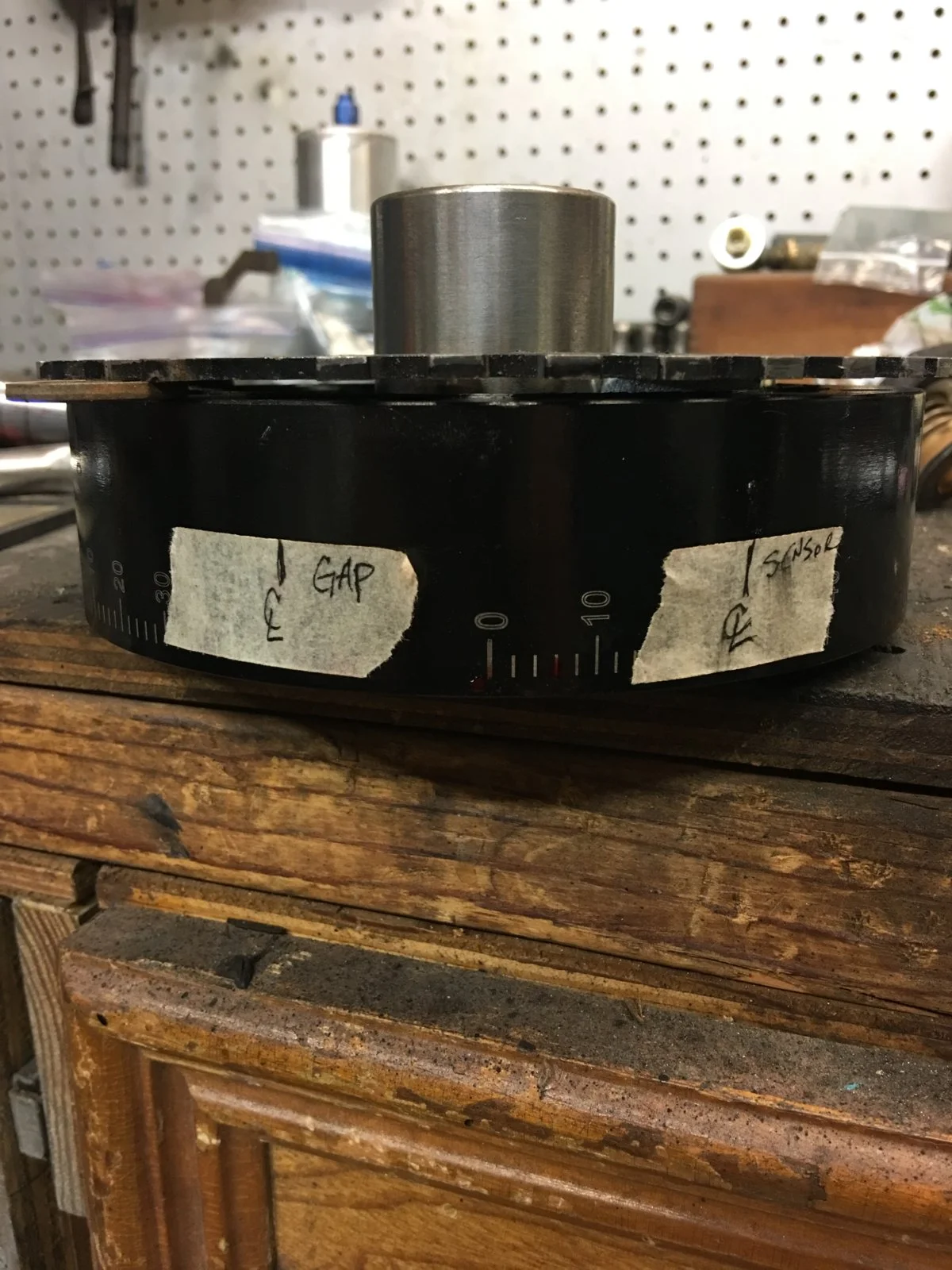

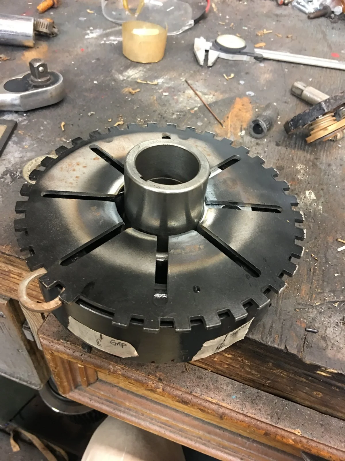

I got nowhere, and yet somewhere tonight. The old balancer is off. The new balancer is marked, and I now know I can’t mount it the same way because the counter weight sticks out too far, so the wheel must go on the face of the balancer. I still need a new trigger wheel I think, and a way to mount it.
Just so you know this ( in case you don't)
Once you figure out the trigger wheel mounting thing, and you rough orient the missing tooth to wherever you want it to go based on the intended location for your crank sensor, you need to find a way to positively lock that thing on the front of the balancer. I used 4 small counter sunk screws, and recessed the heads. If the machine shop you use can cut that center out of that wheel like they did mine, they'll have to bolt the thing to a fixture first to keep it stable so that process won't fuk up the wheel. After they do that, you should be able to use that center hub on the balancer to locate your trigger wheel so you won't have to worry about it being out of round. Then..........glue, screw, or weld that btch in place.
After all that............ And after you get the balancer back on the engine...........you absolutely have to determine TDC.
Once you establish true TDC, and ensure that your timing marks and pointer jive, the location for your pick up sensor can be 100% nailed down based on the information out there for where the thing is supposed to be located for a v8.
The bracket you make needs to be rigid, and adjustable. Recommended pickup gap is supposed to be between .030, and like ..080....( IIRC I used a piece of 16 ga. steel as a go/no go gauge, and stuck it between the sensor, and the trigger wheel tooth while I was tightening everything down) this kept it aligned properly too ( not cocked or twisted)

I know I'm within a red cnt hair of TDC now, as I got it as close as I could feel last night, but how can I absolutely guarantee without a gauge of some sort?
Alright, I went to the machine shop. "Why don't you just grind the opening more so it's loose in the middle, bolt it finger tight, tap it with a hammer to get the run out good, then weld it on?"
