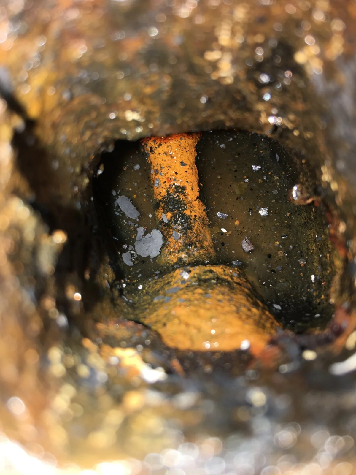

Honestly, I need whatever option is going to get me running again the fastest/easiest. I'm going to try drilling out the broken bit again tonight with a cobalt bit and if it doesn't work, I'll have no choice but to get the P heads cleaned up.It’s personal preference really. Do you want to? If you answer yes more freely with your own questions..then choose that option.

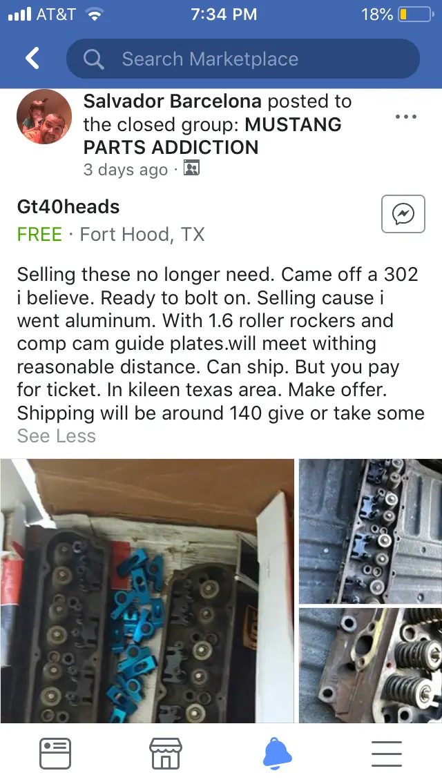

Very true. The ad posted above reads "ready to bolt on", yet they have the heads machined-side down in all the pictures.I die a little more inside every time I see people lay heads machined-side-down on truck beds and concrete.
I was prepared to execute that plan until the drill bit broke off in the head. I'm going to see how cheaply I can pull all this together. For the record, I am NOT excited about any of this work, but I need my truck running ASAP.Collin, protect yourself from yourself, I vote option D. However, if you can't get the broken bolts out then I agree with installing the P heads.
I had this same thing happen when my oil pan bolts sheared off in the block. I tried the reverse drill bits which was a fail, then tried drilling out the old bolt which resulted in snapping off the drill bit in the sheared bolt. I finally said screw it and drilled the entire hole out and installed threaded locking inserts. They were easy and took very little time.I was prepared to execute that plan until the drill bit broke off in the head. I'm going to see how cheaply I can pull all this together. For the record, I am NOT excited about any of this work, but I need my truck running ASAP.
