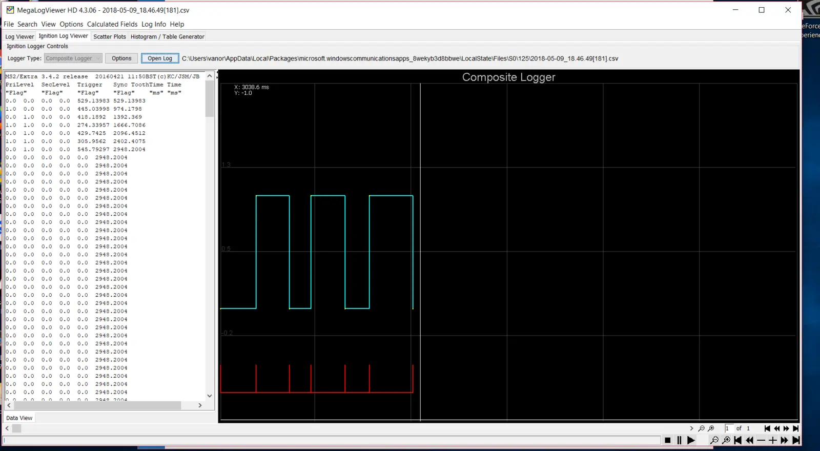

here is the ignition log you sent me, i can see 3 teeth on the log then it quite. the spacing looks normal-ish on the first 3 teeth, you may want to check the spacing on the sensor to the wheel.
